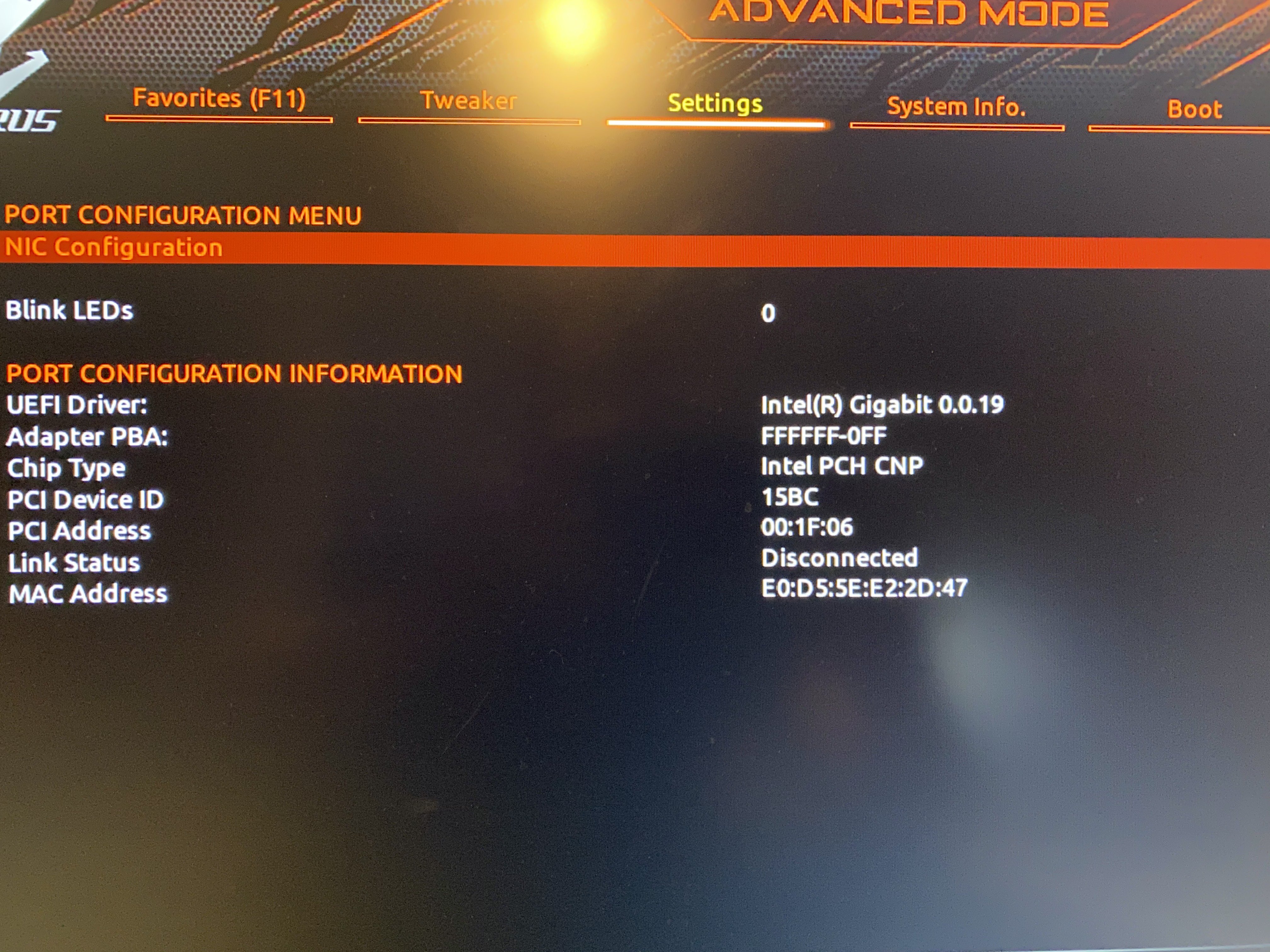

Mr Mike Posted February 23, 2020 Share Posted February 23, 2020 2 minutes ago, texem said: check your dhcp My DHCP usually assigns automatically, I'm not familiar with MacOS and can't see anywhere to manually input. I am connected to a Wi-Fi extender, not sure if that would cause any issues. Link to comment Share on other sites More sharing options...

Mr Mike Posted February 23, 2020 Share Posted February 23, 2020 1 hour ago, Mr Mike said: I'm getting stuck at the install screen with, “internet connection required”? Same with Mojave too! Slightly different error, "The recovery server could not be contacted". This so frustrating. If anyone has any ideas I'm all ears. Link to comment Share on other sites More sharing options...
AudioGod Posted February 23, 2020 Author Share Posted February 23, 2020 10 minutes ago, Mr Mike said: Same with Mojave too! Slightly different error, "The recovery server could not be contacted". This so frustrating. If anyone has any ideas I'm all ears. have you tried if possible plugging directly into your router and see if the problem persists? have you checked the ethernet settings in your network preferences? Link to comment Share on other sites More sharing options...

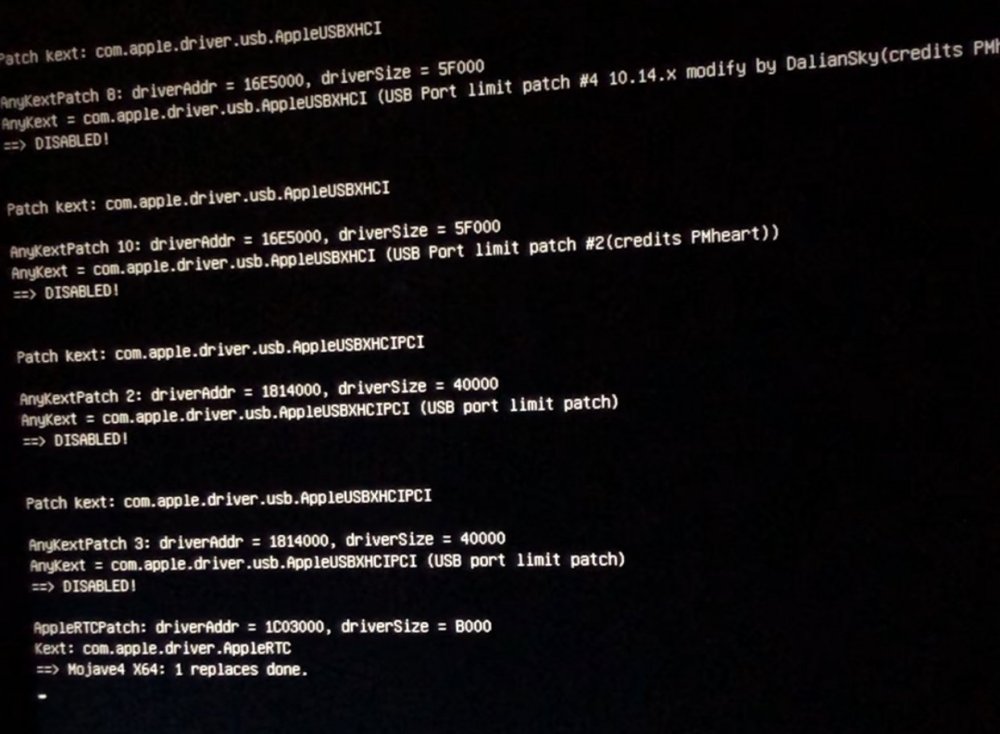

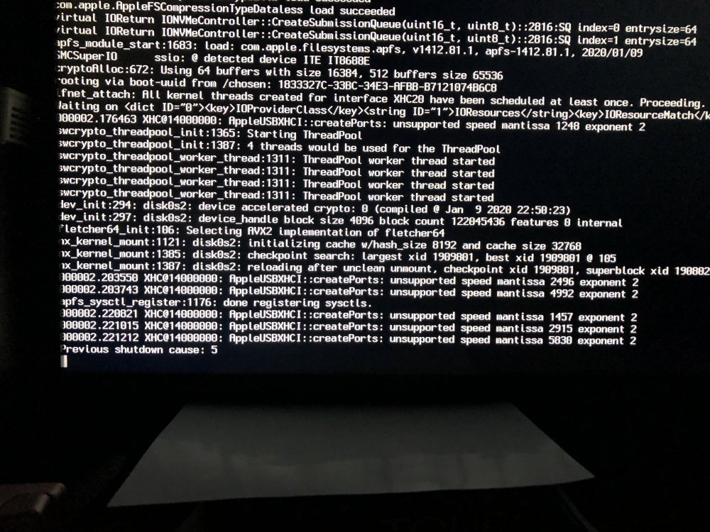

Olion Posted February 23, 2020 Share Posted February 23, 2020 (edited) 1 hour ago, AudioGod said: Does your keyboard and mouse work up until you get to the login? did you try pulling out the keyboard and mouse usb connections and then plugging them back in or trying a different USB port? mouse and keyboard work in BIOS and in clover settings. After loading this login screen opens and no usb port for the mouse or keyboard anymore works. tried to rearrange to all other ports, the same thing. But, I install Catalina from Mojave (Update). Not fully clear installation. Edited February 23, 2020 by Olion Link to comment Share on other sites More sharing options...

larabee Posted February 23, 2020 Share Posted February 23, 2020 1 hour ago, Mr Mike said: Same with Mojave too! Slightly different error, "The recovery server could not be contacted". This so frustrating. If anyone has any ideas I'm all ears. can you try this: open terminal in installation, run command to make sure your ethernet card work ifconfig en0 up Then run command to set dhcp automatically ipconfig set en0 DHCP If this doesn’t solve the issue, plug in directly to router without using extender. Link to comment Share on other sites More sharing options...

Mr Mike Posted February 23, 2020 Share Posted February 23, 2020 1 hour ago, AudioGod said: have you tried if possible plugging directly into your router and see if the problem persists? have you checked the ethernet settings in your network preferences? Not sure how to get to network preferences from this screen, clicking the Apple logo only gives option to shutdown, restart or select disk. 24 minutes ago, larabee said: can you try this: open terminal in installation, run command to make sure your ethernet card work ifconfig en0 up If this doesn’t solve the issue, plug in directly to router without using extender. # ifconfig en0 up ifconfig: interface en0 does not exist # ifconfig lo0: gif0: stf0: XHC20: Tried hooking up directly to the router, same thing. Am I right in thinking that IntelMausi.kext is used to make ethernet work? Is there any way I can find out if this kext is successfully injected? I'm using the same config that's included in the AudioGod's EFI. I don't understand what could possibly be different from my setup compared to anyone else's, baffled. Link to comment Share on other sites More sharing options...
larabee Posted February 23, 2020 Share Posted February 23, 2020 4 minutes ago, Mr Mike said: # ifconfig en0 up ifconfig: interface en0 does not exist # ifconfig lo0: gif0: stf0: XHC20: Tried hooking up directly to the router, same thing. Am I right in thinking that IntelMausi.kext is used to make ethernet work? Is there any way I can find out if this kext is successfully injected? I'm using the same config that's included in the AudioGod's EFI. I don't understand what could possibly be different from my setup compared to anyone else's, baffled. The board is still the same, so in theory it should not cause any problem. Did you load the BIOS profile attached in the guide for bios version 12D? Link to comment Share on other sites More sharing options...

larabee Posted February 23, 2020 Share Posted February 23, 2020 2 minutes ago, Mr Mike said: Are you talking about the CFG Unlock profile? If so, no I didn't. I thought that was just for users with graphics cards. I'll give it a go, I'm desparate at this point. If En0 is not present, then your ethernet card is not functioning. That's the issue. Load the Bios profile and give it a try again. Use the unlocked 12D profile. Link to comment Share on other sites More sharing options...
Mr Mike Posted February 23, 2020 Share Posted February 23, 2020 3 minutes ago, larabee said: If En0 is not present, then your ethernet card is not functioning. That's the issue. Load the Bios profile and give it a try again. Use the unlocked 12D profile. 1 - Download the profile and save it to a USB Key ✔ 2 - Go into the bios, ✔ 3 - Load the profile, ✔ 4 - Save and exit ✔ 5 - Go straight back into the bios and save your bios to a new profile and name it Default CFG Unlocked or something like that. ✔ 6 - Boot back into Catalina go into your clover config and under Kernal and Kext Patches Uncheck KernalPM ✘ 7 - Save the changes and then restart and your done, your motherboard will now be CFG (MSR) Unlocked ✘ Still the same. However there is one thing I noticed in the BIOS > Settings > Intel(R) Ethernet Connection (7) I219-V - [MAC ADDR] > Link Status: Disconnected! Link to comment Share on other sites More sharing options...
AudioGod Posted February 23, 2020 Author Share Posted February 23, 2020 1 minute ago, Mr Mike said: 1 - Download the profile and save it to a USB Key ✔ 2 - Go into the bios, ✔ 3 - Load the profile, ✔ 4 - Save and exit ✔ 5 - Go straight back into the bios and save your bios to a new profile and name it Default CFG Unlocked or something like that. ✔ 6 - Boot back into Catalina go into your clover config and under Kernal and Kext Patches Uncheck KernalPM ✘ 7 - Save the changes and then restart and your done, your motherboard will now be CFG (MSR) Unlocked ✘ Still the same. However there is one thing I noticed in the BIOS > Settings > Intel(R) Ethernet Connection (7) I219-V - [MAC ADDR] > Link Status: Disconnected! Check your cable bud Link to comment Share on other sites More sharing options...
larabee Posted February 23, 2020 Share Posted February 23, 2020 1 minute ago, AudioGod said: Check your cable bud Dude, you're faster than I am, lolz. 1 Link to comment Share on other sites More sharing options...
Mr Mike Posted February 23, 2020 Share Posted February 23, 2020 1 minute ago, AudioGod said: Check your cable bud Just now, larabee said: Dude, you're faster than I am, lolz. Confirmed cable attached, blinking lights. I can even boot into Windows and internet is fine. Link to comment Share on other sites More sharing options...

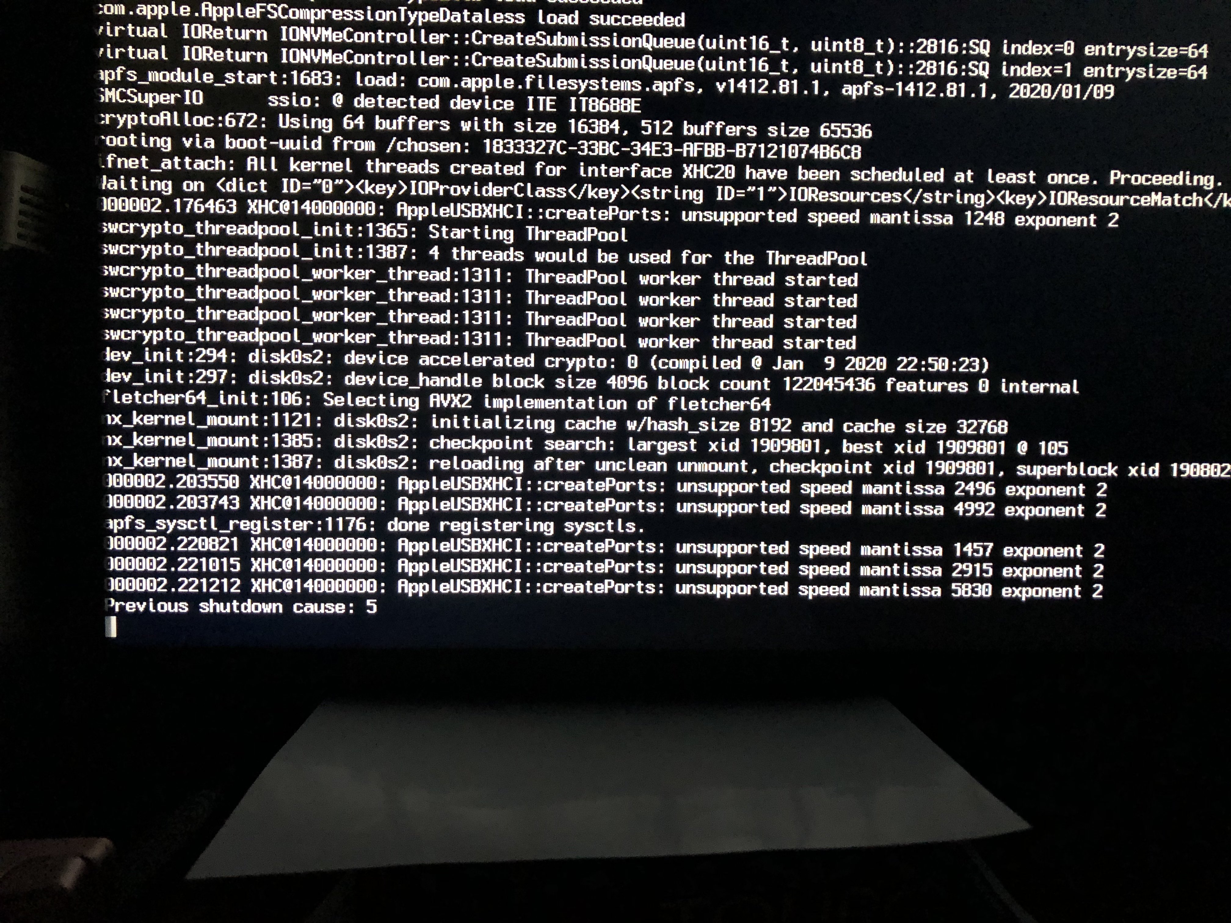

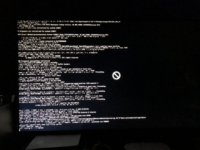

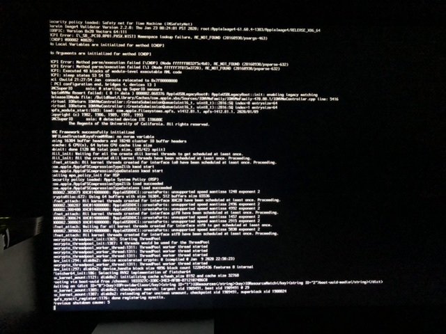

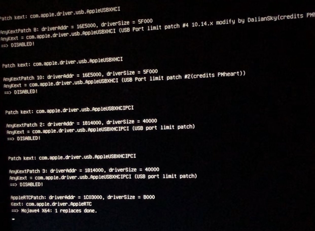

Olion Posted February 24, 2020 Share Posted February 24, 2020 I tried to load recovery mode, all the same, the window opens with a choice of language (as if to continue the installation) mouse and keyboard don’t work. In debug mode I see this mesages: Kext (usb...) disabled. Link to comment Share on other sites More sharing options...
AudioGod Posted February 24, 2020 Author Share Posted February 24, 2020 4 hours ago, Olion said: I tried to load recovery mode, all the same, the window opens with a choice of language (as if to continue the installation) mouse and keyboard don’t work. In debug mode I see this mesages: Kext (usb...) disabled. Erm there is no usb Kext in My EFI, USB is done via the ssdt and dsdt with no kext needed. Link to comment Share on other sites More sharing options...

Olion Posted February 24, 2020 Share Posted February 24, 2020 (edited) I'm desperate. I'm ready to lose all my data and install new macOS, I do everything according to the tutorial from the @glasgood Catalina guide with your settings for f12 h630 and I have a kernel panic, or some other mistake, but even the installation of the osX does not start. Edited February 24, 2020 by Olion Link to comment Share on other sites More sharing options...
