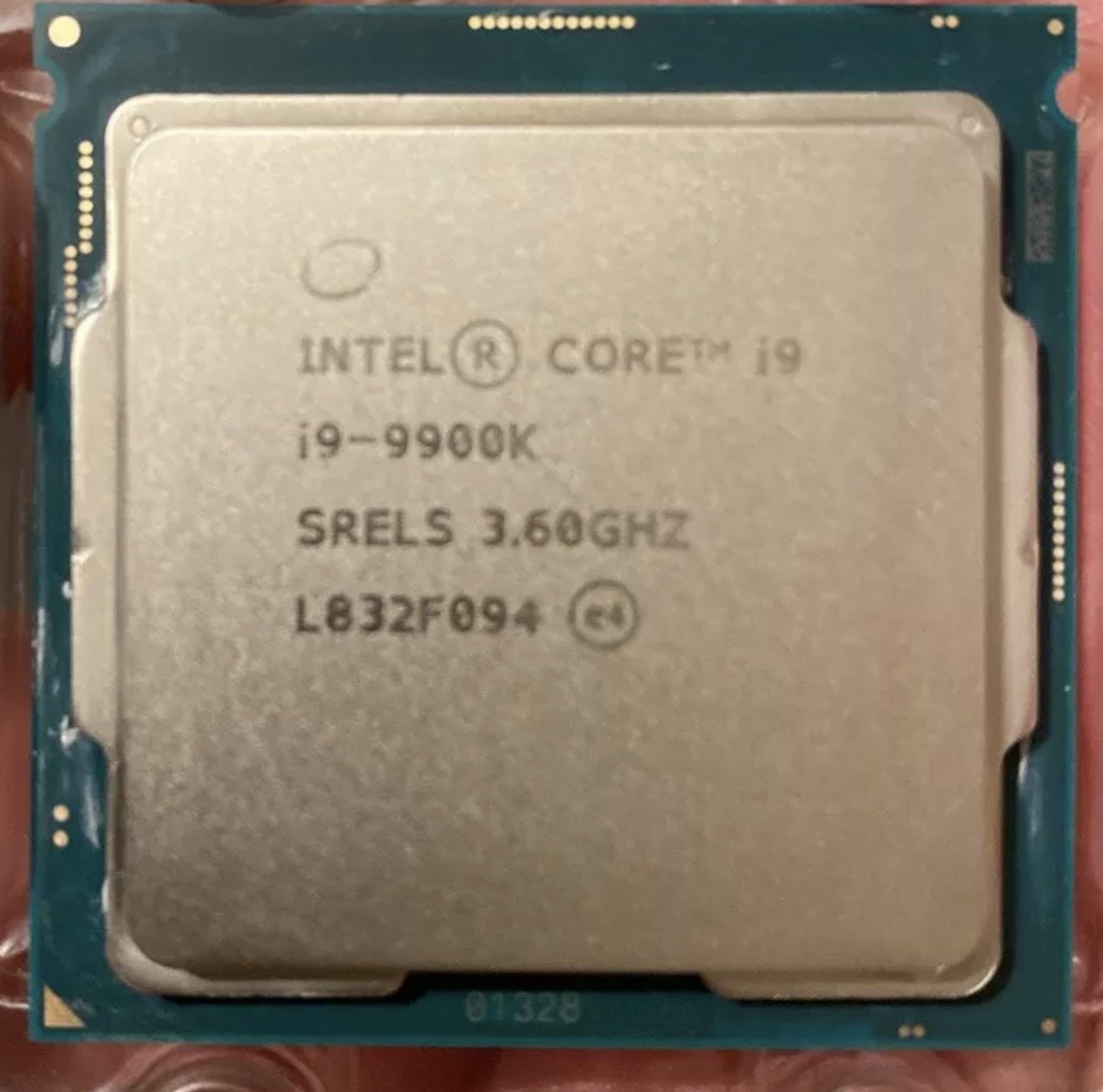

Cameron Nicholson Posted February 21, 2020 Share Posted February 21, 2020 4 minutes ago, AudioGod said: If you can tell me the SKU of your 9900k I can tell you if it’s a good bit of silicone or not? tbh that’s about right temps wise for your average 9900k, the real tell tell of how good it is would be to get a reading or the amps and watts being pulled from the system while running say small ffts in prime 95 (custom 12 12) How do I find the SKU? Link to comment Share on other sites More sharing options...
AudioGod Posted February 21, 2020 Author Share Posted February 21, 2020 2 minutes ago, Cameron Nicholson said: How do I find the SKU? It’s on the ihs heres an example SRELS is the SKU give me a power reading instead like I described and I can tell you that way? Link to comment Share on other sites More sharing options...
Cameron Nicholson Posted February 21, 2020 Share Posted February 21, 2020 1 minute ago, AudioGod said: It’s on the ihs heres an example SRELS is the SKU give me a power reading instead like I described and I can tell you that way? I would have to re setup windows, my pc is hack only these days Link to comment Share on other sites More sharing options...
AudioGod Posted February 21, 2020 Author Share Posted February 21, 2020 2 minutes ago, Cameron Nicholson said: I would have to re setup windows, my pc is hack only these days Don’t bother buddy, I’m only being the nosey nerd that I am Link to comment Share on other sites More sharing options...
