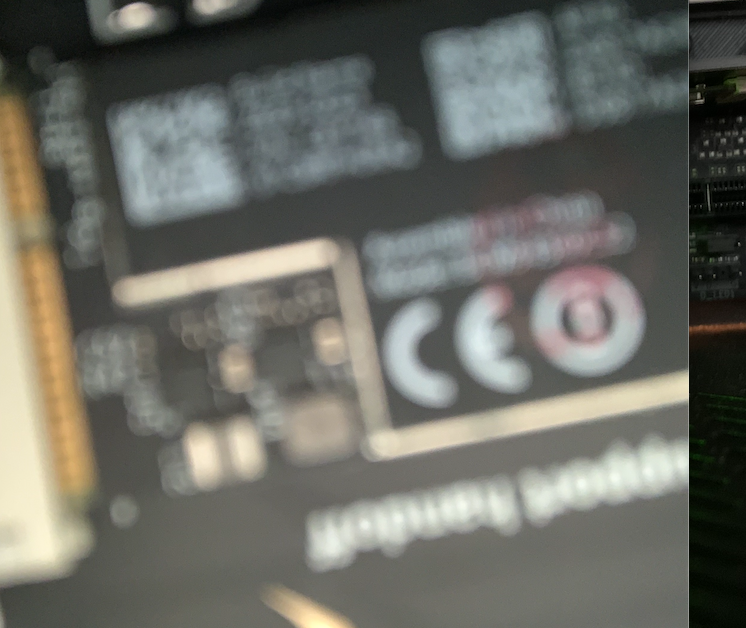

AudioGod Posted February 17, 2020 Author Share Posted February 17, 2020 @texem Question, is your ABWB BCM943602CS metal bracket silver or black? also have a look at the BCM943602CS card itself and tell me if you see a CE approved stamp on it or not? I am doing a build for somebody and I bought a ABWB BCM943602CS from amazon and it’s not a CE approved BCM943602CS so I suspect it’s a fake one and also when the system goes to sleep under smbios1,1 (Vega56 gpu installed) The system crashes and restarts just like what was happening to you. I removed the ABWB BCM943602CS and tried again without it and low and behold the crash stopped straight away. I’ve just called amazon about it and let them know and the guy admitted that they have Had this flagged up a lot of times over the last few months and gave me a full refund and a £15 voucher as a sorry. my Personal ABWB BCM943602CS has a silver bracket not black and is ce approved, I’m going to swap it out for my t919 I think and donate my ABWB BCM943602CS to the build I’m doing. Link to comment Share on other sites More sharing options...

texem Posted February 17, 2020 Share Posted February 17, 2020 (edited) 1 hour ago, AudioGod said: @texem Question, is your ABWB BCM943602CS metal bracket silver or black? silver and CE. Sorry couldn't shot a better photo Edited February 17, 2020 by texem Link to comment Share on other sites More sharing options...
AudioGod Posted February 17, 2020 Author Share Posted February 17, 2020 (edited) @texem no that’s perfect your legit. Phew. drop down to the 4x slot under it, I think the combo is 4x u know. im trying it now there on the build I’m doing and getting much better results. update, no forget it....it’s a 1x adaptor, I just checked the spec, Edited February 17, 2020 by AudioGod Link to comment Share on other sites More sharing options...

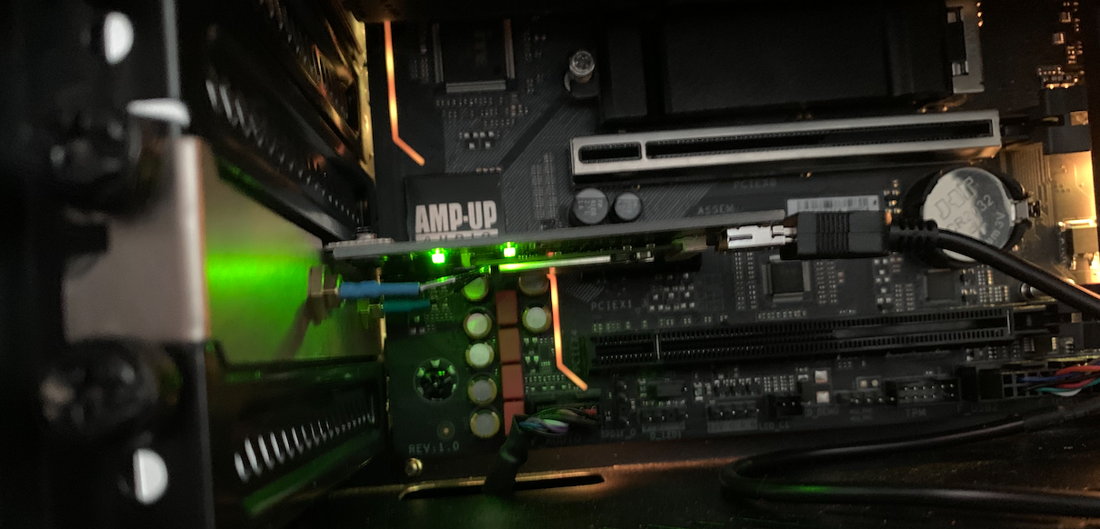

texem Posted February 17, 2020 Share Posted February 17, 2020 I'll give it a try, tnx for the hint Link to comment Share on other sites More sharing options...
texem Posted February 17, 2020 Share Posted February 17, 2020 (edited) as expected : the above x4 hype is nonsense ;-) tbh: for whatever reason it should use more than one lane ? performance ? Never ... Edited February 17, 2020 by texem Link to comment Share on other sites More sharing options...
AudioGod Posted February 17, 2020 Author Share Posted February 17, 2020 (edited) 5 minutes ago, texem said: as expected : the above x4 hype is nonsense ;-) tbh: for whatever reason it should use more than one lane ? performance ? Never ... It’s a 1x card to start with as I quickly corrected myself already above. it’s the t919 that’s 4x and crashes on the 1x slot Edited February 17, 2020 by AudioGod Link to comment Share on other sites More sharing options...
texem Posted February 17, 2020 Share Posted February 17, 2020 (edited) ah, ok . To be correct with the model type it's a BCM94360CS2 / two antennas. There exists "CS" with 3 and "CD" with 4 antennas and BT4.1 The ABWB is the "older" model with BT 4.0 . Edited February 17, 2020 by texem Link to comment Share on other sites More sharing options...
AudioGod Posted February 17, 2020 Author Share Posted February 17, 2020 (edited) 4 minutes ago, texem said: ah, ok . To be correct with the model type it's a BCM94360CS2 / two antennas. There exists "CS" with 3 and "CD" with 4 antennas and BT4.1 l. The ABWB is the "older" model with BT 4.0 . yep that’s right bud (BCM94360CS2 was used up until the 2017 MacBook) but fun fact and you check this one for yourself BCM94360CS2 is actually a 4x card and ABWB are using a 1x adaptor, I doubt it makes any difference tbh but it’s a bit strange of them to do that I think. Edited February 17, 2020 by AudioGod Link to comment Share on other sites More sharing options...
