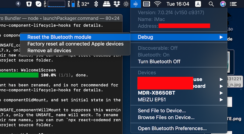

WizeMan Posted January 21, 2020 Share Posted January 21, 2020 (edited) 16 minutes ago, Cameron Nicholson said: Thanks, Kernal PM iS checked Also try to reset the bluetooth module: Shift - Alt - Click the bluetooth icon -> Debug Edited January 21, 2020 by WizeMan Link to comment Share on other sites More sharing options...

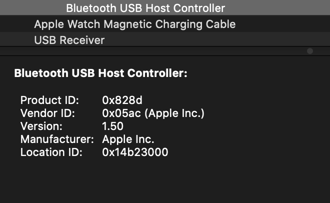

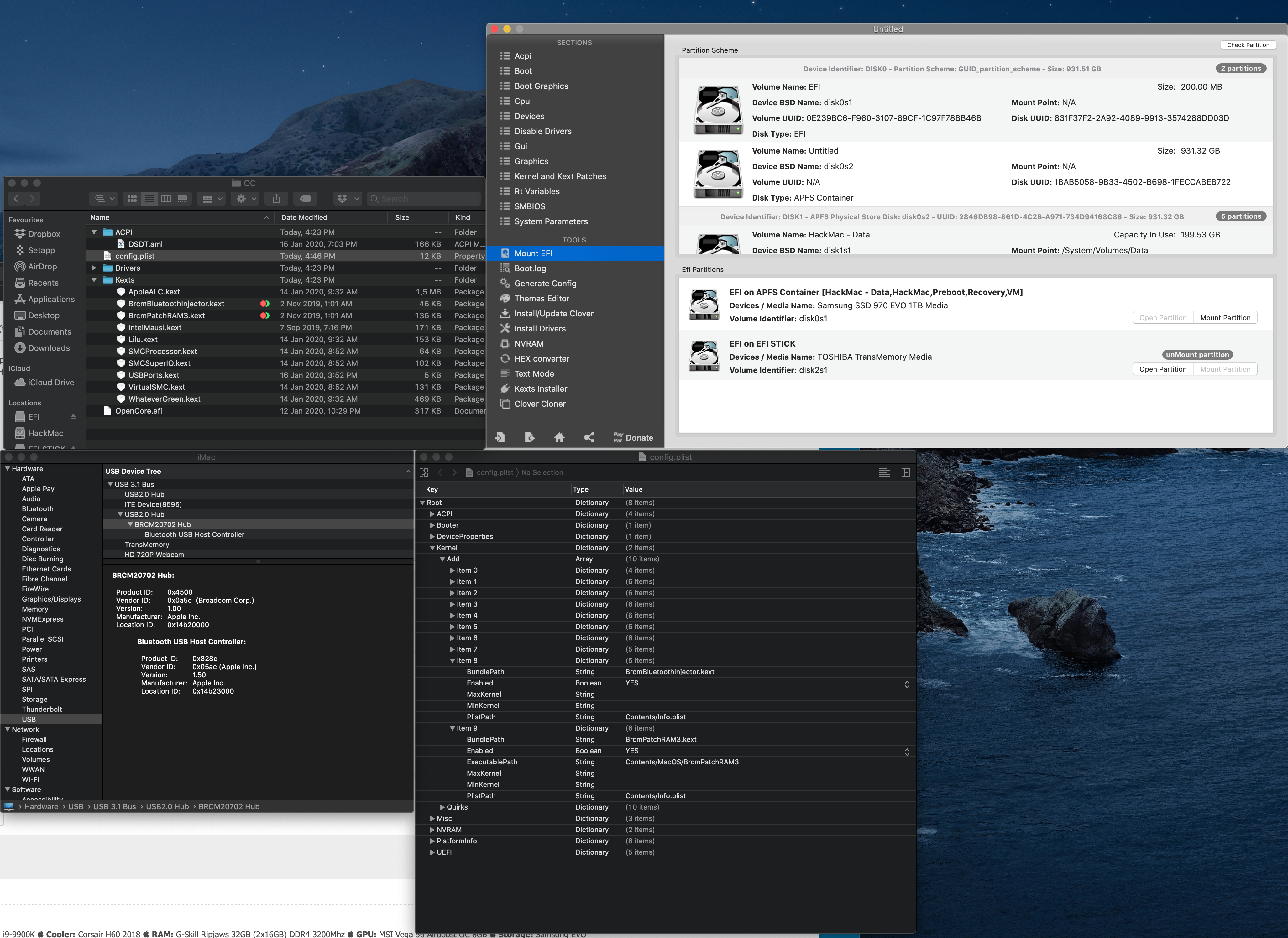

AudioGod Posted January 21, 2020 Author Share Posted January 21, 2020 Just now, WizeMan said: Also try to reset the bluetooth module: Shift - Alt - Click the bluetooth icon -> Debug @WizeMan could you open your usb page in hardware info and take a screen shot of your devices in it mainly your Broadcom connection and show me please? Link to comment Share on other sites More sharing options...

WizeMan Posted January 21, 2020 Share Posted January 21, 2020 2 minutes ago, AudioGod said: @WizeMan could you open your usb page in hardware info and take a screen shot of your devices in it mainly your Broadcom connection and show me please? Link to comment Share on other sites More sharing options...
AudioGod Posted January 21, 2020 Author Share Posted January 21, 2020 (edited) 2 minutes ago, WizeMan said: yeah that’s what I thought I wuould see, it’s wrong buddy. Add the Broadcom fix kexts I sent a few posts back and check again and send Me screenshots please? Edited January 21, 2020 by AudioGod Link to comment Share on other sites More sharing options...
WizeMan Posted January 21, 2020 Share Posted January 21, 2020 3 minutes ago, AudioGod said: yeah that’s what I thought I wuould see, it’s wrong buddy. Add the Broadcom fix kexts I sent a few posts back and check again and send Me screenshots please? I think you might have misunderstood me for @Cameron Nicholson I am not facing any bluetooth issues whatsoever Link to comment Share on other sites More sharing options...

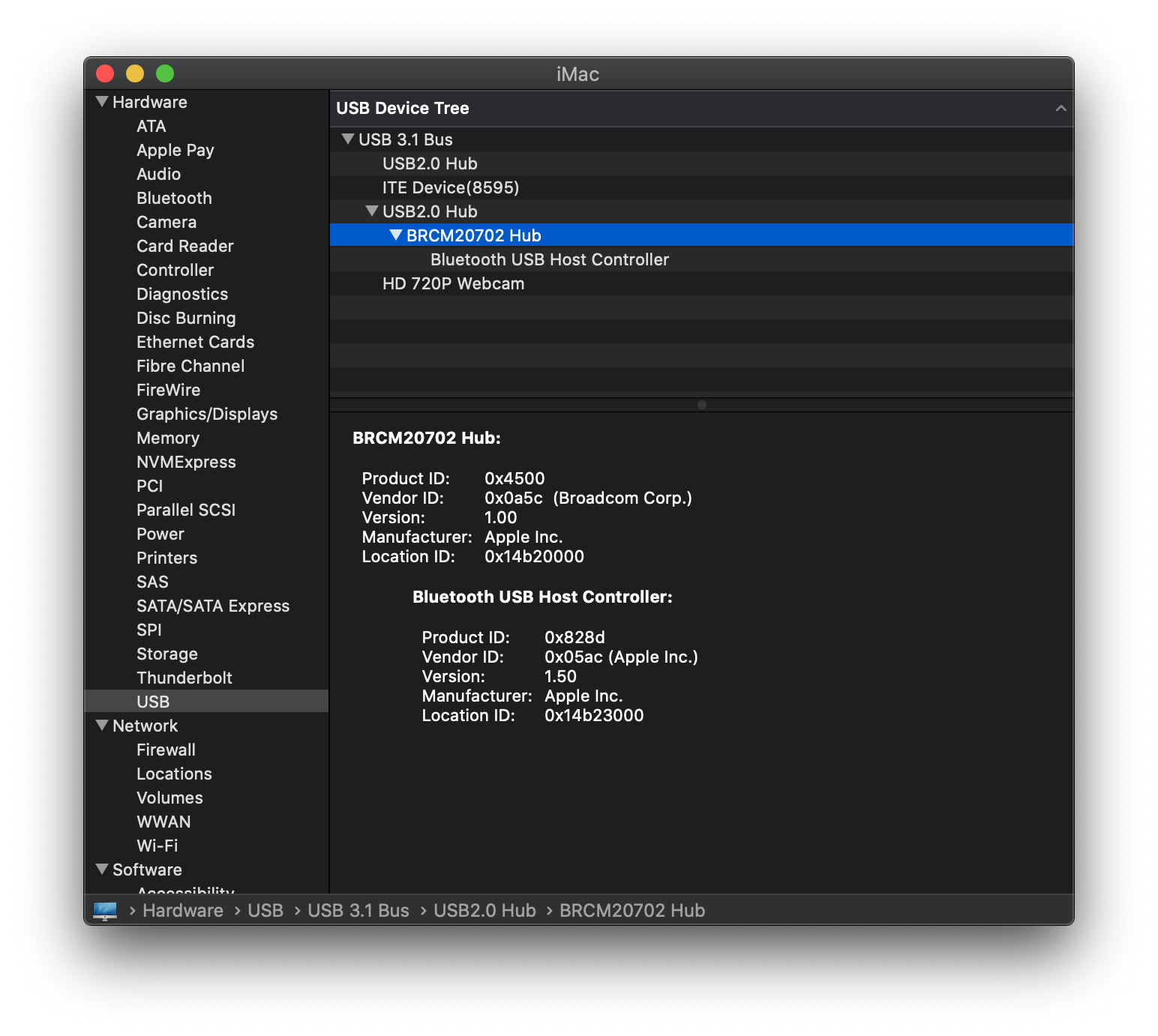

AudioGod Posted January 21, 2020 Author Share Posted January 21, 2020 (edited) 2 minutes ago, WizeMan said: I think you might have misunderstood me for @Cameron Nicholson I am not facing any bluetooth issues whatsoever I known your not and yes I’m talking to you bud, I’ve been doing a lot of homework on Broadcom cards and I can see your firmware and it’s wrong and listing the usb incorrectly, the files I’m Suggesting will correct it. it would also explain why you have to do things differently to get it all going. Edited January 21, 2020 by AudioGod Link to comment Share on other sites More sharing options...
WizeMan Posted January 21, 2020 Share Posted January 21, 2020 Just now, AudioGod said: I known your not and yes I’m talking to you bud, I’ve been doing a lot of homework on Broadcom cards and I can see your firmware and it’s wrong and listing the usb incorrectly, the files I’m Suggesting will correct it. Hm... OK I'll add the kexts to the kexts folder and to OC config.plist and report back... let's hope that this is not a revenge plot to destroy my Apple Watch unlock Link to comment Share on other sites More sharing options...
