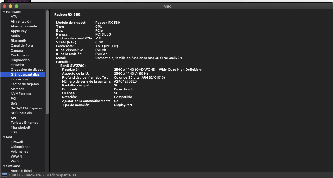

I've been playing with shikigva values with no luck for getting Sidecar working using a lightning cable.
My processor is an i7 9700 with an internal HD 630. Just to mention that the iGPU it's now shown on the graphics section on system information and i don't know if this is the normal behaviour.
Apple TV+ is working fine using shikigva=80 but i used shikigva=16 in order to avoid a system freeze when accesing netflix.
Thanks

Dude your never gonna get it to work on a RX Polaris cos drm is broken and this includes on real macs too.
This thread is a drm free zone now as there’s no point going over and over and over the same old thing when it can’t by fixed until Apple fixes it and or WEG make a work around.
Sorry dude...:wallbash:
Edited by AudioGod
Yeah, i only mentioned that as information but i don't care. Just trying to get Sidecar working!
Sorry if you missinterpreted me, my English is not very good.
Thanks!

also when your running igpu in headless mode you don’t want it to be listed in your system info so that is all correct. Sidecar works if your using smbios19,1 wireless and wired. Tried and tested by many including myself. :)
do you have a WiFi/Bluetooth card in your system?
Edited by AudioGod

Yeah i am using your last EFI with smbios19,1 but no luck with Sidecar. Also if i set Internal Graphics > Enabled in the bios (revision F11), the system won't boot and shows the typical prohibit symbol so i have to leave it as Auto.
Anyway, just playing a bit since i don't need Sidecar either.
Thank you again for all your work!
Ok it’s not working because you have it on auto, it needs to be set to enabled or it will b off even when set too auto.
what you need to do to clear the stop sign or boot kp is save your bios setting as a bios profile and then remove the power from the mains and then remove the motherboard battery for a few mins and then put it all back and load back in your bios profile and try again.
if it still won’t boot then you have somthing wrong with your setup And native nvram because it should and would boot after that. You can also try reducing the igpu memory from 64mb too 32mb but that is a last resort.

Thank you mate. It's working now!!
All the best!
