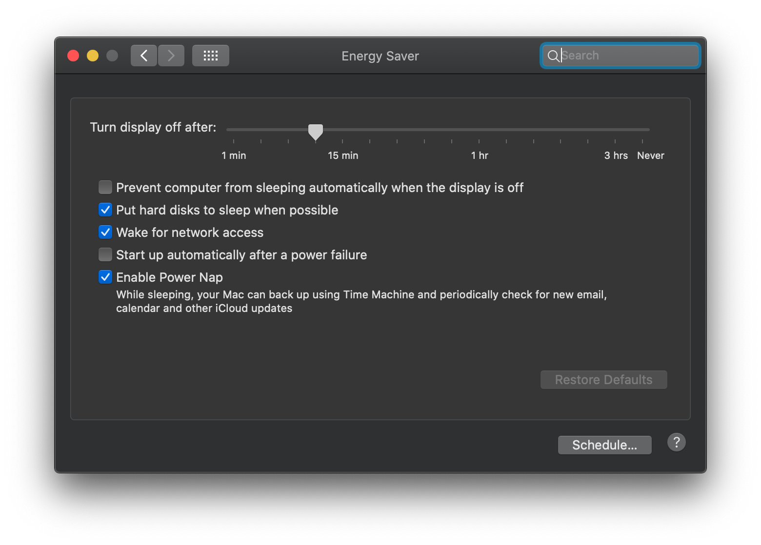

WizeMan Posted December 20, 2019 Share Posted December 20, 2019 (edited) Has anybody noticed any of these issues with the new EFI? : Network / Bluetooth issues: I have been heavily using Skype and Hangouts with the previous and the current (new EFI) and with the latter I have been experiencing degrade in my communications. I do not know whether this bluetooth (headset) or network related. Probably network because Whenever I have issues with the communication some pages also lag to load. Also, with the old EFI my hack automatically connected to the 5G Wifi Network, but now it doesn't (it connects to the 2.4G network - The router provides the same SSID for both -) and maybe that's what causing issues (BT - Wifi on 2.4 both is a no-no). My networking setup has not changed (router in the same position and it's settings as well) Sleep: I press Apple Icon -> Sleep when I leave the office. With the previous EFI when I came back the next day, my computer stayed sleeping (all motherboard / cooler LEDs off - fans off) and woke up fine when moving the Apple Magic Mouse or pressing a Magic keyboard key. With the new EFI, I put the machine to sleep yesterday when I left work (it slept as it normally did before) but when I came back in the morning, although the monitor had no signal, the motherboard LEDs where on and the fans where working as well. When I moved the mouse the monitor got signal and unlock with watch worked as well, but the "sleep" state was very different (the motherboard LEDs and fans working, I mean). Edited December 20, 2019 by WizeMan Link to comment Share on other sites More sharing options...
AudioGod Posted December 20, 2019 Author Share Posted December 20, 2019 (edited) 6 minutes ago, WizeMan said: Has anybody noticed any of these issues with the new EFI? : Network / Bluetooth issues: I have been heavily using Skype and Hangouts with the previous and the current (new EFI) and with the latter I have been experiencing degrade in my communications. I do not know whether this bluetooth (headset) or network related. Probably network because Whenever I have issues with the communication some pages also lag to load. Also, with the old EFI my hack automatically connected to the 5G Wifi Network, but now it doesn't (it connects to the 2.4G network - The router provides the same SSID for both -) and maybe that's what causing issues (BT - Wifi on 2.4 both is a no-no). My networking setup has not changed (router in the same position and it's settings as well) Sleep: I press Apple Icon -> Sleep when I leave the office. With the previous EFI when I came back the next day, my computer stayed sleeping (all motherboard / cooler LEDs off - fans off) and woke up fine when moving the Apple Magic Mouse or pressing a Magic keyboard key. With the new EFI, I put the machine to sleep yesterday when I left work (it slept as it normally did before) but when I came back in the morning, although the monitor had no signal, the motherboard LEDs where on and the fans where working as well. When I moved the mouse the monitor got signal and unlock with watch worked as well, but the "sleep" state was very different (the motherboard LEDs and fans working, I mean). I haven’t made a single change or alteration to anything todo with WiFi or Bluetooth so I don’t see how it can be the EFI at fault and also are you sure you didn’t walk in on the system waking from sleep as it’s setup to wake for mail or messages etc etc etc My hack is sleeping right now and has been asleep since yesterday, I’ve just looked through my logs and nothing strange in the sleep department is going on over here. Edited December 20, 2019 by AudioGod 1 Link to comment Share on other sites More sharing options...
WizeMan Posted December 20, 2019 Share Posted December 20, 2019 About Networking / Bluetooth. I separated the 5G network into a different SSID, removed the 2G SSID and I will see how it goes. About Sleep. Wake for network access has been enabled since day one. I have actually not changed the default settings since initial installation. How can I have a look at the sleep / wake logs? Hackintool is recommenced? Link to comment Share on other sites More sharing options...
AudioGod Posted December 20, 2019 Author Share Posted December 20, 2019 (edited) 3 minutes ago, WizeMan said: About Networking / Bluetooth. I separated the 5G network into a different SSID, removed the 2G SSID and I will see how it goes. About Sleep. Wake for network access has been enabled since day one. I have actually not changed the default settings since initial installation. How can I have a look at the sleep / wake logs? Hackintool is recommenced? If you untick power nap and wake for network then your system will stay off when sleeping. I’m suggesting that you walked in on it in the middle of waking for your network, kinda fits the bill tbh. Put it to sleep and watch it’s behaviour. If you have been messing with OpenCore that can also have its effect if you didn’t clear out the nvram between EFI (just saying just incase) Edited December 20, 2019 by AudioGod Link to comment Share on other sites More sharing options...
WizeMan Posted December 20, 2019 Share Posted December 20, 2019 5 minutes ago, AudioGod said: If you untick power nap and wake for network then your system will stay off when sleeping. I’m suggesting that you walked in on it in the middle of waking for your network, kinda fits the bill tbh. Put it to sleep and watch it’s behaviour. If you have been messing with OpenCore that can also have its effect if you didn’t clear out the nvram between EFI (just saying just incase) Your point is very valid. I just probably caught that little rascal red-handed (woken up for network activity). I always clear my NVRam, sir! I am a clean dude Cheers again, @AudioGod. Your help is very valuable for our hacks and our sanity. 1 Link to comment Share on other sites More sharing options...
