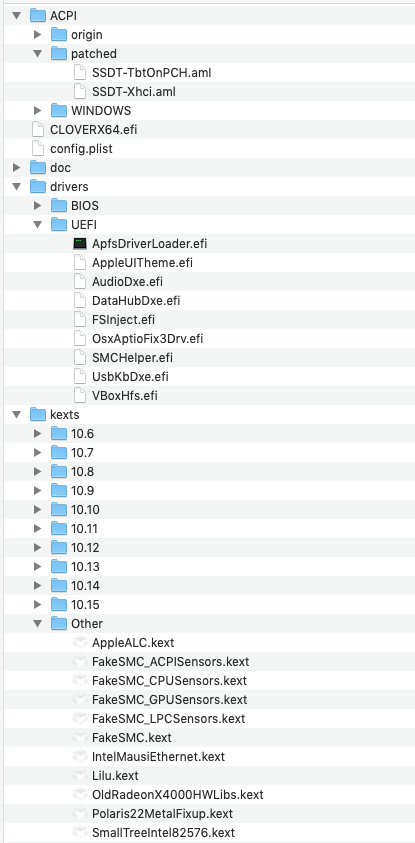

Hi I’m new to the hackintosh. I have already macOS Mojave on my nuc but I have the metal graphics issue so I tried to swap my efi with your and after I restart it say”no bootable driver is detected” how can I fix it . Please help me I don’t want to loose all my data.
Unfortunately you did not follow the direction. You’re supposed to install clover first and overwrite the EFI files. The download does not include Clover. To fix it, you need to reinstall Clover and then copy over the files AFTER installing clover.
Again, make sure you’re merging the directories instead of replacing it.

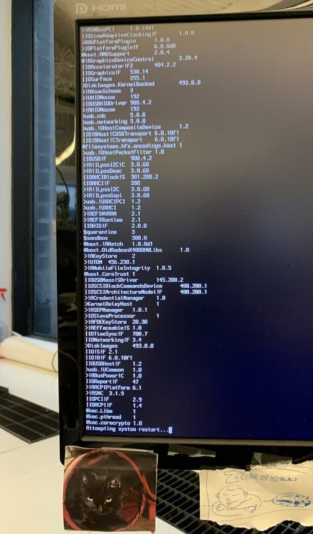

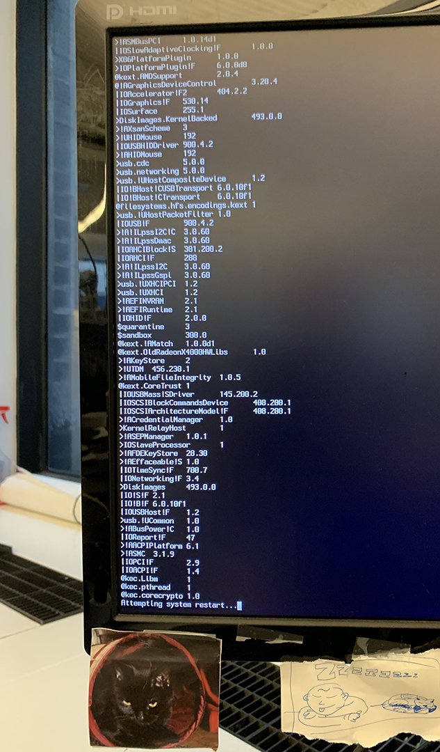

well Im into my setup fro the 65w version, and have built an installer a couple of times, but it keeps hanging after boot into the os install. attached KP screen. If anyone sees anything to suggest feel free to offer a suggestion. thanks!
Edited by kwjenkins
attach more useful screensnap
19 minutes ago, kwjenkins said:
Doh!
Did you make any modifications to config.plist? You can get a better KP log if you add this kext patch: https://github.com/RehabMan/Intel-NUC-DSDT-Patch/blob/master/config_nuc5.plist#L232
thanks taking whole kit home to work on, been trying to do install at office in downtime [I should know better] will check out link and adjust to get a better log.I didn't mod the config, Id initially thought to add a custom UUID to the file you provide, then backed out, and reinstalled the one in your collect.

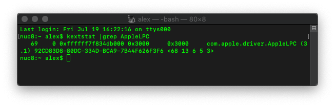

For some reason, AppleLPC.kext was not loaded with the patch you directed me to "The setting is here: https://github.com/osy86/HaC-Mini/blob/master/Clover/config.plist#L167"
Would you be able to show me the output of your nuc8 with the command in terminal "kextstat |grep AppleLPC" ?
This my nuc8 output with LPC injection and I get nothing with device-id override for PciRoot(0)/Pci(31,0).
Thanks !
Edited by Alex.C
