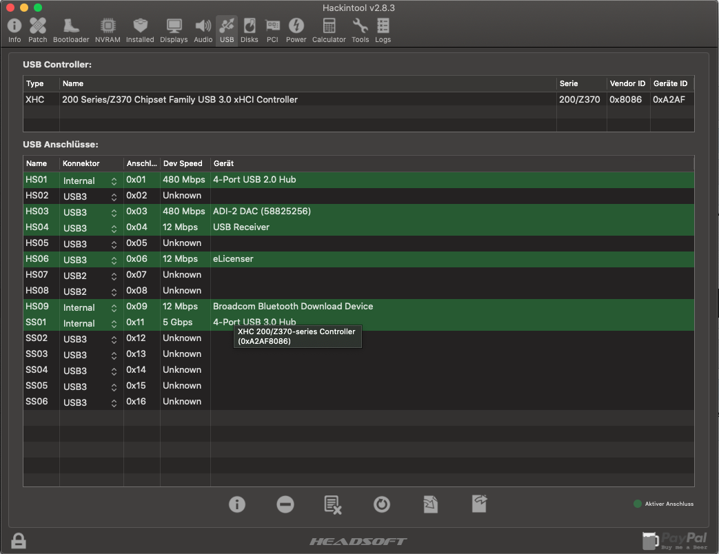

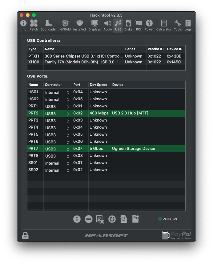

The_Dave94 Posted October 25, 2019 Share Posted October 25, 2019 (edited) Spoiler I'm having trouble to get the bluetooth working with my BCM943602CS. Wifi works without any kexts but bluetooth just won't, no matter what. At the moment i have the latest BrcmBluetoothInjector.kext, BrcmFirmwareData.kext, BrcmPatchRAM3.kext in L/E Edited October 25, 2019 by The_Dave94 Link to comment Share on other sites More sharing options...

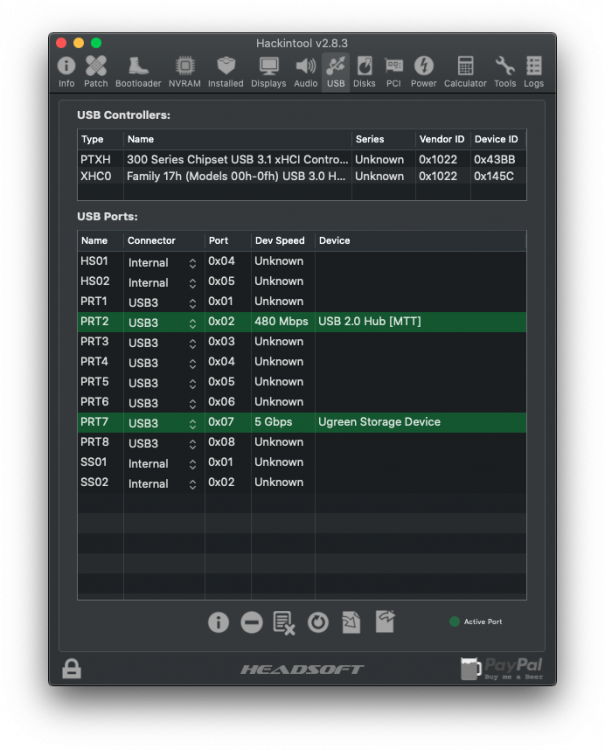

PepsiColaNYC Posted October 25, 2019 Share Posted October 25, 2019 26 minutes ago, The_Dave94 said: Reveal hidden contents I'm having trouble to get the bluetooth working with my BCM943602CS. Wifi works without any kexts but bluetooth just won't, no matter what. At the moment i have the latest BrcmBluetoothInjector.kext, BrcmFirmwareData.kext, BrcmPatchRAM3.kext in L/E I was having similar issues with my genuine Apple BCM94360CS2 card. It turned out to be a problem with my USB configuration. On my Z390 motherboard, the WiFi/BT M.2 slot is assigned a high USB port number. I didn't have a USB port limit patch, and the port just wasn't being detected by Mac OS. Once I added the patch (there's even one for Catalina now), the card was detected correctly, and everything magically worked. Link to comment Share on other sites More sharing options...
The_Dave94 Posted October 25, 2019 Share Posted October 25, 2019 2 minutes ago, PepsiColaNYC said: I was having similar issues with my genuine Apple BCM94360CS2 card. It turned out to be a problem with my USB configuration. On my Z390 motherboard, the WiFi/BT M.2 slot is assigned a high USB port number. I didn't have a USB port limit patch, and the port just wasn't being detected by Mac OS. Once I added the patch (there's even one for Catalina now), the card was detected correctly, and everything magically worked. I've created a custom usb port patch with hackintool so that shouldn't be a problem. Spoiler 1 Link to comment Share on other sites More sharing options...

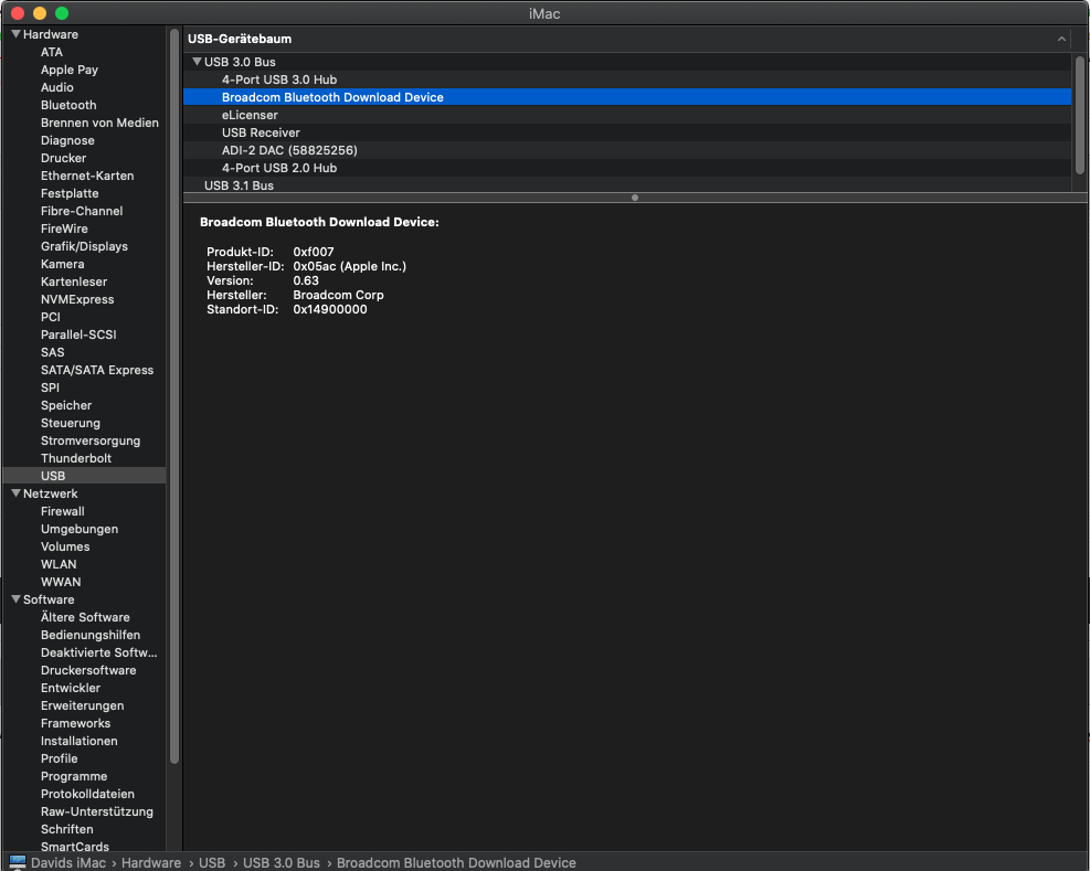

DaGr8Gatzby Posted October 29, 2019 Share Posted October 29, 2019 (edited) My BCM94360CD PCI card has working WiFi but non working bluetooth. System info does not even show it in USB bus. I have installed the following kexts from the BrcmPatchRAM-2019-10-17.zip file to /L/E: BrcmBluetoothInjector.kext BrcmPatchRAM3.kext BrcmFirmwareRepo.kext I am receiving the following error: 2019-10-29 11:15:22.323800-0400 localhost kernel[0]: (IOBluetoothFamily) <IOBluetoothFamily`IOBluetoothHCIController::SearchForTransportEventTimeOutHandler()> **** [IOBluetoothFamily][SearchForTransportEventTimeOutHandler] -- 'Broadcom USB Host Controller' does not exist in IORegistry causing this missing Blutooth Controller Transport problem This works in windows. Here is a screenshot of my Windows layout: And here is what Hackintool sees: Edited October 29, 2019 by DaGr8Gatzby Link to comment Share on other sites More sharing options...
ludufre Posted October 29, 2019 Share Posted October 29, 2019 (edited) 46 minutes ago, DaGr8Gatzby said: My BCM94360CD PCI card has working WiFi but non working bluetooth. System info does not even show it in USB bus. I have installed the following kexts from the BrcmPatchRAM-2019-10-17.zip file to /L/E: BrcmBluetoothInjector.kext BrcmPatchRAM3.kext BrcmFirmwareRepo.kext I am receiving the following error: 2019-10-29 11:15:22.323800-0400 localhost kernel[0]: (IOBluetoothFamily) <IOBluetoothFamily`IOBluetoothHCIController::SearchForTransportEventTimeOutHandler()> **** [IOBluetoothFamily][SearchForTransportEventTimeOutHandler] -- 'Broadcom USB Host Controller' does not exist in IORegistry causing this missing Blutooth Controller Transport problem This works in windows. Here is a screenshot of my Windows layout: And here is what Hackintool sees: I am afraid your USBs are not configured correctly. It should appear HSxx (HS01, HS02, etc.), see mine: HSxx = USB2.0 SSxx = USB3.0 See: https://github.com/RehabMan/OS-X-USB-Inject-All Edited October 29, 2019 by ludufre Link to comment Share on other sites More sharing options...

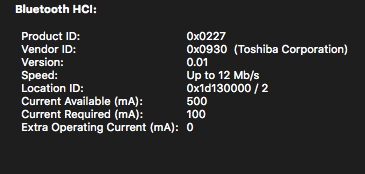

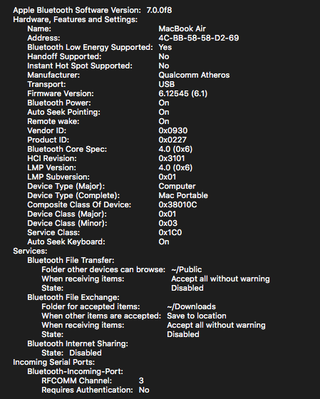

k3ron3i Posted October 31, 2019 Share Posted October 31, 2019 Hello from this end, Was passing by and decided to pose a question, just incase. I have AR9565 card, Wifi has its issues but at least its what am connected via now. Main issue is Bluetooth, the chipset is 0930:0227, Which surprisingly haven't seen anything of such id's from the attached firmwares. From System info, BT has a firmware version 6.12545 (6.1) , which is what is visible even from linux system which makes me think it's not loaded on start but rather saved in it. Using hardware switch, it turns on and off just fine, but on prefs, it just searches and seems not to find anything, I recently did build the repo on post #1 and installed BrcmBluetoothInjector.kext and somehow the BTTransporter kext was loaded and can now turn on/off from prefs and top panel, but still nothing is found while searching, attaching two screenshots. My question is simple, is there a way this card is supported(Currently running on Catalina), Could there be a way of getting it to run airDrop(Currently wifi works partially unlike in Mojave, ) regards. Link to comment Share on other sites More sharing options...
