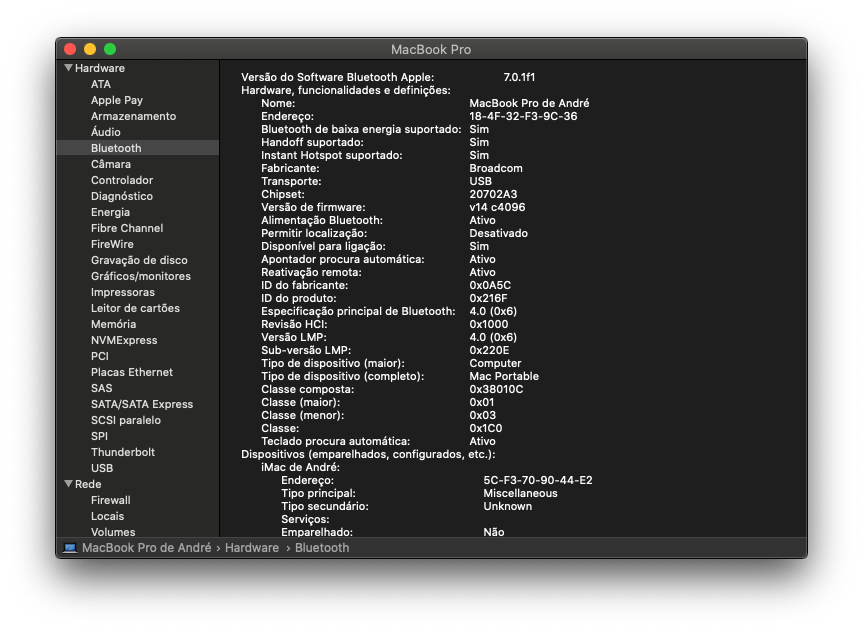

Gusu7 Posted November 2, 2019 Share Posted November 2, 2019 6 hours ago, Gusu7 said: after upgrading to 10.15.1, the bluetooth failed again, the firmware version turns to 4096 again... Please kindly help, what should I do, because I tried to use Hackintool to install the 3 kexts again, but it's not working. kextcache -arch x86_64 -local-root -all-loaded -kernel /System/Library/Kernels/kernel -prelinked-kernel /Library/Apple/System/Library/PrelinkedKernels/prelinkedkernel -volume-root / /Library/Extensions /AppleInternal/Library/Extensions /Library/Apple/System/Library/Extensions /System/Library/Extensions Kext with invalid signature (-67062) allowed: <OSKext 0x7fecd9e126a0 [0x7fff84c04d10]> { URL = "file:///Library/Extensions/BrcmBluetoothInjector.kext/", ID = "org.rehabman.injector.BrcmBluetoothInjector" } Kext with invalid signature (-67062) allowed: <OSKext 0x7fecd9e22e60 [0x7fff84c04d10]> { URL = "file:///Library/Extensions/BrcmFirmwareRepo.kext/", ID = "com.no-one.BrcmFirmwareStore" } Kext with invalid signature (-67062) allowed: <OSKext 0x7fecd9c01150 [0x7fff84c04d10]> { URL = "file:///Library/Extensions/BrcmFirmwareData.kext/", ID = "com.no-one.BrcmFirmwareStore" } Kext with invalid signature (-67062) allowed: <OSKext 0x7fba7942d060 [0x7fff84c04d10]> { URL = "file:///Library/Extensions/BrcmFirmwareData.kext/", ID = "com.no-one.BrcmFirmwareStore" } Kext with invalid signature (-67062) allowed: <OSKext 0x7fba794396c0 [0x7fff84c04d10]> { URL = "file:///Library/Extensions/BrcmBluetoothInjector.kext/", ID = "org.rehabman.injector.BrcmBluetoothInjector" } Kext with invalid signature (-67062) allowed: <OSKext 0x7fba79442180 [0x7fff84c04d10]> { URL = "file:///Library/Extensions/BrcmPatchRAM3.kext/", ID = "com.no-one.BrcmPatchRAM3" } Kext with invalid signature (-67062) allowed: <OSKext 0x7fba79443de0 [0x7fff84c04d10]> { URL = "file:///Library/Extensions/BrcmFirmwareRepo.kext/", ID = "com.no-one.BrcmFirmwareStore" } Link to comment Share on other sites More sharing options...
onemanOSX Posted November 2, 2019 Share Posted November 2, 2019 16 hours ago, Gusu7 said: after upgrading to 10.15.1, the bluetooth failed again, the firmware version turns to 4096 again... Please kindly help, what should I do, because I tried to use Hackintool to install the 3 kexts again, but it's not working. No problem here. I dont install 3rd party kexts in S/L/E or L/E but only C/K/O Link to comment Share on other sites More sharing options...

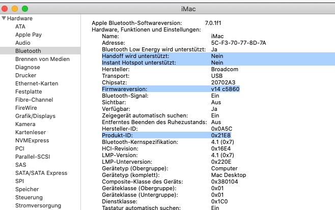

xtraa Posted November 6, 2019 Share Posted November 6, 2019 (edited) Strange... the firmware is updated, but I still have no Handoff or Instant Hotspot. - my BT device is supported according to Rehabmans readme - dropped kexts BrcmFirmwareData and BrcmPatchRAM3 in /Others - applied Handoff-Patch in cfg plist as shown in Rehabman's readme - USB ports are fine, like sorted and working - cat /var/log/system.log | grep -i brcm[fp] gives no errors But my hackintosh still says nein and nein Hmm, I think I am missing something... Edited November 6, 2019 by xtraa Link to comment Share on other sites More sharing options...
k0nrad Posted November 7, 2019 Share Posted November 7, 2019 (edited) 8 hours ago, xtraa said: - applied Handoff-Patch in cfg plist as shown in Rehabman's readme Instead of this try to use BT4LEContinuityFixup. Edited November 7, 2019 by k0nrad Link to comment Share on other sites More sharing options...
xtraa Posted November 7, 2019 Share Posted November 7, 2019 Thank you for the hint! Unfortunately, after installing it (and also disabling the kext-patch in Clover), it still does not work. kextstat shows me that it's loaded, but it still shows it as unsupported. Maybe I need internal WiFi for it to work? Because I'm on a desktop with an ethernet connection only. Link to comment Share on other sites More sharing options...
k0nrad Posted November 7, 2019 Share Posted November 7, 2019 https://support.apple.com/guide/mac-help/mchl732d3c0a/mac Quote To use Handoff, your devices must meet Continuity system requirements. They must also have Wi-Fi, Bluetooth and Handoff turned on in System Preferences (on your Mac) and in Settings (on your iOS and iPadOS devices). You must be signed in with the same Apple ID on all your devices. 1 1 Link to comment Share on other sites More sharing options...

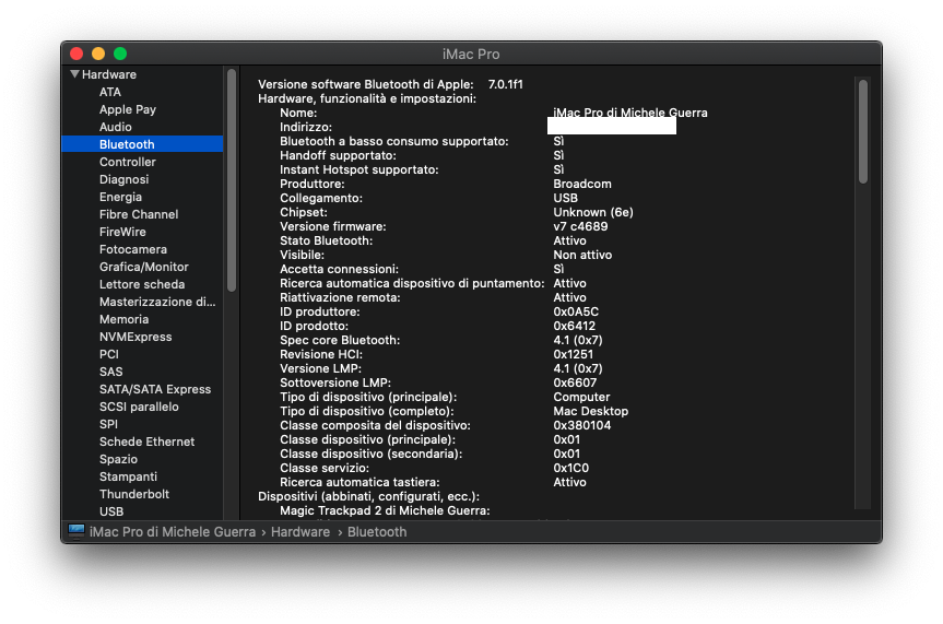

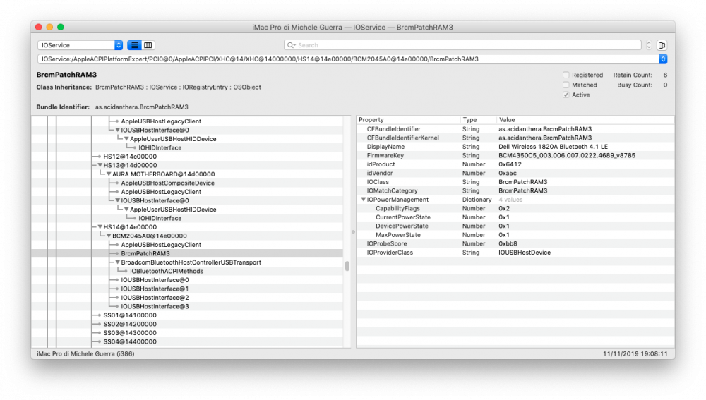

Michelinu Posted November 11, 2019 Share Posted November 11, 2019 (edited) Hi, I'm currently running macOS Catalina 10.15.1. I'm using an Asus ROG Strix Z390-I with DW1820A (model 0VW3T3). Wi-Fi was working OOB, BT didn't. By installing BrcmFirmwareData+BrcmBluetoothInjector+BrcmPatchRAM3 kexts, now BT works but only for Continuity/Handoff. Other BT devices are detected but it doesn't connect. This I what happens during boot. I also noticed that if I boot Windows and then I reboot in macOS, firmware is upgraded to 5799 and BT works. Can you help me? Thank you Edited November 11, 2019 by Michelinu Link to comment Share on other sites More sharing options...
