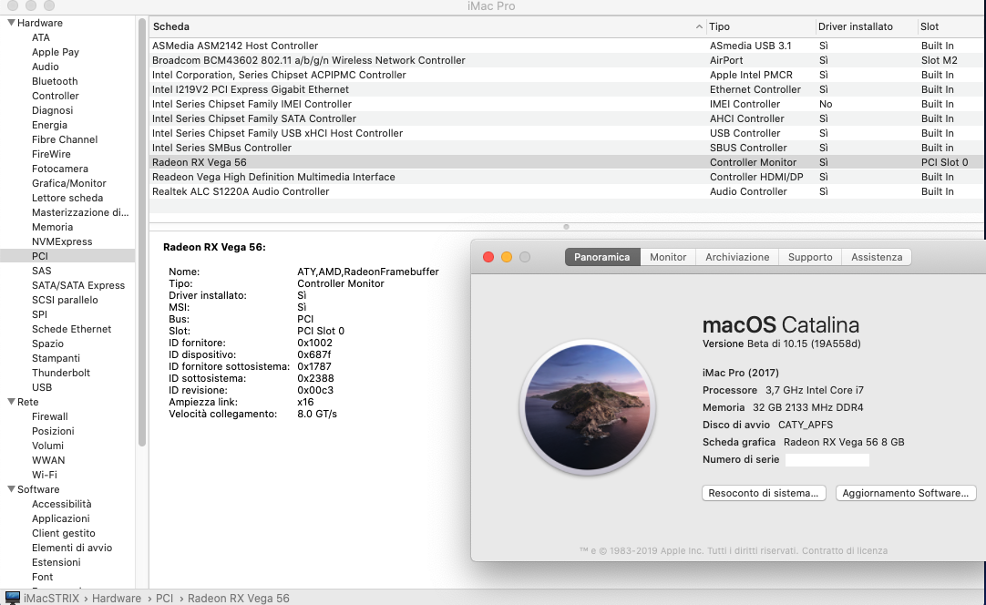

Loloflat6 Posted August 29, 2019 Share Posted August 29, 2019 My First Install with MacPro 7,1 2019 SMBIOS : I installed macOS Catalina DP6, about 17 minutes and all seems OK. I'will try macOS Catalina DP7 later... 2 Link to comment Share on other sites More sharing options...

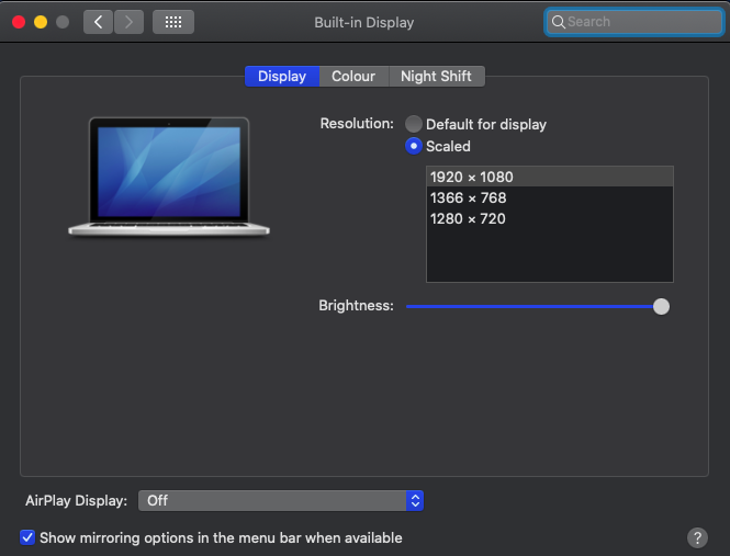

chris1111 Posted August 30, 2019 Share Posted August 30, 2019 (edited) Ok now for the Old Nvidia and Intel HD 3000 both fix are included in the same package and for Catalina 10.15, note that the repos has change of name and links New link to the Repos ➤ Legacy Video patch GeForce 210 Intel HD 3000 Edited August 30, 2019 by chris1111 5 Link to comment Share on other sites More sharing options...
Guest ricoc90 Posted August 30, 2019 Share Posted August 30, 2019 @chris1111 how does the HD 3000 perform? I did install Catalina on my mid-2011 macbook pro with the HD 3000 but the performance was really, really bad to the point of not being usable at all Link to comment Share on other sites More sharing options...
chris1111 Posted August 30, 2019 Share Posted August 30, 2019 (edited) 41 minutes ago, ricoc90 said: @chris1111 how does the HD 3000 perform? I did install Catalina on my mid-2011 macbook pro with the HD 3000 but the performance was really, really bad to the point of not being usable at all Works good here , Video Youtube works and QE/CI EDIT** the only things is some graphics glitch aprears some times Try my packages after a fresh Install of BETA7 Edited August 30, 2019 by chris1111 2 Link to comment Share on other sites More sharing options...

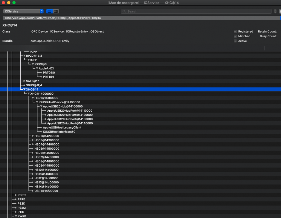

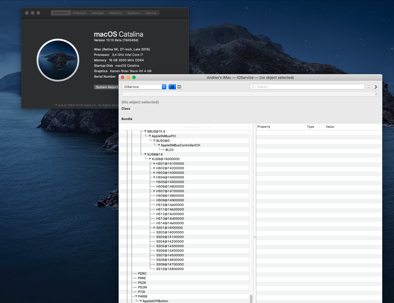

oscarbg Posted September 5, 2019 Share Posted September 5, 2019 Hi, anyone can share the latest (DP7) USB port limit patches? I used the ones referenced on first post and doesn't work (seems they are only for DP1?): or anyone on DP7 have it working and it's my problem? Link to comment Share on other sites More sharing options...
Andres ZeroCross Posted September 5, 2019 Share Posted September 5, 2019 1 hour ago, oscarbg said: Hi, anyone can share the latest (DP7) USB port limit patches? I used the ones referenced on first post and doesn't work (seems they are only for DP1?): or anyone on DP7 have it working and it's my problem? DP7 with USB Limit patch Link to comment Share on other sites More sharing options...
MaLd0n Posted September 5, 2019 Share Posted September 5, 2019 2 hours ago, oscarbg said: Hi, anyone can share the latest (DP7) USB port limit patches? I used the ones referenced on first post and doesn't work (seems they are only for DP1?): or anyone on DP7 have it working and it's my problem? same patches <dict> <key>Comment</key> <string>USB Port limit patch #1(credits PMheart)</string> <key>Disabled</key> <false/> <key>Find</key> <data> g/sPDw== </data> <key>InfoPlistPatch</key> <false/> <key>MatchOS</key> <string>10.15.x</string> <key>Name</key> <string>com.apple.iokit.IOUSBHostFamily</string> <key>Replace</key> <data> g/s/Dw== </data> </dict> <dict> <key>Comment</key> <string>USB Port limit patch #2(credits PMheart)</string> <key>Disabled</key> <false/> <key>Find</key> <data> g/kPDw== </data> <key>InfoPlistPatch</key> <false/> <key>MatchOS</key> <string>10.15.x</string> <key>Name</key> <string>com.apple.driver.usb.AppleUSBXHCI</string> <key>Replace</key> <data> g/k/Dw== </data> </dict> 2 Link to comment Share on other sites More sharing options...

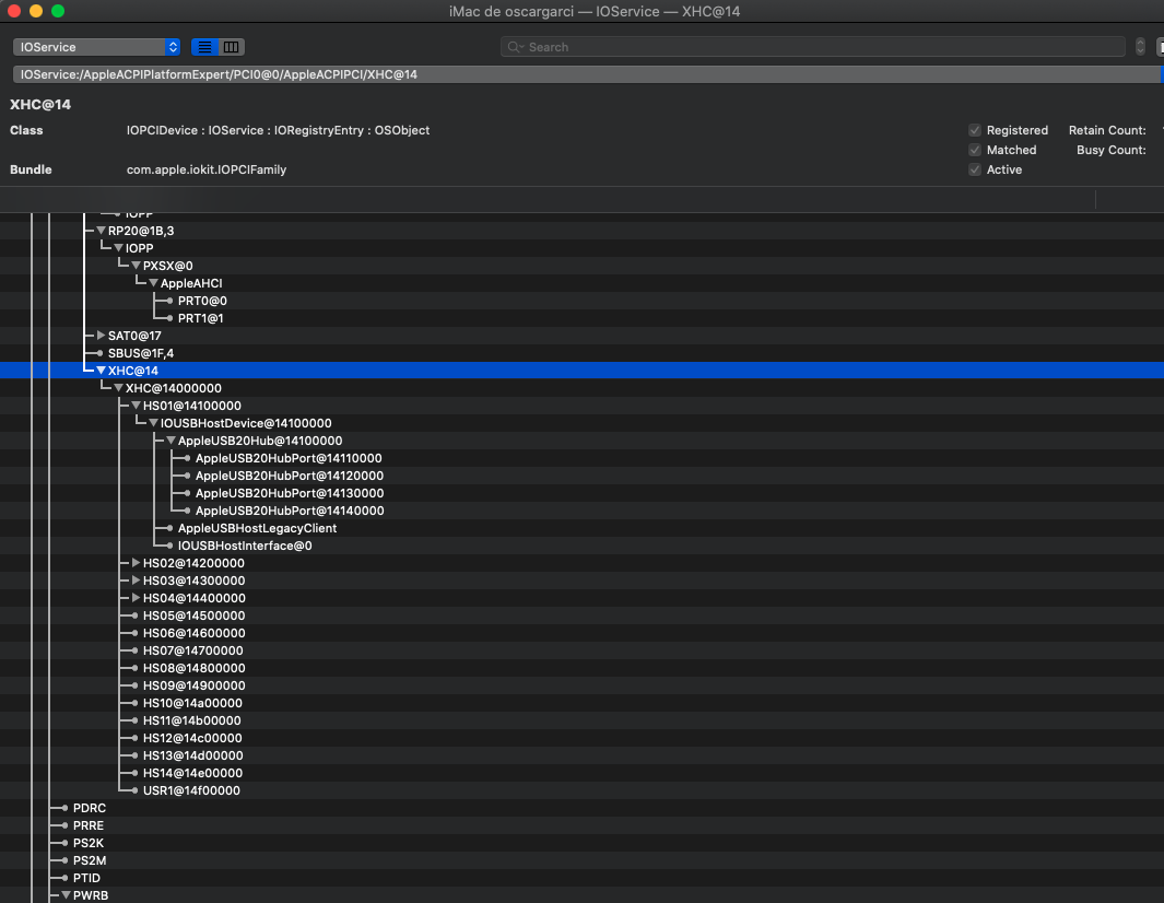

oscarbg Posted September 6, 2019 Share Posted September 6, 2019 23 hours ago, Andres ZeroCross said: DP7 with USB Limit patch Hi.. Thanks MaLd0n and Andres, so it's my problem.. Andres just have same motherboard but my screenshoot of IORegistryExplorer is different: I see XHC instead of XUSB and no SSxxx entries.. other diff is system info : iMac (27 pulgadas, finales de 2013) and also have USBInjectAll loaded (kext stat): 0x4000 com.rehabman.driver.USBInjectAll (0.7.1) some help? Link to comment Share on other sites More sharing options...
oscarbg Posted September 6, 2019 Share Posted September 6, 2019 sorry guys, yes patches work.. seems I had an only 10.13.x patch lying around in plist being applied unconditionally which searched for same key.. Link to comment Share on other sites More sharing options...
