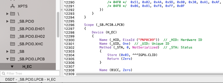

Guest ricoc90 Posted August 1, 2019 Share Posted August 1, 2019 (edited) 19 minutes ago, MaLd0n said: desktop, have only EC0 in some asus mobos and others, we can use it without any problem into_all device label EC0 set_label begin EC end my Dell Precision T1700 has H_EC, so for me that would be a problem Edited August 1, 2019 by ricoc90 Link to comment Share on other sites More sharing options...

Guest ricoc90 Posted August 1, 2019 Share Posted August 1, 2019 2 minutes ago, Andres ZeroCross said: No need to rename thing,, just add EC device if you don't have EC device in your system SSDT-EC.dsl from here https://github.com/acidanthera/OpenCorePkg/blob/master/Docs/AcpiSamples/SSDT-EC.dsl can be a sampel. If you used OpenCore bootloader then Renaming ACPI will affect in other OS too. Just add EC device with If _OSI method. No need combination of manual renaming, patch all OEM SSDT from Config.plist I renamed H_EC to EC through the Clover patch mentioned by MaLd0n a couple of posts earlier. I was just mentioning that his patch.txt for maciasl won't work in my case (simply because mine is not EC0 but H_EC) 1 minute ago, Andres ZeroCross said: Remove all patch about renaming acpi of EC or H_EC,, revert all ACPI renaming in ACPI DSDT, Just put this to EFI/CLOVER/ACPI/Patched or EFI/OC/ACPI. Problem will be solved,, with if _OSI of Darwin, then if you used OpenCore bootloader EC device will not be loaded. So no worry. Renaming ACPI with OpenCore bootloader without if _OSI specific then it will appear in your device manager. SSDT-ECUSBX.aml I'l look into it later, thanks Link to comment Share on other sites More sharing options...
Andres ZeroCross Posted August 1, 2019 Share Posted August 1, 2019 1 minute ago, ricoc90 said: I renamed H_EC to EC through the Clover patch mentioned by MaLd0n a couple of posts earlier. I was just mentioning that his patch.txt for maciasl won't work in my case (simply because mine is not EC0 but H_EC) No need to rename your DSDT device from Config.plist. Just use that SSDT. It will fix it Link to comment Share on other sites More sharing options...

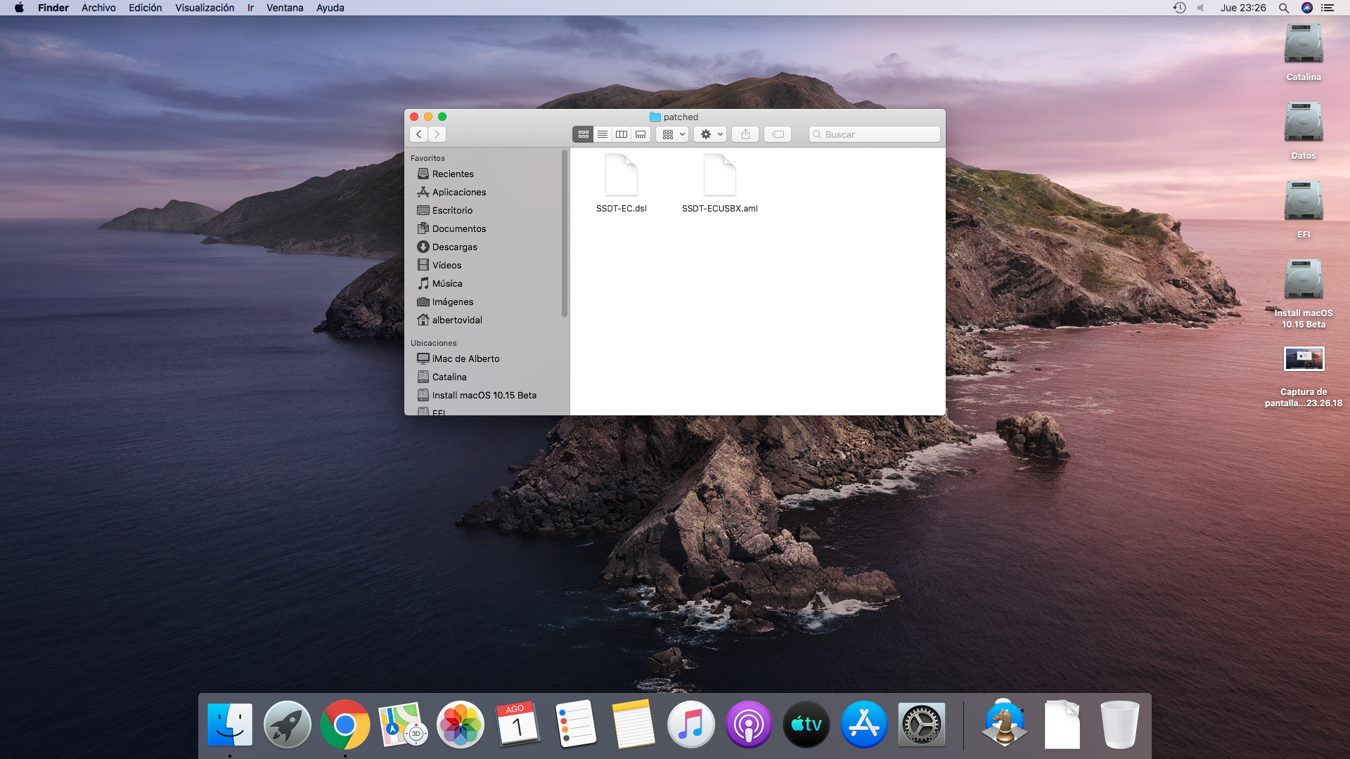

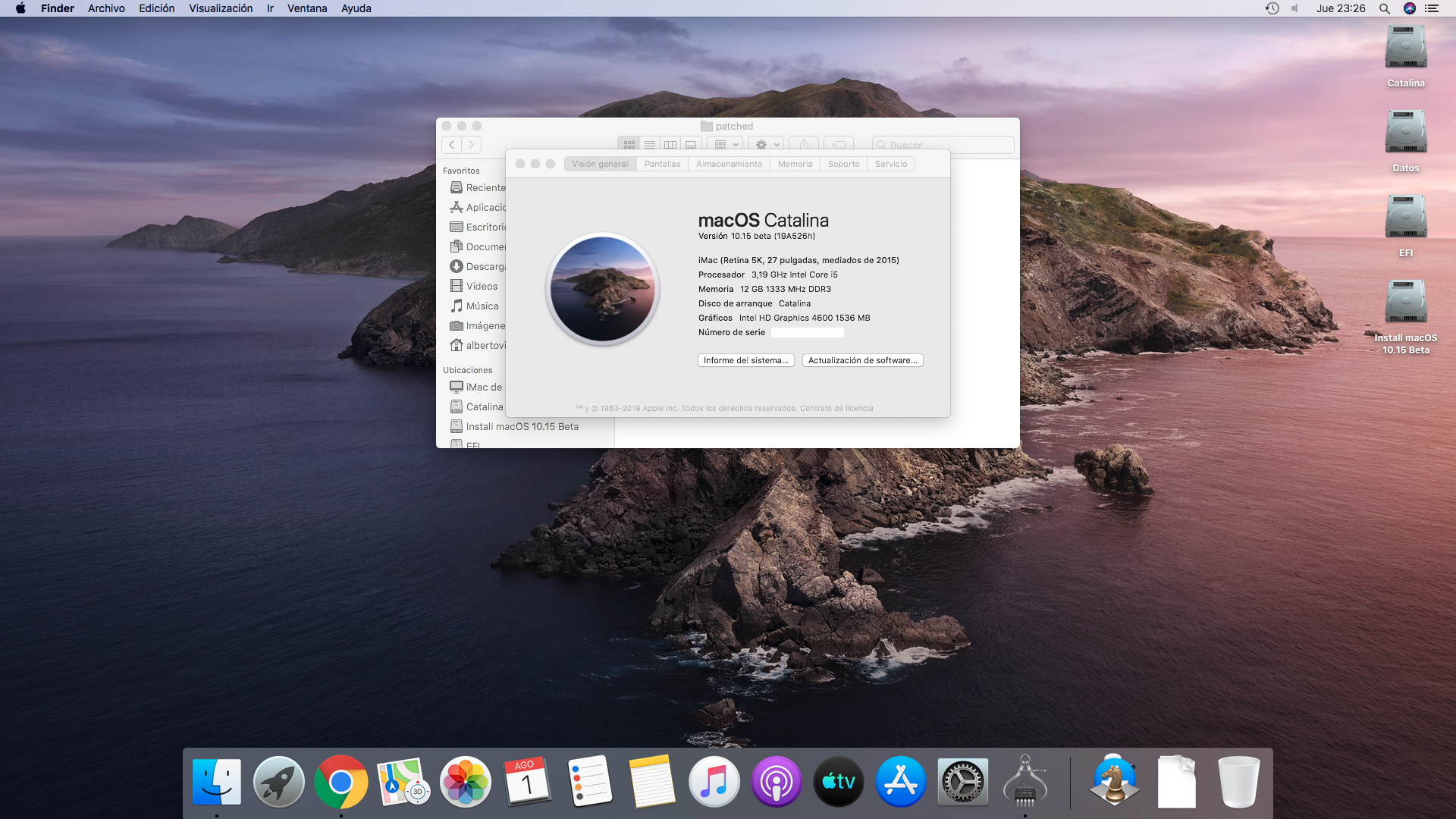

asdesoso Posted August 1, 2019 Share Posted August 1, 2019 1 hour ago, Andres ZeroCross said: Remove all patch about renaming acpi of EC or H_EC,, revert all ACPI renaming in ACPI DSDT, Just put this to EFI/CLOVER/ACPI/Patched or EFI/OC/ACPI. Problem will be solved,, with if _OSI of Darwin, then if you used OpenCore bootloader and boot to Windoes then EC device from this custom SSDT will not be loaded. So no worry. Renaming ACPI with OpenCore bootloader without if _OSI specific then it will appear in your device manager. I attached a sampel SSDT-ECUSBX.aml Copied the above .aml and previous .dst files to /EFI/CLOVER/ACPI/patched and finally my Desktop build with Catalina DP5 boot-up again. Thanks for all people that helped me. Here are some pictures. Link to comment Share on other sites More sharing options...
Andres ZeroCross Posted August 1, 2019 Share Posted August 1, 2019 (edited) 1 minute ago, asdesoso said: Copied the above .aml and previous .dst files to /EFI/CLOVER/ACPI/patched and finally my Desktop build with Catalina DP5 boot-up again. Thanks for all people that helped me. Here are some pictures. Congratulations then Just remove SSDT-EC.dsl., you don't need DSL files ini ACPI It's not used Edited August 1, 2019 by Andres ZeroCross 1 Link to comment Share on other sites More sharing options...
