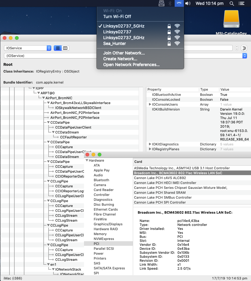

onemanOSX Posted July 19, 2019 Share Posted July 19, 2019 (edited) On beta 4, Broadcom BCM943602CS pcie wireless card cannot connect to network with or without Airportbrcmfixup. It is working oob in Mojave. https://imgur.com/KLgLl1s Edited July 19, 2019 by onemanOSX 1 Link to comment Share on other sites More sharing options...

igorw Posted July 19, 2019 Share Posted July 19, 2019 18 minutes ago, onemanOSX said: On beta 4, Broadcom BCM943602CS pcie wireless card cannot connect to network with or without Airportbrcmfixup. It is working oob in Mojave. https://imgur.com/KLgLl1s I have the very same one and it works without a problem, no Kext needed and no Clover fixes. My SMBIOS is 15,1, I'm not sure if it plays a role. Link to comment Share on other sites More sharing options...
onemanOSX Posted July 19, 2019 Share Posted July 19, 2019 (edited) 40 minutes ago, igorw said: no Clover fixes Perhaps I could try deleting my device-id injection. Thanks for the heads up! @igorw That worked! Deleted my device-id injection. SMBios doesnt matter in this case. Thanks again! Edited July 19, 2019 by onemanOSX 1 Link to comment Share on other sites More sharing options...
