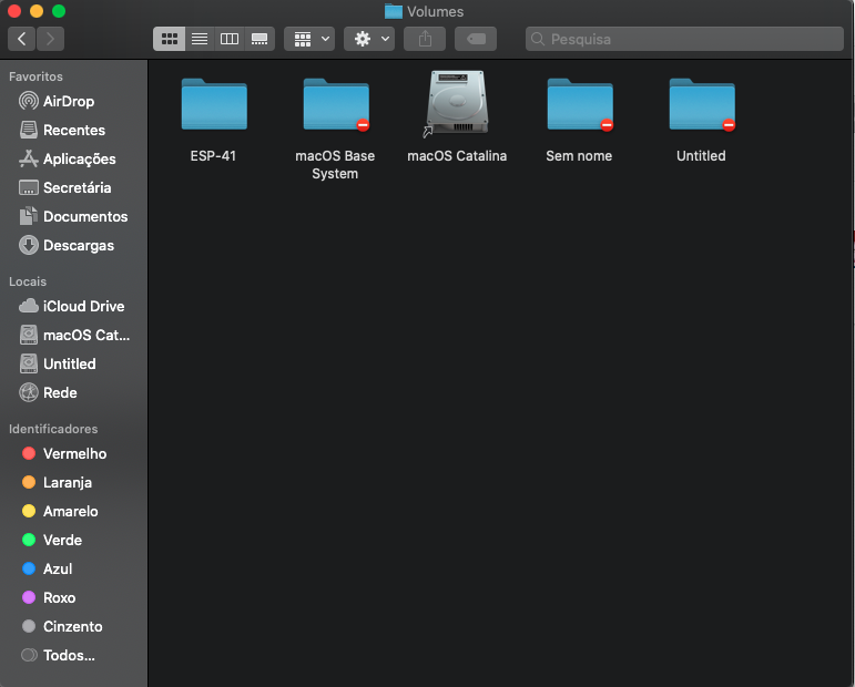

hi @chris1111, I did that and I don't have EFI Backups or EFi RootDir... in my first macOS Catalina, and now in a new install in a new partition of my ssd... but the result is the same clover don't install... grrrrr
Thanks you

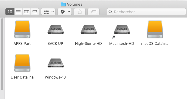

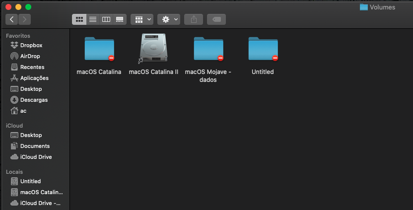

See on Volumes folder and post Picture of that
that picture was in the new partition, and I wasn't able to delete it, and now I'm in my first macOS Catalina and in this one I don't have one named ESP-41... sorry for my mistake...
Ok do you try install Clover now ?
And this is not normal you have a Lock folder and its suppose to a DISK, like this
not a folder like you Your Issue is from that and maybe its relate to bad interpreting Clover NVRAM on Catalina but I am not sure
Edited by chris1111
Yes and one more time it didn't install...
The strange thing is that in my second partition I can't install clover too, and I can't delete the ESP-41...
Thanks anyway...

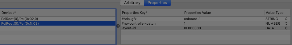

Lenovo IdeaPad 720s Smoothes, fastest and moust easy update in my time since i have been in a hackintosh community in a decade!
Have been using FinalCut Pro X, Logic X pro with non facing broplems so far. Audio, ALC236, Wifi (Broadcom BCM94352Z), Hdmi Out (with sound), TRackPad VoodooIC2 v.2.2. etc.
macOS 10.15 (19A471t) Is extrmly fast with Samsung 970 EVO SSD NVme! And Catalina boot time is around 4sec.
which is about 70 percent faster than Mojove.
I made another partition and made a clean installation. Installation. was about 50% faster than mojave.
I’m using ALC 236 Devices patch PciRoot(0)/Pci(0x1f,03)
                                                    #hda-gfx.     onboard-1
                                                    #no-controller-patch.            1
                                                    layout-id.       0F000000
Bluetooth is only what is not working at the moment! have not had much time to try.
Clover 4945.
I will report if there are any problems ahead...

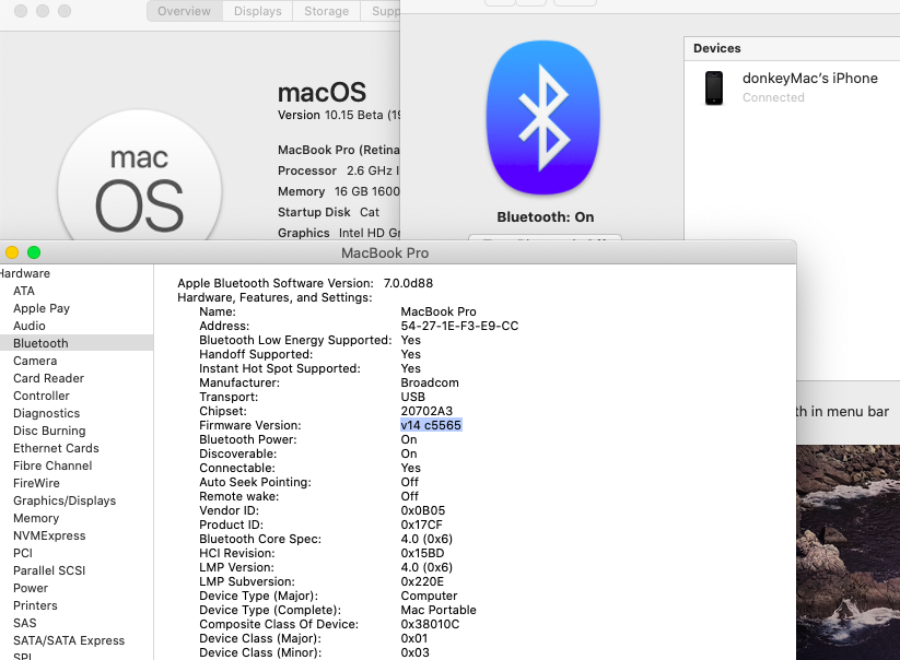

3 hours ago, Gigamaxx said:
I'm using the Mojave 14.4 bluetooth kexts and have got it working.
Bluetooth kexts fix.zip
Should I apply these 2 kexts with Kext Utility or put them in Clover/EFI/Clover/kexts/other (or 10.14 and 10.15 respectively) ?
Neither worked for my Z87 hackintosh. In "About This Mac"/Bluetooth no change of firmware version yet !
[Edit]
Very strange it worked in Z97 hackintosh at 10.14.6 beta and 10.15 beta with these 2 kets from 10.14.4 in Clover/EFI/Clover/kexts/10.14 and 10.15 respectively.
Trying to figure out why it did not work in Z87 hackintosh yet !
Edited by jsl2000
[Edit]
I replaced them in S/L/E and then ran kext utility.   I posted the originals from Catalina in case they don't work and some one needs a backup..

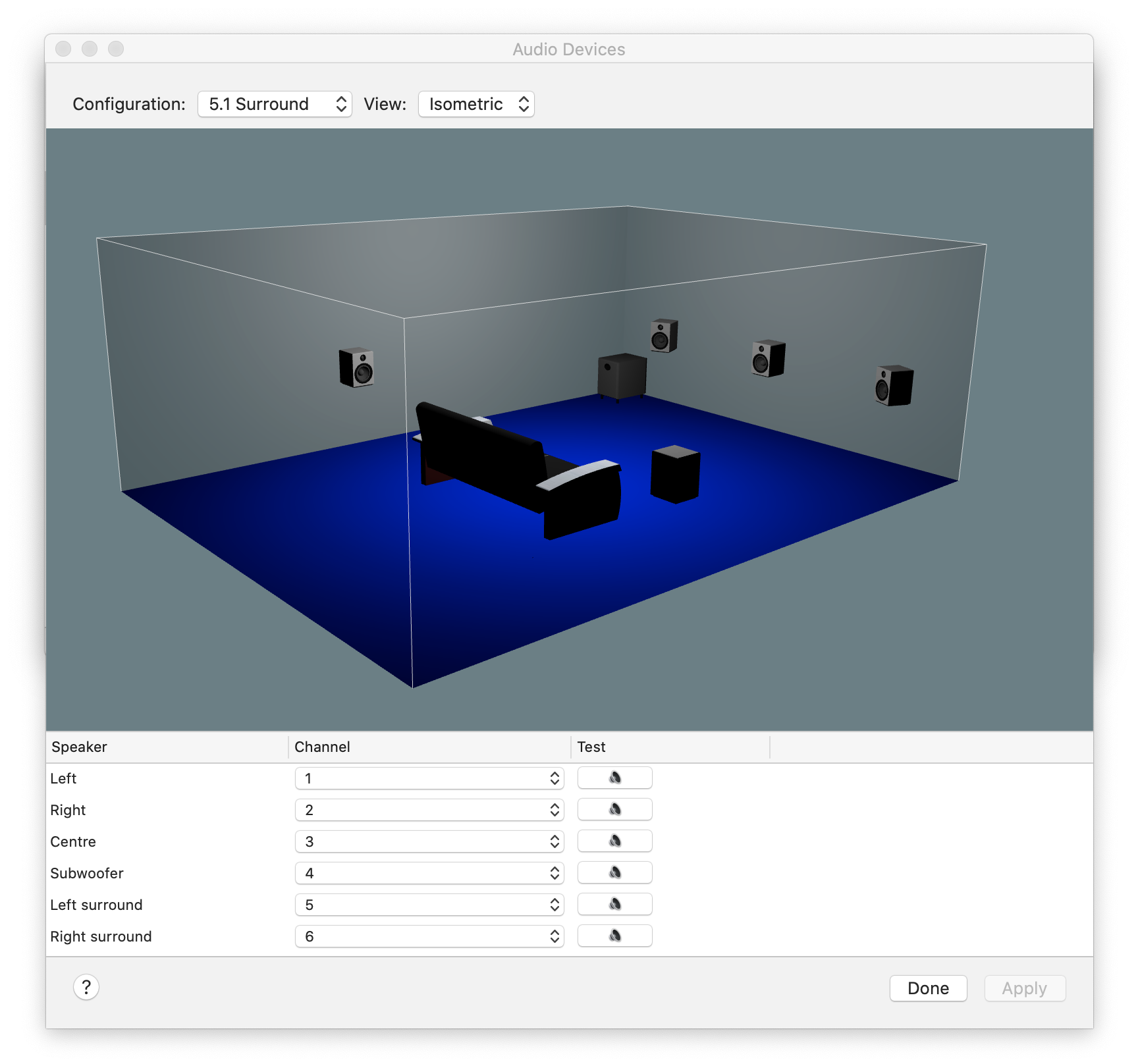

After some absence, I have not read all posts yet. I am not sure if anyone has noticed that the Audio-MIDI-Setup tool contains some visual updates. This room can also be rotated!
So far, it works very well and fast, only Safari sometimes does not work anymore.

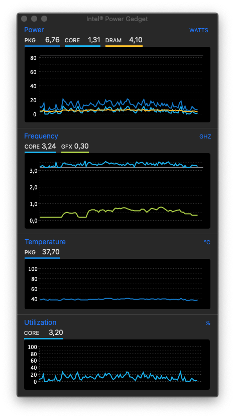

Fresh install and everything is working, sort of.

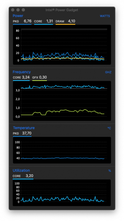

Something is wrong with the frequency. It's up high all time. the other thing I have problem with is USB are all dead after wake.
Anyone have a clue why?
Tnx.
