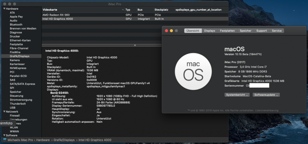

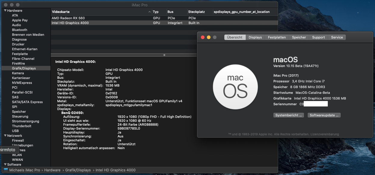

Rocky12 Posted June 8, 2019 Share Posted June 8, 2019 (edited) On 6/4/2019 at 1:40 PM, PPCnostalgic said: Up and running on this very old HP Z400 (signature). Note that I'm using Mac Pro 5,1 mid 2010 SMBIOS, ;-) is it possible to shere your EFI folder from macOS Catalina Edited June 8, 2019 by Rockey12 Link to comment Share on other sites More sharing options...

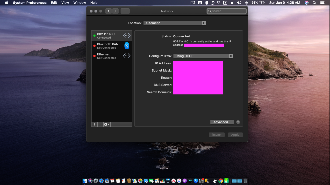

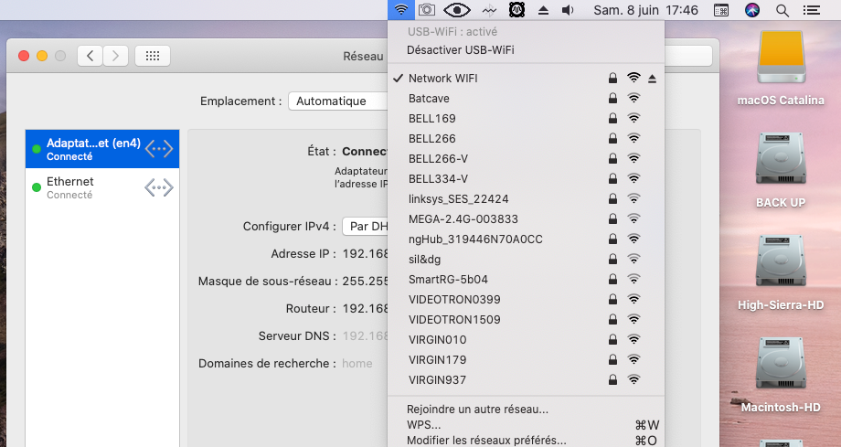

chris1111 Posted June 8, 2019 Share Posted June 8, 2019 (edited) 1 hour ago, hohoho said: i found this. the app here is the same as what TP-Link has on their website that i was using in Mojave and the app in this link is working in Catalina --- https://github.com/chris1111/Wireless-USB-Adapter-Clover/releases/tag/V7 Confirm its work for my EDIMAX EW-7722UTn V2 AND EDIMAX NANO N150 But my Installer need to be more adapting for this Beta 10.15 This one also work ➔ Wireless USB Adapter Edited June 8, 2019 by chris1111 2 Link to comment Share on other sites More sharing options...

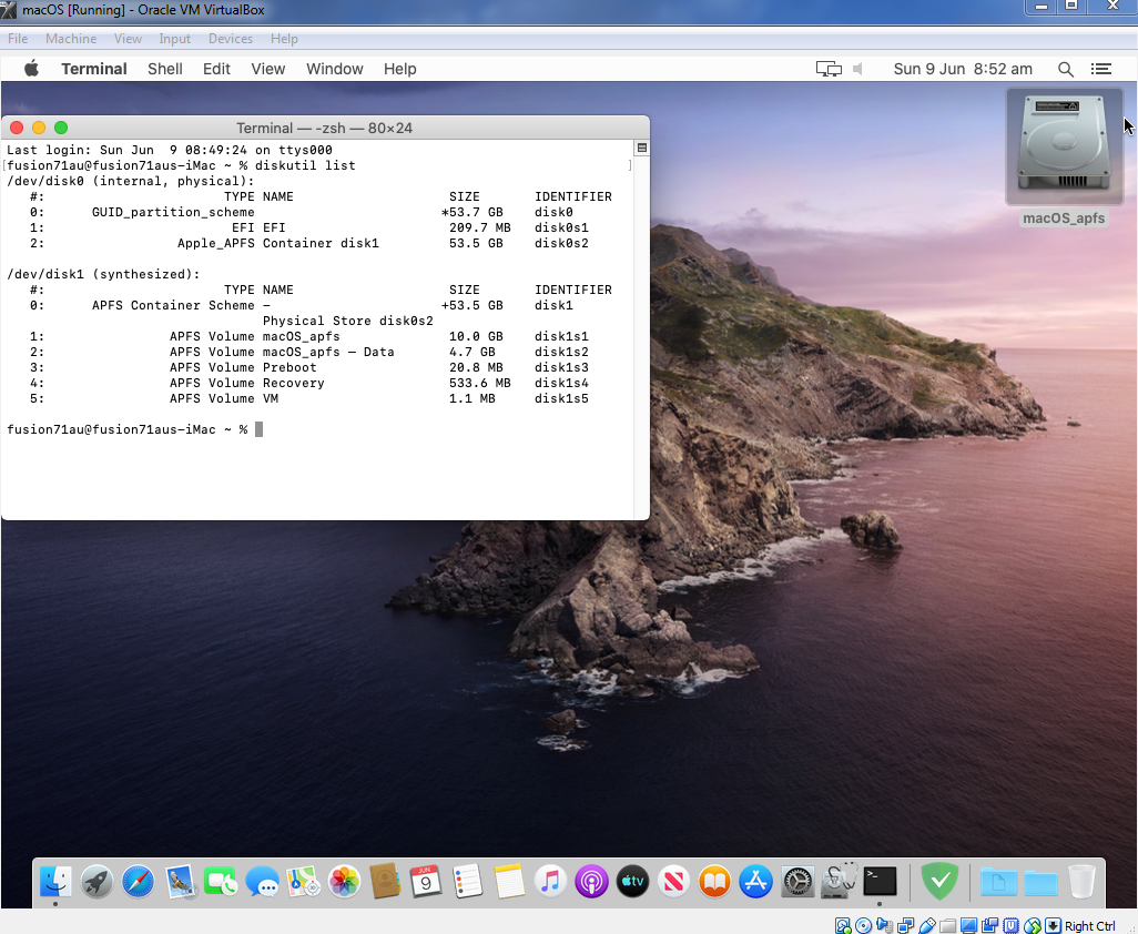

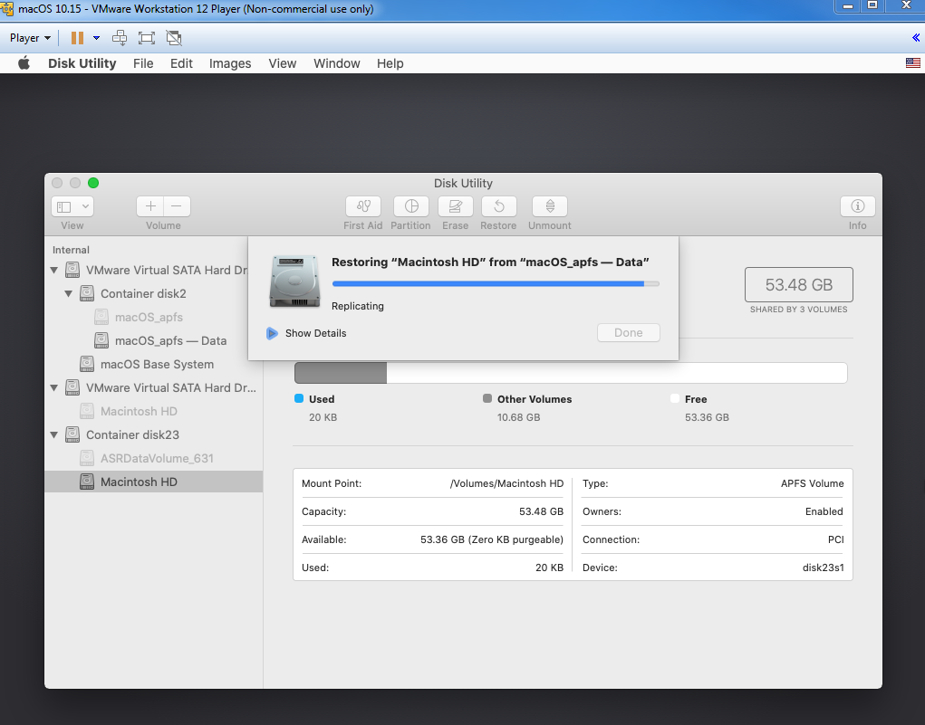

fusion71au Posted June 8, 2019 Share Posted June 8, 2019 Hi Guys, Just a quick heads up on how to clone your macOS Catalina installs with Disk Utility. Pre-requisites 1. Catalina version of Disk Utility eg on your installer USB or separate Recovery/BaseSystem Partition 2. Target HD apfs partition size the same or larger than the original source Procedure 1. First boot to your catalina installer USB or Recovery/BaseSystem Partition 2. Erase the target HD, formatting it to the apfs file system 3. Click the target partition and choose the restore button on top. You can choose either the original catalina or catalina--data partition as the source ---> when to process is complete, both volumes will be cloned to the target. Result... 1 Link to comment Share on other sites More sharing options...
surfinchina Posted June 8, 2019 Share Posted June 8, 2019 3 hours ago, hohoho said: i found this. the app here is the same as what TP-Link has on their website that i was using in Mojave and the app in this link is working in Catalina --- https://github.com/chris1111/Wireless-USB-Adapter-Clover/releases/tag/V7 Worked for my TP link T2U nano as well, even though it's not on the supported list. Thanks! 1 hour ago, chris1111 said: Confirm its work for my EDIMAX EW-7722UTn V2 AND EDIMAX NANO N150 But my Installer need to be more adapting for this Beta 10.15 And working on my TP Archer T2U nano. Thanks Chris You could put that wifi adapter on the supported list. If you like. 1 Link to comment Share on other sites More sharing options...
chris1111 Posted June 9, 2019 Share Posted June 9, 2019 27 minutes ago, surfinchina said: Worked for my TP link T2U nano as well, even though it's not on the supported list. Thanks! And working on my TP Archer T2U nano. Thanks Chris You could put that wifi adapter on the supported list. If you like. Thank you Verry much I wii ad in next release Link to comment Share on other sites More sharing options...
