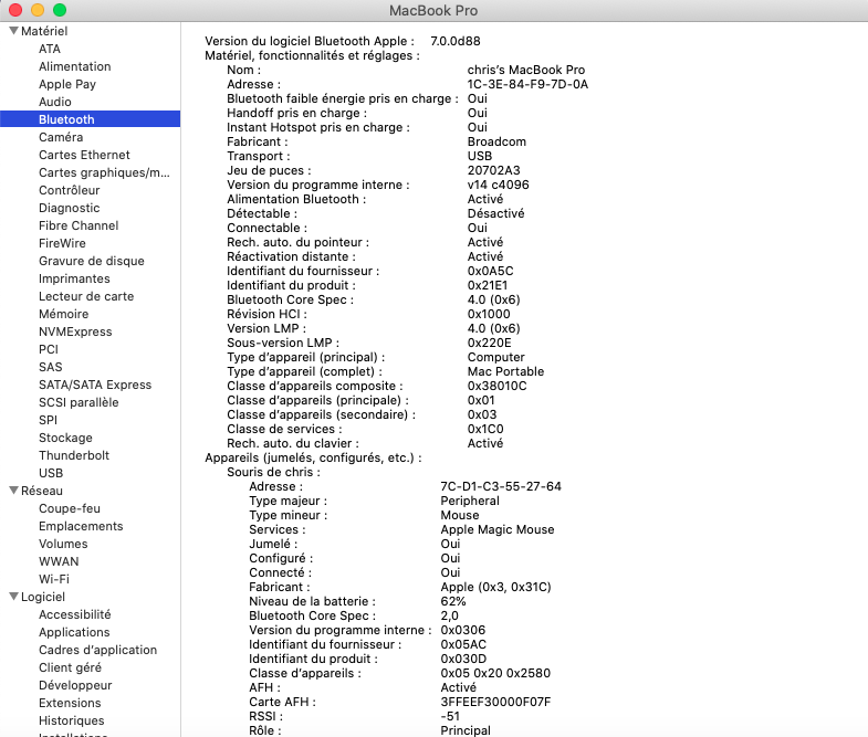

According to RehabMan's ReadMe for BrcmPatchRAM, if you see version 4096 in System Info, your BT will NOT work.   Your's is 4096.  It looks like it works but it is the wrong firmware version.  Mine is version 5668.  Here's what he says:
Quote
Troubleshooting
After installing BrcmPatchRAM, even though your Bluetooth icon may show up, it could be that the firmware has not been properly updated.
Verify the firmware is updated by going to System Information and check the Bluetooth firmware version number under the Bluetooth information panel.
If the version number is "4096", this means no firmware was updated for your device and it will not work properly.
Verify any errors in the system log by running the following command in the terminal:
    cat /var/log/system.log | grep -i brcm[fp]
Ensure you check only the latest boot messages, as the system.log might go back several days.
I am not use BrcmPatchRAM I use Injector like jsl2000
https://www.insanelymac.com/forum/topic/339035-pre-release-macos-catalina/?page=12&tab=comments#comment-2676644
how can you get 5668?
i'm using injector and got 4096. i can get bt. but it's not properly working. bt tethering or other devices. are your bt working properly?
나의 SM-N960N 의 Tapatalk에서 보냄
53 minutes ago, chris1111 said:
I understand, @chris1111, I'm using the BluetoothInjector too.  Without the injector, we get no BT at all, working or not.  But like RehabMan says, if your BT properties shows version 4096 like your's does, it will not work properly.
I'm getting my BT to work without injection, @Sherlocks, because I keep switching back and forth between Catalina and Mojave and injection works in Mojave.  It's no different than booting from Windows 10 to Catalina.  The firmware is already there when I restart my laptop.  The bottom line is that the BluetoothInjector is only a temporary workaround, at least for the BT chips we have.  Eventually, we will need a working injection kext.  I haven't seen RehabMan around much and he hasn't updated any of his kexts in 2019 to my knowledge.  Hopefully, he or someone with a lot more know-how than me will figure out how to do that.

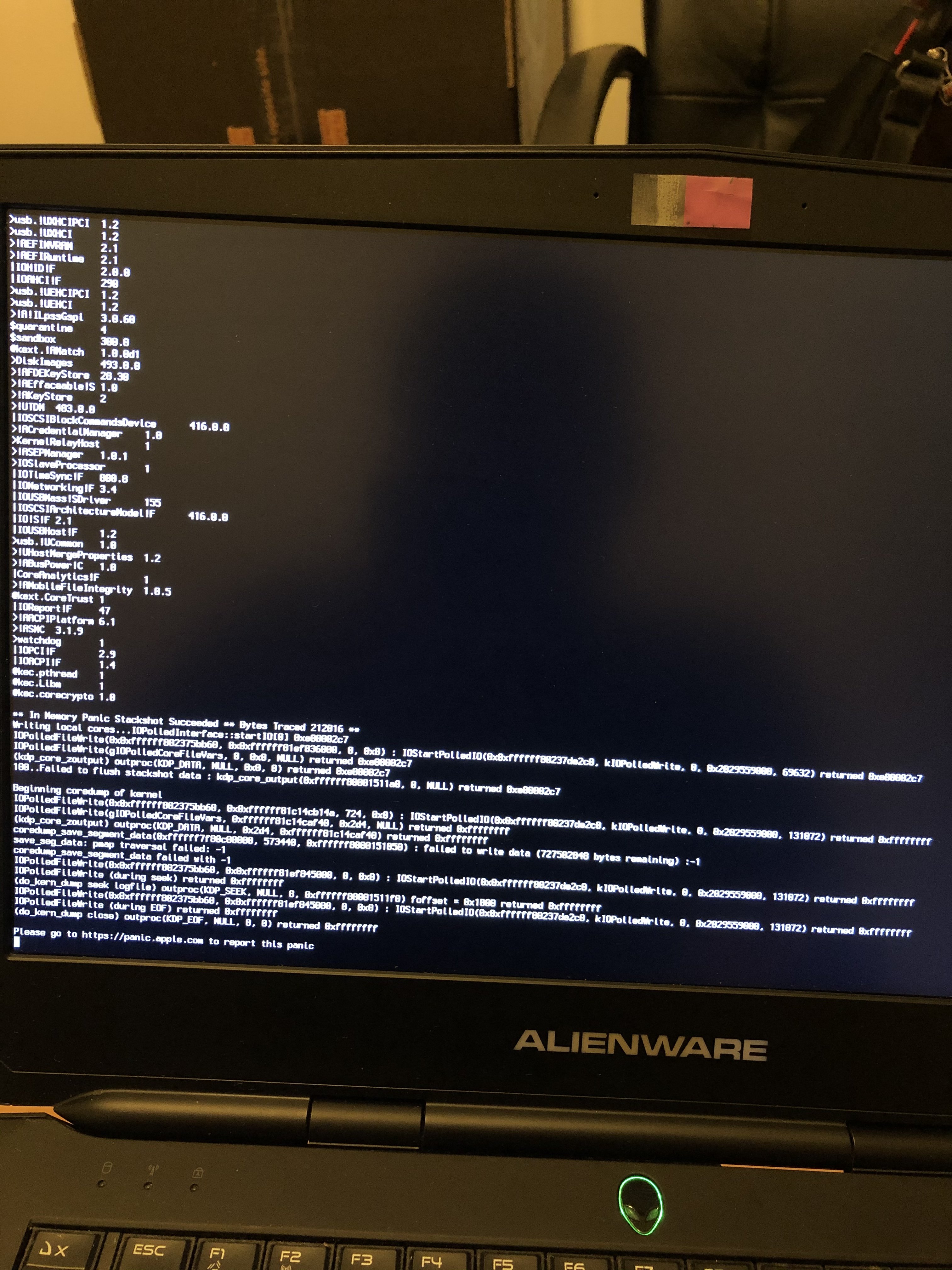

1 hour ago, abdouoi said:
I don’t know what’s causing the issue
Please apply this patch first: https://github.com/acidanthera/bugtracker/issues/305#issuecomment-487549100
And then post your "real" panic log. :)

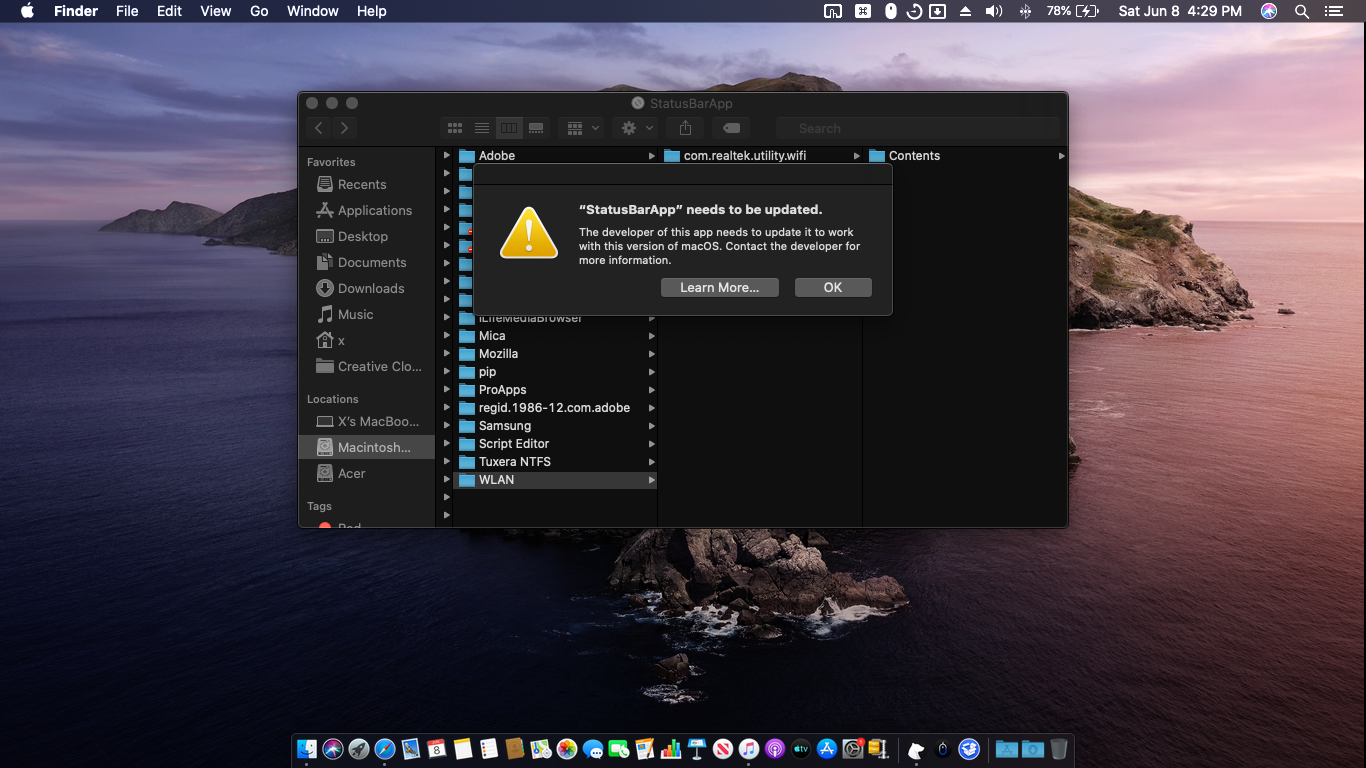

 https://www.tp-link.com/us/support/download/tl-wn823n/#Driver --- can you fix the mojave driver here so that it works in catalina? The usbwifi is working and ON (with light) but i can't connect to the internet.
[update] nevermind, i found a fix for my problem. thanks.
Edited by hohoho
Usbwifi App can't open
