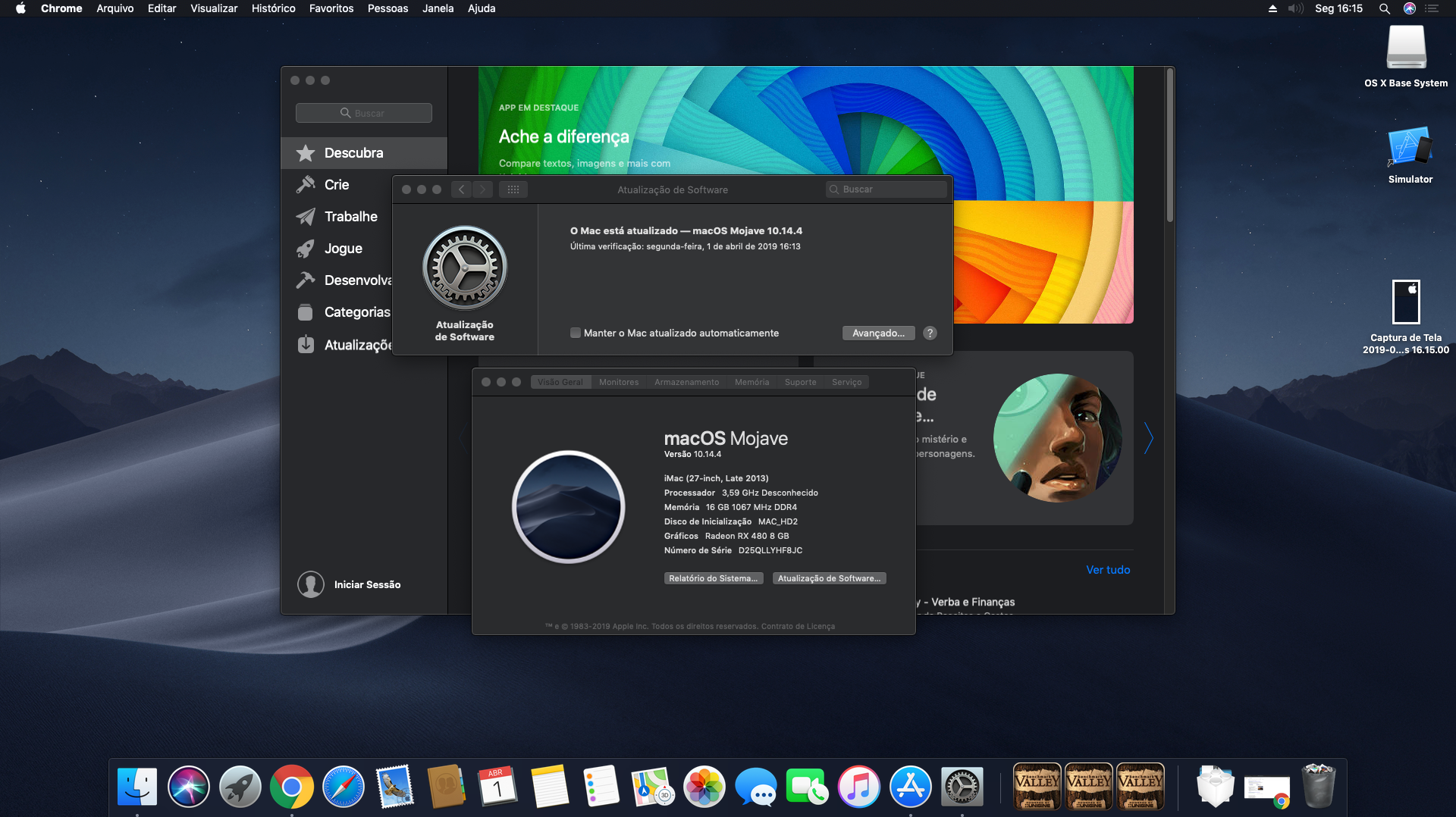

Good job. I was using the previous version of config.plist for 10.14.3 and did the update inside the system for 10.14.4. But before I switched to the newer config.plist and the update occurred without problems.
Edit: I have a Ryzen 1600x, 16Gb, Motheboard ASUS B350-PLUS. RX 480.
Edited by tucano2000
inserted my machine specifications

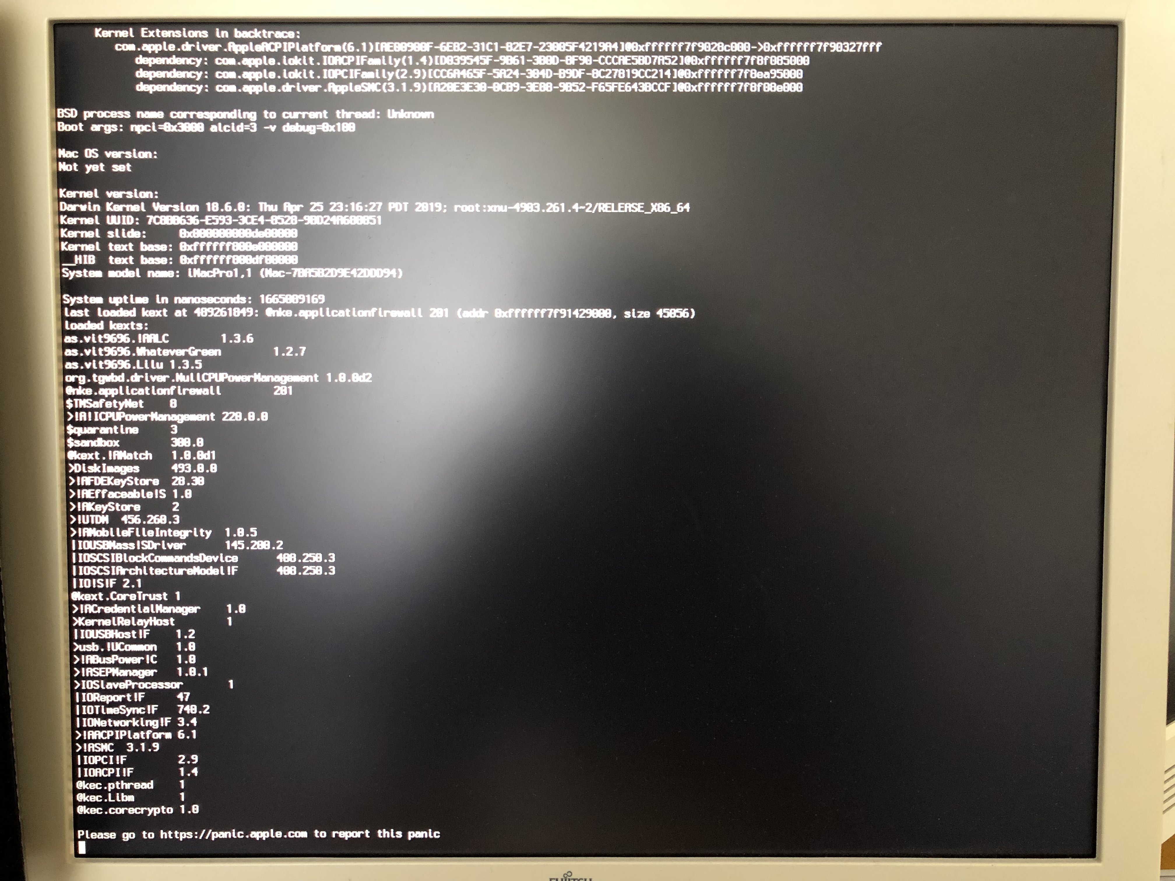

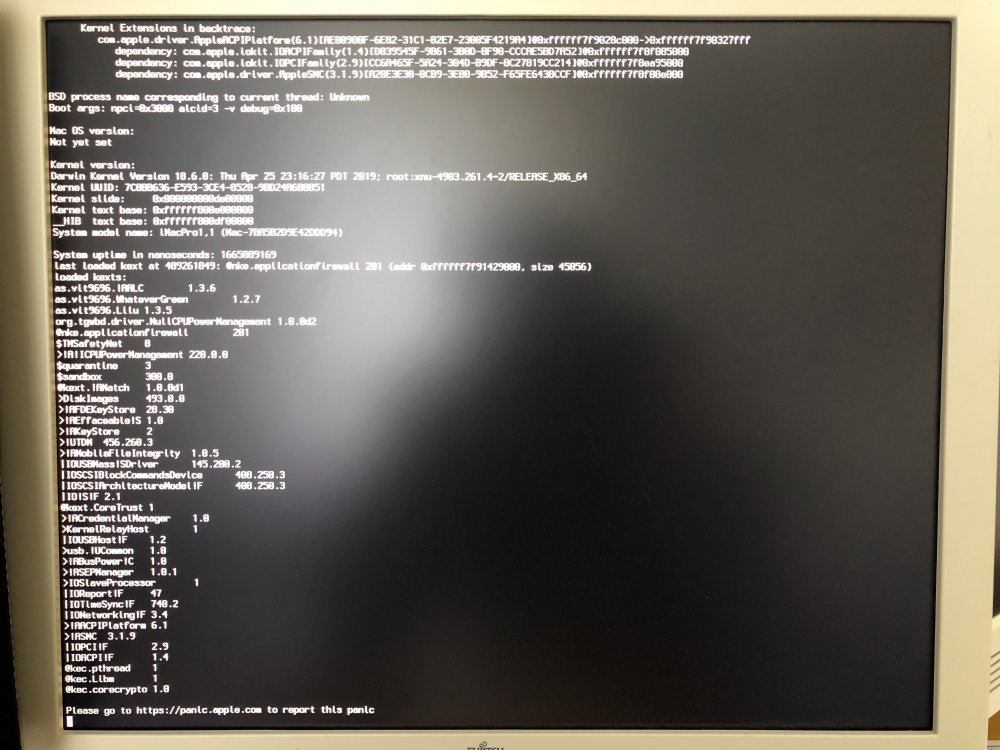

6 hours ago, CEGOCAPO said:
 Instant reboot
that's not instant reboot.. that's kernel panic.. Removing the kernel logging can help us see what's the issue
Quote
   <key>KernelToPatch</key>
            <array>
                <dict>
                    <key>Comment</key>
                    <string>Disable panic kext logging on 10.14 Release kernel (c) vit9696</string>
                    <key>Disabled</key>
                    <false/>
                    <key>Find</key>
                    <data>
                    igKEwHRC
                    </data>
                    <key>Replace</key>
                    <data>
                    igKEwOtC
                    </data>
                </dict>
            </array>
 probably you have an old clover and injection of nullcpupowermanagement  is not working. Happened to me. Make sure you use v4895. I use that one and have no issue.
Edited by AlGrey

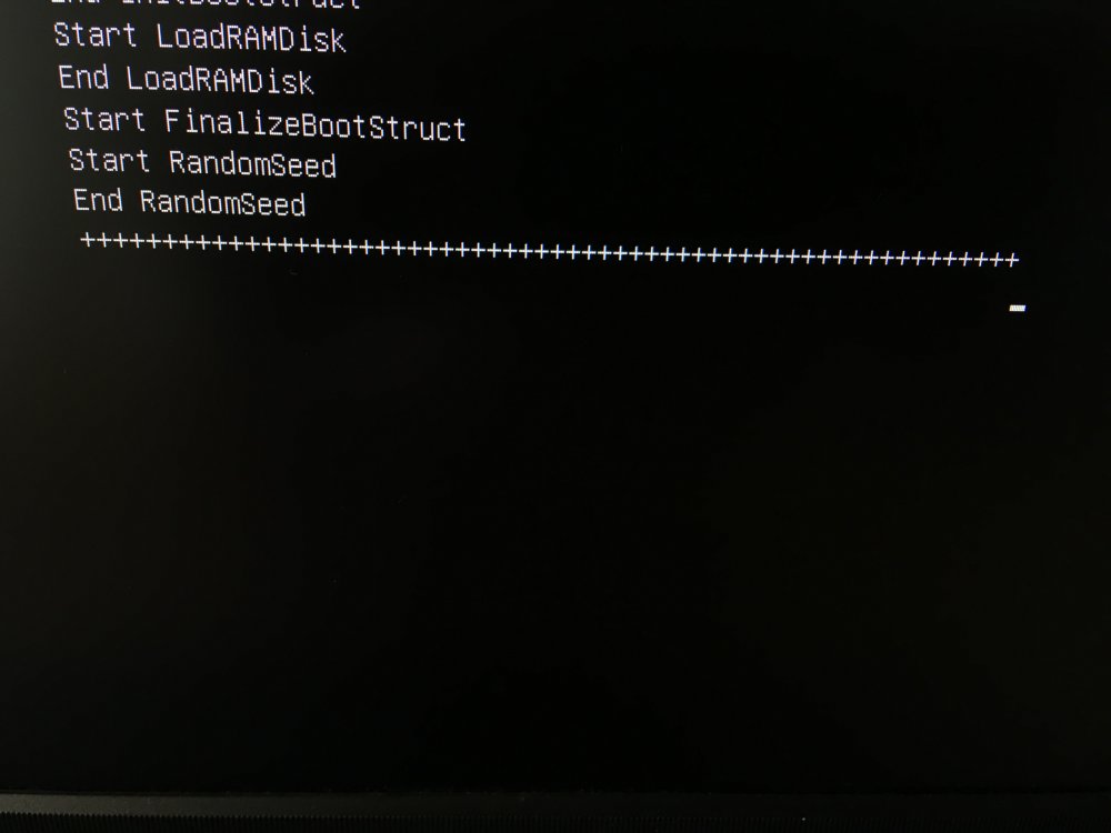

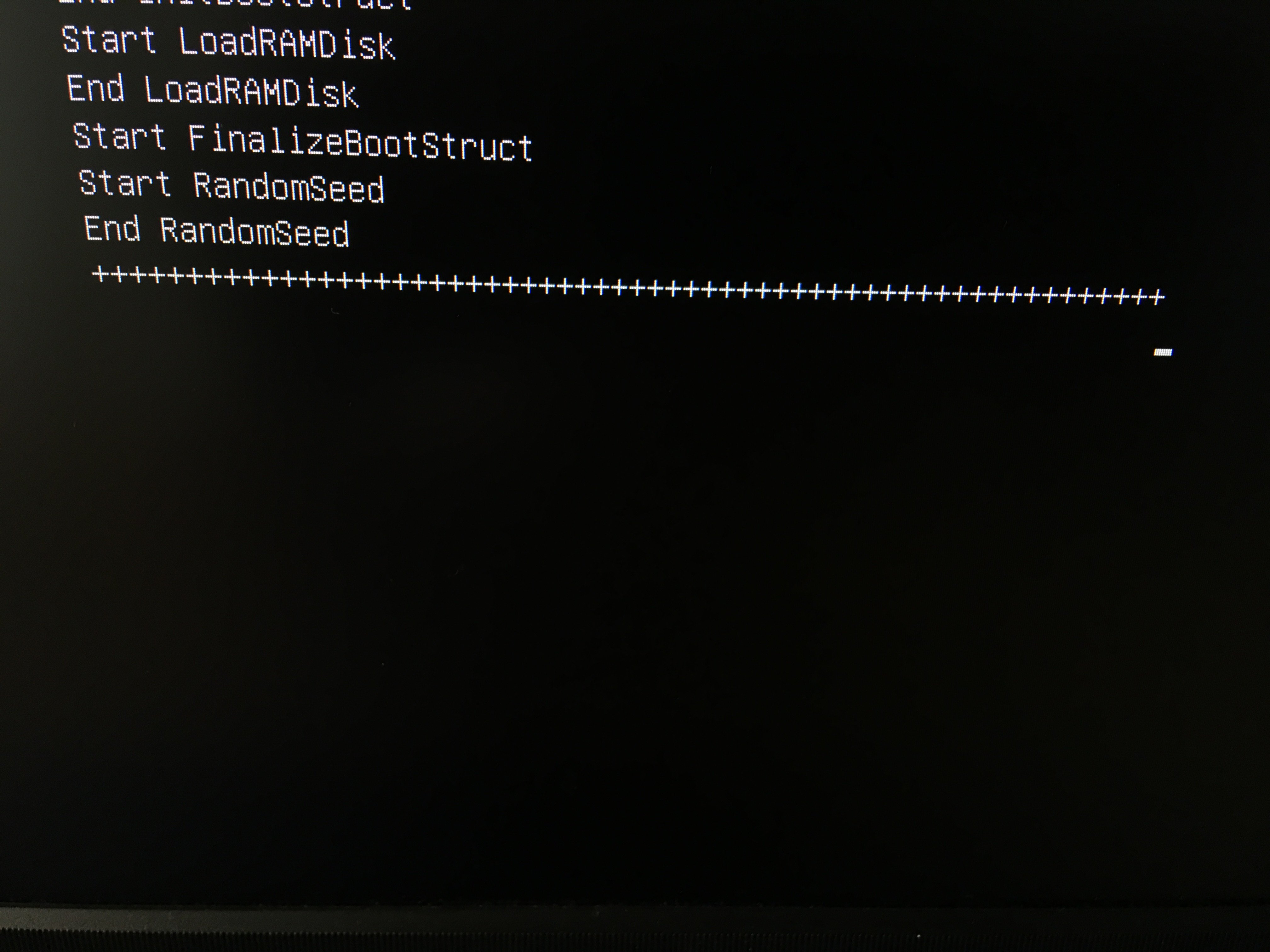

My Ryzen 1700X hackintosh got 10.13.6 working only, freeze after ++++++++++++ at 10.14.4
Edited by jsl2000
2 hours ago, jsl2000 said:
Thanks for your contribution for such an excellent config.plist & patches.plist.
Do you mean there is no need for NullCPUPowerManagement.kext in /EFI/CLOVER/kexts/Other now ?
Which version of 10.14.4 is compatible ? 226?
No, nullcpupowermanagement is mandatory.

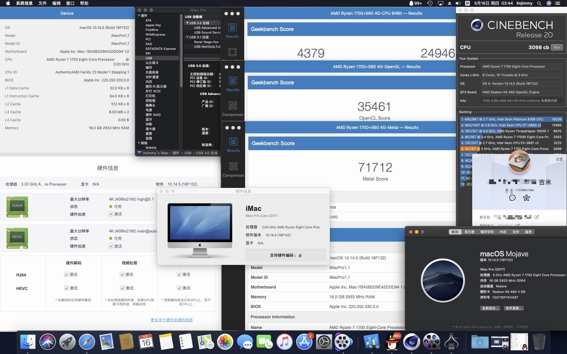

Thanks and it worked at 10.14.4 (18E226) & 10.13.6 in both Ryzen 1700X & FX-6300 hackintoshs !
It also worked at 10.14.1 & 10.14.3 in Ryzen 1700X hackintosh alone.
The only limitation was lack of 32-bit app support.
Hope it can be solved in the near future !
Edited by jsl2000

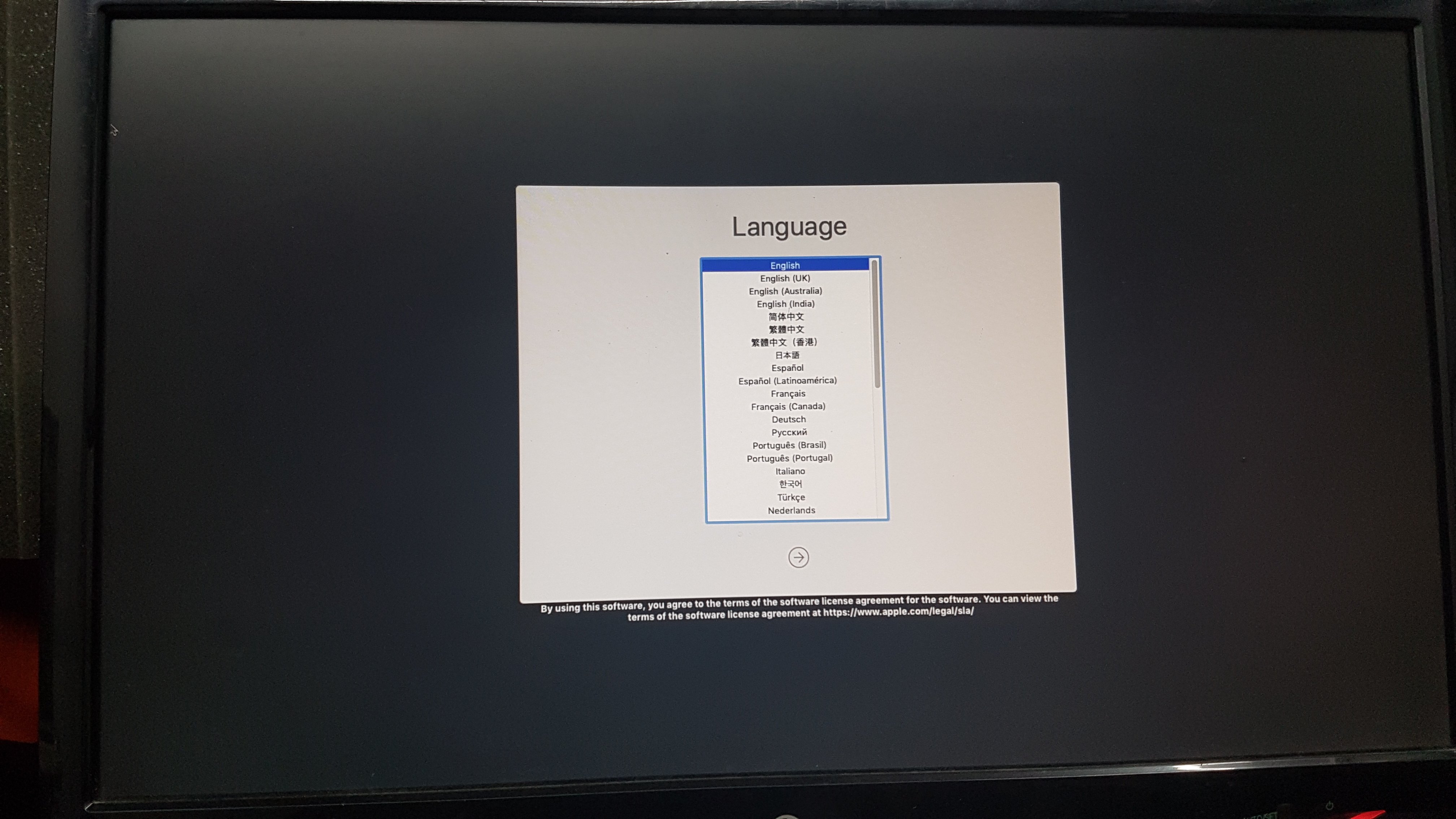

Bought me a Sapphire Nitro+ RX580 graphical card. Works well under High Sierra (changed my framebuffer to Orinoco in Clover, not using Lilo or Whatevergreen).
So I did a clean 10.14.4 installation on a spare HD, but have some issues:
- getting a lot of USB errors during installation (appleusbhostcontroller::hardwareexceptionthreadcallgated) --> when swithing from USB2 to USB3 port during installation I managed to get my USB installer passing on. I've tried all possible combinations of kexts (USBinjectall, GenericUSBXHCI, ...), but did not do the PMHeart changes in Clover. Any help is welcome here, how can this be solved?
- Mojave boots well with the Algrey plist changes (so using vanilla kernel), but after the Analytics screen it crashes and reboots (same as here: https://apple.stackexchange.com/questions/337467/mojave-install-froze-on-analytics-successful-force-reboot-but-did-it-miss-an). Any ideas how to solve this?
thanks!
