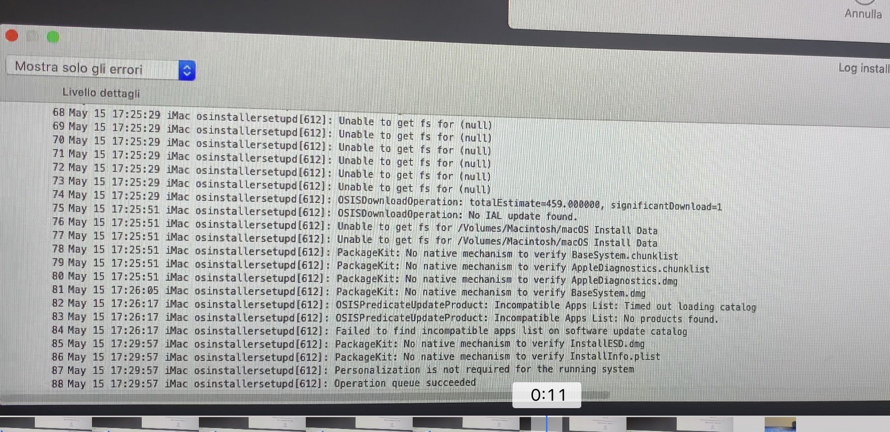

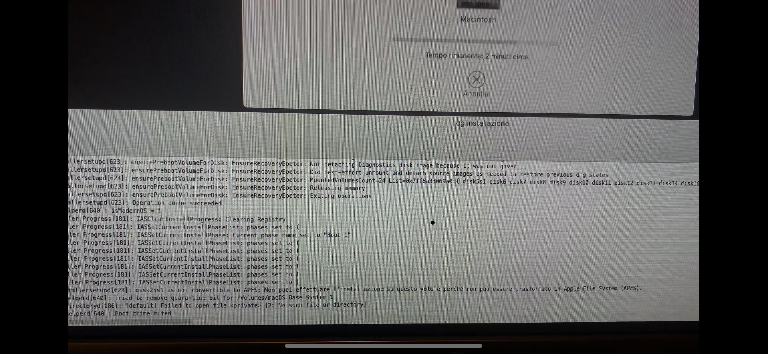

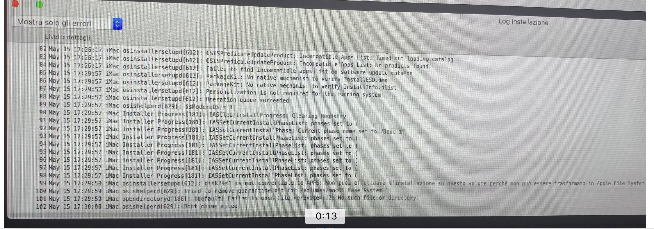

blackwalker Posted May 15, 2019 Share Posted May 15, 2019 Same error but I capture the log and say: “disk25s1 is not convertible to APFS: you can’t install on this volume because can’t be trasformed in Apple File System (APFS) “ dunno if it refer to the ssd that i erase and format correctly in APFS as you suggested or it refer to the usb??! I can do a video of the log if you like or it’s ok these screenshot? Link to comment Share on other sites More sharing options...

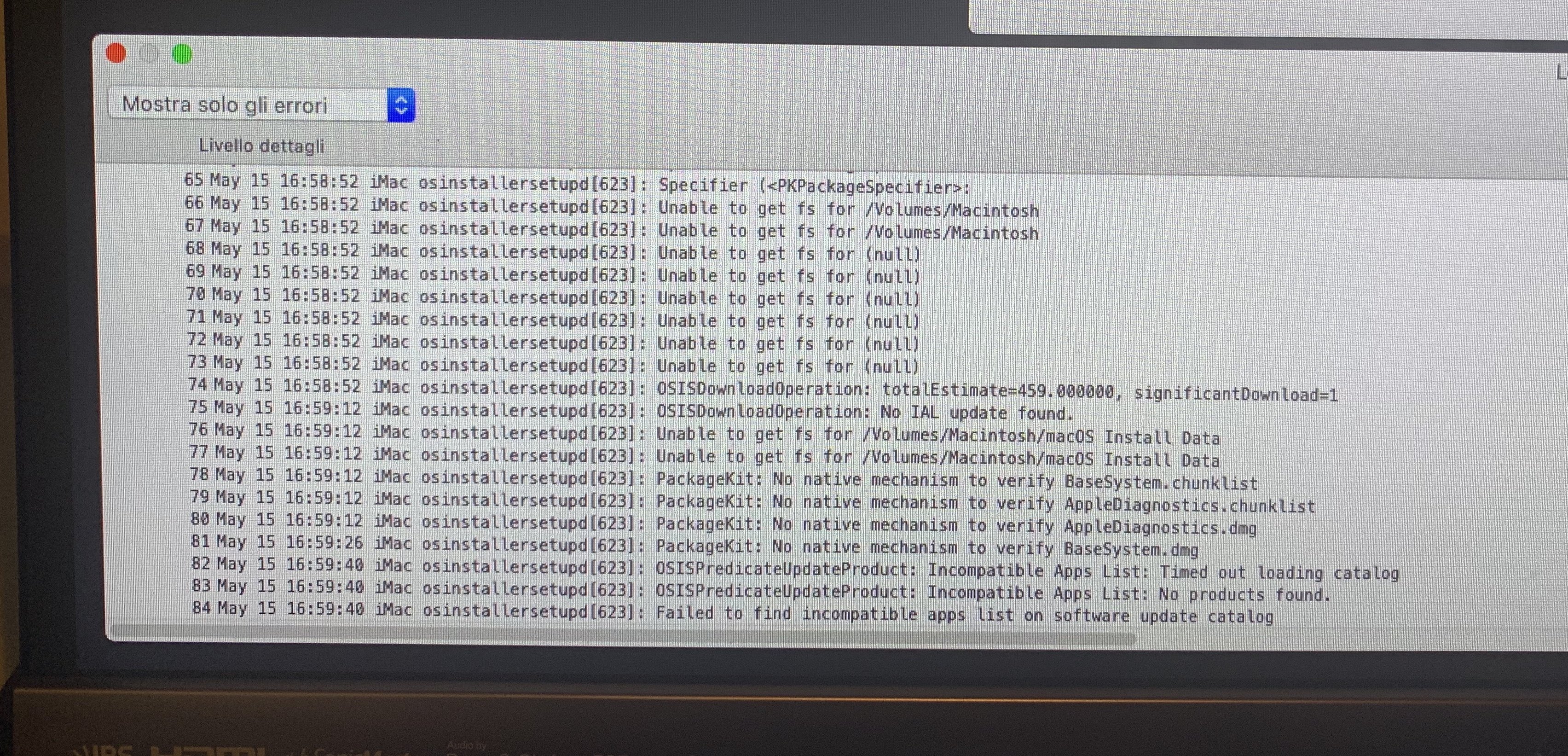

blackwalker Posted May 15, 2019 Share Posted May 15, 2019 (edited) I format the ssd in classic file sistem, same error I captured 2 screenshots that talk about: ”No native mechanism to verify InstallESD...” etc... Edited May 15, 2019 by blackwalker Link to comment Share on other sites More sharing options...
glasgood Posted May 15, 2019 Author Share Posted May 15, 2019 14 minutes ago, blackwalker said: Same error but I capture the log and say: “disk25s1 is not convertible to APFS: you can’t install on this volume because can’t be trasformed in Apple File System (APFS) “ dunno if it refer to the ssd that i erase and format correctly in APFS as you suggested or it refer to the usb??! I can do a video of the log if you like or it’s ok these screenshot? Try, physically remove all drives (m2 970 samsung, 2tb crucial ) from motherboard, have just the Samsung 860 EVO connected. So only have the Samsung 860 EVO connected to Motherboard. and remove 16GB of memory. Also: Ensure Above 4G Decoding is set to disabled in the BIOS And retry installation. Link to comment Share on other sites More sharing options...
blackwalker Posted May 15, 2019 Share Posted May 15, 2019 4 minutes ago, glasgood said: Try, physically remove all drives (m2 970 samsung, 2tb crucial ) from motherboard, have just the Samsung 860 EVO connected. So only have the Samsung 860 EVO connected to Motherboard. and remove 16GB of memory. Also: Ensure Above 4G Decoding is set to disabled in the BIOS And retry installation. ok i can try this, later! anyway, - Above 4G Decoding is set to disabled - what about the other error message like "”No native mechanism to verify InstallESD.dmg” and so on? thanks a lot for your time and patience Link to comment Share on other sites More sharing options...
glasgood Posted May 15, 2019 Author Share Posted May 15, 2019 (edited) 13 minutes ago, blackwalker said: ok i can try this, later! anyway, - Above 4G Decoding is set to disabled - what about the other error message like "”No native mechanism to verify InstallESD.dmg” and so on? thanks a lot for your time and patience In past, I've had similar problem at same state of install and it was because Above 4G Decoding was enabled. Also on another occasion, same stage during installation was because I tried to install onto an old WD black SATA drive, when drive was replaced the install was good. But first, try removing parts that I mentioned. Then if problem persists, would try and use another USB flash drive for Mojave Installer. Edited May 15, 2019 by glasgood Link to comment Share on other sites More sharing options...
