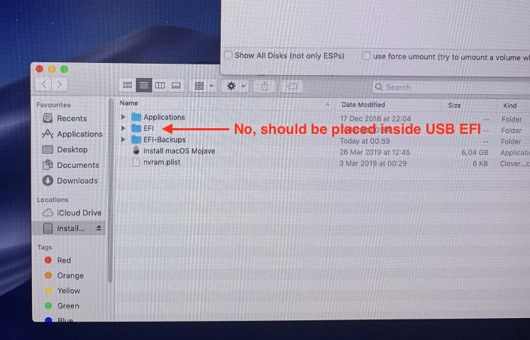

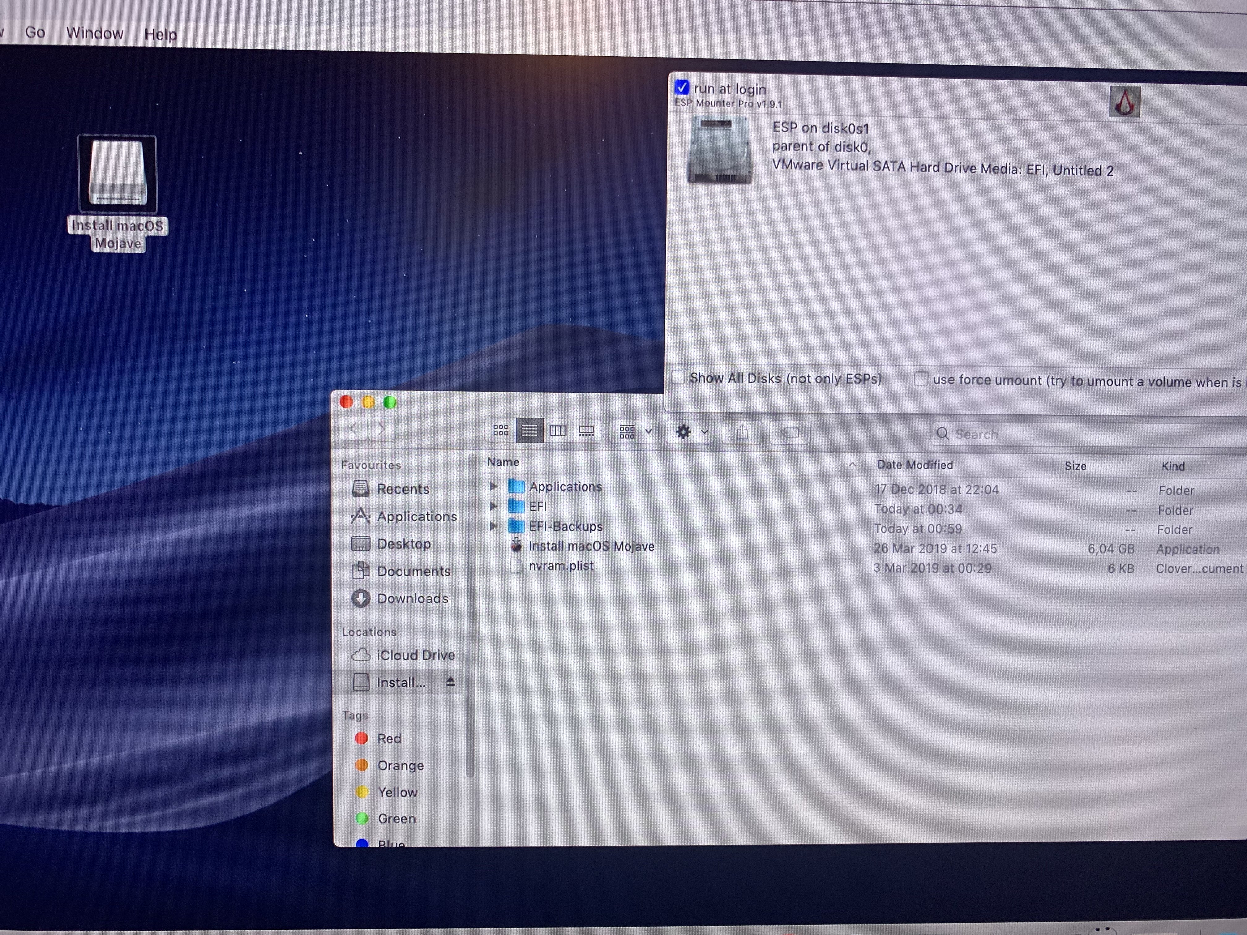

hi,
USB wont boot!
I follow the guide preparing the usb installer and i use VMware with
Mojave installed to make it.
I download the Mojave and put it in application.
I notice that while i see the video, you have to mount the EFI partition of the usb installer everytime using esp mounter pro ,
if i click and open the "Install macOS Mojave" usb, i have all visible.... i mean i see and have all there whithout using esp mounter pro:
- Applications (folder)
- EFI (folder)
- EFI-Backups (folder)
- Install macOS Mojave
- nvram.plist
and i follow the guide!
Maybe the problem is related to this?
I mean, when i try to start from USB i see only "KingstonDataTraveler G3 PMAP" unit and not the Uefi one as i see on the pic
what i'm doing wrong? :(
ps:
- i'm using the usb 2.0 port
- when i create the usb installer i used the front usb 3.0 port
Edited by blackwalker
7 minutes ago, blackwalker said:
hi,
USB wont boot!
- EFI (folder)
- nvram.plist

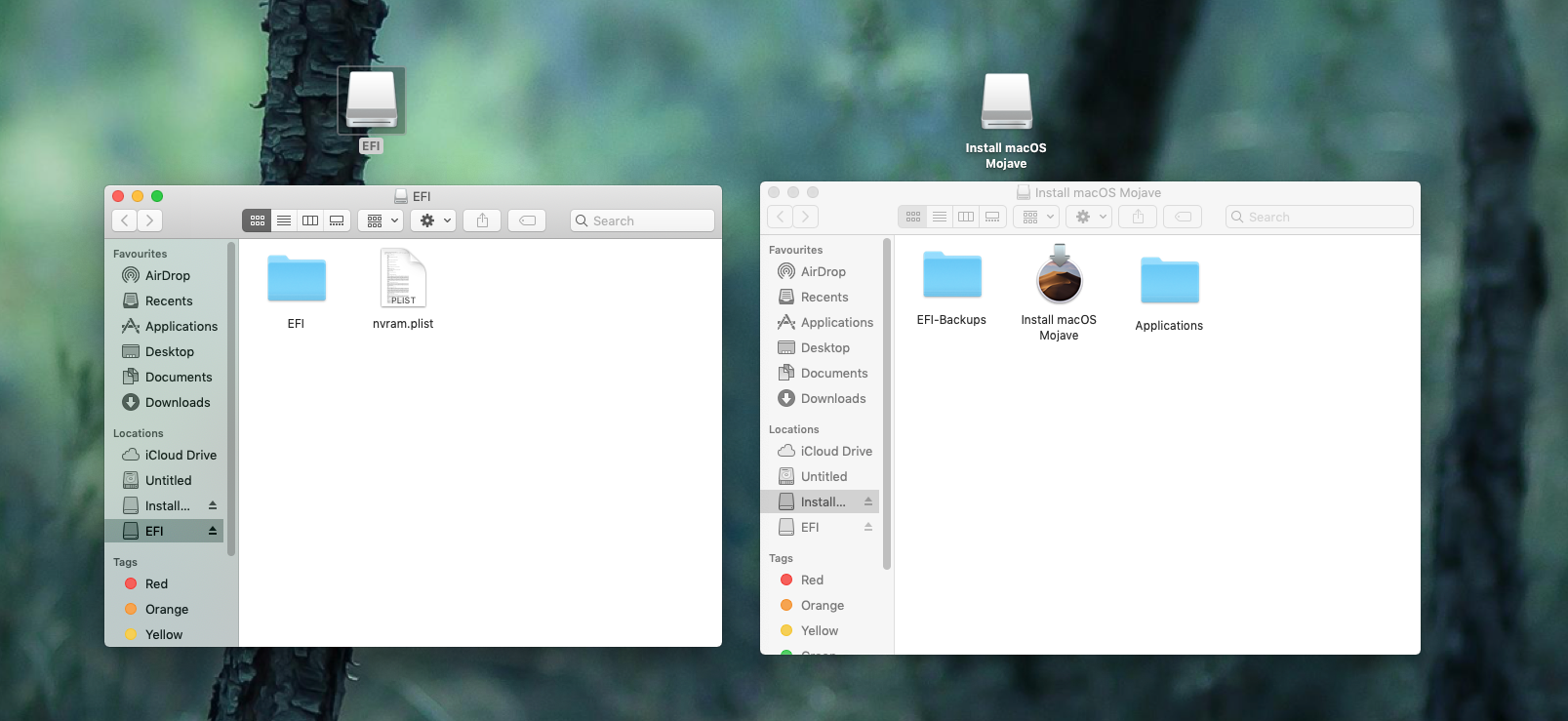

Hello @blackwalker
Do you have the following, when mounted on your desktop. Can you send a screen dump ?
1406994498_Screenshot2019-05-15at10_03_54.thumb.png.133f8b64dca3ff240c0651104f015144.png
Edited by glasgood
12 minutes ago, blackwalker said:
Here is what i have:
i dont have to mount efi and open it because i just have all there when open usb
Hello,
It seem's like you do not have an EFI partition on your USB installer.
  • Delete, EFI folder.
  • Then follow.
Then mount EFI partition from your USB installer then copy over EFI folder.
Then you will  have:
2074255880_Screenshot2019-05-15at10_03_54.thumb.png.ff445a170a2a77519a8c4679381356c8.png
Edited by glasgood

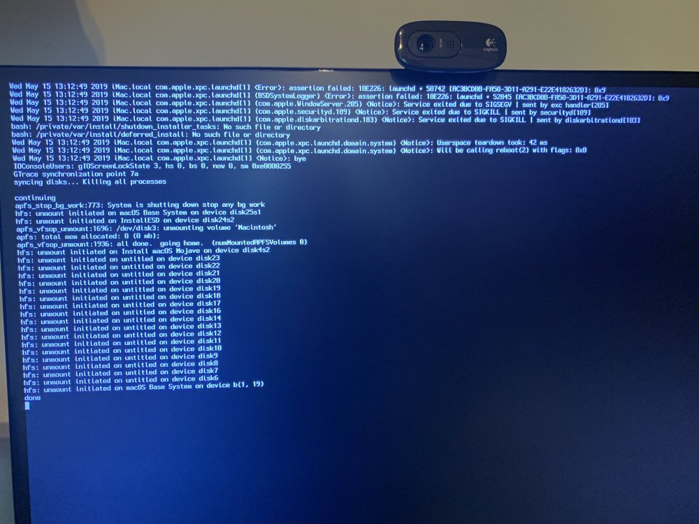

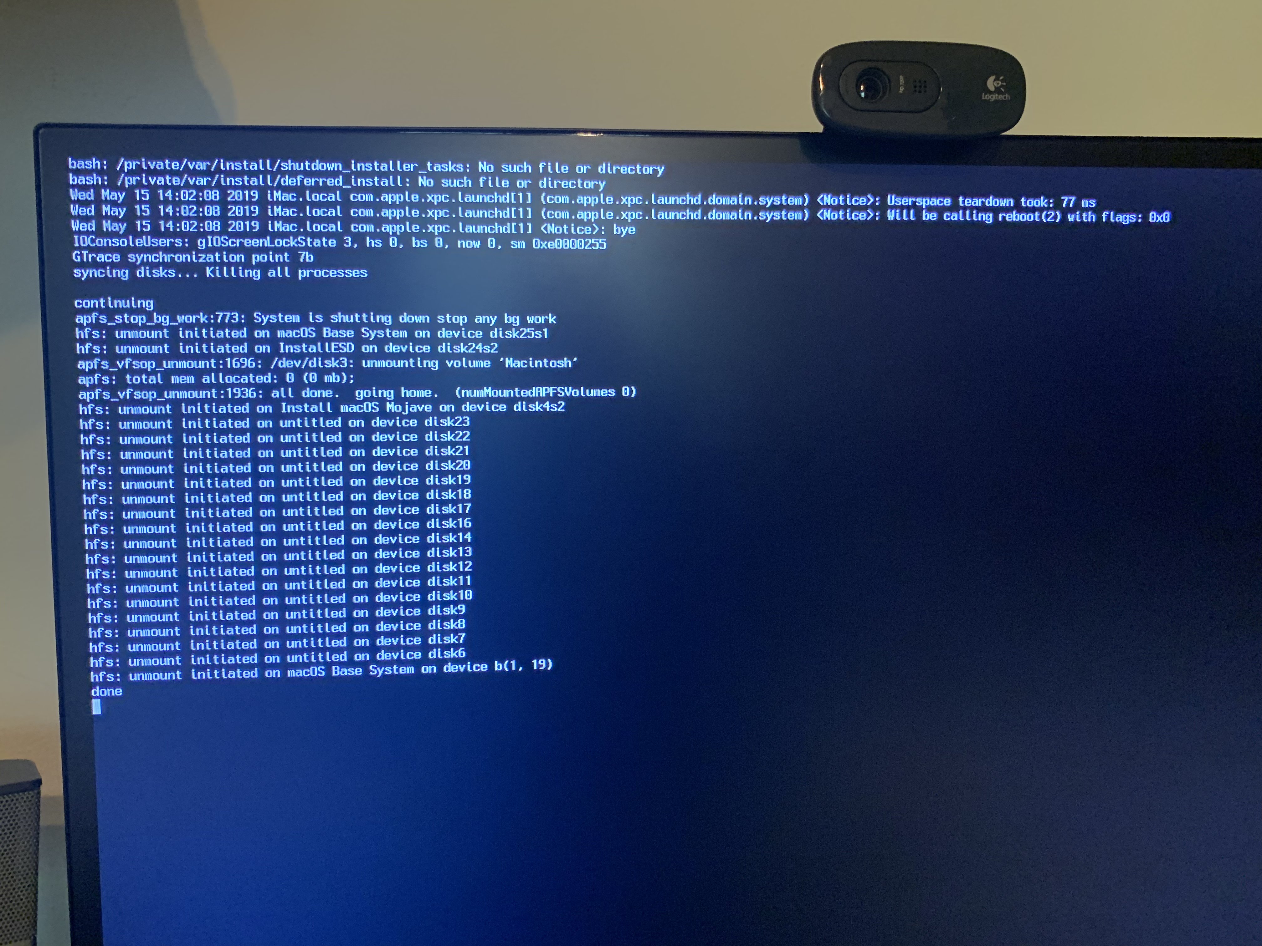

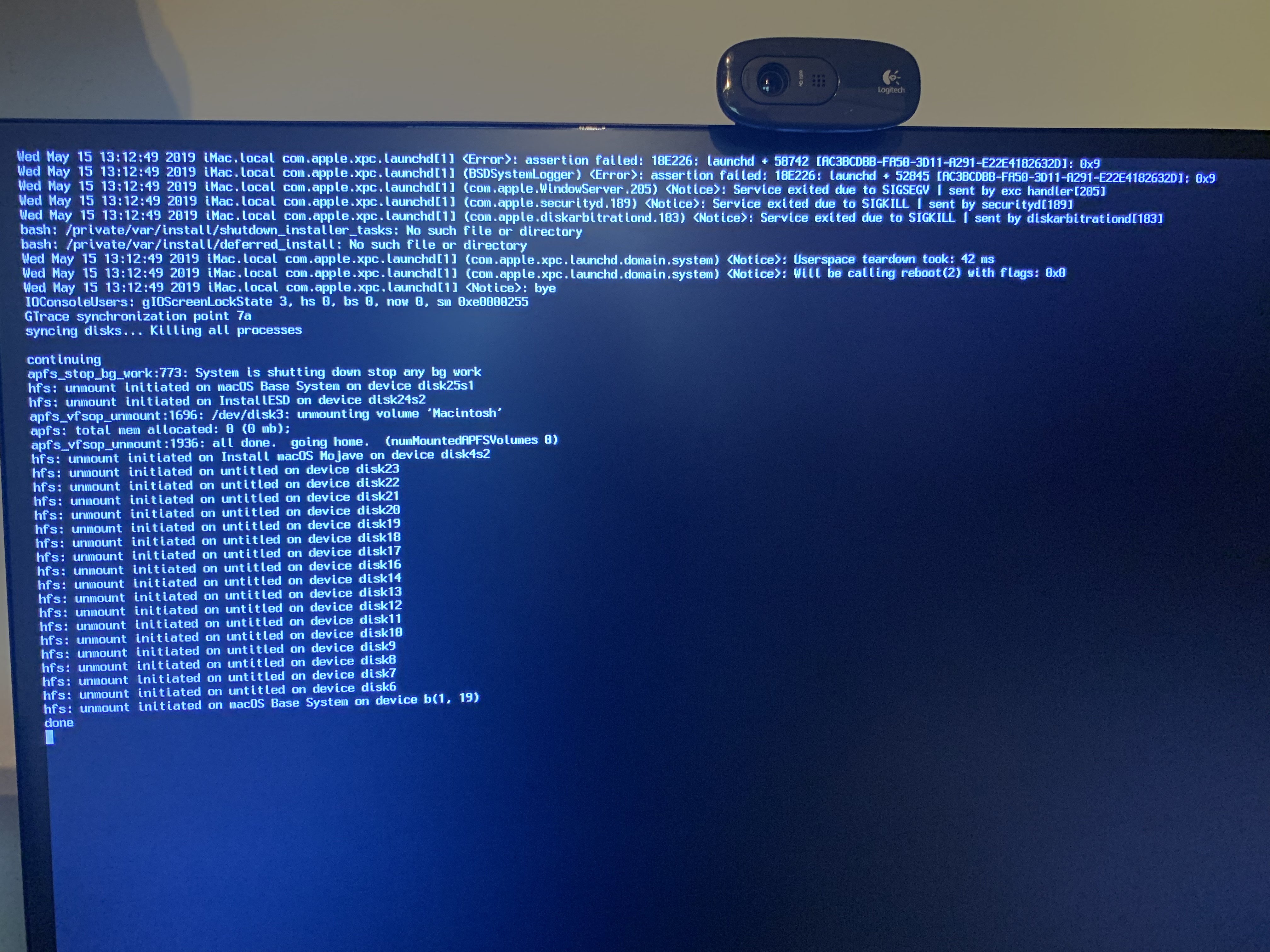

Maybe i miss something!
- Press f12 and select the usb installer efi
- start the install from usb
- so i format and select the ssd
- at around 2 minutes it’ll stop and restart
- i select now to  Boot macOS Install from Macintosh
- looks like the install continue again and finish ok and say it’ll restart in some seconds
(With a different screen and dont ask for sistem settings...)
- after reboot i select to boot from usb and then select boot from ssd but freeze
something is wrong...
Ps: i didnt find in bios settings the
”Intel(R) Bios Guard option”!!!!
where is?????
