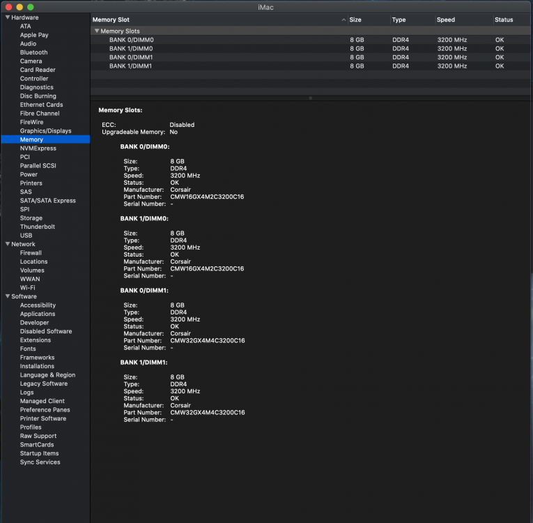

So finally I tried different settings and did a Memtest86 from Usb. the hardware seams to be ok. In windows I don't have a problem and Mojave runs perfect with 2 stick 16gb each. but when I put back all 4 sticks it boots up normally but freeze within 3 minutes. also if I change the order of the sticks it the sane that's why I don't think the RAM is faulty. could it be somehow related to the installation or some Bios settings? I also thought maybe its better to take another setting then iMac Pro since the Pro iMacs use ECC memory.

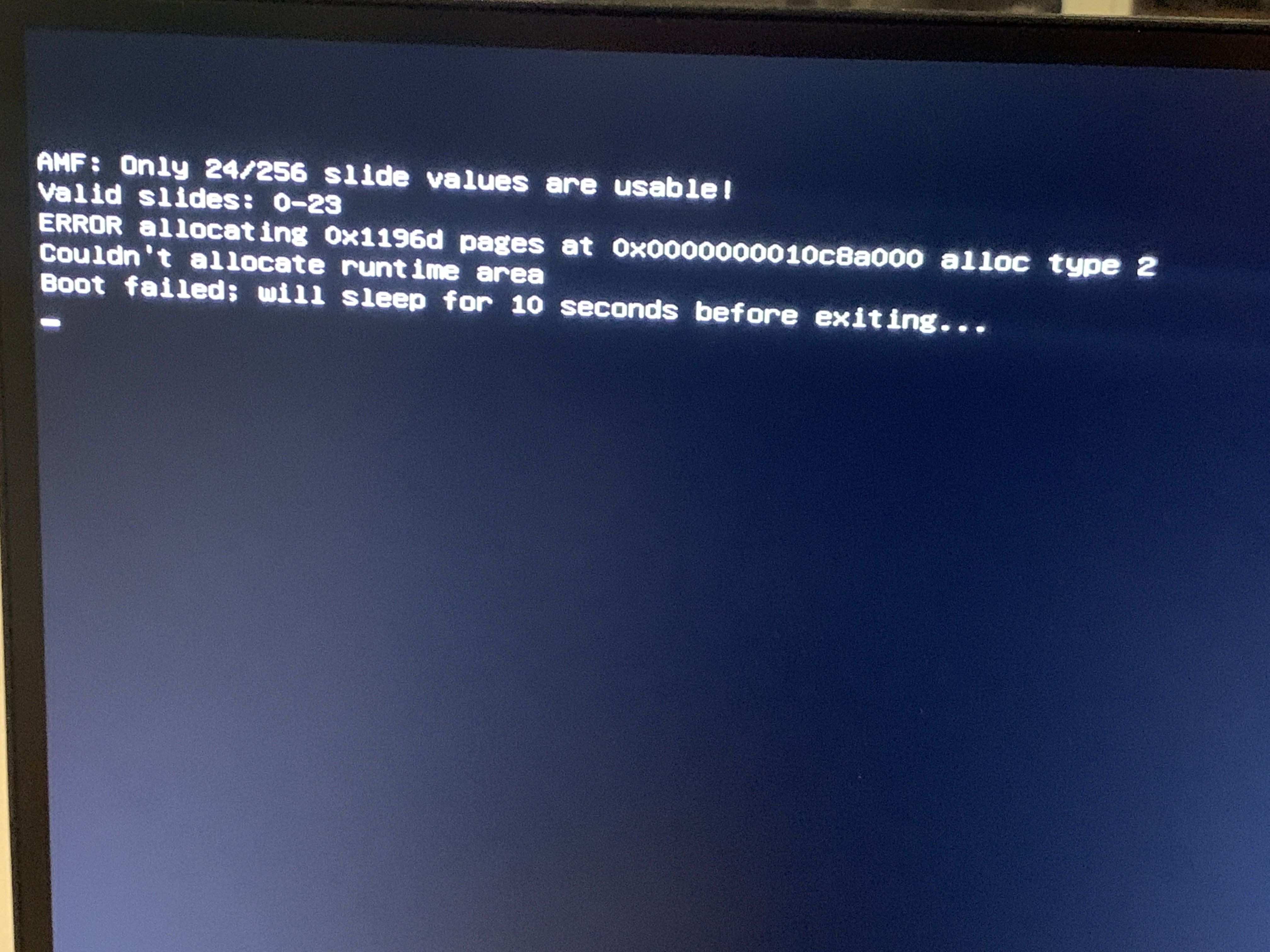

No problem, I and MaLd0n looked though your EFI and ssdt and it’s all correct bar a few kexts you didn’t need and also don’t use slide=0, it’s not needed unless your using the igpu on smbios 19,1
