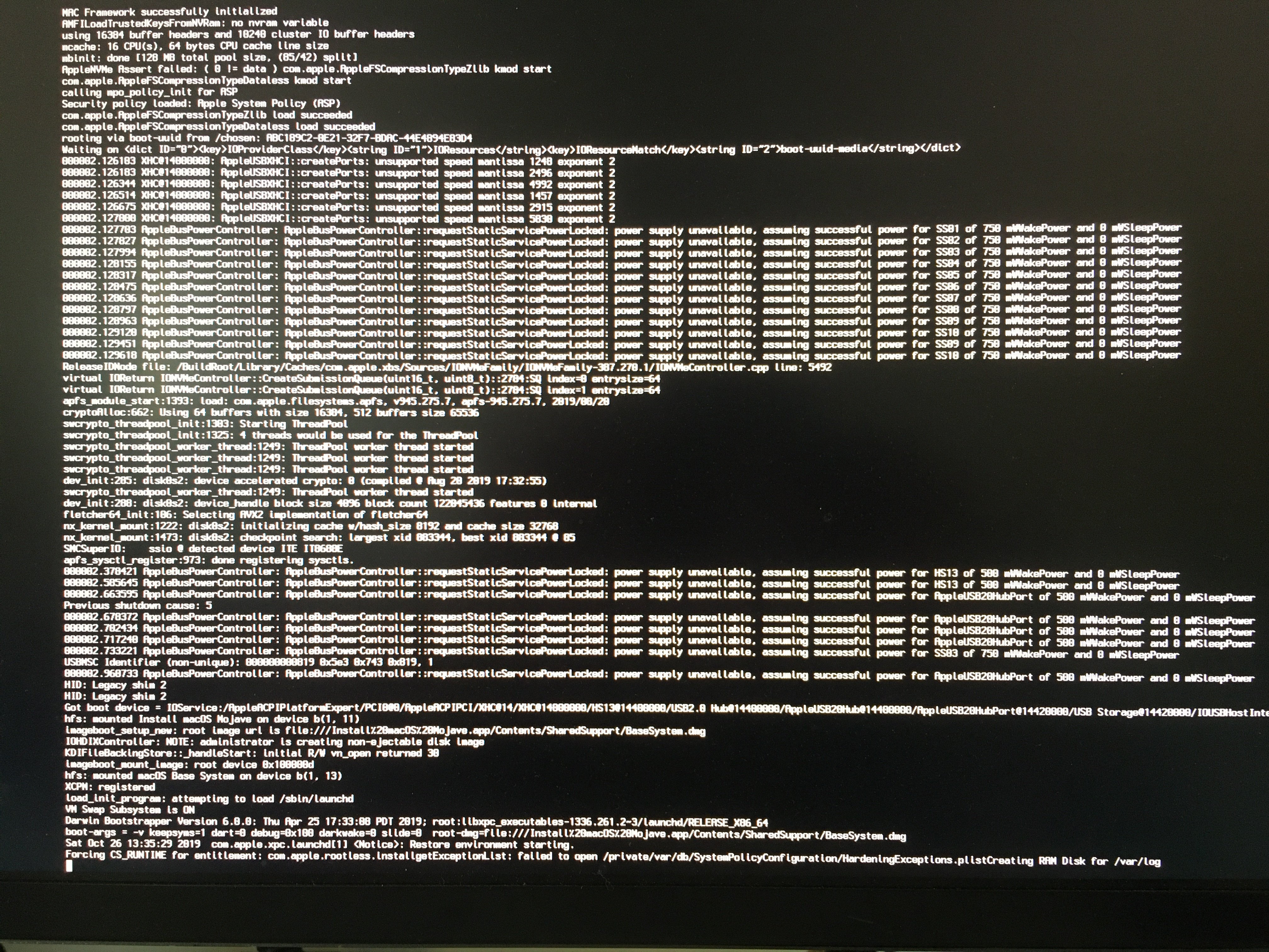

On 8/10/2019 at 12:59 PM, gino8080 said:
Hello and sorry for late answer,
So these are my pics of the build (a bit messy :whistle:)
hope they are clear, otherwise I'll shoot new with better light and/or zoom
Do you see something strange?
the power supply is a Cooler Master V1000 (bought less than 1 year ago)
Now I mounted a new noctua fan (for the case) and attacched a APC BR1500GI  1500 VA, tried disconnecting power, and seems working on battery without problems
Now seems pretty stable, temps "seems" good  these are in idle..
(Istat menu screen)
I'm using the integrated mobo sound, BUT i did not tried again disconnecting/connecting the audio jack, because that was the problem, i'll try again to see If i'll got a black screen
BUT NOW I HAVE A PROBLEM with bluetooth not anymore recognized! and so also airdrop stopped working
DOn't know why, the only new hardware thing changed, is the new noctua fan that is a 4pin (the old was a 3 pin)
I also changed the usb port of the Abwb 802.11AC Wi-Fi  (PCI-E) BCM943602CS , and removed the front usb from the other port (so atm I have only 1 of the 2 usb2 port busy with the  Abwb bluetooth cable)
What can be the problem for the bluetooth stopping working? (i''l check in windows if it's recognized)
EDIT: SOLVED!
As suggested from  @ilcondannato (ciao caro grazie l'ho visto prima che lo cancellassi! :))
I just swapped pci port, and also usb2 port (for the bluetooth cable) and now it's working good!
I also changed Country code to #4 and also TX rate seems better!
THANK YOU!

Hello Glasgood,
I'm trying to install with your settings and files since 2 days and always getting following error:
Forcing CS_Runtime for entitlement: com.apple.rootless.installgetexceptionlist: failed to open /private/var/db/systempolicyconfigutration/hardeningexceptions.plistcreating RAM disk for var/log
I have the same hardware then you ( Z390 Aorus Pro with 64GB RAM and a 9900K) only difference is a Radeon VII Graphics. I tried BIOS F10 and F9 and Mojave and Catalina. Always the same error. Also tried a standard [url="http://www.insanelymac.com/forum/topic/279450-why-insanelymac-does-not-support-tonymacx86/"]#####[/url] stick and different sticks. Same result.
I tried to install with 4 x 16GB RAM and also with only one stick in the first slot next to CPU.
My drive is a EVO 960 Samsund M.2 SSD 512GB.
Thanks in advance,
Ben
