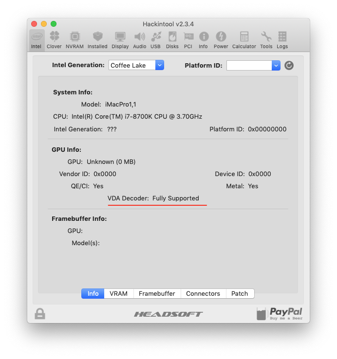

AudioGod Posted July 25, 2019 Share Posted July 25, 2019 1 hour ago, glasgood said: Thanks, though I'm wondering if the RX580 is root of the problem when using SMBIOS for iMac Pro. It seems that sleep works, system seems to wake but my screen stays black. I still have a rx580 knocking about so I will prep my test bench later and try and reproduce the wake problem using my setup. Scratch that il use my system so it all stays in line and plop in the rx580 and see what happens. I believe with the rx580 your probably better off staying at smbios 19,1 but that OsxAptioFix2Drv -free2000.efi needs togo because it's making memory throw errors and to me that's worst then anything else as when I'm in the middle of a session that's the last thing I need happening to me. It was forcing me to brute force my system agent to try and stabilise the ram. Yuk! LoL 1 Link to comment Share on other sites More sharing options...
glasgood Posted July 25, 2019 Author Share Posted July 25, 2019 44 minutes ago, AudioGod said: I still have a rx580 knocking about so I will prep my test bench later and try and reproduce the wake problem using my setup. Scratch that il use my system so it all stays in line and plop in the rx580 and see what happens. I believe with the rx580 your probably better off staying at smbios 19,1 but that OsxAptioFix2Drv -free2000.efi needs togo because it's making memory throw errors and to me that's worst then anything else as when I'm in the middle of a session that's the last thing I need happening to me. It was forcing me to brute force my system agent to try and stabilise the ram. Yuk! LoL I may have to stay with OsxAptioFix2Drv-free2000.efi , been using it for several months now without problem. Appreciate you offer to test the RX580, fingers crossed I have under looked something some where Cheers! 49 minutes ago, larabee said: Did you remove all iGpu settings and boot flag? I forgot the shikigva flag and it messed up entire thing. I've been running iMac Pro 1.1 for quite a while and doesn't have sleep issue. It must be framebuffer for RX580. I tried removing shikigva boot flag and intel settings from Device / Properties, still no luck. Link to comment Share on other sites More sharing options...
larabee Posted July 25, 2019 Share Posted July 25, 2019 1 hour ago, glasgood said: I may have to stay with OsxAptioFix2Drv-free2000.efi , been using it for several months now without problem. Appreciate you offer to test the RX580, fingers crossed I have under looked something some where Cheers! I tried removing shikigva boot flag and intel settings from Device / Properties, still no luck. @glasgood Yeah, with iMac Pro 1.1 , you must remove iGPU related bootflag and intel device properties and completely disable iGPU for the SMBIOS to work properly. Otherwise, you will not be able to open Jpeg file at all and Final Cut will sometimes freeze depending on the file format you're working with. I will try troubleshoot the issue with AudioGod as our systems are basically clone of each other. I have a RX570 and tested it out, facing some random kernel panic Bool ATI Framebuffer but a restart clear the error. @AudioGod I tried plugging RX570 and experience the same problem as Glasgood. Waiting for your Rx580 buddy. Link to comment Share on other sites More sharing options...

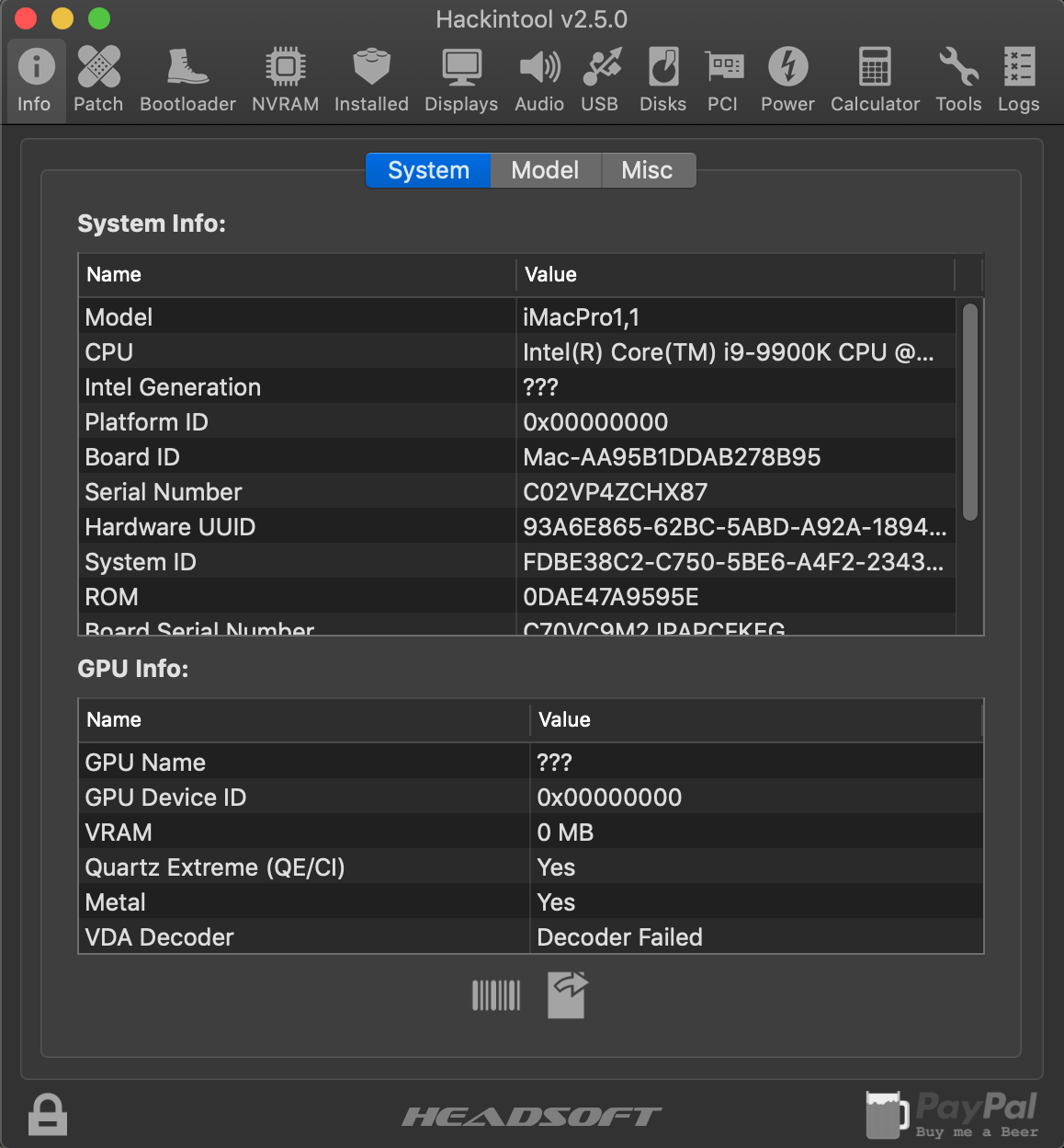

glasgood Posted July 25, 2019 Author Share Posted July 25, 2019 5 minutes ago, larabee said: @glasgood Yeah, with iMac Pro 1.1 , you must remove iGPU related bootflag and intel device properties and completely disable iGPU for the SMBIOS to work properly. Otherwise, you will not be able to open Jpeg file at all and Final Cut will sometimes freeze depending on the file format you're working with. I will try troubleshoot the issue with AudioGod as our systems are basically clone of each other. I have a RX570 and tested it out, facing some random kernel panic Bool ATI Framebuffer but a restart clear the error. @AudioGod I tried plugging RX570 and experience the same problem as Glasgood. Waiting for your Rx580 buddy. Thanks @AudioGod I suspect it's the frame buffer, so at the moment I'm looking into see if patching AMD9500Controller.kext is still relevant when using WhateverGreen.kext Link to comment Share on other sites More sharing options...
AudioGod Posted July 25, 2019 Share Posted July 25, 2019 14 minutes ago, larabee said: @AudioGod I tried plugging RX570 and experience the same problem as Glasgood. Waiting for your Rx580 buddy. @glasgood @larabee Hey guys, yep it happens to me with the rx580 too. Dark screen at wake.. Link to comment Share on other sites More sharing options...
larabee Posted July 25, 2019 Share Posted July 25, 2019 1 hour ago, glasgood said: Thanks @AudioGod I suspect it's the frame buffer, so at the moment I'm looking into see if patching AMD9500Controller.kext is still relevant when using WhateverGreen.kext Can you try the WhateverGreen 1.3.1 I think the 1.2.9 has problem with framebuffer patching for the 9500controller kext. Link to comment Share on other sites More sharing options...
glasgood Posted July 25, 2019 Author Share Posted July 25, 2019 31 minutes ago, larabee said: Can you try the WhateverGreen 1.3.1 I think the 1.2.9 has problem with framebuffer patching for the 9500controller kext. I updated to latest WhateverGreen early today, can’t remember what version, but will double check in morning. Thanks Link to comment Share on other sites More sharing options...

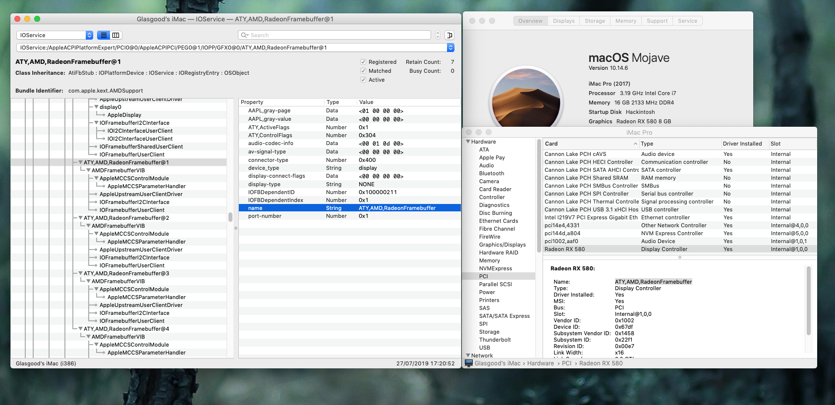

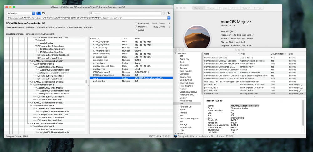

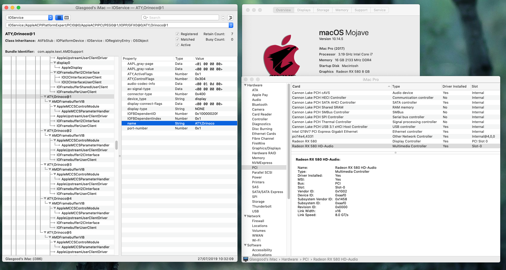

glasgood Posted July 27, 2019 Author Share Posted July 27, 2019 (edited) @AudioGod @larabee Making some progress, exhausted most other frame buffer options but finally managed to change frame buffer from ATY,AMD,RadeonFrambuffer to ATY,Orinoco via a custom SSDT. I hoped this would fix the black screen on wake, but unfortunately not lol I tried specifying values 5 & 6 on "CFG,CFG_FB_LIMIT" in SSDT but not happening. SSDT for RX 580 seems to be working! So maybe the frame buffer is not responsible for black screen on wake. Will try darkwake options. SSDT-RX-580.aml SSDT-RX-580.dsl Edited July 27, 2019 by glasgood Link to comment Share on other sites More sharing options...
AudioGod Posted July 27, 2019 Share Posted July 27, 2019 22 minutes ago, glasgood said: @AudioGod @larabee Making some progress, exhausted most other frame buffer options but finally managed to change frame buffer from ATY,AMD,RadeonFrambuffer to ATY,Orinoco via a custom SSDT. I hoped this would fix the black screen on wake, but unfortunately not lol I tried specifying values 5 & 6 on "CFG,CFG_FB_LIMIT" in SSDT but not happening. SSDT for RX 580 seems to be working! So maybe the frame buffer is not responsible for black screen on wake. Will try darkwake options. SSDT-RX-580.aml SSDT-RX-580.dsl Your getting there buddy, if you need me to run any tests for you then just let me know. Il be about from around 2pm on our time so I'm here if you need me. 1 Link to comment Share on other sites More sharing options...

glasgood Posted July 27, 2019 Author Share Posted July 27, 2019 45 minutes ago, AudioGod said: @glasgood Give this version of whatevergreen 1.3.1 a try buddy. it has fixes for the rx580 frame buffer and also clears up the purple lines at boot. its not full release and still at debug status but I've been running it since last night with no problem and have double made sure its good togo before sending it over to you. WhateverGreen-131.zip What's a good cloning tool for macos to copy my ssd with bro? It fixes the purple lines, but still have black screen on wake. It also resorts back to ATY,AMDRadeonFrambuffer. WhateverGreen-131 without SSDT-RX580 WhateverGreen-131 with SSDT-RX580 53 minutes ago, AudioGod said: @glasgood Give this version of whatevergreen 1.3.1 a try buddy. it has fixes for the rx580 frame buffer and also clears up the purple lines at boot. its not full release and still at debug status but I've been running it since last night with no problem and have double made sure its good togo before sending it over to you. WhateverGreen-131.zip What's a good cloning tool for macos to copy my ssd with bro? Did you test on your hack, black screen on wake from sleep ? not working on mine. Link to comment Share on other sites More sharing options...
AudioGod Posted July 27, 2019 Share Posted July 27, 2019 (edited) 19 minutes ago, glasgood said: It fixes the purple lines, but still have black screen on wake. It also resorts back to ATY,AMDRadeonFrambuffer. WhateverGreen-131 without SSDT-RX580 WhateverGreen-131 with SSDT-RX580 Did you test on your hack, black screen on wake from sleep ? not working on mine. I actually was just trying that now for you. I put the rx580 back in and flipped my efi then made the changes using your ssdt and weg 1.3.1 and same thing. Black screen on wake. With the vega 56 everything is spot on perfect for me. Stupid rx580's, I'm gonna chuck mine out the window in a minute...hahaha Edited July 27, 2019 by AudioGod 1 Link to comment Share on other sites More sharing options...

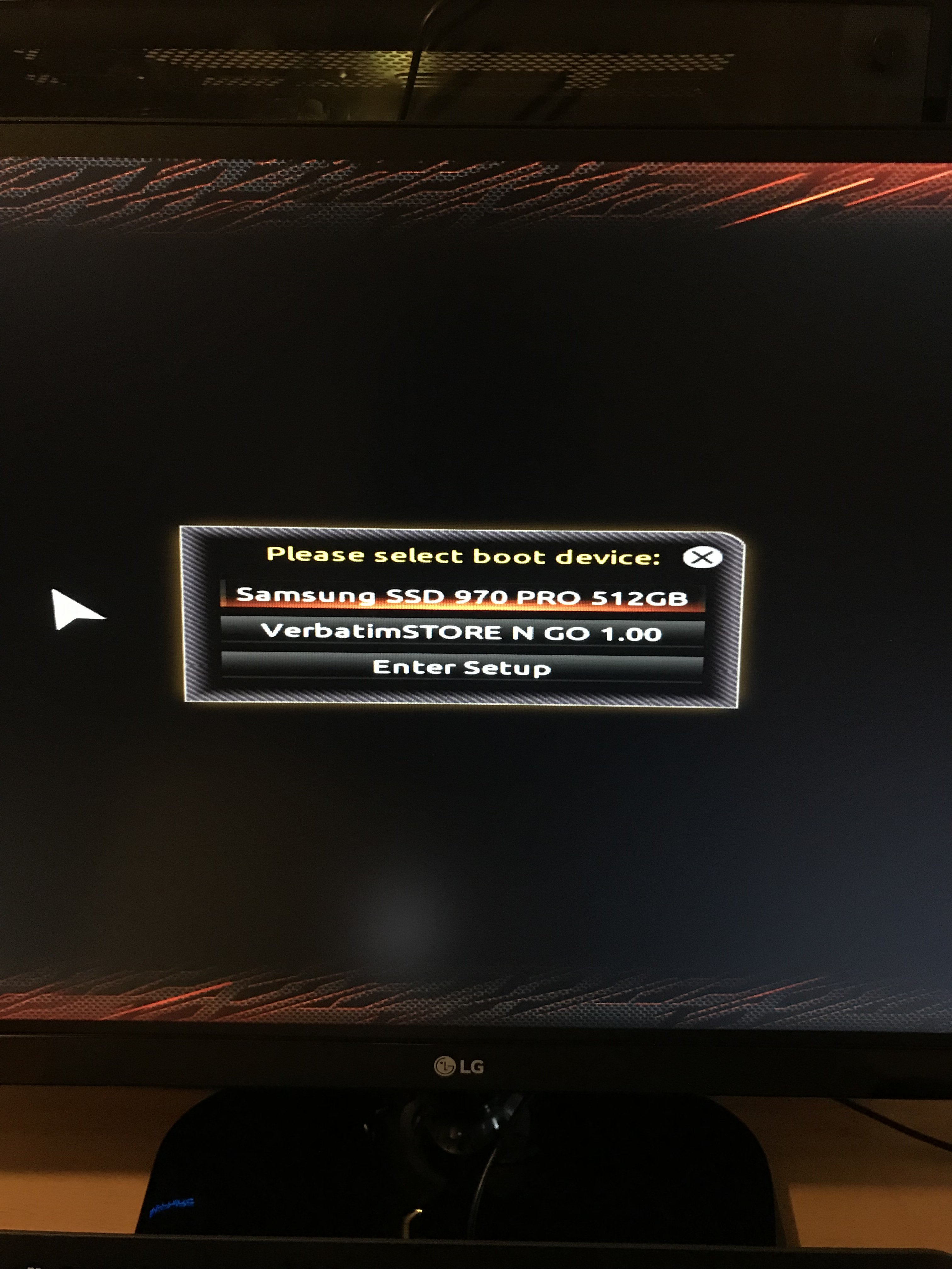

brucevan96 Posted July 28, 2019 Share Posted July 28, 2019 Hey, I am A first time Hackintosh builder here. I followed your guide step by step but when I try to boot from the USB, the screen goes black and goes right back to the select boot device. I've tried changing the BIOS settings around and also tried following guides from other people. Not sure what I'm doing wrong. If anyone can give help me out, it would be much appreciated. Thanks. Hardware: INTEL CORE I9 9900K Gigabyte Z390 AORUS PRO WIFI SAPPHIRE RADEON RX 580 NITRO+ 8GB DDR5 SAMSUNG 970 PRO 512GB M.2 COOLER MASTER HYPER 212 EVO EVGA 650WATT GQ PSU CORSAIR VENGENCE LPX 16GB DDR4 (2X8GB 3200 MHZ) CORSAIR 275R MID-TOWER CASE LG 21:9 25' ULTRAWIDE MONITOR 25UM58 Link to comment Share on other sites More sharing options...
glasgood Posted July 28, 2019 Author Share Posted July 28, 2019 (edited) 36 minutes ago, brucevan96 said: Hey, I am A first time Hackintosh builder here. I followed your guide step by step but when I try to boot from the USB, the screen goes black and goes right back to the select boot device. I've tried changing the BIOS settings around and also tried following guides from other people. Not sure what I'm doing wrong. If anyone can give help me out, it would be much appreciated. Thanks. Hardware: INTEL CORE I9 9900K Gigabyte Z390 AORUS PRO WIFI SAPPHIRE RADEON RX 580 NITRO+ 8GB DDR5 SAMSUNG 970 PRO 512GB M.2 COOLER MASTER HYPER 212 EVO EVGA 650WATT GQ PSU CORSAIR VENGENCE LPX 16GB DDR4 (2X8GB 3200 MHZ) CORSAIR 275R MID-TOWER CASE LG 21:9 25' ULTRAWIDE MONITOR 25UM58 Hi, Choose the UEFI partition on USB Installer, if you choose the non UEFI partition then you will loop back to select boot device. Make sure you installed Clover onto the USB device. Edited July 28, 2019 by glasgood Link to comment Share on other sites More sharing options...
