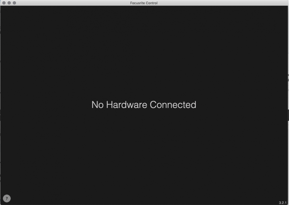

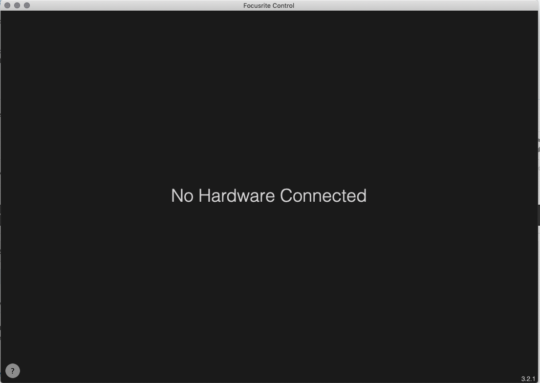

AntoineWill Posted July 4, 2019 Share Posted July 4, 2019 On 7/3/2019 at 9:51 AM, glasgood said: What are your full system specifications, and can you attach your EFI folder. I've completely restart the whole guide process and now it works fine and boot every time to the main drive (I use the hackintosh right now) ! However, I've a last problem - and this is a problem for me because I need it them a lot : The USB ports work for flash drives for exemple (I tried every one of them (usb 2, usb 3.0, usb 3.1) and the flash drive shows up on the desktop every time) BUT, if I try to use the USB ports for my external hardware - like my Focusrite Clarett 4 pre USB audio interface or my master midi keyboard - The USB ports on the backplate doesn't work, the light turn on the keyboard but it's not found in my DAW, if I switch to the front USB ports or to one of the four USB2.0 ports on the backplate, it works fine... So, I can only use the 2 front USB3.0 and the 4 USB2.0. This is strange, and I don't get it because I've use your EFI (Post) and Got the exact same hardware. Any Help ? This is my system specifications and my EFI folder : https://www.dropbox.com/sh/8njlu27mqi1nhnu/AAAEGIv-yjWoXlw_wrEiC8X3a?dl=0 Thanks a lot for your help Intel Core i7-8600 Gigabyte Aorus Pro Z390 (bios F9) AMD Sapphire Radeon RX 580 8 Go Nitro+ Samsung SSD 970 EVO Plus 500GB (with the last stable firmware) Case Corsair 275R iMac.spx Link to comment Share on other sites More sharing options...
glasgood Posted July 4, 2019 Author Share Posted July 4, 2019 31 minutes ago, AntoineWill said: I've completely restart the whole guide process and now it works fine and boot every time to the main drive (I use the hackintosh right now) ! However, I've a last problem - and this is a problem for me because I need it them a lot : The USB ports work for flash drives for exemple (I tried every one of them (usb 2, usb 3.0, usb 3.1) and the flash drive shows up on the desktop every time) BUT, if I try to use the USB ports for my external hardware - like my Focusrite Clarett 4 pre USB audio interface or my master midi keyboard - The USB ports on the backplate doesn't work, the light turn on the keyboard but it's not found in my DAW, if I switch to the front USB ports or to one of the four USB2.0 ports on the backplate, it works fine... So, I can only use the 2 front USB3.0 and the 4 USB2.0. This is strange, and I don't get it because I've use your EFI (Post) and Got the exact same hardware. Any Help ? This is my system specifications and my EFI folder : https://www.dropbox.com/sh/8njlu27mqi1nhnu/AAAEGIv-yjWoXlw_wrEiC8X3a?dl=0 Thanks a lot for your help Intel Core i7-8600 Gigabyte Aorus Pro Z390 (bios F9) AMD Sapphire Radeon RX 580 8 Go Nitro+ Samsung SSD 970 EVO Plus 500GB (with the last stable firmware) Case Corsair 275R iMac.spx Sounds like your external usb hardware is USB2. Follow guide and create an SSDT and change some of the USB3 ports on motherboard backplate to USB2. So change some SSxx on backplate to HSxx. Link to comment Share on other sites More sharing options...
