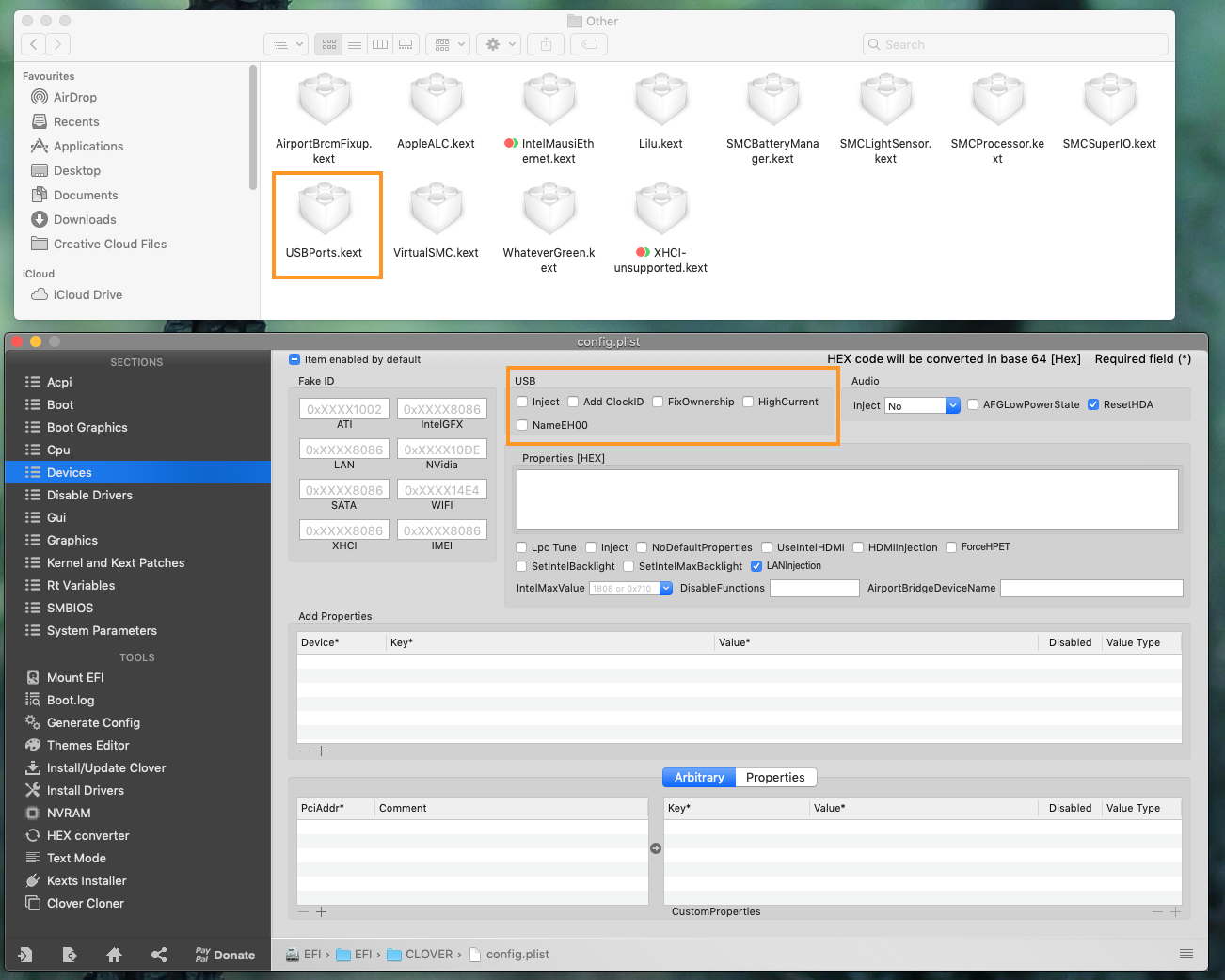

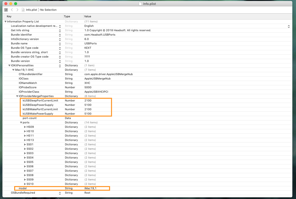

glasgood Posted June 16, 2019 Author Share Posted June 16, 2019 15 hours ago, Delecta said: Hey, Thank you for you guide ! It was very helpful for me. I just have an issue : I don't have a USB after sleep. The USB stick is eject when I wake my hack up. EDIT : Only with USB sticks whatever the ports it is plugged. But with external HDD or TB3, it's working fine after sleep. If you have any idea. Thank you Hello @Delecta If build is Aorus Pro Z390 and you have SMBIOS for iMac 19,1 then replace USBInjextAll.kext with ==> USBPorts.kext.zip and remove SSDT-UIAC, SSDT-USBX. Link to comment Share on other sites More sharing options...
Delecta Posted June 16, 2019 Share Posted June 16, 2019 Hello @Glasgood, I am actually in 18.3 and I have success to work my 2 ports TB3 in hotplug ! But I will try your kext and let you know. Thank you very much ! Link to comment Share on other sites More sharing options...
glasgood Posted June 16, 2019 Author Share Posted June 16, 2019 3 minutes ago, Delecta said: Hello @Glasgood, I am actually in 18.3 and I have success to work my 2 ports TB3 in hotplug ! But I will try your kext and let you know. Thank you very much ! Update the model within info.plist in USBPorts.kext to reflect 18,3 Link to comment Share on other sites More sharing options...

Delecta Posted June 17, 2019 Share Posted June 17, 2019 Hello, I tried your kext but it doesn't work But now this is not my main issue. My hack stuck at "start uncompressed kernelcache" only when I've got my 2nd SSD in Exfat. I try ti add Fat drivers in Drivers64UEFI. But it doesn't work. Anyone have an idea ? Thank you Link to comment Share on other sites More sharing options...
glasgood Posted June 17, 2019 Author Share Posted June 17, 2019 49 minutes ago, Delecta said: Hello, I tried your kext but it doesn't work But now this is not my main issue. My hack stuck at "start uncompressed kernelcache" only when I've got my 2nd SSD in Exfat. I try ti add Fat drivers in Drivers64UEFI. But it doesn't work. Anyone have an idea ? Thank you Can you post EFI, also what is the exact specifications of your hackintosh build ? Link to comment Share on other sites More sharing options...
Delecta Posted June 17, 2019 Share Posted June 17, 2019 (edited) Hello again @glasgood ! So this is a really weird issue : I have got this "start uncompressed kernelcache" when I have a a second SSD plugged-in in Exfat or in APFS but not in HFS+. But not with an USB stick in Exfat. And what is really weird it's that I can be able to boot only when I put the Intel Graphics in Auto or in Disable in the BIOS or plug any USB stick. Here is my EFI, I'm on 18.3 to be able to have the hotplug in TB3. EFI .zip Edited June 17, 2019 by Delecta Link to comment Share on other sites More sharing options...
glasgood Posted June 17, 2019 Author Share Posted June 17, 2019 4 minutes ago, Delecta said: Hello again @glasgood ! So this is a really weird issue : I have got this "start uncompressed kernelcache" when I have a a second SSD plugged-in in Exfat OR in MacOS. But not with an USB stick in Exfat. And what is really weird it's that I can be able to boot only when I put the Intel Graphics in Auto or in Disable in the BIOS or plug any USB stick. Here is my EFI, I'm on 18.3 to be able to have the hotplug in TB3. EFI .zip What is the exact specifications of your hackintosh build ? Link to comment Share on other sites More sharing options...

Delecta Posted June 17, 2019 Share Posted June 17, 2019 1 hour ago, glasgood said: Hi, Just looking at your EFI, it is one on the older EFI from the guide. Also nothing is injected in Devices Properties in your config.plist, you have no SSDT-UIAC.aml and are using USBInjectAll.kext with no boot args to include or exclude. Please use the latest EFI folder from guide. Then transfer your SSDT's for Thunderbolt over to most recent EFI from guide. So I tried your EFI and no I am able to start with the Exfat and APFS drive plugged-in but no it doesn't boot with USB stick plug now. Link to comment Share on other sites More sharing options...
