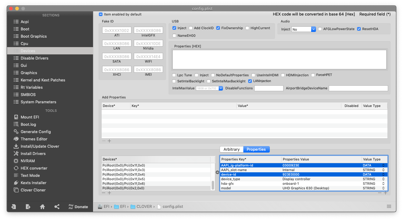

glasgood Posted June 14, 2019 Author Share Posted June 14, 2019 (edited) 12 hours ago, Hifi33 said: RTCMemoryFixUp.kext and EFICheckDisabler.kext didn't allow it to boot either unfortunately after matching your Bios settings. Also added UserKernelCache=No to no avail. I can boot with DVMT Total Gfx Mem - Max just not DVMT Pre-Allocated - 256M Admittedly, my board has a few odd quirks, ie. never retaining the correct time in Bios but this is likely something in a setting somewhere. Going over the Bios screens (thank you) the only differences in your settings to mine I noticed were unrelated ie. under Peripherals - Port Configuration Information - Link Status. Mine is listed as Disconnected. My EFI/OS is located on an NVMe drive so I have a few extra options. Also my CPU Fan speed runs a full 1K higher (2300rpm @29C) than your Corsair AIO. @Hifi33 Losing time In BIOS could be an indicator that CMOS battery is almost dead. When using RTCMemoryFixup and EFIDisabler you can remove "UserKernelCache=No" boot argument. 4 hours ago, corrie said: Will any version/brand of the rx 580 graphics card work with this tutorial or is it only a specific one? Anyone who replies I appreciate it! @corrie Don't buy XFX RX580, go with Asus, Gigabyte, Sapphire, Powercolor, MSI. Edited June 14, 2019 by glasgood 1 Link to comment Share on other sites More sharing options...
