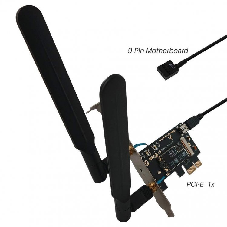

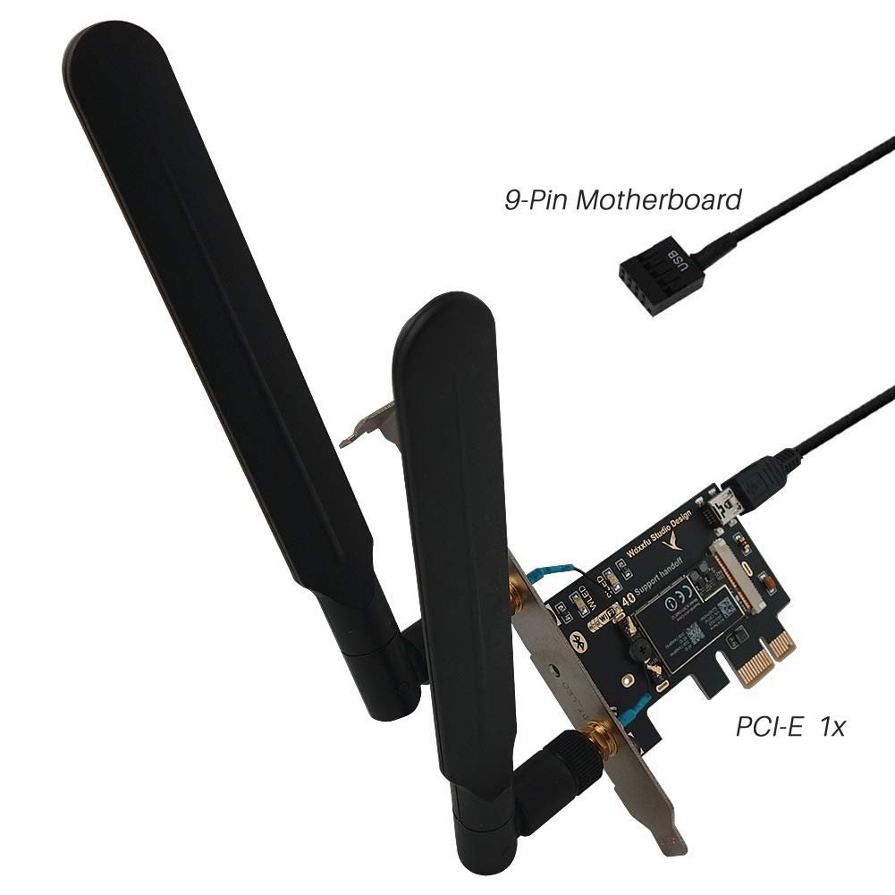

Broadcom-BCM4360-BCM94360-Desktop-PCIe-WLAN-BT4-0-Card-for-Apple-BCM94360CSAX-BCM943602CS-PCI-E-X1.thumb.jpg.469175976281e14ac6d8add48ed7222d.jpg

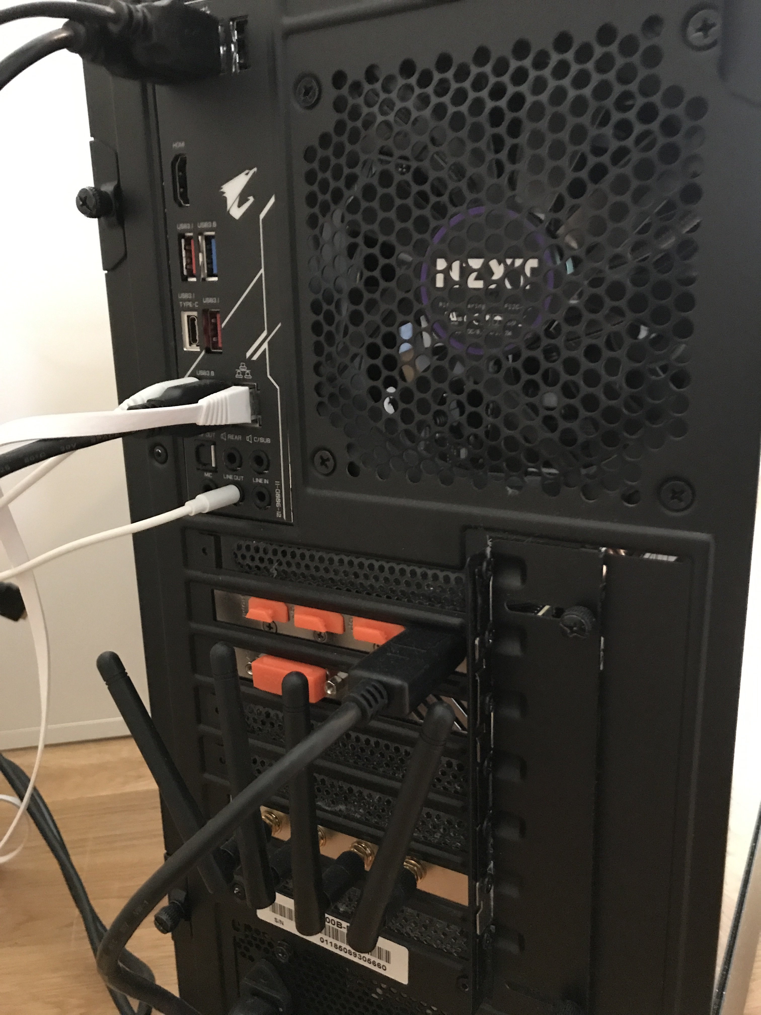

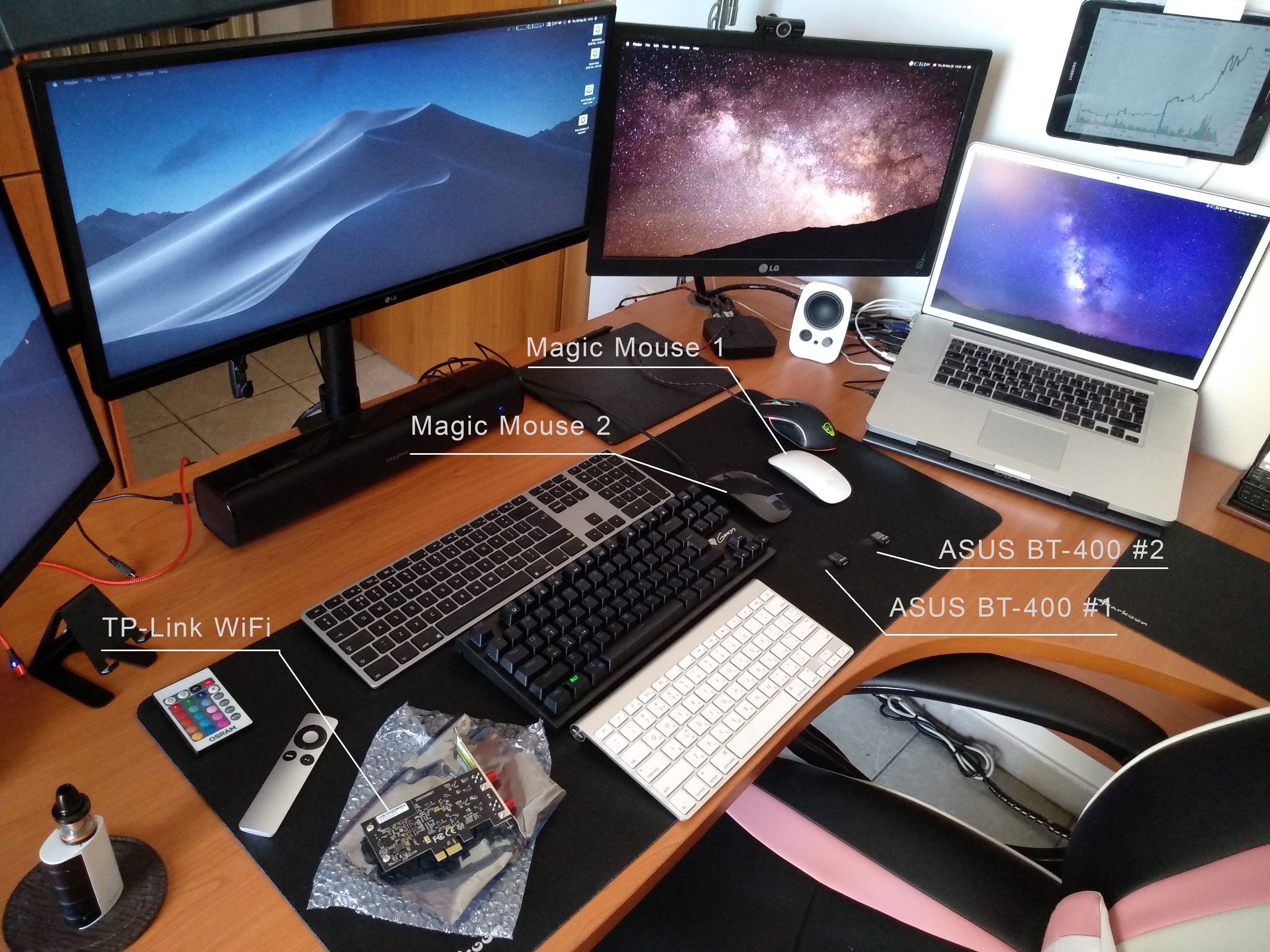

Looking at the photo of your desktop setup your desktop hackintosh is a small distance away from your keyboard, did you try testing keyboard directly next to your hackintosh desktop computer? ( what happens if Hackintosh is placed on floor, under desk, directly below keyboard )
Possibly RF signal could be degraded on USB3.0 bus, hence the lag, if you have external USB storage remove it and test.  Did you try testing USB keyboard dongle( if applicable ) on a USB 2.0 port ?

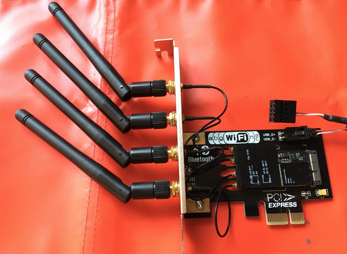

If I may interject - That particular card whilst it worked somewhat with previous OS X versions can be a bit laggy at times or will be continually searching for connection specially after wake/sleep. I have one and since 10.14.5 it became very hit and miss in operation and was preventing my rig from the sleep function. What I did to overcome the problem, I removed the wifi/bluetooth module and fitted it to a 4 arial PCI-E adapter I had (like the included pic) and all my sleep and connection problems were solved. Reading through the post I would hazard a guess it's the card that is causing the problem. By the way the module must contain 4 connection for the 4 arial attachment, failing that, I am afraid a new suitable card preferably one with 4 antennas will be needed. Good luck.

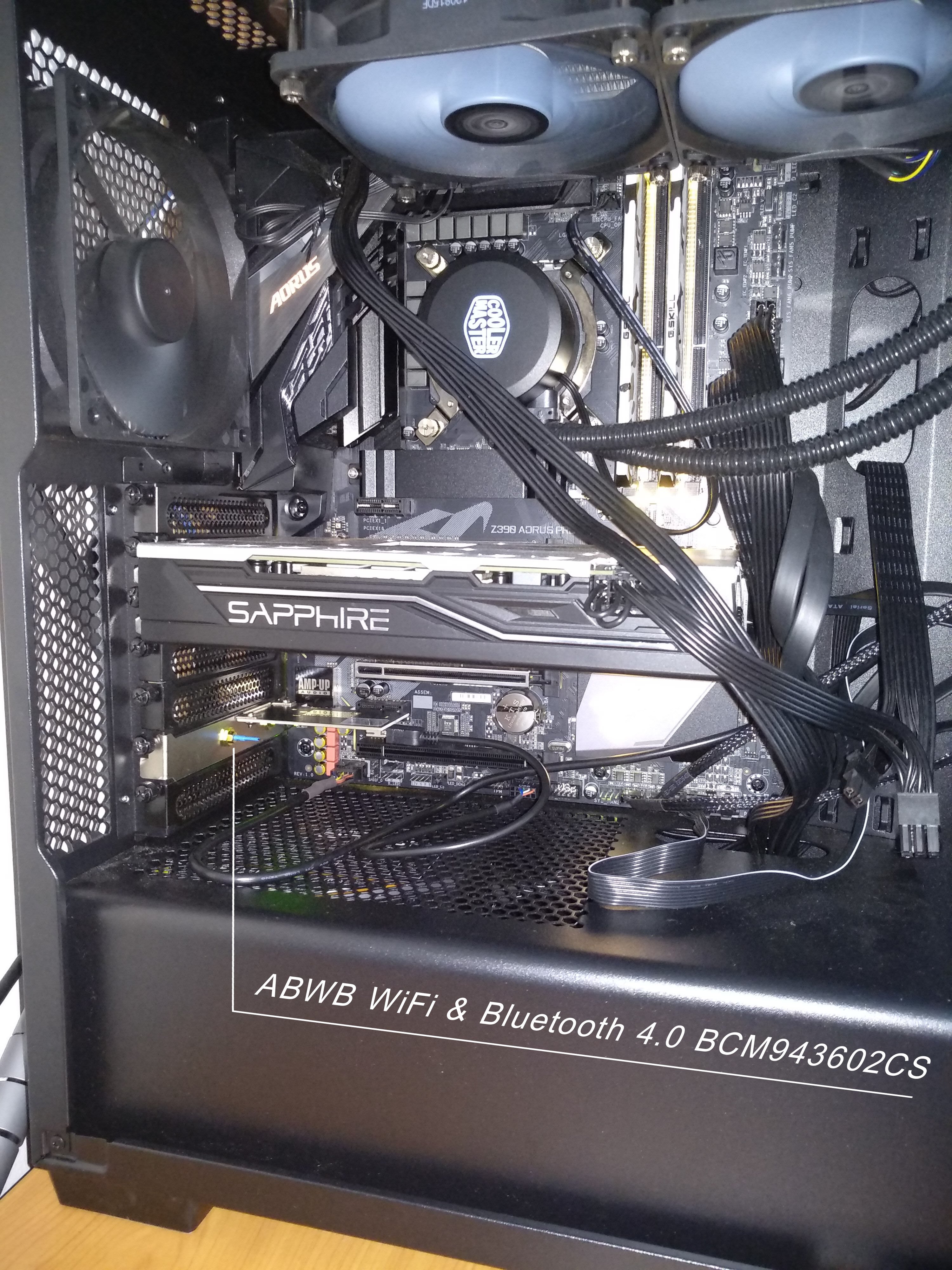

@eSaF
Not exactly sure how many antennas @panosru has on his wifi / bluetooth combo card. The image I used was used for point of reference regarding antennas. Good to know, regarding your previous experience with PCIe adapters with less than 4 antennas.
I'm using a BCM94331CD from an iMac ( it required AirportBrcmFixup.kext ) with PCI-e adapter and don't have any problems with sleep / lag. :)

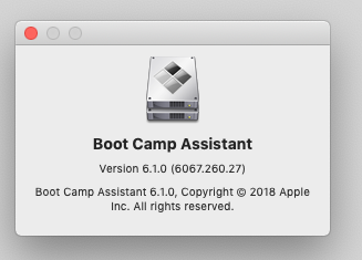

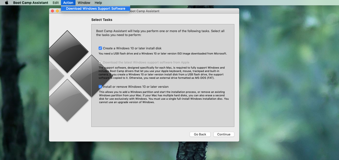

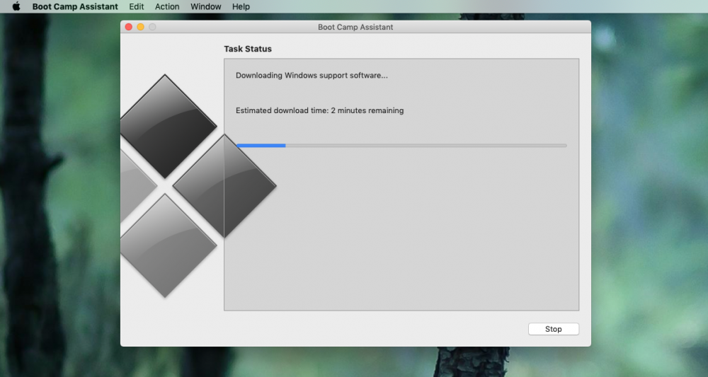

Are you dual booting with windows? The reason I am asking I am searching for version 6 Bootcamp drivers but cannot get hold of them.

@glasgood and @eSaF
First thanks a lot for taking the time to help me troubleshoot that issue! I appreciate it!
The card I bought is this:
I bought it from Amazon here: https://www.amazon.de/gp/product/B00MBP25UK/ref=ppx_yo_dt_b_asin_title_o00_s00?ie=UTF8&psc=1
It has two antennas. I'm not using WiFi, I'm connected with my Ethernet cable but on testings I did, the WiFi works fine.

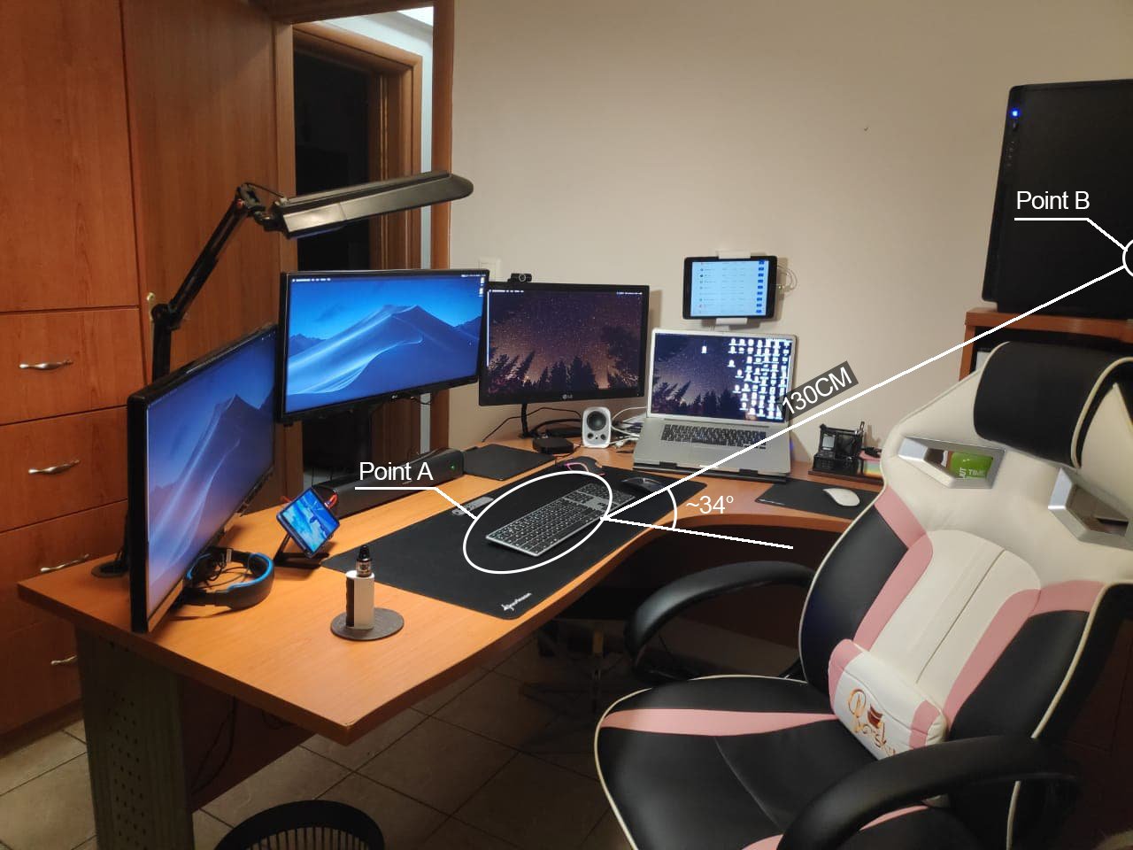

My Hackintosh is about 130 - 140 meters away from my workspace with an angle of about 34 degrees (from point A my workspace where I have my kb and mouse and point B the position of my card).
I just disconnected all devices from the computer and left only my wired keyboard, my wired mouse, my Bluetooth keyboard and Bluetooth mouse, so far is laggy, I will give it a bit more time for testing.
I haven't tried to place it under the desk below the workspace, I will do that for testing, but to apply it I will have to disassemble the furniture and remove the wires because I did some hard cable management to embed everything...
I have two USB dongles, and I tested them on both USB 2 and USB 3.
Handoff is disabled.
I already did a test with one monitor only, but still the same.
When I connect only one device, for instance, my mouse, it starts to work fine, some times for few seconds some times for few minutes, but after, e.g. 5 minutes, the lag comes back.

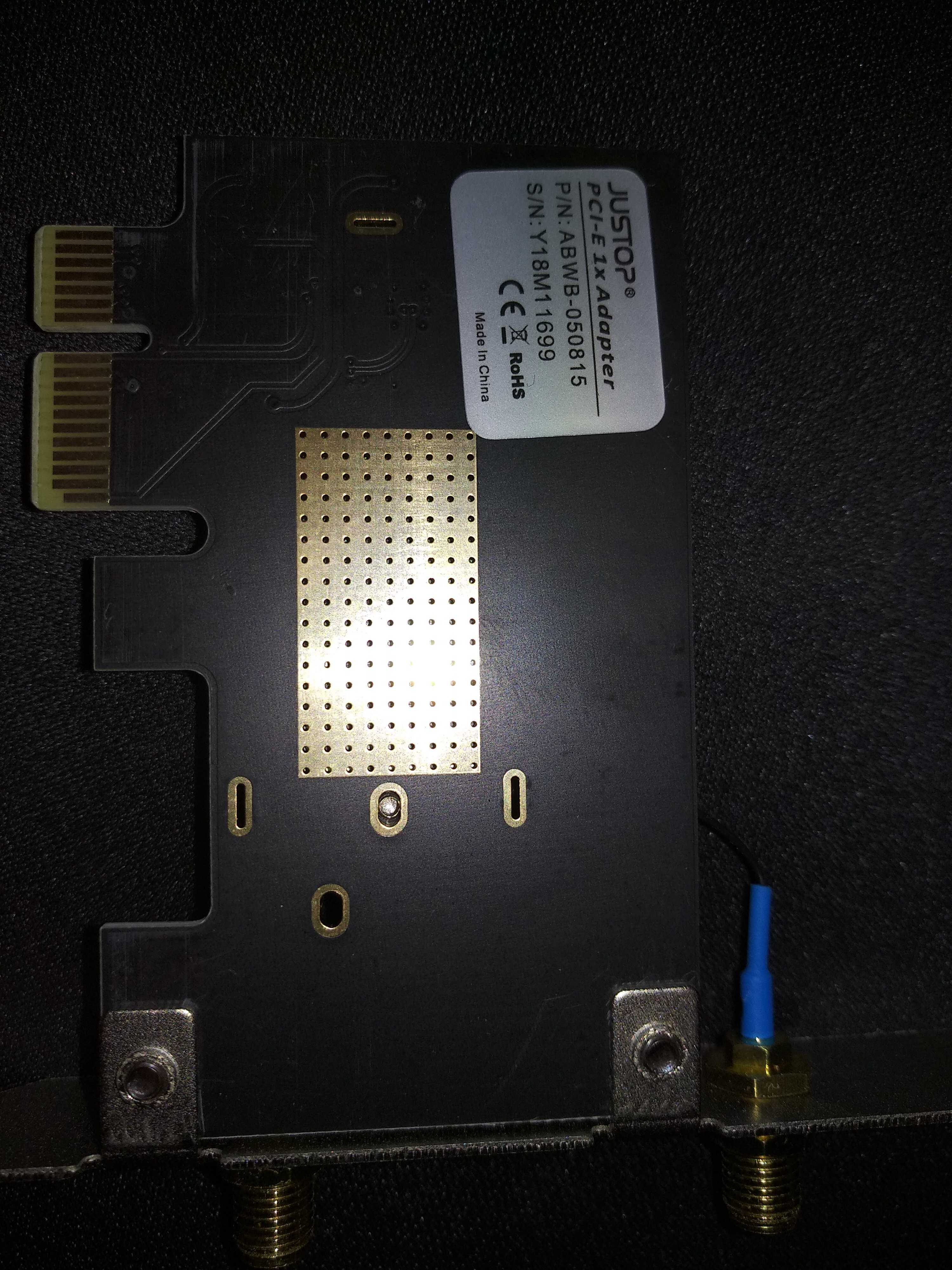

I haven't tried to disconnect the antenna cables and switch position; I will try it, could you explain to me a bit more what exactly should I detach and which cable place where?
@eSaF , I'm not that good with soldering, I'm afraid I might damage the card :(
I will turn off the computer now and remove the card to take some closeup pictures and upload them here.
Thanks!!!

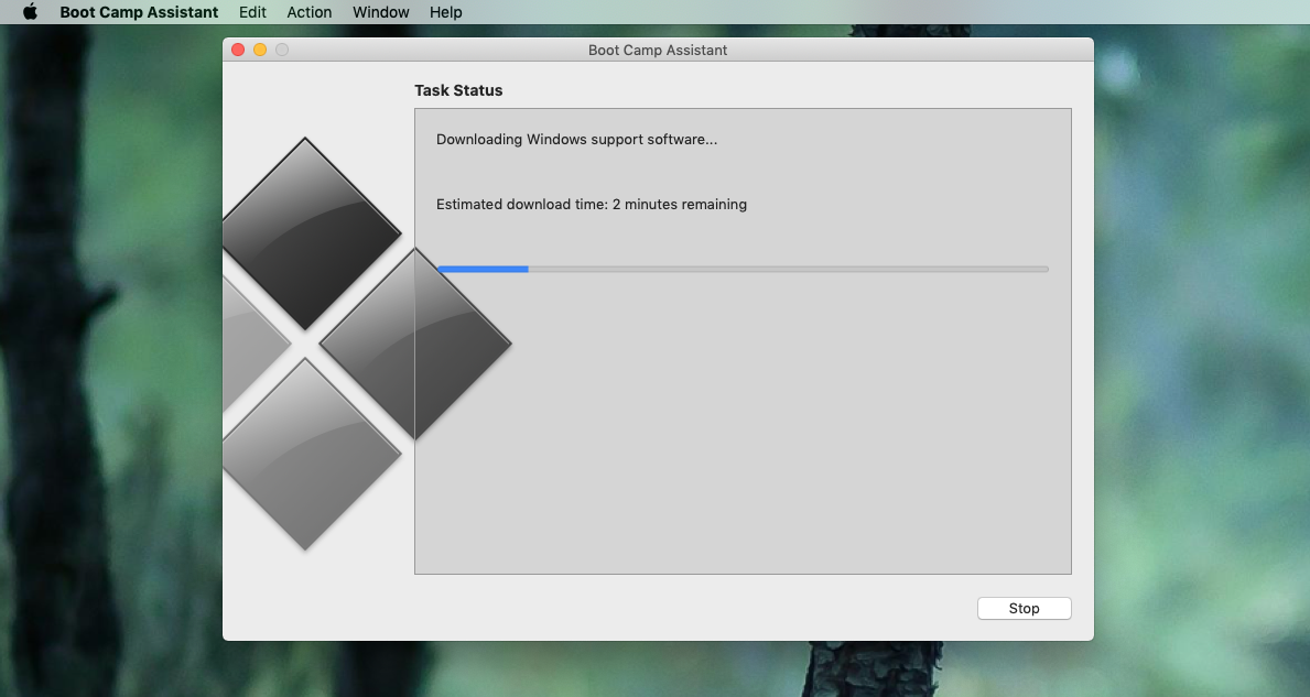

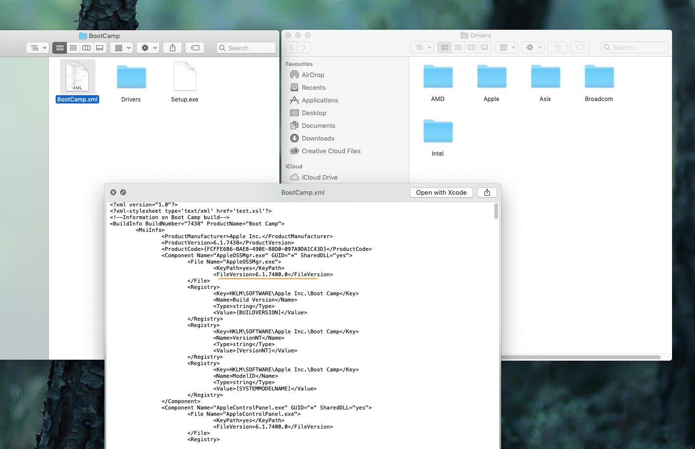

Download via bootcamp:
1767381576_Screenshot2019-05-31at12_37_49.thumb.png.9d0d7e5c45838e1fd1e1e38af079c337.png
2017709110_Screenshot2019-05-31at12_38_05.thumb.png.b5be2abfb3e186a0b8661e42a3ea4efc.png
198836733_Screenshot2019-05-31at12_43_24.thumb.png.dc8289253276383f00ee9bf472a8114f.png
Edited by glasgood

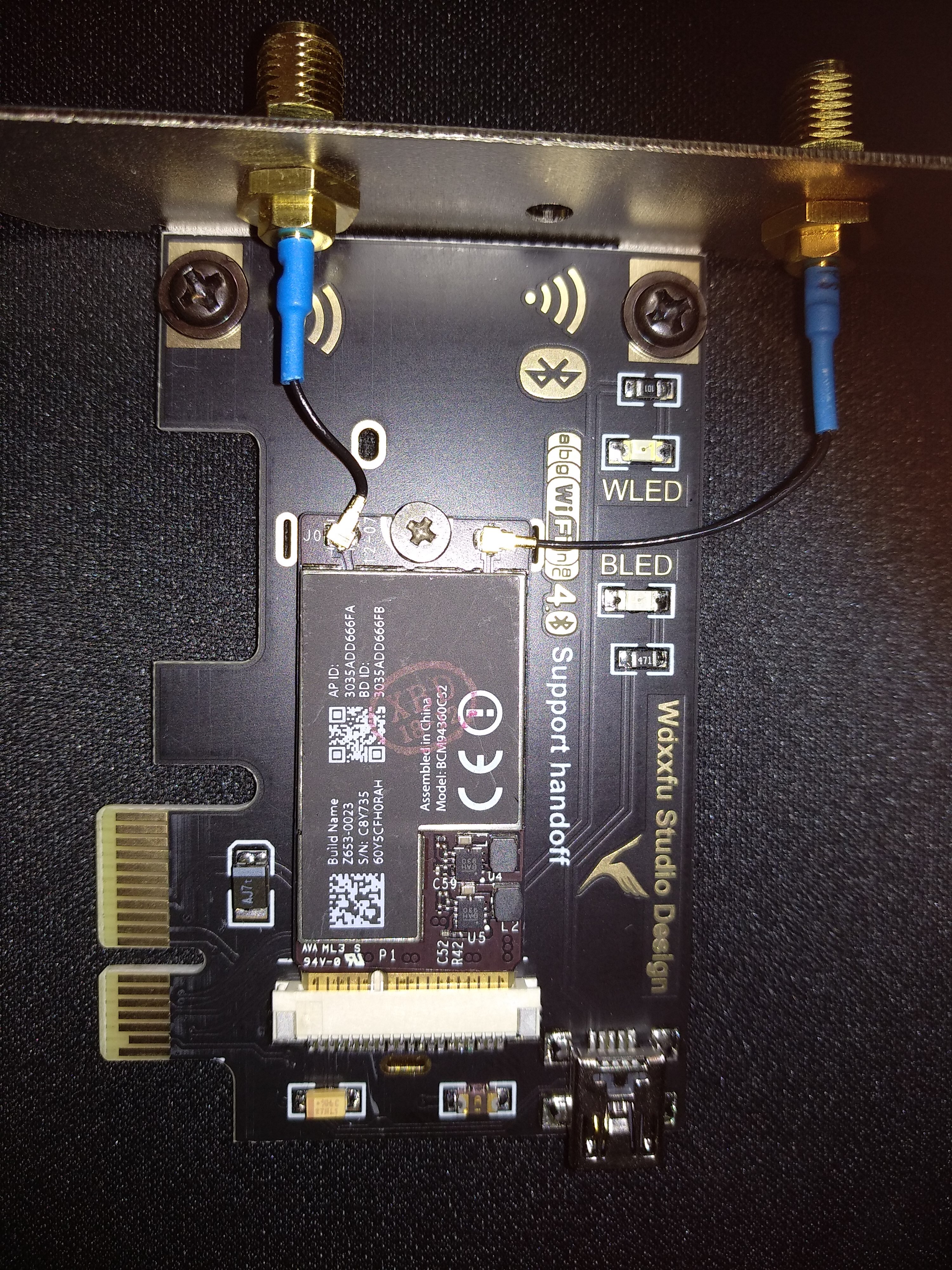

I took some photos from the card, and I don't think there is a way to remove the cables or swap them, they seem to be fitter there
@panosru
Antenna look like they are firmly connected to wifi module.
Try,
Place Hackintosh on floor, under desk, directly below keyboard and power off MacBook. Power up Hackintosh computer with only essentials connected such as keyboard and mouse. And test if lag persists.
@glasgood I put the computer under the desk and so far I haven't encountered any lag with any of my devices...
At that point is feeling that combines joy and sadness together...
What I will try now to do is to put back my TP-Link WiFi card which works fine for the WiFi, remove the ABWB card, and place a USB3 hub under my desk (which is already there) and mount a Bluetooth USB dongle on it (ASUS BT-400) and see if that will do the trick, so I could have my computer there where I intended to place it and the USB dongle under the desk, it might do the trick..
So possibly related to poor signal strength from WiFi combo card. If you can, don't rush yet to change anything. Confirm latest set up with no lag is good before changing anything else.
