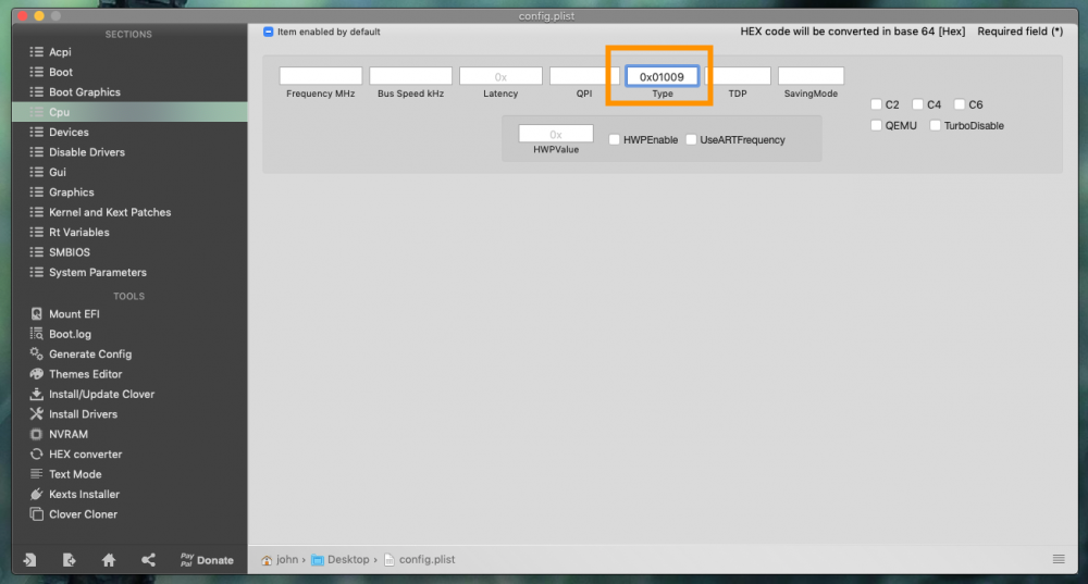

FTFT1234 Posted May 26, 2019 Share Posted May 26, 2019 I've followed this guide a month or so ago and got my whole system up and running flawlessly. Thanks @glasgood! However, yesterday I've updated from macOS 10.14.4 to 10.14.5 and now I have a problem. When booting the progress bar underneath the apple logo gets to around 75 percent, but then my monitor loses signal. It takes 20 - 30 seconds before the monitor gets a new signal with the login screen being shown. Other than this everything works perfect. My system specs are: Motherboard: Gigabyte Z390 AORUS PRO Processor: Intel Core i7-9700K Graphics: IGPU (UHD630) RAM: 16 GB Storage: SAMSUNG SSD 830 Series SMBIOS: iMac18,1 Do you guys know, what the problem could be? Of course the Framebuffer patches are in my config.plist, I didn't change anything there before or after updating to 10.14.5. Oh, and something funny I've noticed: Since updating to 10.14.5 in the About this Mac section it says I have a 3,6 GHz Intel Core i9, but as you can see in my specs list, it's an i7. I guess that comes from the new iMacs not having a 9th gen i7 but an i9 instead. Link to comment Share on other sites More sharing options...
glasgood Posted May 26, 2019 Author Share Posted May 26, 2019 1 hour ago, FTFT1234 said: I've followed this guide a month or so ago and got my whole system up and running flawlessly. Thanks @glasgood! However, yesterday I've updated from macOS 10.14.4 to 10.14.5 and now I have a problem. When booting the progress bar underneath the apple logo gets to around 75 percent, but then my monitor loses signal. It takes 20 - 30 seconds before the monitor gets a new signal with the login screen being shown. Other than this everything works perfect. My system specs are: Motherboard: Gigabyte Z390 AORUS PRO Processor: Intel Core i7-9700K Graphics: IGPU (UHD630) RAM: 16 GB Storage: SAMSUNG SSD 830 Series SMBIOS: iMac18,1 Do you guys know, what the problem could be? Of course the Framebuffer patches are in my config.plist, I didn't change anything there before or after updating to 10.14.5. Oh, and something funny I've noticed: Since updating to 10.14.5 in the About this Mac section it says I have a 3,6 GHz Intel Core i9, but as you can see in my specs list, it's an i7. I guess that comes from the new iMacs not having a 9th gen i7 but an i9 instead. Hi, not sure what is causing monitor to lose signal briefly. Maybe updating to latest Clover version could resolve this. You could try testing SMBIOS 19,1. To correct cpu type: 4 hours ago, AudioGod said: Ah yes the white mains power up flash. That's normal with asus and gigabyte boards. I've been seeing that for many years now. I don't think it's a fault of any sort though. Il double check but I'm pretty sure it's a little power on self test of some sort. Update - what's happening is when erp is enabled and you power up from the mains for the first time the psu is briefly allowing power though the system before the erp kicks in and shuts everything off. The reverse effect is too have something that lights up hooked into a USB slot and shut down the system with erp off and the lights will remain lit up in the USB device because erp hasn't kicked in and shut off the USB power fully. If you like to charge stuff with the system off via USB then leave erp disabled but if like me you have loads of stuff hooked up via USB and more so if it lights up or is rgb then leave it enabled or power keeps going to the devices even though the system is off. I hope that helps buddy. Thanks for explaining, I decided to keep erp disabled on my hack 2 Link to comment Share on other sites More sharing options...
AudioGod Posted May 26, 2019 Share Posted May 26, 2019 1 hour ago, glasgood said: Hi, not sure what is causing monitor to lose signal briefly. Maybe updating to latest Clover version could resolve this. You could try testing SMBIOS 19,1. To correct cpu type: Thanks for explaining, I decided to keep erp disabled on my hack I don't like power running though the system while in an off state as it will be pushing a min of 1amp and a few watts though each USB output maybe slightly more. If you plug your phone into the system while it's off does it start charging? if so and it's a modern phone then you know its pushing out more, I don't like the thought of that.. lol Link to comment Share on other sites More sharing options...
FTFT1234 Posted May 26, 2019 Share Posted May 26, 2019 1 hour ago, glasgood said: Hi, not sure what is causing monitor to lose signal briefly. Maybe updating to latest Clover version could resolve this. You could try testing SMBIOS 19,1. To correct cpu type: Thanks for explaining, I decided to keep erp disabled on my hack Thanks! Switching to iMac19,1 did the trick for me Changing the cpu type didn't do it for me, but that's okay, it doesn't bother me as it doesn't affect the performance in any way. Thank you! Link to comment Share on other sites More sharing options...

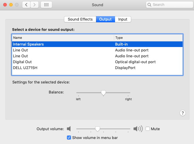

Charles375 Posted May 27, 2019 Share Posted May 27, 2019 2 hours ago, glasgood said: @mfortuna What EFI folder are you using, intel or RX580, and does your machine now have RX580 ? @Charles375 Attach efi. Here it is, I removed Firmware.scap to save space EFI Charles no sound.zip Link to comment Share on other sites More sharing options...

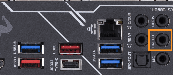

glasgood Posted May 27, 2019 Author Share Posted May 27, 2019 (edited) 1 hour ago, Charles375 said: Here it is, I removed Firmware.scap to save space EFI Charles no sound.zip @Charles375 Realtek ALC1220-VB has layout-id 1 (Audio Inject = 1) on Aorus Z390 Pro. No need to use realtekALC.kext and AppleALC.kext at same time. EFI Charles no sound.zip Best! Edited May 27, 2019 by glasgood Link to comment Share on other sites More sharing options...
Charles375 Posted May 27, 2019 Share Posted May 27, 2019 37 minutes ago, glasgood said: @Charles375 Realtek ALC1220-VB has layout-id 1 (Audio Inject = 1) on Aorus Z390 Pro. No need to use realtekALC.kext and AppleALC.kext at same time. EFI Charles no sound.zip Best! Thank you, I've tried all layouts (and the EFI you re-sent me) but nothing works, I still have only HDMI Output in Sound Preferences Link to comment Share on other sites More sharing options...
glasgood Posted May 27, 2019 Author Share Posted May 27, 2019 19 minutes ago, Charles375 said: Thank you, I've tried all layouts (and the EFI you re-sent me) but nothing works, I still have only HDMI Output in Sound Preferences @Charles375 Test speakers connected to Line Out jack ? And change sound pref to Internal Speakers. Link to comment Share on other sites More sharing options...
