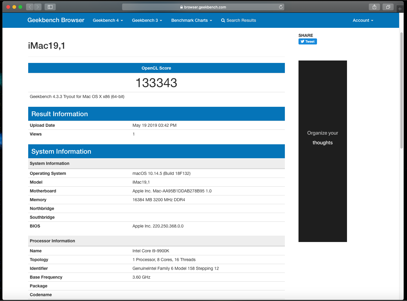

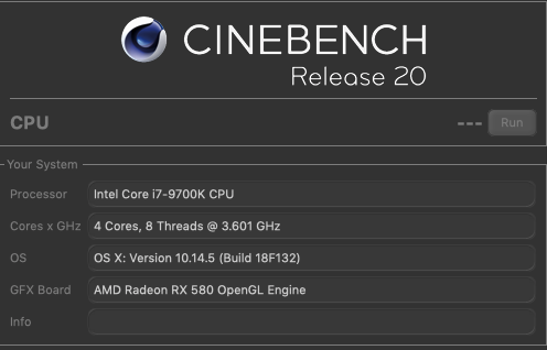

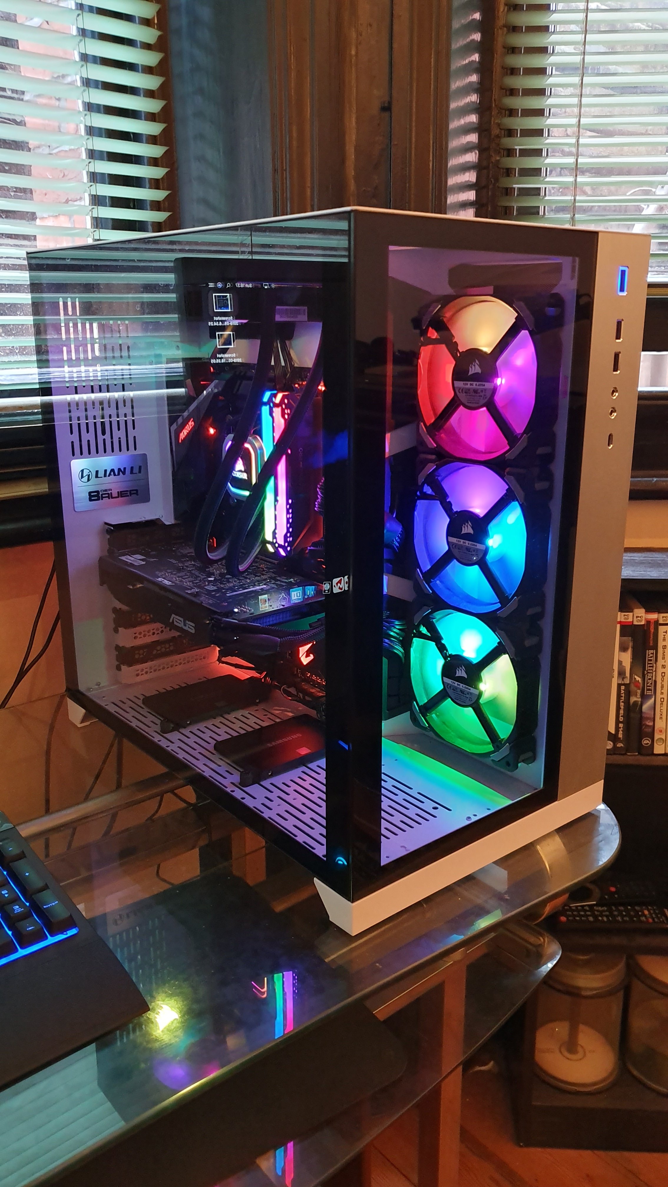

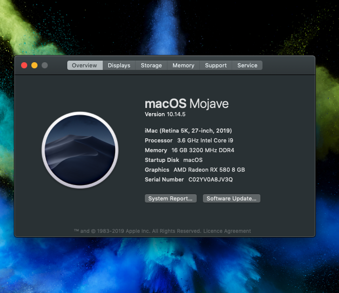

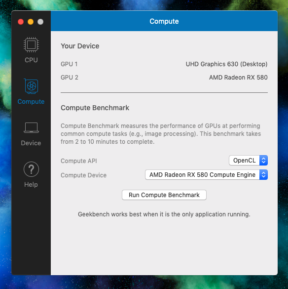

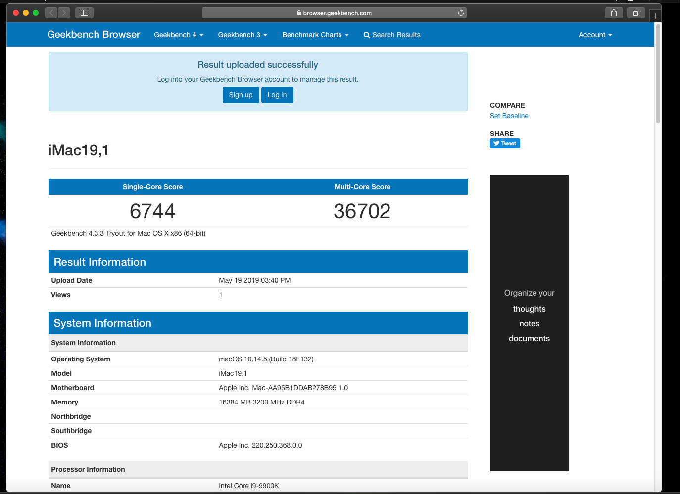

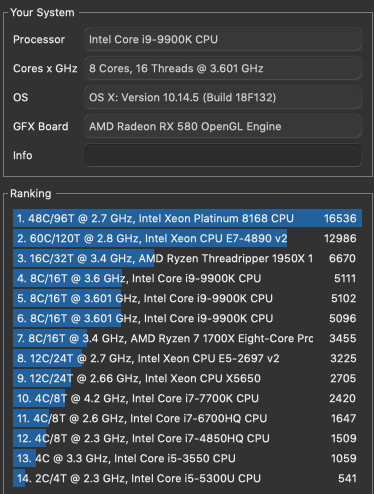

AudioGod Posted May 19, 2019 Share Posted May 19, 2019 Hi Buddy I thought you might like to see what I've been working on for the past few days as she's now 100% finished and booted and ready for a hard days graft tomorrow...lol I hope you like it buddy, you helped me make it perfect 2 Link to comment Share on other sites More sharing options...
glasgood Posted May 19, 2019 Author Share Posted May 19, 2019 (edited) 21 minutes ago, AudioGod said: Hi Buddy I thought you might like to see what I've been working on for the past few days as she's now 100% finished and booted and ready for a hard days graft tomorrow...lol I hope you like it buddy, you helped me make it perfect @AudioGod Awesome Your whole setup looks amazing, and fantastic benchmarks! Thanks for sharing your success Edited May 19, 2019 by glasgood 1 Link to comment Share on other sites More sharing options...

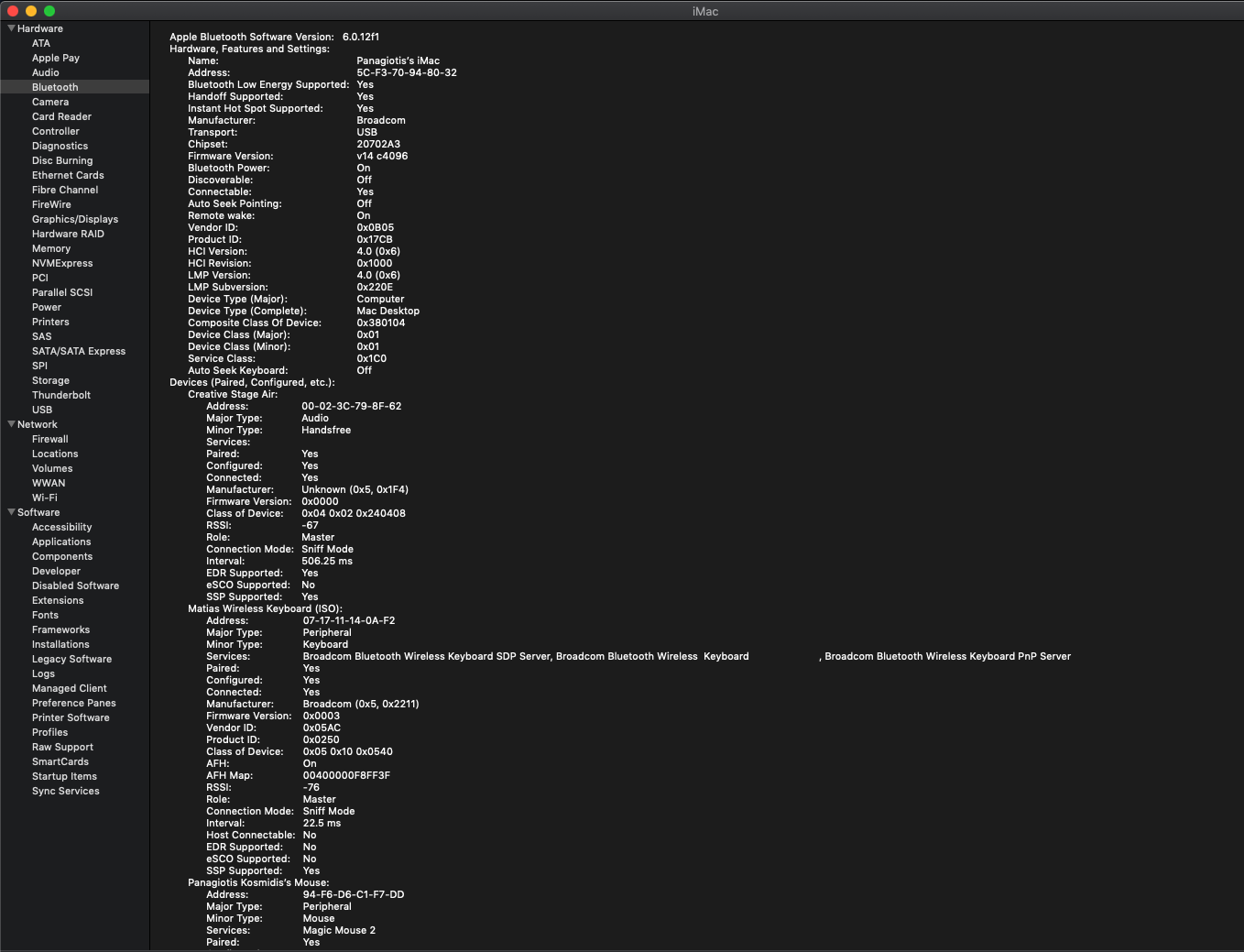

panosru Posted May 19, 2019 Share Posted May 19, 2019 @glasgood thank you for the detailed guide! It was more than perfect! I was struggling couple of days, ready to give up and bumped on your guide, started the whole process from scratched and got it working, a few questions and issues I have are the following: 1. How I could tell that USB 3 is actually working with USB 3 speed? 2. When I try to run Cinebench R20, my CPU is not recognised 3. My main issue is that my bluetooth is not working properly, I have ASUS BT-400 dongle but my Magic Mouse 2 is very laggy, my Matias wireless keyboard is so laggy to the point that makes it unusable, every time I reboot I have to re-pair my creative bluetooth sound-bar, and I'm not sure what should I do to fix that issue. I shut-down my MacBook Pro, turned off my routers and WiFi to make sure that it has nothing to do with signal interference, I tested all those products with the same bluetooth dongle on my MacBook Pro and they all work fine... I am attaching here my clover, please point me to the right direction to solve that last issue I got because I'm struggling two days already only on trying to find a solution for my bluetooth problem. Thank you in advance! CLOVER.zip Link to comment Share on other sites More sharing options...
AudioGod Posted May 19, 2019 Share Posted May 19, 2019 42 minutes ago, glasgood said: @AudioGod Awesome Your whole setup looks amazing, and fantastic benchmarks! Thanks for sharing your success Thanks buddy and thank you for all your help. I couldn't of done it as perfect as it is without you so props too you sir! Tempted to overclock it now but resisting the urge hahaha 1 Link to comment Share on other sites More sharing options...
glasgood Posted May 19, 2019 Author Share Posted May 19, 2019 42 minutes ago, panosru said: @glasgood thank you for the detailed guide! It was more than perfect! I was struggling couple of days, ready to give up and bumped on your guide, started the whole process from scratched and got it working, a few questions and issues I have are the following: 1. How I could tell that USB 3 is actually working with USB 3 speed? 2. When I try to run Cinebench R20, my CPU is not recognised 3. My main issue is that my bluetooth is not working properly, I have ASUS BT-400 dongle but my Magic Mouse 2 is very laggy, my Matias wireless keyboard is so laggy to the point that makes it unusable, every time I reboot I have to re-pair my creative bluetooth sound-bar, and I'm not sure what should I do to fix that issue. I shut-down my MacBook Pro, turned off my routers and WiFi to make sure that it has nothing to do with signal interference, I tested all those products with the same bluetooth dongle on my MacBook Pro and they all work fine... I am attaching here my clover, please point me to the right direction to solve that last issue I got because I'm struggling two days already only on trying to find a solution for my bluetooth problem. Thank you in advance! CLOVER.zip Hi, I think you can measure speed of devices using Blackmagic Disk Speed Test. Looks like your information is missing inside your config.plist for CPU. Looks like you may have overwritten, deleted the Property values contained inside my config.plist for Intel CPU My config.plist has the following: Here is the config.plist from above. >>config.plist you can use the Property Values. Regarding Bluetooth. RECOMMENDED WIFI CARD → ABWB 802.11AC WI-FI With Bluetooth 4.0 PCI-Express (PCI-E) BCM943602CS Link to comment Share on other sites More sharing options...
AudioGod Posted May 19, 2019 Share Posted May 19, 2019 Hey pal just a quick note for you, if you disable render standby in the bios your get much better fps with the 580 and a general boost in your scores. I was meaning to say this the other day but my head was in to deep with my system. Also your safe to update to the latest bios on your board. I'm running and did the USB routing with revision F9. I hope that helps buddy 1 Link to comment Share on other sites More sharing options...

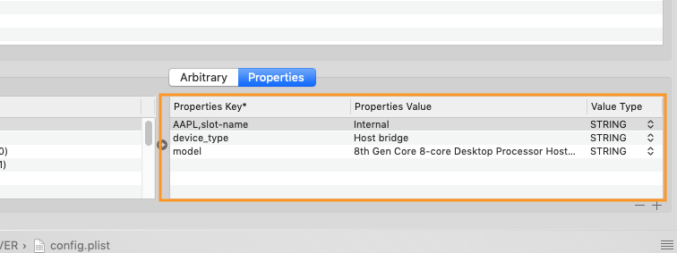

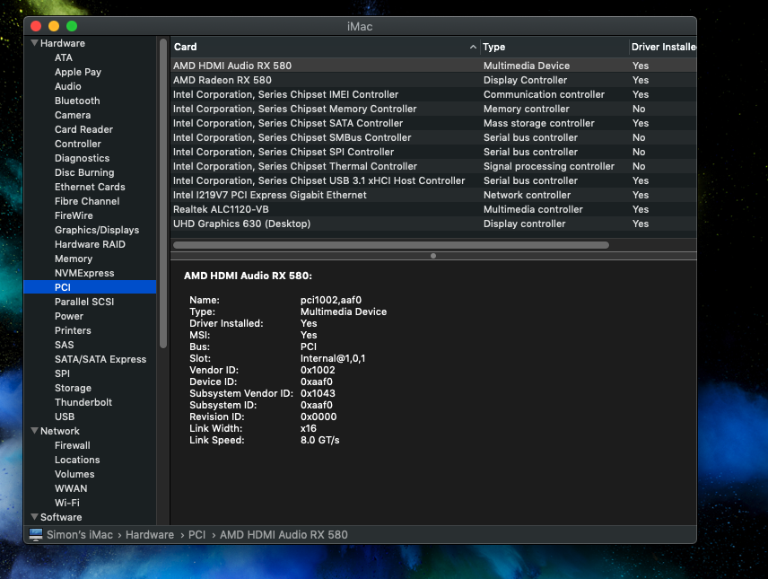

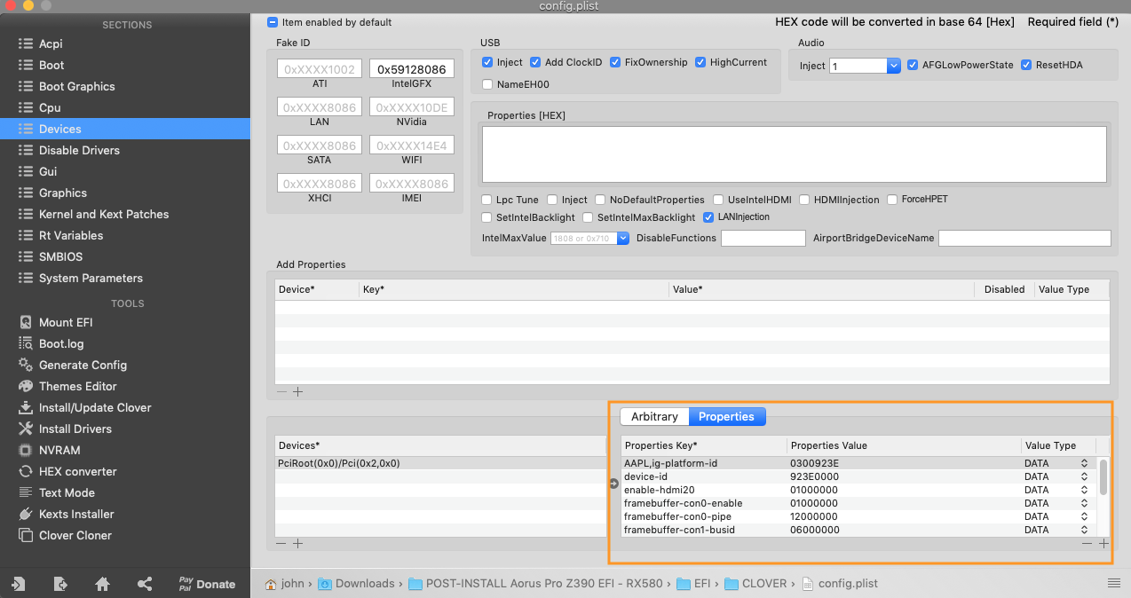

panosru Posted May 19, 2019 Share Posted May 19, 2019 (edited) @glasgood thank. you for your reply! I have followed your guide on Populating System Information - PCI via config.plist using Hackintool so indeed I have changed the properties on that section, as pre your guide's steps, I replaced them with ones from hackintool. The "About This Mac" window shows "Processor 3.6 GHz Intel Core i7", in System Report for CPU I get this: Processor Name: Intel Core i7 Processor Speed: 3.60 GHz Number of Processors: 1 Total Number of Cores: 8 But on Cinebench I see this: I used Blackmagic speed test, I'm not sure what speeds are equivalent to USB 3, for instance I was getting around 120MB/s write and 140MB/s read, for another USB 2 disk I was getting around 40MB/s write/read, so I assume USB 3 works properly right? For the bluetooth card, I currently have TP-Link Archer T6E for WiFi which works great, ASUS BT-400 should also work fine since many other people use it and it works, but from the guides I found, many mention to use BrcmPatchRAM2.kext and BrcmFirmwareRepo.kext on /L/E, but honestly I don't have a clue what the /L/E is and where to put those kexts, so before I give up on BT-400 and Archer T6E, maybe you could point me to the right direction so I could try to fix the issue without having to pay extra for new hardware and leave the one I have already bought unused? This is my bluetooth section from system report: Much appreciate it! Thank you! PS: Should I update to F9 bios or I should stay with F8? Edited May 20, 2019 by panosru Link to comment Share on other sites More sharing options...
glasgood Posted May 20, 2019 Author Share Posted May 20, 2019 7 hours ago, panosru said: @glasgood thank. you for your reply! I have followed your guide on Populating System Information - PCI via config.plist using Hackintool so indeed I have changed the properties on that section, as pre your guide's steps, I replaced them with ones from hackintool. The "About This Mac" window shows "Processor 3.6 GHz Intel Core i7", in System Report for CPU I get this: Processor Name: Intel Core i7 Processor Speed: 3.60 GHz Number of Processors: 1 Total Number of Cores: 8 I used Blackmagic speed test, I'm not sure what speeds are equivalent to USB 3, for instance I was getting around 120MB/s write and 140MB/s read, for another USB 2 disk I was getting around 40MB/s write/read, so I assume USB 3 works properly right? For the bluetooth card, I currently have TP-Link Archer T6E for WiFi which works great, ASUS BT-400 should also work fine since many other people use it and it works, but from the guides I found, many mention to use BrcmPatchRAM2.kext and BrcmFirmwareRepo.kext on /L/E, but honestly I don't have a clue what the /L/E is and where to put those kexts, so before I give up on BT-400 and Archer T6E, maybe you could point me to the right direction so I could try to fix the issue without having to pay extra for new hardware and leave the one I have already bought unused? This is my bluetooth section from system report: Much appreciate it! Thank you! PS: Should I update to F9 bios or I should stay with F8? @panosru Base processor speed for the i7-9700K is 3.6GHz and that is what is shown, it should turbo upto 4.90GHz. Sometimes on Hackintosh CPU gets reported 3.601. In "About my Mac" my base processor speed is reported as 3.19GHz and not 3.2GHz, it's is cosmetic. Your USB speeds are working, that is same / similar what to expect on a real Mac. LE is your Library/Extensions folder for kexts ( kernel extensions ) You can automatically open it with following command using Terminal: open . /Library/Extensions/ Or using finder window: Though, those kexts should also work in Clover / kexts / Other folder. I'm still on BIOS F5, if you have a good reason then update. Link to comment Share on other sites More sharing options...

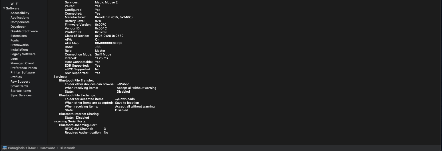

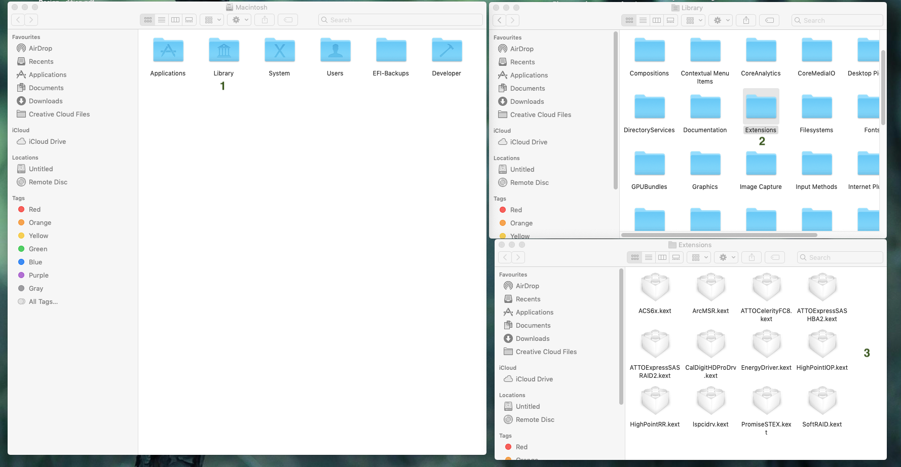

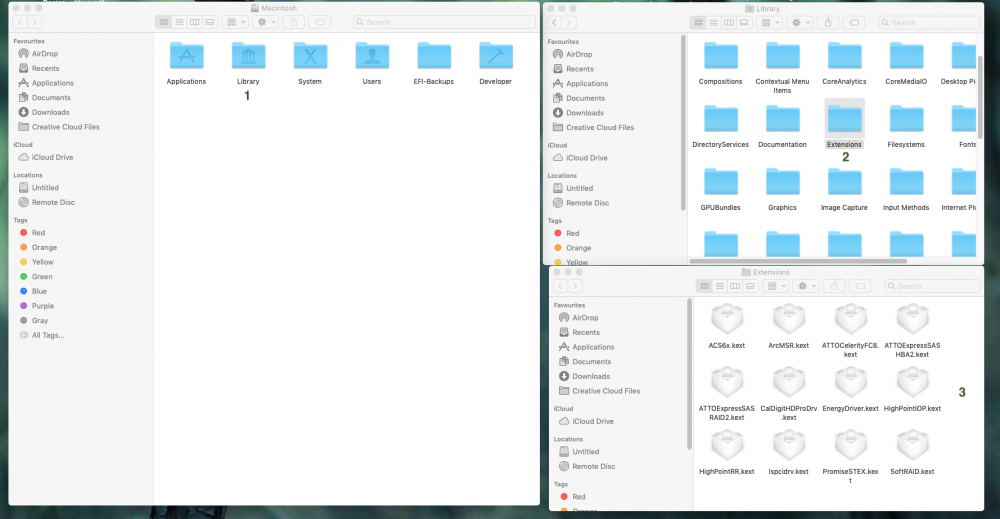

panosru Posted May 20, 2019 Share Posted May 20, 2019 @glasgood Thanks for clarifying me what /L/E/ means, I already put the kexts there, rebooted but the usb still acts like before, its like it works for a few moments, then it starts to have some lag spikes, then some serious lagging, then it works again and the cycle repeats... normally BT-400 should work out of the box, without the need of any additional hacking, if there isn't anything else that I could try, then I'll try to search a bit more online maybe I find something interesting that I haven't so far, otherwise I'll buy the card you suggested and see if that fixes the issue. For the CPU, in BIOS I see that the frequency of the CPU is 4600MHz, so it seems that it synced in 4.6GHz, Cinebench is unable to see my CPU, so I cannot run Cinebench tests. Thanks again for your amazing guide and the time you spend on building it! Link to comment Share on other sites More sharing options...

glasgood Posted May 20, 2019 Author Share Posted May 20, 2019 13 hours ago, AudioGod said: Hey pal just a quick note for you, if you disable render standby in the bios your get much better fps with the 580 and a general boost in your scores. I was meaning to say this the other day but my head was in to deep with my system. Also your safe to update to the latest bios on your board. I'm running and did the USB routing with revision F9. I hope that helps buddy Thanks, will look at it later. Link to comment Share on other sites More sharing options...

glasgood Posted May 20, 2019 Author Share Posted May 20, 2019 (edited) 22 hours ago, AudioGod said: Hey pal just a quick note for you, if you disable render standby in the bios your get much better fps with the 580 and a general boost in your scores. I was meaning to say this the other day but my head was in to deep with my system. Also your safe to update to the latest bios on your board. I'm running and did the USB routing with revision F9. I hope that helps buddy @AudioGod Hi, Peer pressure I just updated BIOS from version F5 to F9, So I tested sleep and audio did not resume after wake from sleep. Can you test ? Put hack to sleep and then on wake, can you hear audio / sound from youtube etc.. I seem to have it fixed, and have attached an SSDT and kext to guide. @AudioGod Late update, completed a fresh install of macOS Mojave on a test drive. Tested sleep and sound. Sound is fully working after wake from sleep, so no need to use CodecCommander.kext and SSDT-ALC1220. Edited May 20, 2019 by glasgood Link to comment Share on other sites More sharing options...
