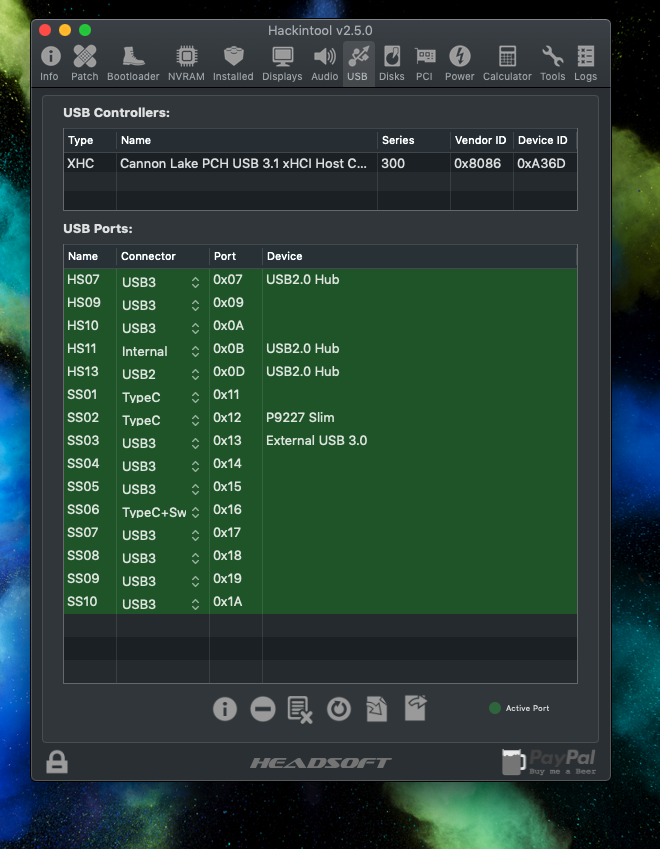

Sorry my mistake its SS01 and SS02 and I see ss03 listed too but nothing is connecting to it when I plug into any of the ports. What's all that about? LoL
Should i do it again and remove ss03 as i don't see its purpose too being there but then why would it of gone green while I was setting up the ports?
Help! LoL

1 minute ago, AudioGod said:
Yeah I see ss01 listed too but nothing is connecting to it when I plug into any of the ports. What's all that about? LoL
Should i do it again and remove ss01 as i don't see its purpose too being there?
Yeah, remove SS01.

7 minutes ago, glasgood said:
Yeah, remove SS01.
Sorry it was SS03 that's not in use but listed not SS01. I updated my old post above listing the correct ports.
Ok so I should  Remove SS03 then?
What is it though?
Do I use the work i did from yesterday on hackintool and just update it?
If I don't need SS03 then I will give the extra port to HS08 so SS07 and SS08 will both be USB 2 and 3 compatible. Hows that sound?
Edited by AudioGod
What is it though?
Do I use the work u did from yesterday on hackintool and just update it?
Here is the  mapping that I know so far, do you have a cable attached on F_USB30C ? if you remove SS01 then you have 14 ports ?  :)

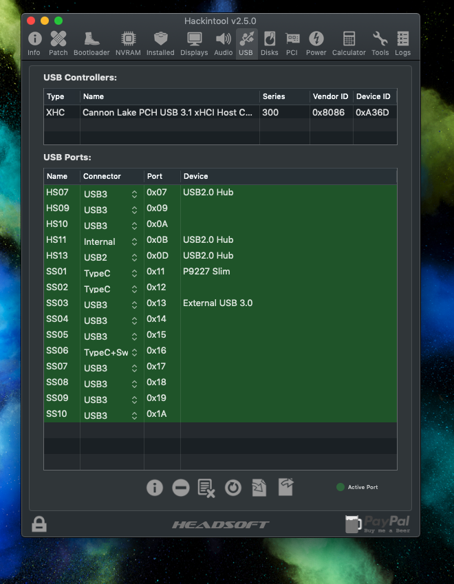

Here's a screen shot of the ports with a USB 3 drive connected too ss03 and my type c drive connected to ss01 and then flipped and connected too ss02
Sorry I posted one screenshot twice and I can't remove it lol sorry

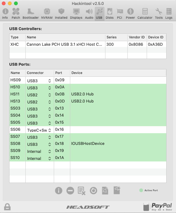

Good, though I initially set SS09 & SS10 connector to internal.  Though It seems it also works when set to USB3.
Here is my Hackintool for my existing SSDT.
  • Thanks 1

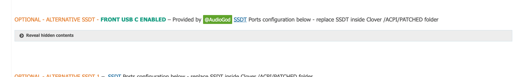

2 minutes ago, AudioGod said:
Omg in totally honoured that you posted my SSDT as an alternative. You just made my day bro. I hope somebody finds it useful :)
Appreciate your fantastic help, I do not have front USB C on my chassis /case. So now everyone using guide will know that SS01 & SS02 are connected to motherboard header F_USB30C.
:thumbsup_anim:Awesome :thumbsup_anim:
Thanks again!

8 minutes ago, AudioGod said:
Ok il do it now buddy thank you. :)
I was just using your SSDT, all good. In my default SSDT, SS09 and SS010 are set as connecter type internal in my Aorus EFI folders. So when I mounted an external drive the icon mounted would show as:
but now using your SSDT with connector set a USB3 external icon is now correctly shown as:
So motherboard internal header F_USB30 has connector type USB3 and is not Internal. Interestingly they both work at correct speed regardless.
Will later include your SSDT inside Aorus Pro EFI folders.
Cheers!
