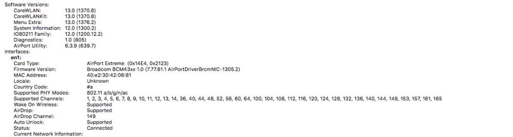

I have just checked in 10.14.3 with the latest AirportBrcmFixup.kext and Lilu.kext, it works.
Yes , I know that.
I want to change country code without using airportfixup.kext , since my card is nativerly supported.

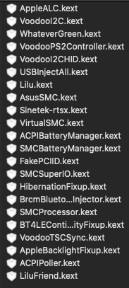

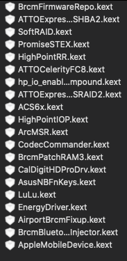

Here is my config and all the kexts I have in L/E (first pic,) and Clover (second pic):
config.plist
EDIT: Just noticed I have a dupe kext, BrcmBluetoothInjector lol.
