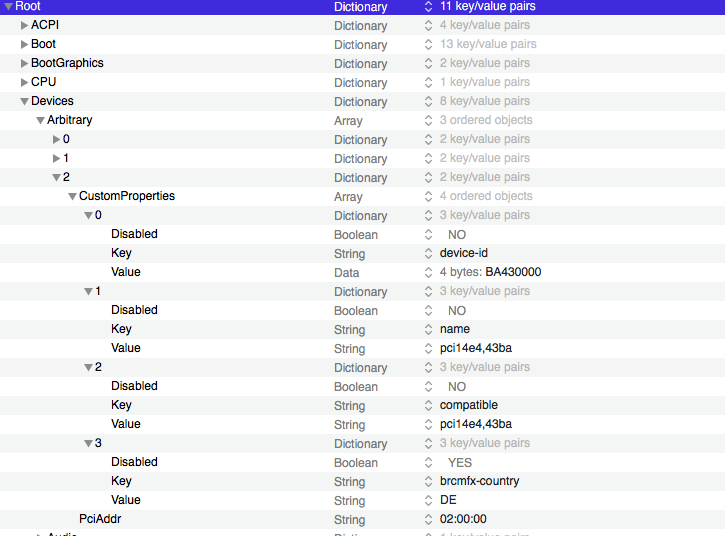

Could you try the attached version?
On the screenshot you will find the working example how to fake id to 43ba (my original is 43b1).
I don't have any additional patches/settings in config.plist for Wi-Fi.

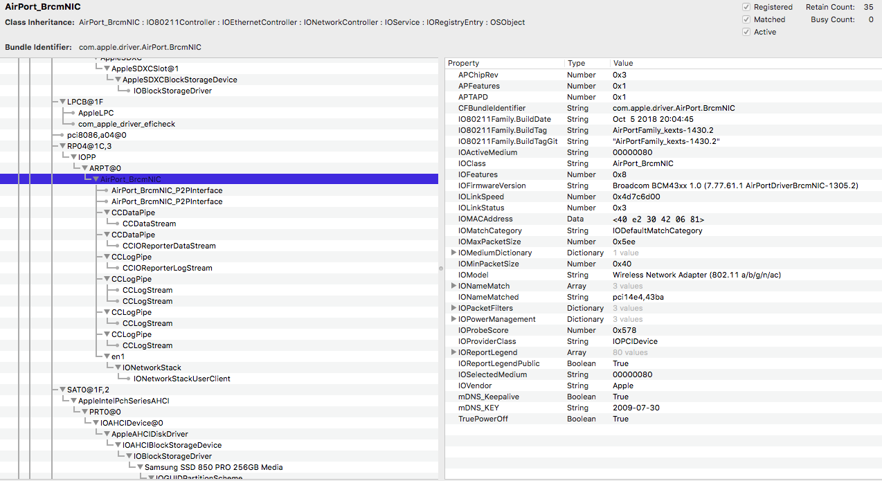

I also can choose a driver: brcmfx-driver=0, and in IOReg I see AirPort_BrcmNIC-MFG,
brcmfx-driver=2, and in IOReg I see AirPort_BrcmNIC.
In logs I can see that 43b1 is replaced with 43ba.
If you can't get this card working in Mojave, may be it worth to try with 10.13.6...

it wasn’t booting before because I did not see you were using data on property 0 and CCG defaults to string.
booted this time set as 43a3 and the results in io jones are reporting as 43a3.
43a3

Now I see that AirportBrcmFixup worked properly, and it managed to load AirPortBrcmNIC-MFG and AirPortBrcmNIC depending on brcmdx-driver.
BTW: if you see kext in kextstat, it does not necessarily mean it is started, it also can be a case that it was loaded and tried to start, but was stopped. Only class name in ioreg tells the true about which driver exactly is started.

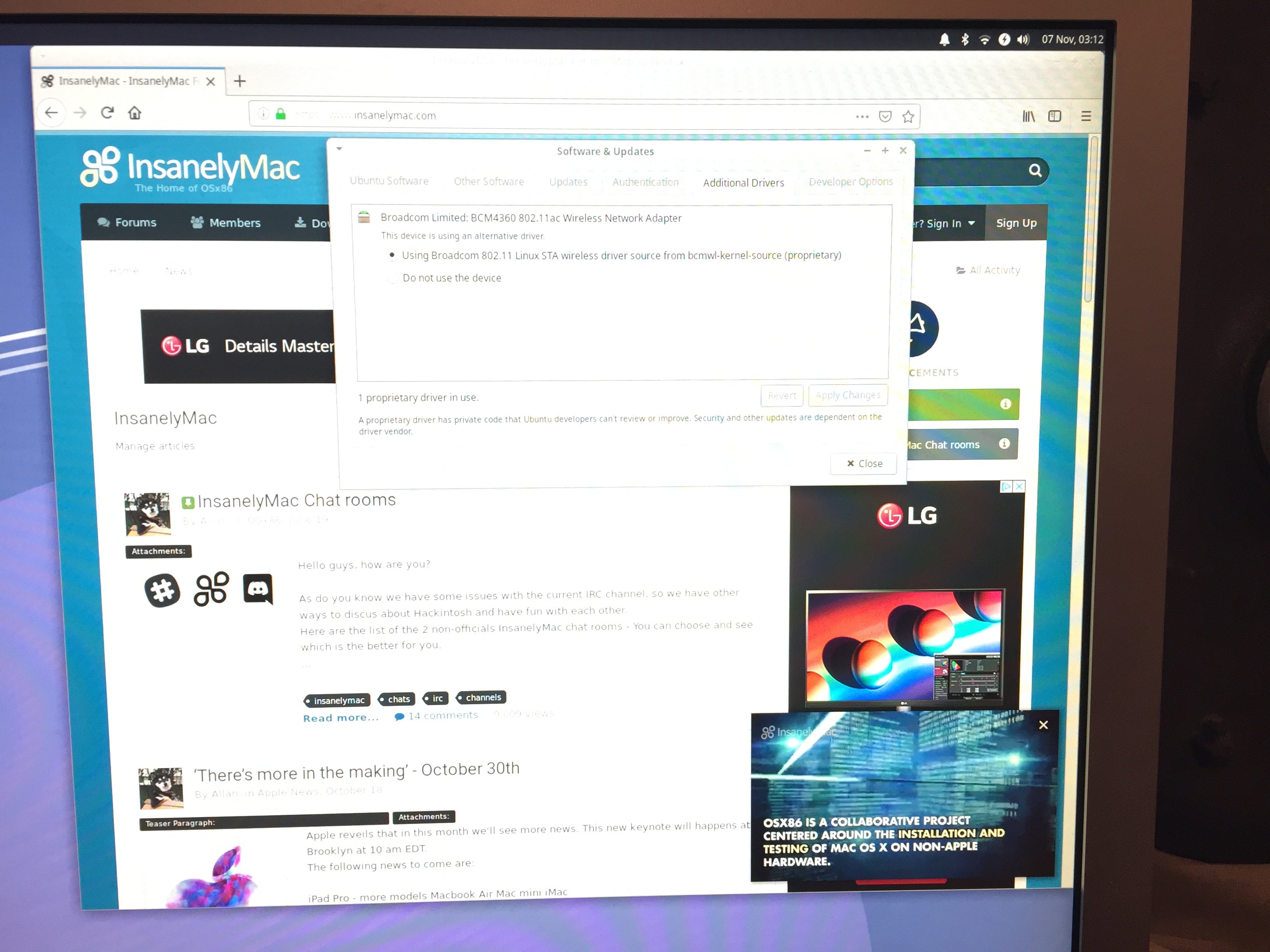

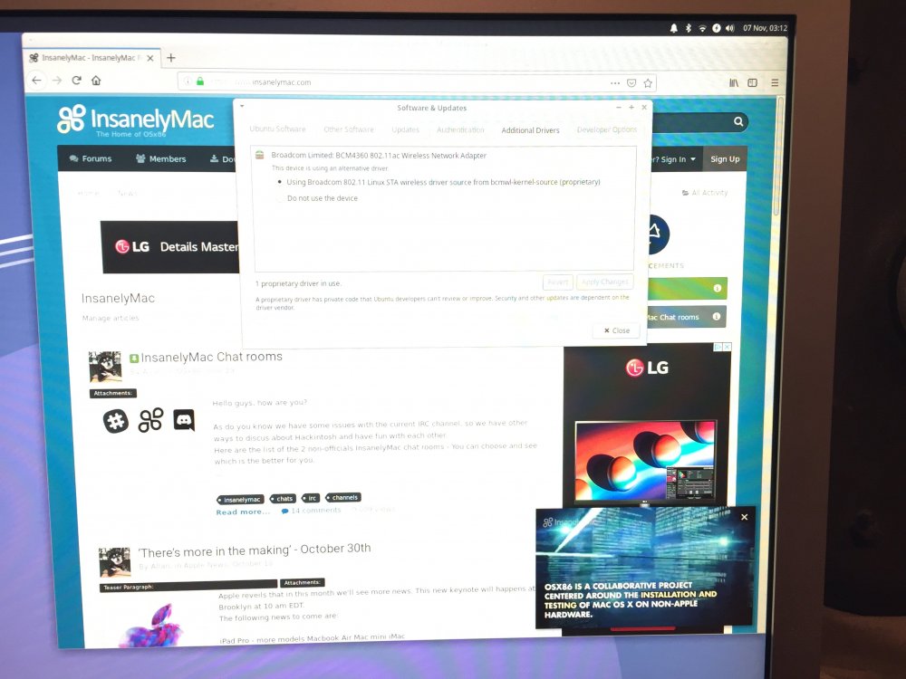

I’ll look into that, I can boot with Linux and I’m sure the card will work. Fairly confident it’s macos blocking the card.
with the Broadcom Linux sta driver it is working fine on xubuntu 18.04 or 18.10.
i can test high Sierra 10.13.6, I do not have an installer available for anything older.

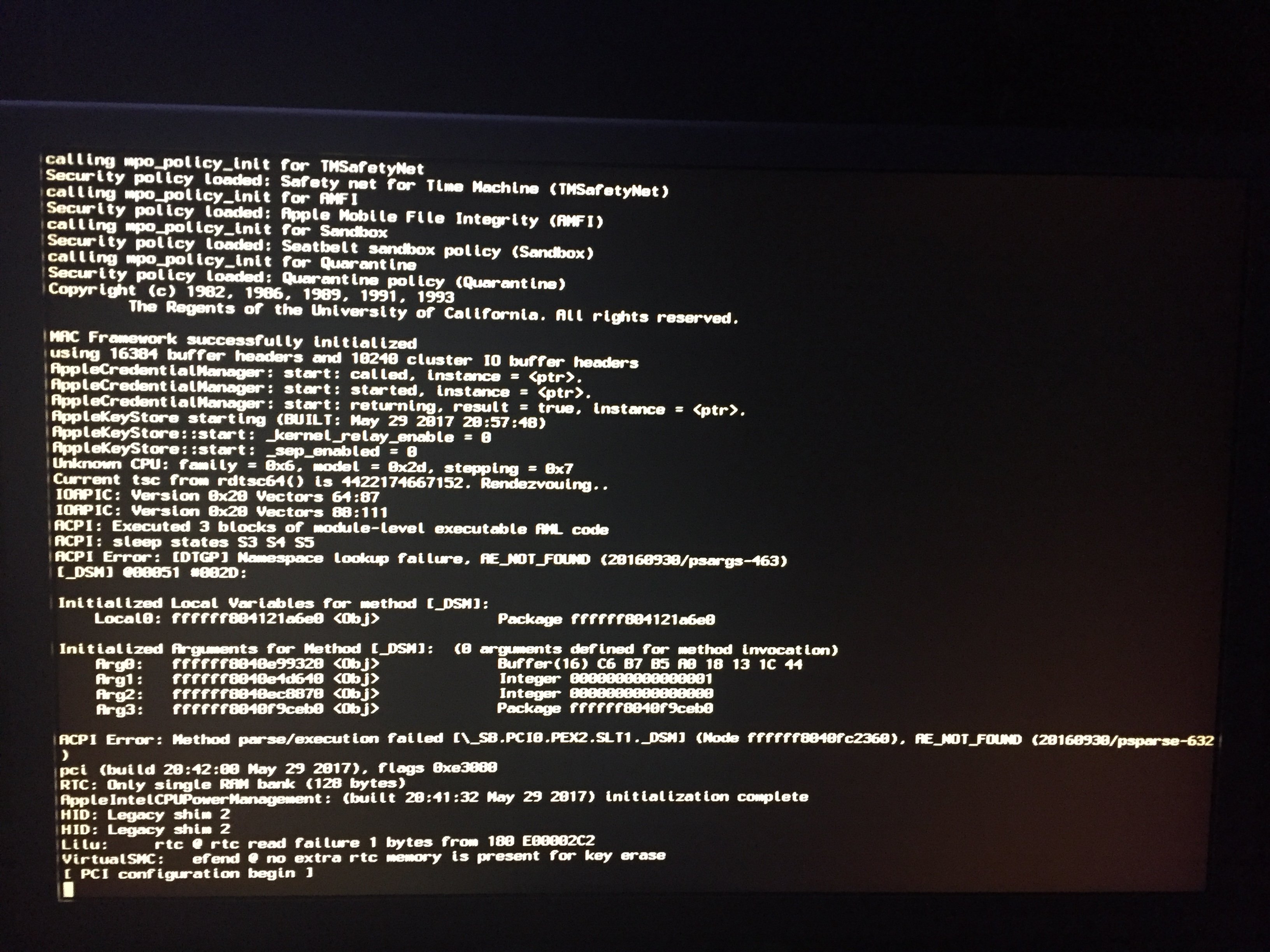

@lvs1974
it continues to reboot, patches are disabled and fixup is removed.
its only booted once to desktop and since then it will no longer boot.
i would say it seems to not like my dsdt, but it wasn’t an issue before.
I’ve tried booting in safe mode as well, Mojave is still installed on the other drive that it has.
Edited by fallen00sniper
