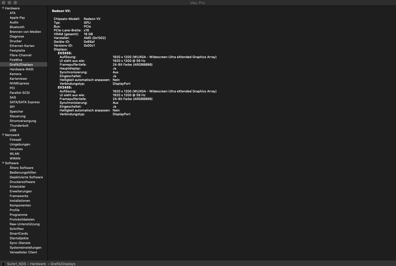

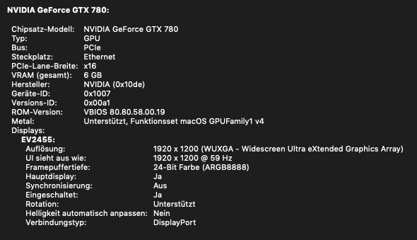

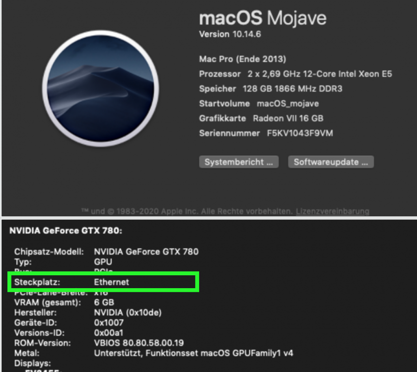

walter77 Posted June 4, 2020 Share Posted June 4, 2020 (edited) Hi there! Yesterday i tried to upgrade from High Sierra to Mojave. Everything went quiet ok and i got everything working except my new Radeon VII does not have Metal support. I tired everything in the config, switched from iMac to Mac Pro 5.1 but nothing changed. I also did a complete fresh install of Mojave, no success. Just for fun i put the Vega VII in my old Mac Pro 3.1, fresh install and everything does work. Does anyone have an idea what the trick could be? Thanks walter77_Z820_IOJones_Export.iojones.zip Hi there! Yesterday i tried to upgrade from High Sierra to Mojave. Everything went quiet ok and i got everything working except my new Radeon VII does not have Metal support. I tired everything in the config, switched from iMac to Mac Pro 5.1 but nothing changed. I also did a complete fresh install of Mojave, no success. Just for fun i put the Vega VII in my old Mac Pro 3.1, fresh install and everything does work. Does anyone have an idea what the trick could be? Thanks Edited June 4, 2020 by walter77 Link to comment Share on other sites More sharing options...
antonio.clb Posted June 4, 2020 Share Posted June 4, 2020 (edited) 18 minutes ago, walter77 said: Hi there! Yesterday i tried to upgrade from High Sierra to Mojave. Everything went quiet ok and i got everything working except my new Radeon VII does not have Metal support. I tired everything in the config, switched from iMac to Mac Pro 5.1 but nothing changed. I also did a complete fresh install of Mojave, no success. Just for fun i put the Vega VII in my old Mac Pro 3.1, fresh install and everything does work. Does anyone have an idea what the trick could be? Thanks walter77_Z820_IOJones_Export.iojones.zip Hi there! Yesterday i tried to upgrade from High Sierra to Mojave. Everything went quiet ok and i got everything working except my new Radeon VII does not have Metal support. I tired everything in the config, switched from iMac to Mac Pro 5.1 but nothing changed. I also did a complete fresh install of Mojave, no success. Just for fun i put the Vega VII in my old Mac Pro 3.1, fresh install and everything does work. Does anyone have an idea what the trick could be? Thanks Hello! Try to update Lilu and WhateverGreen to the latest version and reboot. Additionally: is the latest Mojave (10.14.6)? Looks like Radeon VII got the full support out-of-the-box from 10.14.5... Let us know! Edited June 4, 2020 by antonio.clb Link to comment Share on other sites More sharing options...
walter77 Posted June 4, 2020 Share Posted June 4, 2020 6 hours ago, antonio.clb said: Hello! Try to update Lilu and WhateverGreen to the latest version and reboot. Additionally: is the latest Mojave (10.14.6)? Looks like Radeon VII got the full support out-of-the-box from 10.14.5... Let us know! I'm on the latest version, Lilu and WhateverGreen too. I just installed my old GTX 780 and everything works out of the box. But why does the Radeon VII has no Metal support? Link to comment Share on other sites More sharing options...
antonio.clb Posted June 4, 2020 Share Posted June 4, 2020 28 minutes ago, walter77 said: I'm on the latest version, Lilu and WhateverGreen too. I just installed my old GTX 780 and everything works out of the box. But why does the Radeon VII has no Metal support? It should... Maybe this thread could be useful: https://forums.macrumors.com/threads/amd-radeon-vii-on-the-mac-pro-5-1-mojave-10-14-4-and-10-14-5-beta-driver-results.2170567/ Link to comment Share on other sites More sharing options...

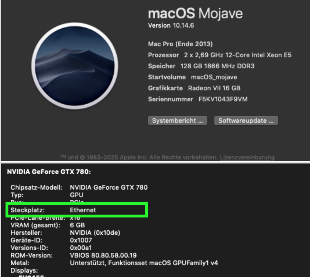

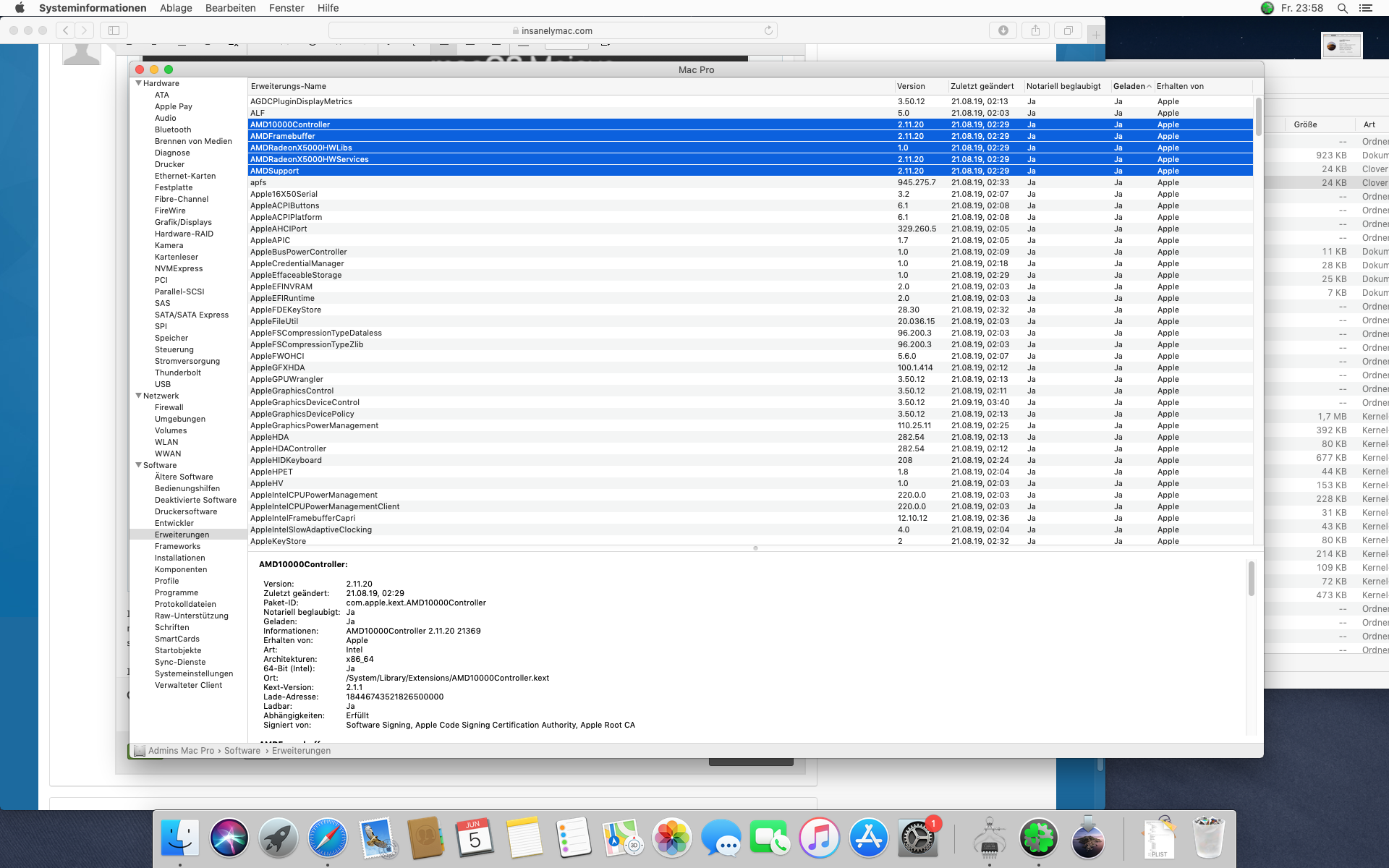

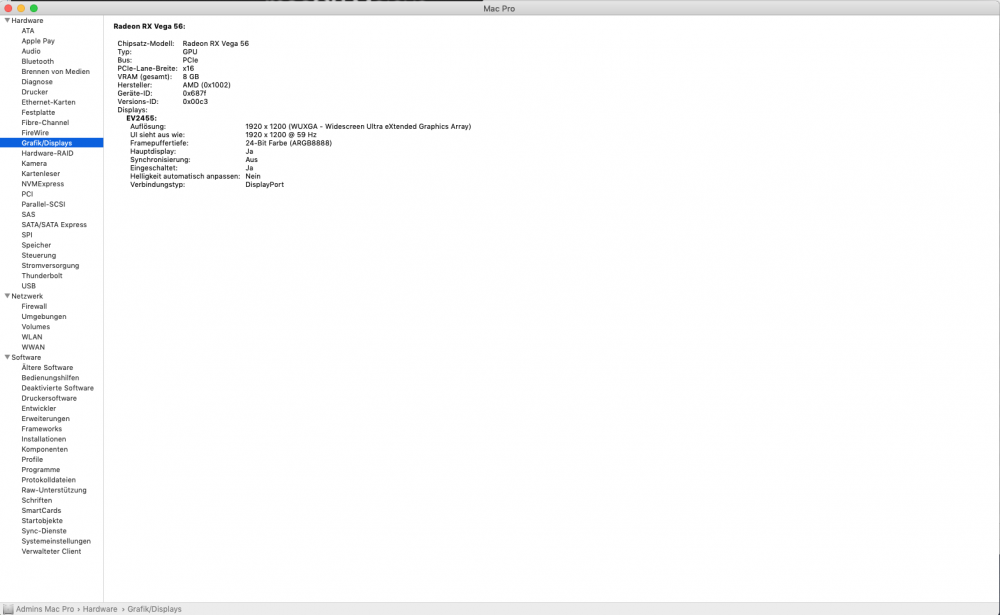

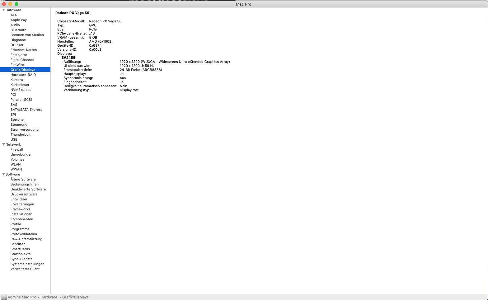

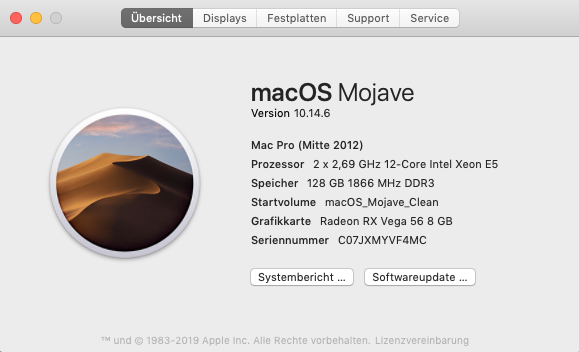

walter77 Posted June 5, 2020 Share Posted June 5, 2020 3 hours ago, Rocky12 said: @walter77 Can you please put some light on it what it could be I think the slot info is just a cometic thing cause the NVIDIA card is running like it should. All my NVIDA cards work out of the box but the AMD Cards do not. I just tested a AMD Vega 56 with 10.13.6 and it does not have any acceleration, the same in 10.14.6. The Vega 56 should work OOB, but it does not with my Clover settings. I did the complete guide step by step and everything works like it should with supported NVIDA cards but not with AMD cards. Does anyone have the Z820 running with a Radeon 56, 64 or the new VII? Is there something in the config I have to change? 1 Link to comment Share on other sites More sharing options...
walter77 Posted June 5, 2020 Share Posted June 5, 2020 1 hour ago, walter77 said: I think the slot info is just a cometic thing cause the NVIDIA card is running like it should. All my NVIDA cards work out of the box but the AMD Cards do not. I just tested a AMD Vega 56 with 10.13.6 and it does not have any acceleration, the same in 10.14.6. The Vega 56 should work OOB, but it does not with my Clover settings. I did the complete guide step by step and everything works like it should with supported NVIDA cards but not with AMD cards. Does anyone have the Z820 running with a Radeon 56, 64 or the new VII? Is there something in the config I have to change? I attached my clover folder and just did a fresh install, but it does not work, no support for the AMD cards with this EFI folder. Does anyone have an idea why NVIDIA cards are working and AMD does not? Hopefully anyone has time to help me, thank you. CLOVER.zip walter77 Mac Pro.iojones Link to comment Share on other sites More sharing options...
walter77 Posted June 6, 2020 Share Posted June 6, 2020 9 hours ago, walter77 said: I attached my clover folder and just did a fresh install, but it does not work, no support for the AMD cards with this EFI folder. Does anyone have an idea why NVIDIA cards are working and AMD does not? Hopefully anyone has time to help me, thank you. CLOVER.zip walter77 Mac Pro.iojones I got it working. It took me many hours and it was just a custom bootflag in my config. The custom flag for Dual CPUs from the guide caused the error with the AMD cards. After removing "-xcpm-ipi" it worked. Now my system works again under 10.14.6 and it's faster then before. 1 Link to comment Share on other sites More sharing options...

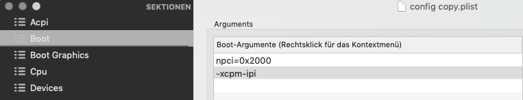

walter77 Posted June 6, 2020 Share Posted June 6, 2020 4 hours ago, walter77 said: I got it working. It took me many hours and it was just a custom bootflag in my config. The custom flag for Dual CPUs from the guide caused the error with the AMD cards. After removing "-xcpm-ipi" it worked. Now my system works again under 10.14.6 and it's faster then before. Is it possible to get a second AMD GPU working as a rendering GPU for Davinci Resolve? With 10.13.6 i had 2 1080ti working without any problem. Installing a second GPU will show me the GPU under system information but it's not usable by the system. What would be the right Clover settings? config.plist 1 Link to comment Share on other sites More sharing options...

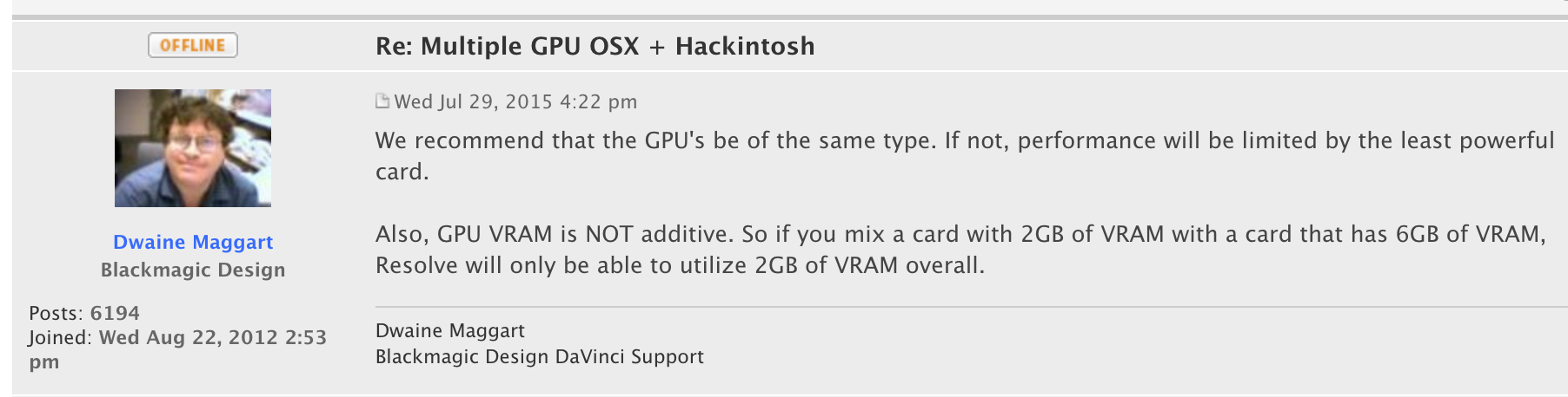

Rocky12 Posted June 6, 2020 Share Posted June 6, 2020 (edited) Final Cut und Davinci Resolve nutzen zwei GPUs gut aus. Die Affinity Tools ebenfalls. Bei Final Cut müssen sie aber identisch sein sonst wird nur eine genutzt. https://forum.blackmagicdesign.com/viewtopic.php?t=37577&p=346697 Edited June 6, 2020 by Rocky12 Link to comment Share on other sites More sharing options...

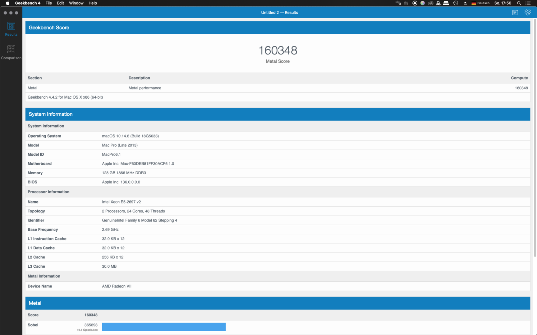

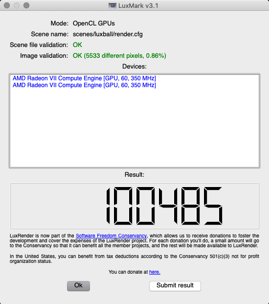

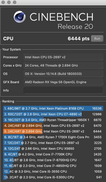

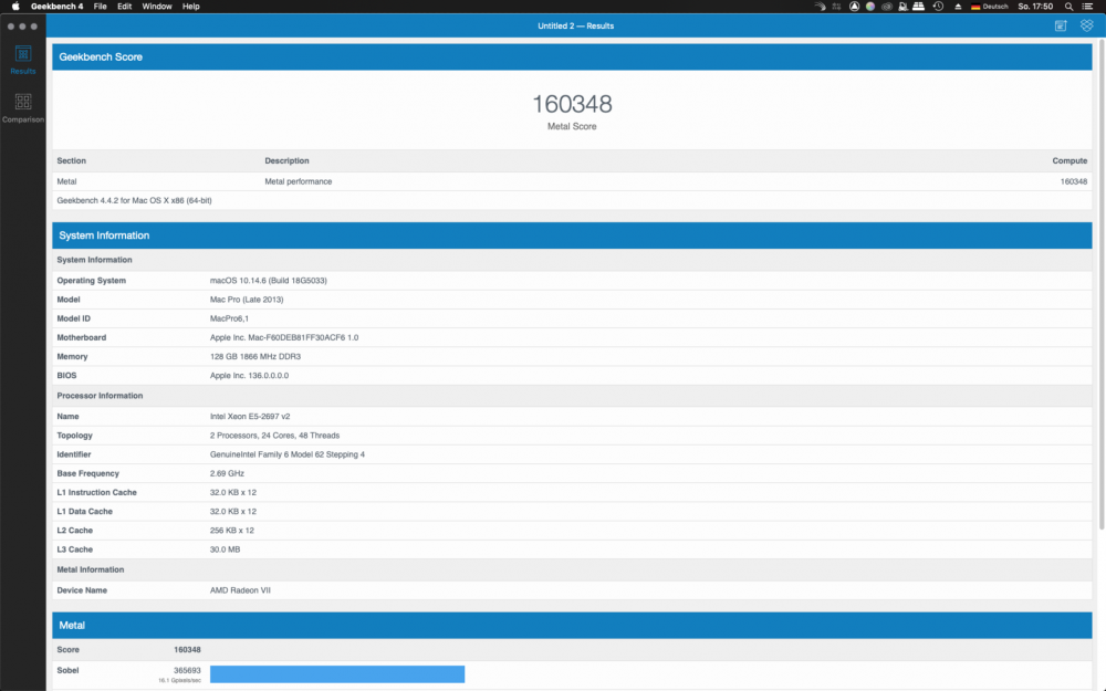

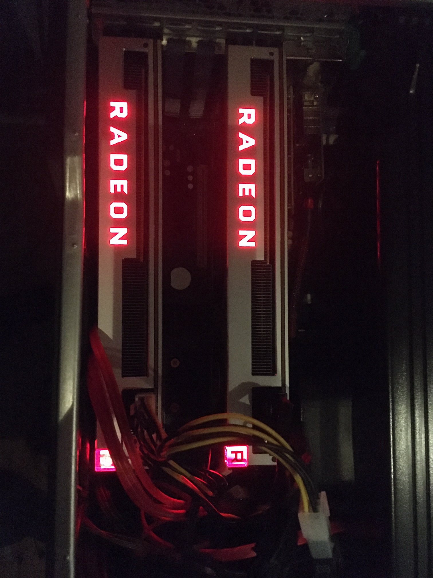

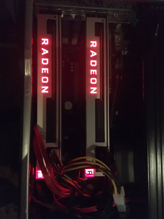

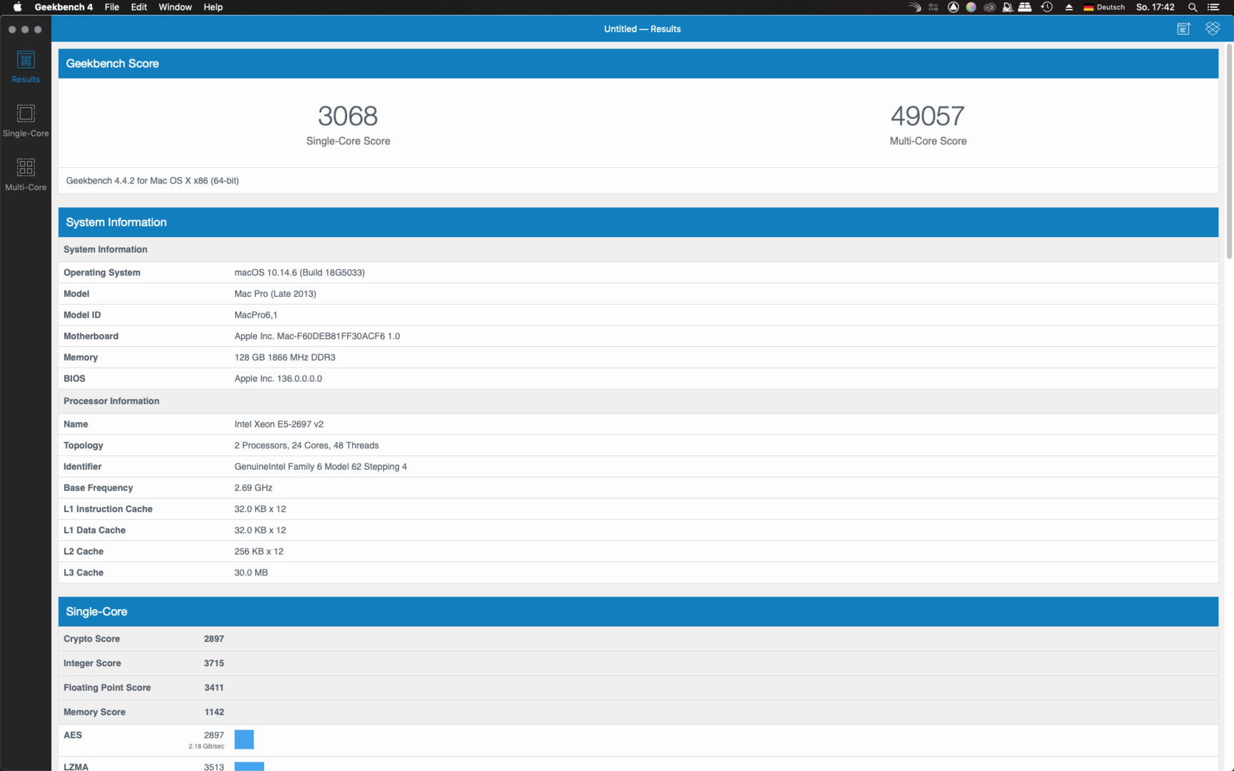

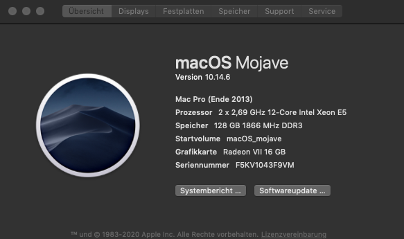

walter77 Posted June 7, 2020 Share Posted June 7, 2020 On 6/6/2020 at 9:24 PM, Rocky12 said: https://www.youtube.com/watch?v=Js4bZLWWoM4 Got two Radeon VII working with the help from the Hackintosh Forum (thanks to Chris for the hint). I don't know why, but i had the idea to see if the cards will work with Windows 10 and thy did. So i extract the DSDT under Windows 10, did all the patches from the Great Guide and everything now works perfect under 10.14.6 Mojave. The old box is still running really smoothly... 1 Link to comment Share on other sites More sharing options...
bilbo Posted June 8, 2020 Author Share Posted June 8, 2020 (edited) On 6/6/2020 at 10:46 AM, walter77 said: I got it working. It took me many hours and it was just a custom bootflag in my config. The custom flag for Dual CPUs from the guide caused the error with the AMD cards. After removing "-xcpm-ipi" it worked. Now my system works again under 10.14.6 and it's faster then before. WTH.... I',m shocked. That is completely unexpected. I can't understand why that bootflag screw up with the grahic card. Do you have cpu PM ? Some user reported that without that bootflag cpu doesn't get PM (with dual cpus) Edited June 8, 2020 by bilbo Link to comment Share on other sites More sharing options...

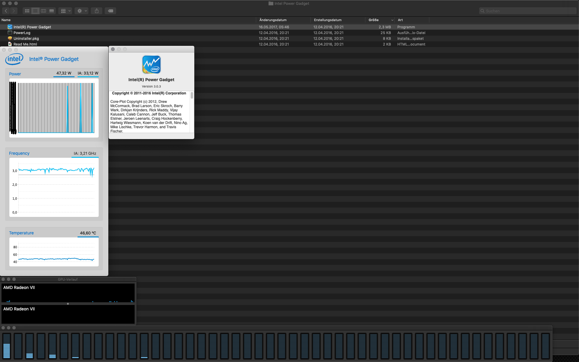

walter77 Posted June 8, 2020 Share Posted June 8, 2020 3 hours ago, bilbo said: WTH.... I',m shocked. That is completely unexpected. I can't understand why that bootflag screw up with the grahic card. Do you have cpu PM ? Some user reported that without that bootflag cpu doesn't get PM (with dual cpus) Yes i think i have PM, Intel Power Gadjet shows me that. Just to clarify, i removed the custom bootflag "xcpm-ipi" and activated "KernelXCPM" in the Clover Kernel and Kext Patches (Clover Configurator). So it's still there, but only this way it's booting up with AMD cards. And don't set RadeonDeinit, cause this will not work with dual AMD cards. Link to comment Share on other sites More sharing options...
bilbo Posted June 8, 2020 Author Share Posted June 8, 2020 I have been searching about that. I've just discovered that there is an specific patch for ivy called "KernelIvyXCPM" . Is that the patch you are talking about? P.S-What intel power gadget version do you use?. All version I've tested are not compatible with dual processors. Link to comment Share on other sites More sharing options...
walter77 Posted June 8, 2020 Share Posted June 8, 2020 53 minutes ago, bilbo said: I have been searching about that. I've just discovered that there is an specific patch for ivy called "KernelIvyXCPM" . Is that the patch you are talking about? P.S-What intel power gadget version do you use?. All version I've tested are not compatible with dual processors. I will give you the infos later this day and i can send you my EFI if you want to. Link to comment Share on other sites More sharing options...
