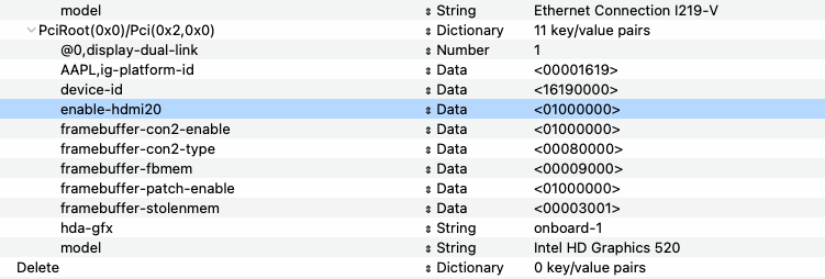

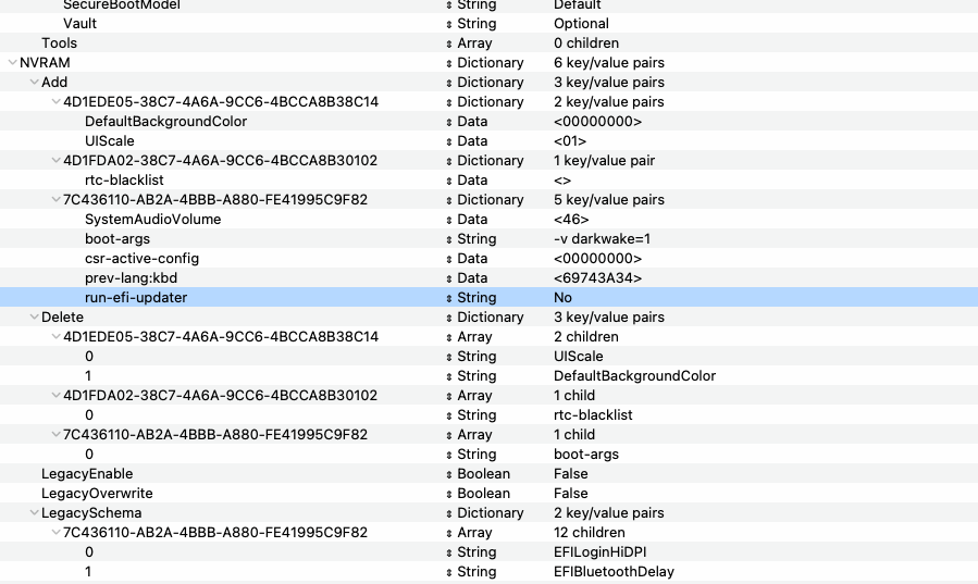

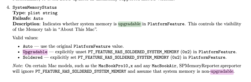

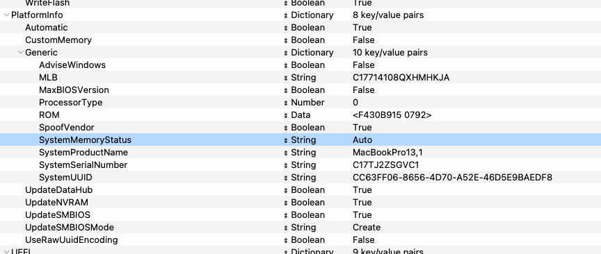

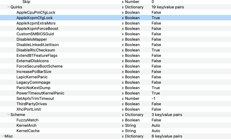

1Ale1 Posted April 20, 2021 Share Posted April 20, 2021 (edited) I'll explain here my doubts on this EFI... On 3/7/2021 at 8:37 AM, Baio77 said: New SSDT ALL Fix EFI.zip 27.15 MB · 18 downloads EliteBook Pro di Roger.ioreg.zip 3.93 MB · 9 downloads First, SystemProfilerMemoryfixup, (other than being deprecated because of it userspace patching with Lilu which is broken) is totally unnecessary since this feature was implemented in OC in the section And if you want to see the "memory" section in About this mac, you should learn to read the Configuration.pdf This is also broken for lack of userspace patching on macOS 11. - If this patch is required, you should rely on enable-max-pixel-clock-override. - hda-gfx is already loaded by AppleALC for HDMI audio - framebuffer-fbmem and stolenmem are highly NOT recommended as shown here: https://github.com/acidanthera/bugtracker/issues/1585#issuecomment-812525071 Also, your power management patches invalidate AppleIntelPowermanagement.kext features, leading to instability. Check section 7.8 of Configuration.pdf to unlock the MSR 0xE2 register with ControlMSRE2 and disable this patch. Note that HP laptops allow to access the advanced bios by pressing Ctrl+F10. This NVRAM variable is deprecated on Big Sur Overall, in this system there're a lot of unnecessary patches that demonstrate the incompetence of the creator Edited April 20, 2021 by 1Ale1 1 Link to comment Share on other sites More sharing options...
