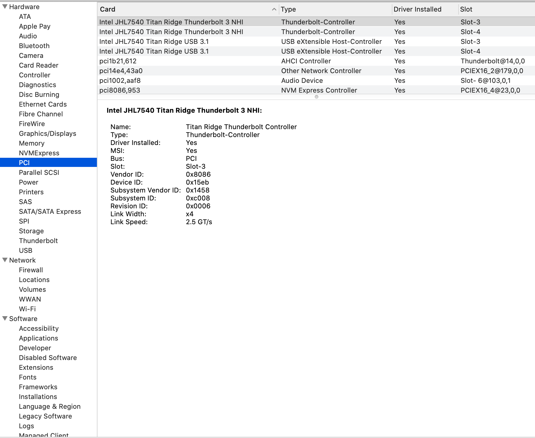

sarah1101 Posted August 12, 2020 Share Posted August 12, 2020 (edited) @obus Hi ! i also have the Titan Ridge TB3 card and trying to make it work. Can you please send me the firmware that you flashed. Please !!! Thankyou ! : ) -Sarah Edited August 12, 2020 by sarah1101 Link to comment Share on other sites More sharing options...
obus Posted August 13, 2020 Author Share Posted August 13, 2020 (edited) 18 hours ago, sarah1101 said: @obus Hi ! i also have the Titan Ridge TB3 card and trying to make it work. Can you please send me the firmware that you flashed. Please !!! Thankyou ! : ) -Sarah This firmware are working best for me. I'm running my rig with two TT Tb3 cards now. DESIGNARE-Z390-NVM33-Elias64Fr.bin Edited August 13, 2020 by obus 1 Link to comment Share on other sites More sharing options...
sarah1101 Posted August 13, 2020 Share Posted August 13, 2020 @obus thank you so much. : ) do i need to use the above DSDT too that you posted ?? and has anyone ever made TB3 made work on supermicro x11 motherboard ? Thanks ! -Sarah Link to comment Share on other sites More sharing options...

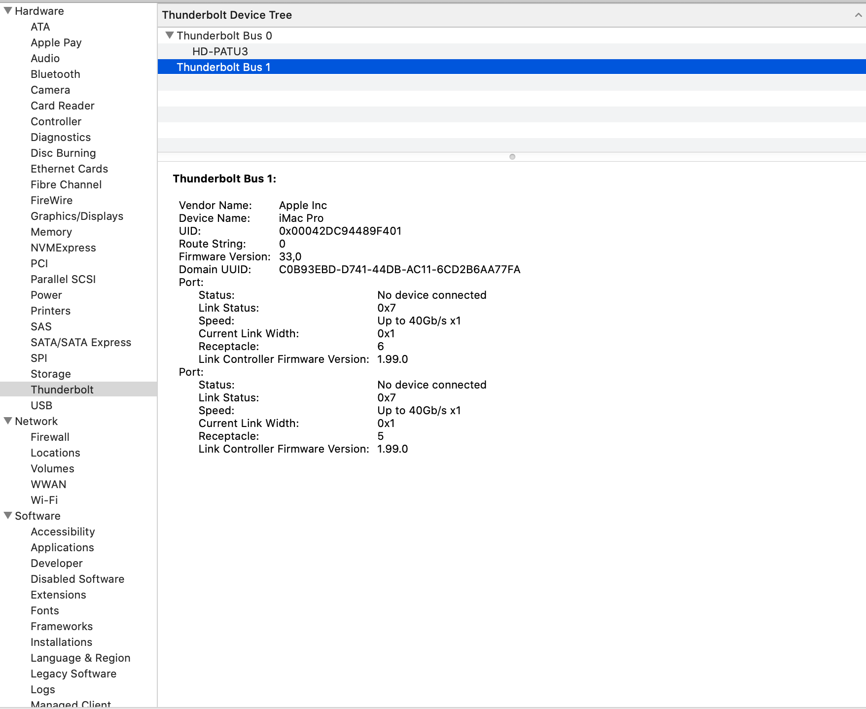

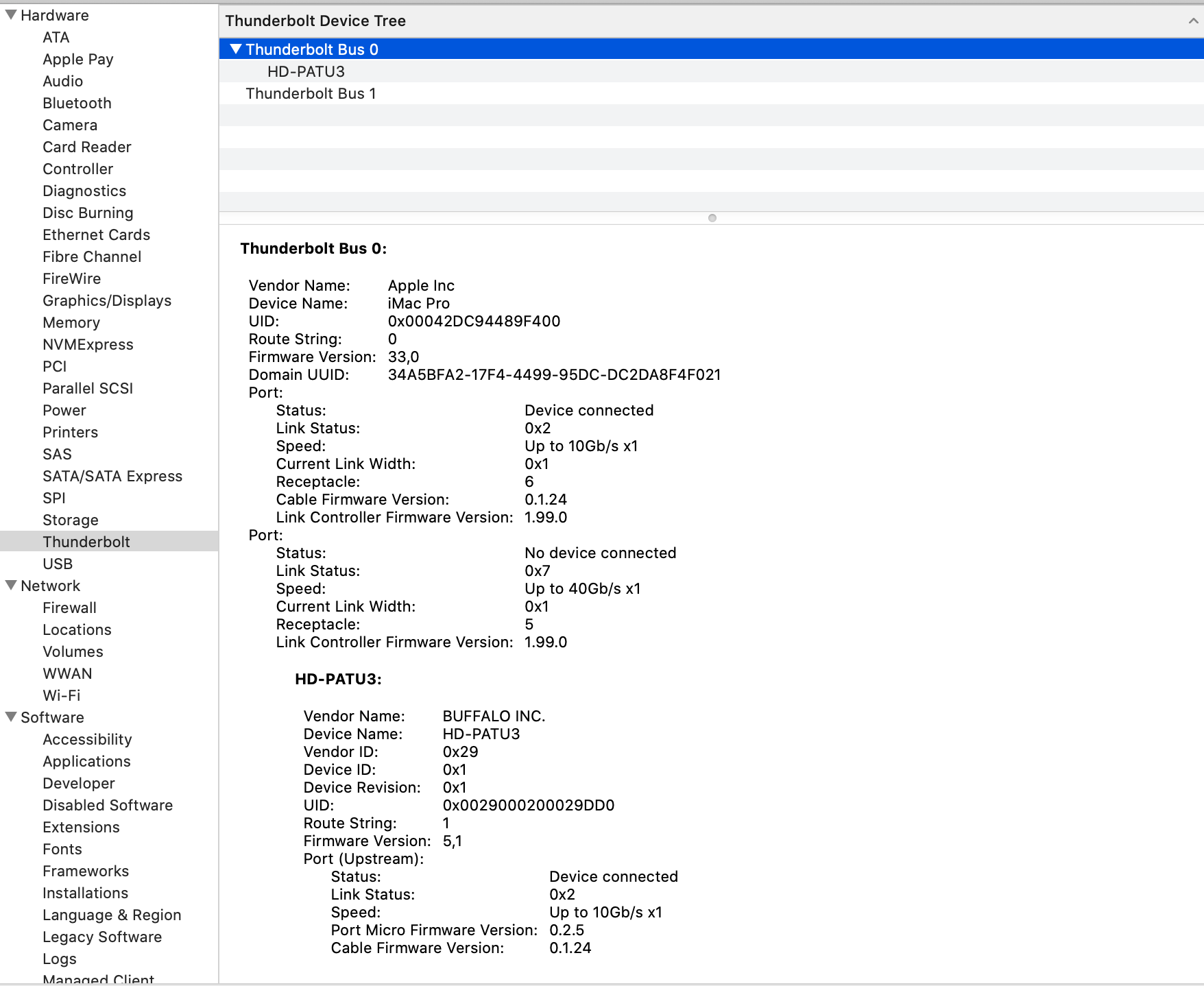

obus Posted August 13, 2020 Author Share Posted August 13, 2020 (edited) 21 minutes ago, sarah1101 said: @obus thank you so much. : ) do i need to use the above DSDT too that you posted ?? and has anyone ever made TB3 made work on supermicro x11 motherboard ? Thanks ! -Sarah For this hack you don't need a Thunderbolt header on your mobo so it should work fine. I have one THB header on my, but i'am not using it. To get it working after flashing your firmware just bridge pin 1 and 3 on the thunderbolt header on the Titan Ridge card. To get USB 3.1 type C port working you should connect USB power cable to the card. Check this: https://github.com/ameyrupji/thunderbolt-macpro-5-1/blob/master/GC-TitanRidge.md?fbclid=IwAR05Z3oG3fZc2ArzPiYgQcG0P7PEXlmbCktf0ulODeFaTSJa2BF0iWMaCDM With the firmware I sent to you you need to activate bus and change the Drom. Follow the guide on this site for doing that: https://www.tonymacx86.com/threads/success-gigabyte-designare-z390-thunderbolt-3-i7-9700k-amd-rx-580.267551/page-1624 You could use attached SSDT. Maybe you need to edit the SSDT depending on which PCI slot your card is mounted. SSDT-TBOLT3.aml Edited August 13, 2020 by obus Link to comment Share on other sites More sharing options...
sarah1101 Posted August 13, 2020 Share Posted August 13, 2020 53 minutes ago, obus said: For this hack you don't need a Thunderbolt header on your mobo so it should work I have one THB header on my, but i'am not using it. To get it working after flashing your firmware just bridge pin 1 and 3 on the thunderbolt header on the Titan Ridge card. To get USB 3.1 type C port working you should connect USB power cable to the card. Check this: https://github.com/ameyrupji/thunderbolt-macpro-5-1/blob/master/GC-TitanRidge.md?fbclid=IwAR05Z3oG3fZc2ArzPiYgQcG0P7PEXlmbCktf0ulODeFaTSJa2BF0iWMaCDM With the firmware I sent to you you need to activate bus and change the Drom. Follow the guide on this site for doing that: https://www.tonymacx86.com/threads/success-gigabyte-designare-z390-thunderbolt-3-i7-9700k-amd-rx-580.267551/page-1624 You could use attached SSDT. Maybe you need to edit the SSDT depending on which PCI slot your card is mounted. SSDT-TBOLT3.aml thank you so much for the help : ) i will test it out soon. thanks ! -Sarah Link to comment Share on other sites More sharing options...

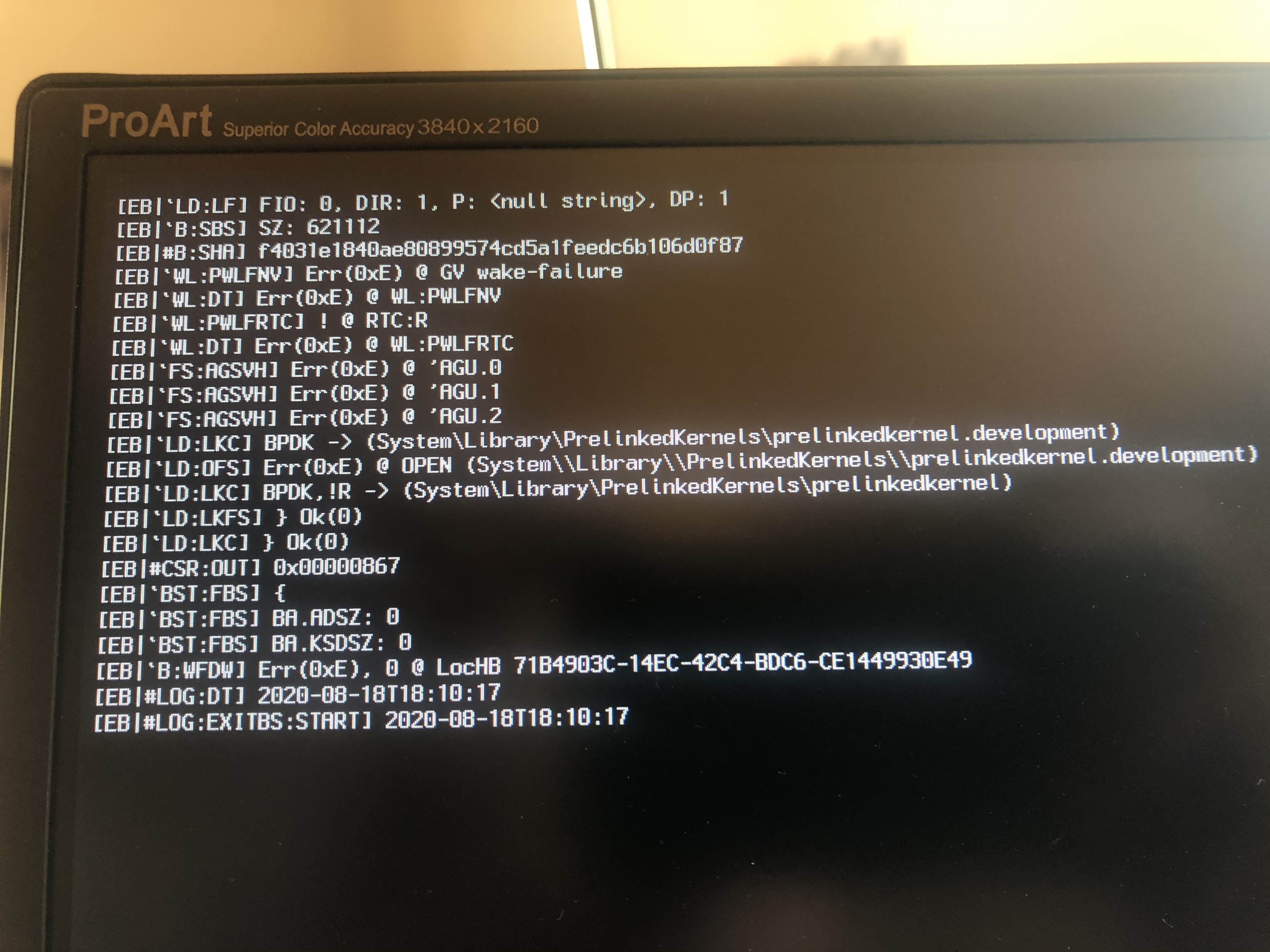

khe91 Posted August 18, 2020 Share Posted August 18, 2020 2 hours ago, obus said: This new 3203 bios is working like a charm on my rig without changing anything in my OC config.plist. Could you please post your EFI. Here OC 0.6.0 is crashing with the 3203 BIOS. 3102 works well. Thanks Link to comment Share on other sites More sharing options...
yapan4 Posted August 18, 2020 Share Posted August 18, 2020 @khe91 Enable Kernel/Quirks -> AppleXcpmExtraMsrs 1 1 Link to comment Share on other sites More sharing options...
khe91 Posted August 18, 2020 Share Posted August 18, 2020 16 minutes ago, yapan4 said: @khe91 Enable Kernel/Quirks -> AppleXcpmExtraMsrs Thanks, that did the trick. 1 Link to comment Share on other sites More sharing options...

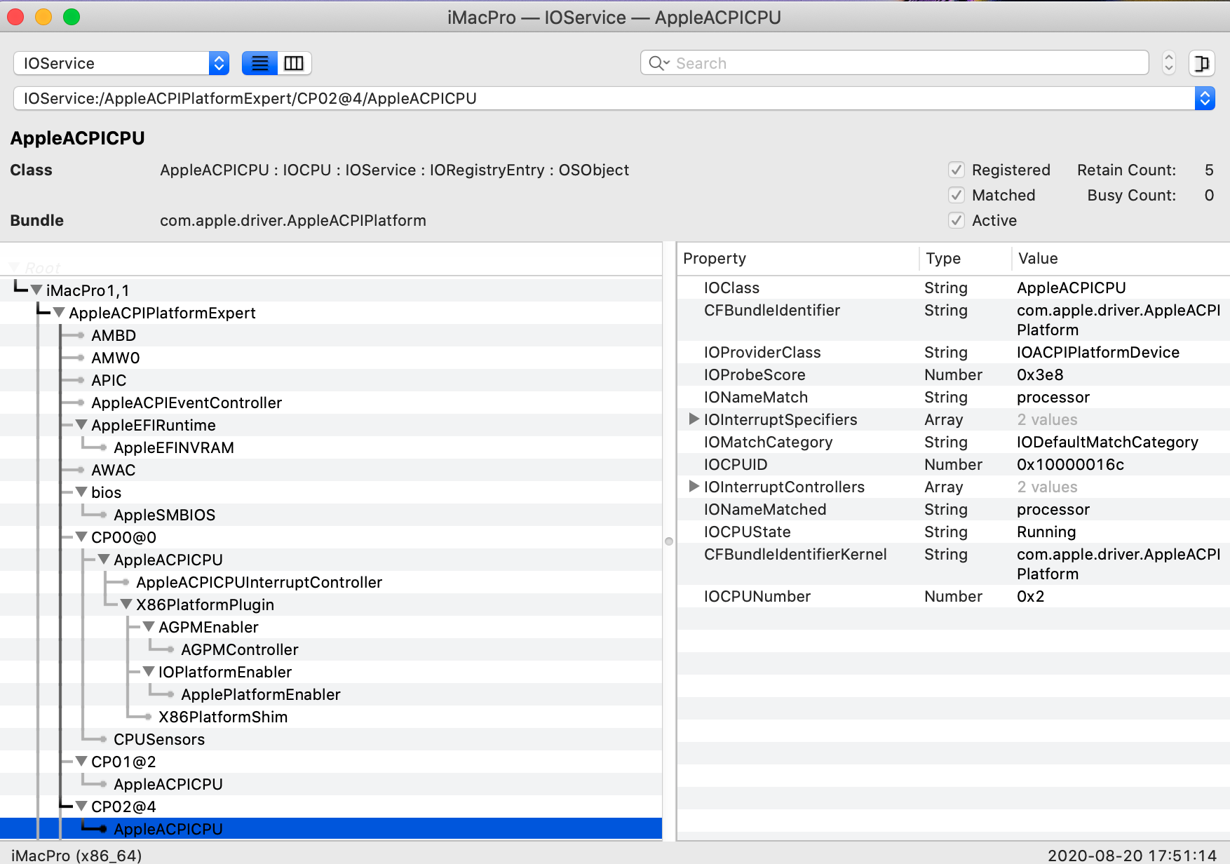

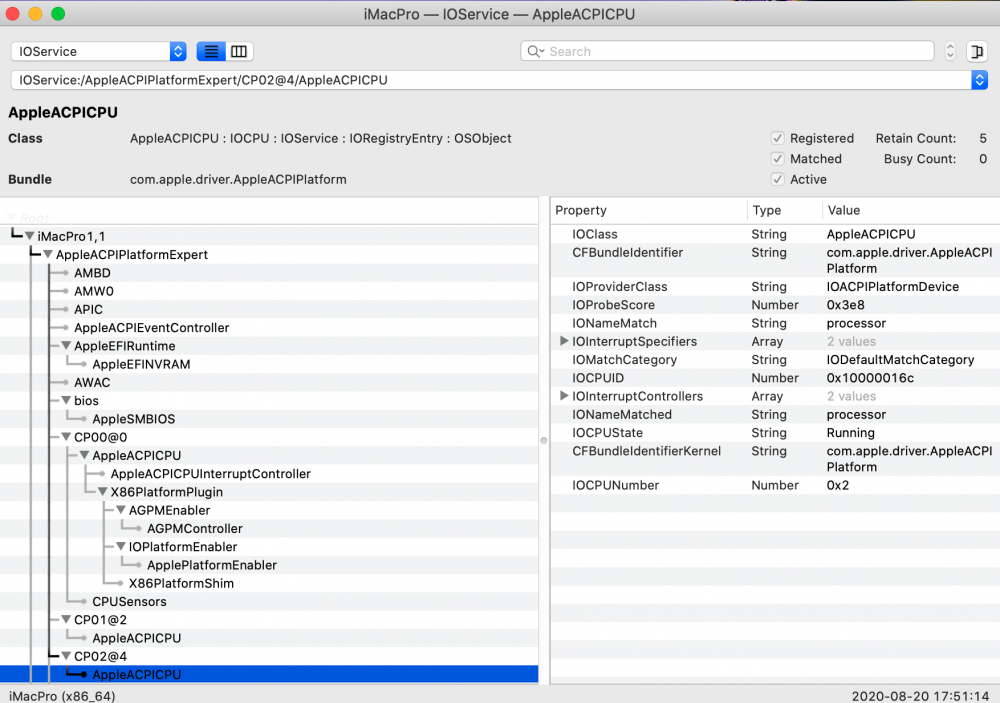

obus Posted August 20, 2020 Author Share Posted August 20, 2020 (edited) 21 hours ago, yapan4 said: @obus My hack doesn't want to fall asleep. And your? Stability? AWAC? RTCO? EC0? Sleep? Other issues? I have no issues at all. Everything is working nice including sleep if you uncheck "wake for network access" in System Preferences --> Energy Saver. Stability is 100% perfect. No shutdowns, hang or other problems. SSDT-AWAC.aml isn't necessary at all it's only for 300 series chipset. (I have that controller by default. See attached picture) SSDT-EC-USBX.aml, SSDT-Plug.aml and SSDT-RTC0.aml is the only SSDT I use. EFI_C422_0_6_0_iMacPro1,1-BIOS_3203_RELEASE_FakeSMC.zip Edited August 20, 2020 by obus 1 Link to comment Share on other sites More sharing options...
yapan4 Posted August 20, 2020 Share Posted August 20, 2020 45 minutes ago, obus said: I have no issues at all. Everything is working nice including sleep if you uncheck "wake for network access" in System Preferences --> Energy Saver. Stability is 100% perfect. No shutdowns, hang or other problems. SSDT-AWAC.aml isn't necessary at all it's only for 300 series chipset. (I have that controller by default. See attached picture) SSDT-EC-USBX.aml, SSDT-Plug.aml and SSDT-RTC0.aml is the only SSDT I use. That's great! About Sleep: wake for network access not enabled, I will search another reasons... if sleep do work for you, must work for me too. Thanks. Another question remains - is it possible to apply the Metacolin method for BIOS v3203 to unlock also MSR 0x1AA? Link to comment Share on other sites More sharing options...
obus Posted August 20, 2020 Author Share Posted August 20, 2020 (edited) 1 hour ago, yapan4 said: That's great! About Sleep: wake for network access not enabled, I will search another reasons... if sleep do work for you, must work for me too. Thanks. Another question remains - is it possible to apply the Metacolin method for BIOS v3203 to unlock also MSR 0x1AA? Could your problems with sleep be related to your Radeon Pro WX4100? Test my EFI straight off and see if sleep is working. I'm not sure how the Metacolin method is executed. Could you elaborate a little bit further "how too" and I will test. OK I find Metacolins guide about patching and I will test. Edited August 20, 2020 by obus Link to comment Share on other sites More sharing options...
