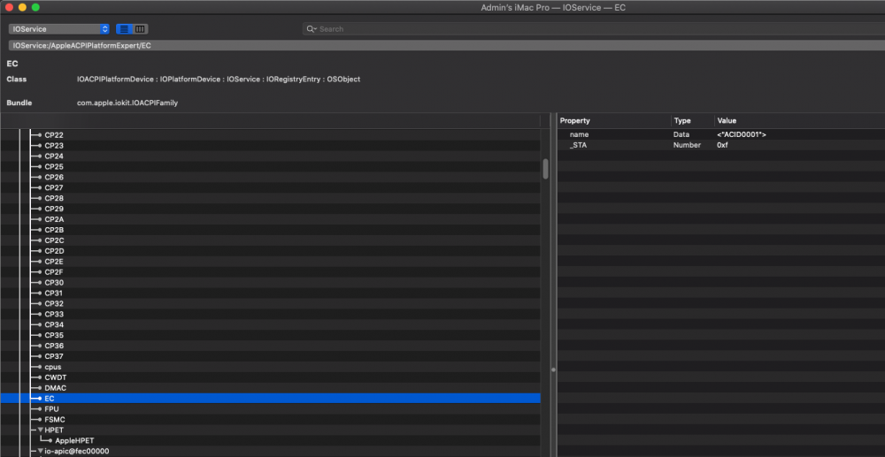

yapan4 Posted October 24, 2019 Share Posted October 24, 2019 No, this is EC0->EC IOReg, your SSDT not tasted yet(will do it after beta3 install) Link to comment Share on other sites More sharing options...
obus Posted October 24, 2019 Author Share Posted October 24, 2019 2 minutes ago, yapan4 said: No, this is EC0->EC IOReg, your SSDT not tasted yet(will do it after beta3 install) That driver (device) appleACPIEC shouldnt't be there for working AppleBusPowerController. 1 Link to comment Share on other sites More sharing options...

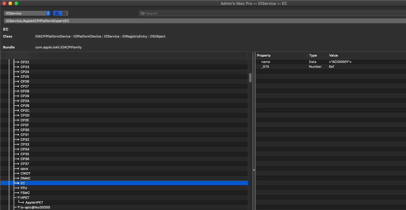

yapan4 Posted October 24, 2019 Share Posted October 24, 2019 I noticed a problem with malfunctioning USB 3.0-3.1 lately. Probably because of EC0-> EC. I will see the difference EC0-> EC vs your SSDT... Link to comment Share on other sites More sharing options...

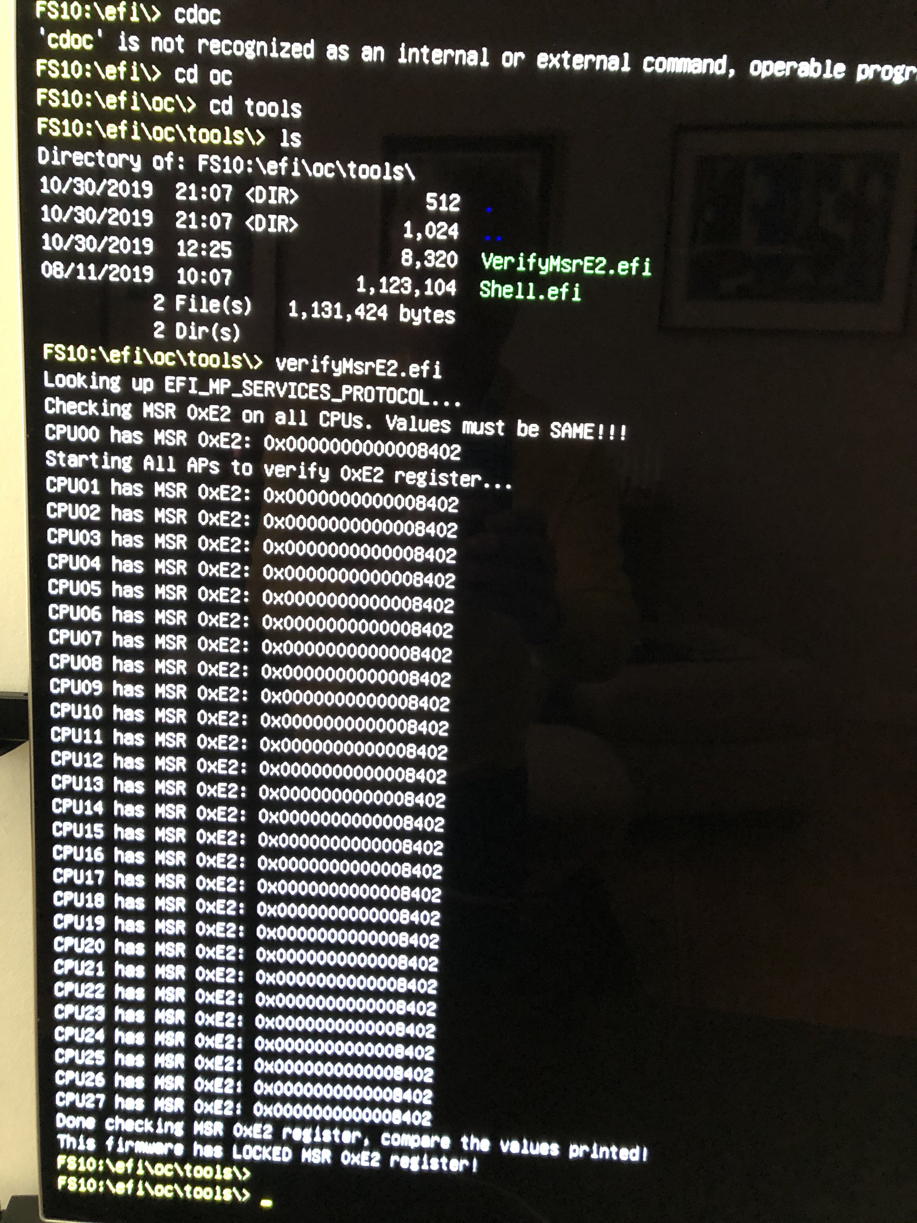

yapan4 Posted October 31, 2019 Share Posted October 31, 2019 (edited) The first bug found - does not work MSR Lock Control. No difference is enabled or disabled, Clover reported locked MSR 0xE2 Probably significantly changed ACPI tables preboot.log Edited November 1, 2019 by yapan4 Link to comment Share on other sites More sharing options...

obus Posted October 31, 2019 Author Share Posted October 31, 2019 (edited) Hey @yapan4 Check my log on opencore-forum. locked MSR 0xE2 is not my problem Because with OC my rig is booting and not stuck at "end random seed" Edited October 31, 2019 by obus Link to comment Share on other sites More sharing options...

obus Posted November 1, 2019 Author Share Posted November 1, 2019 (edited) 13 hours ago, yapan4 said: Thank you, @obus. Back to 1202 over flashback button worked. I reviewed you screenshot, yes this is the same stop as my, probably not related with locked MSR 0xE2. There may be something with ACPI or FakeSMC The firmware has locked MSR 0xE2. We need it to be unlocked and I don't know how? Any ideas? Edited November 1, 2019 by obus Link to comment Share on other sites More sharing options...

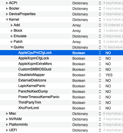

Ellybz Posted November 1, 2019 Share Posted November 1, 2019 (edited) 1 hour ago, obus said: I tried to unlock the MSR 0xE2 register today with Grub but with no go. Will test a little bit more tomorrow. Have you tried enabling the AppleCpuPmCfgLock option in OC? (MSR 0xE2 write protection) You can also try to mod your Bios with the UEFITool from Longsoft if you feel adventurous & the option in OC doesn't work. Edited November 1, 2019 by Ellybz Link to comment Share on other sites More sharing options...
