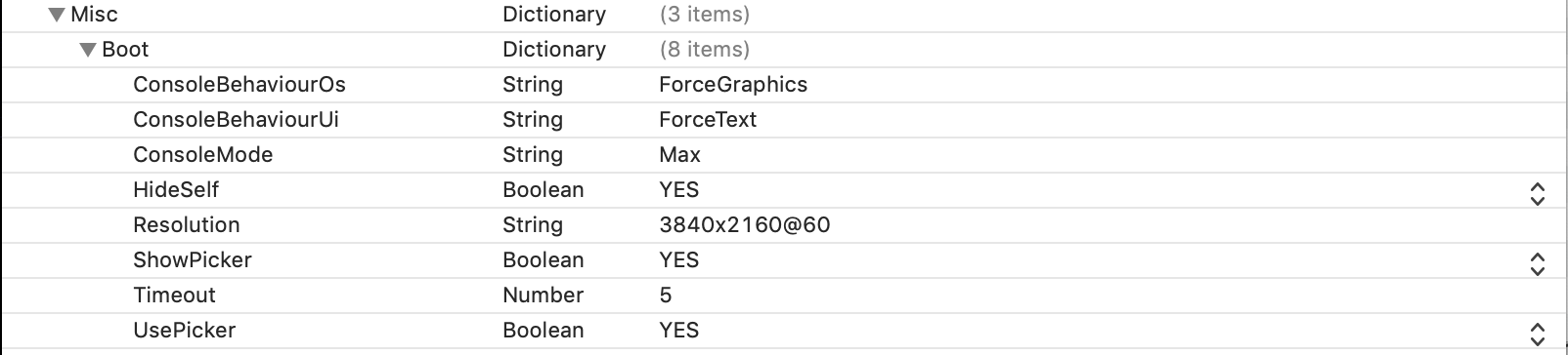

skyflying5 Posted August 6, 2019 Share Posted August 6, 2019 1 hour ago, obus said: Here we go! If you appreciated this help you may click the Like button If you don't appreciate my help stop asking for help EFI_OC_0.0.4.zip thanks for u share but i cannot see the boot select screen , only get black screen stay still. i got the oc 0.0.3 can get boot select on the screen but cannot boot so there are lot's of work to deal with I should work harder to understand how the oc worked Link to comment Share on other sites More sharing options...
obus Posted August 6, 2019 Author Share Posted August 6, 2019 You need to change config.plist like this to see OC boot screen Link to comment Share on other sites More sharing options...

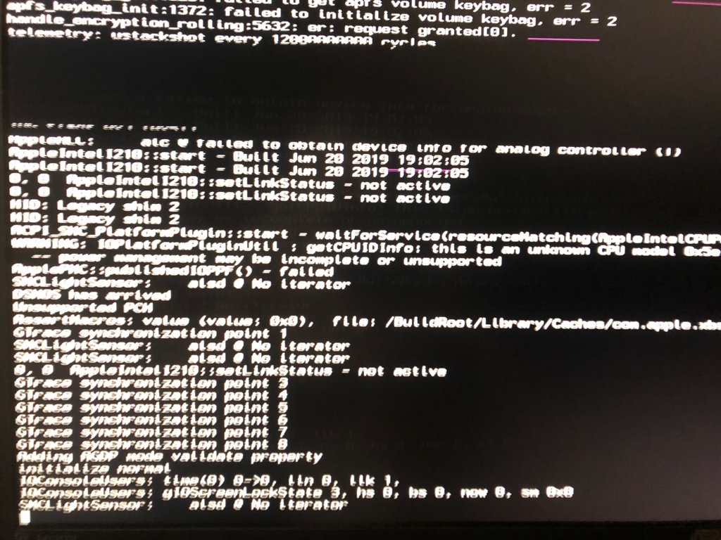

khe91 Posted August 20, 2019 Share Posted August 20, 2019 On 6/9/2019 at 6:51 PM, obus said: Use this. Just put in MLB, Serial and UUID. If you have a SSDT-PM enable it in config and put SSDT into ACPI -> custom. Don't change anything else. EFI.zip Hi obus, I got nearly the same hardware as yours. Just an different CPU. Do I need to change anything for the W-2125 CPU ? Tried your EFI.zip from the post of June, 9. but it crashes during boot, I guess on graphic init. Any ideas what I'm doing wrong ? Thanks, khe91 Link to comment Share on other sites More sharing options...
obus Posted August 20, 2019 Author Share Posted August 20, 2019 (edited) 1 hour ago, khe91 said: Hi obus I got nearly the same hardware as yours. Just an different CPU. Do I need to change anything for the W-2125 CPU ? Tried your EFI.zip from the post of June, 9. but it crashes during boot, I guess on graphic init. Any ideas what I'm doing wrong ? Try this EFI. It should work with your hardware. This is the debug version so if it crash during boot you have a log file in the root of your EFI. You need to put in your own iMacPro1.1 generic platform information in the config.plist. Try WITHOUT my SSDT-ALL.aml if it not works in the first time. EFI.zip Edited August 20, 2019 by obus 1 Link to comment Share on other sites More sharing options...

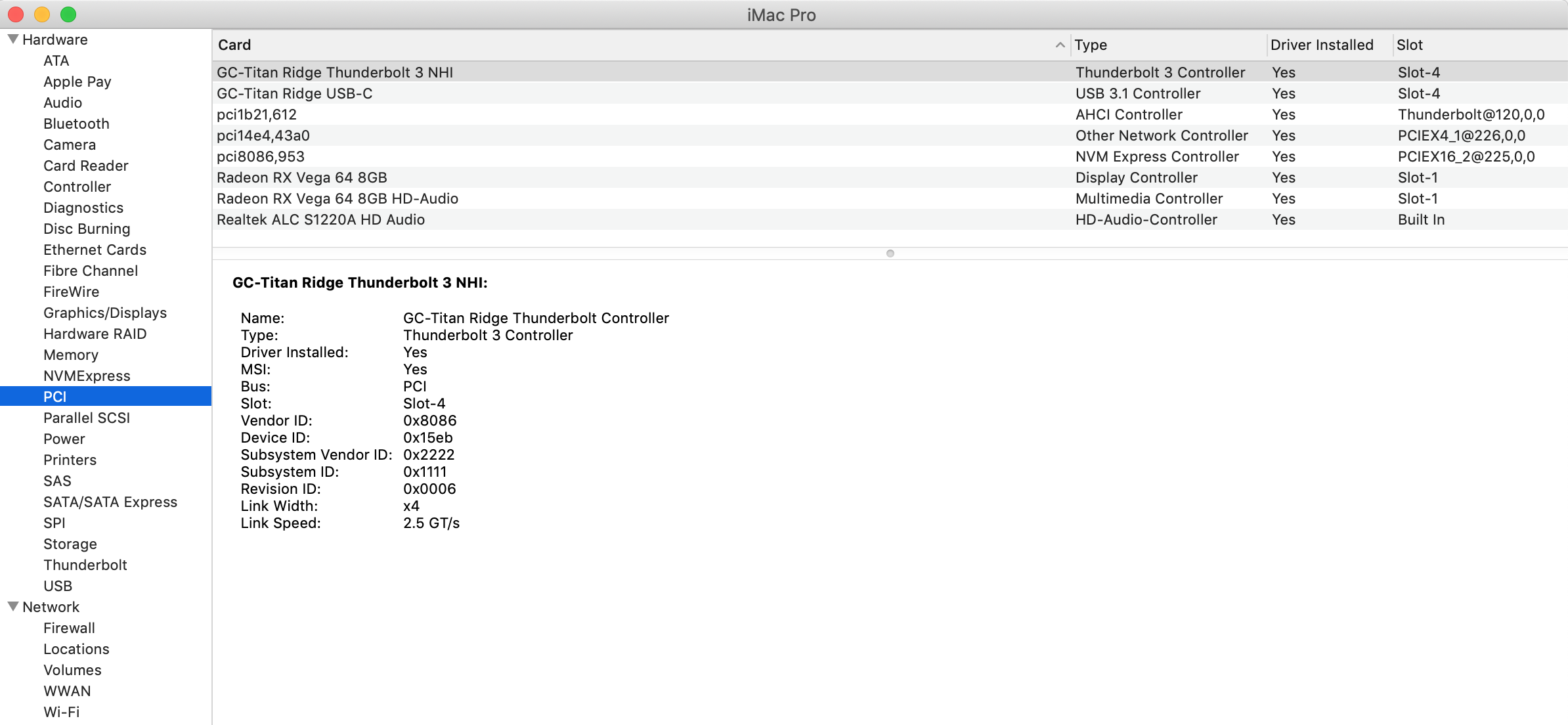

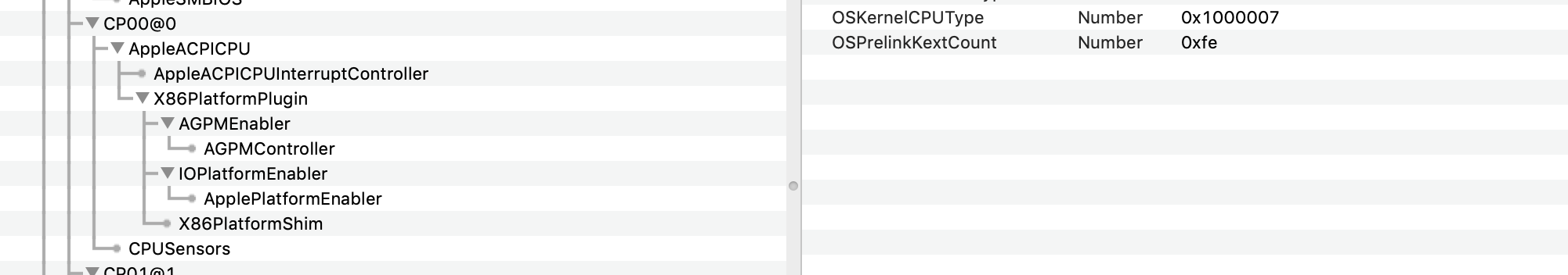

obus Posted August 21, 2019 Author Share Posted August 21, 2019 (edited) CPU will always be recognised as unsupported. As long as you have XCPM working everything is fine. Then your CPU is working as it should (sort of). With this command from terminal you can check if you have XCPM working: sysctl -a | grep xcpm. In IOreg it should loo like this: As long as you have your THB-card in slot PCIEX4_1 and thunderbolt enabled in bios on that slot my SSDT-ALL.aml should work. The same for your Vega 64 if it's connected to PCIX16_1. EC USB-bus power should work and of course XCPM with that SSDT. You need USB plugged in for your THB TitanRidge card. Edited August 21, 2019 by obus Link to comment Share on other sites More sharing options...

Guest Posted August 21, 2019 Share Posted August 21, 2019 15 minutes ago, khe91 said: --- In the System Information it says for Thunderbolt: No drivers are loaded. GC-Titan Ridge is in Slot PCIEX4_1, Thunderbolt header, USB and power cables are connected. The card works in Windows. No drivers is correct in system information Try to start your pc with a ON thunderbolt device and see If your system see it Hot plug could be very tricky, maybe a correct SSDT for it is necessary Link to comment Share on other sites More sharing options...

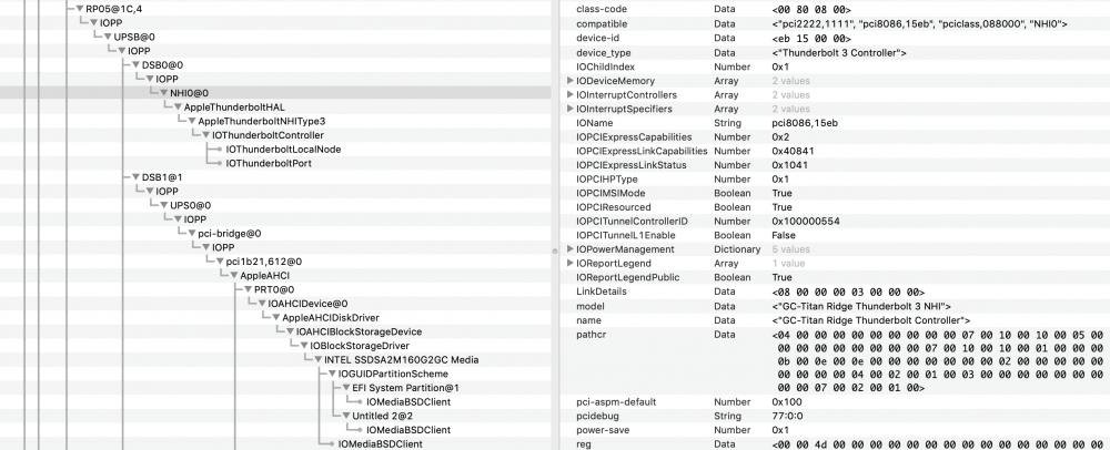

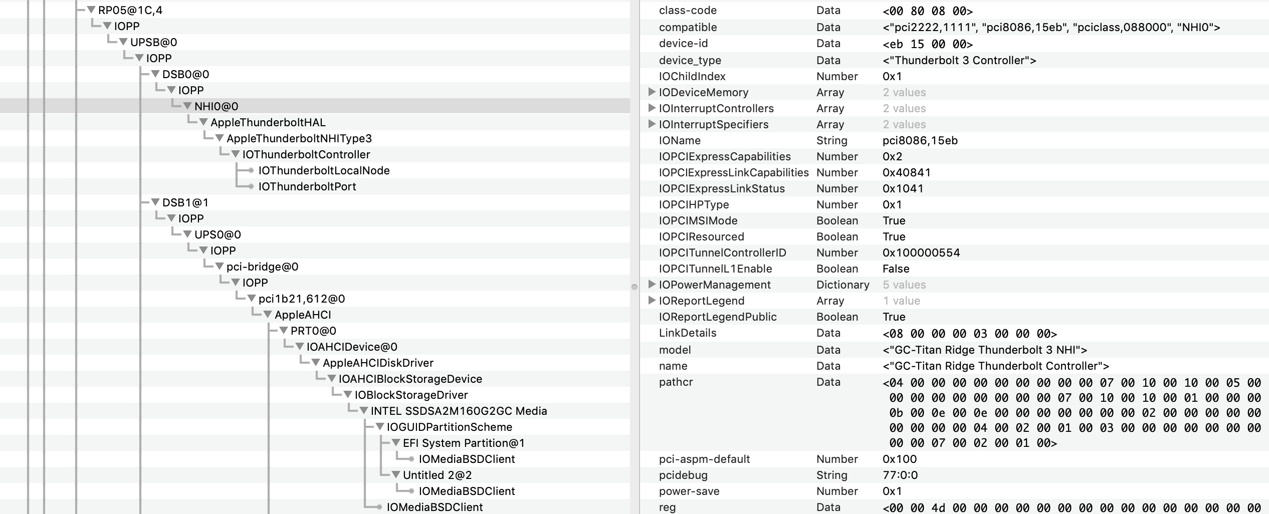

obus Posted August 21, 2019 Author Share Posted August 21, 2019 19 minutes ago, khe91 said: BlackmagicDesign eGPU is connected on start. System can't see it. This could be a culprit. I've never tested with a eGPU but hot swap works like a charm with my Buffalo-disk. This is my IOReg wit my disk attached: Link to comment Share on other sites More sharing options...
