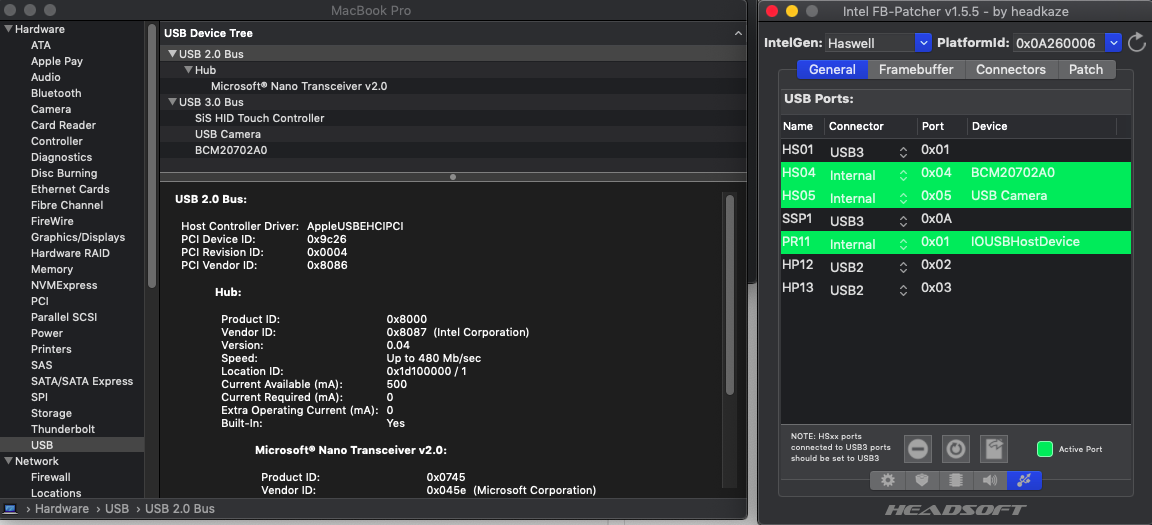

SavageAUS Posted October 24, 2018 Share Posted October 24, 2018 @SavageAUS can you download FB-Patcher v1.5.5. It can now export USBEHCPorts.kext and USBXHCPorts.kext. I'm guessing that's what you need? Even with 1.5.5 and USB port patch I cannot see the 2 USB 2.0 ports with the app just the USB 3.0 and internal. Sent from my iPhone using Tapatalk Link to comment https://www.insanelymac.com/forum/topic/335018-hackintool-v3xx/page/6/#findComment-2642735 Share on other sites More sharing options...
headkaze Posted October 24, 2018 Author Share Posted October 24, 2018 2 minutes ago, SavageAUS said: Even with 1.5.5 and USB port patch I cannot see the 2 USB 2.0 ports with the app just the USB 3.0 and internal. Can you please run "ioreg -l >ioreg.txt" from Terminal and attach it here. Link to comment https://www.insanelymac.com/forum/topic/335018-hackintool-v3xx/page/6/#findComment-2642737 Share on other sites More sharing options...
SavageAUS Posted October 24, 2018 Share Posted October 24, 2018 5 minutes ago, headkaze said: Can you please run "ioreg -l >ioreg.txt" from Terminal and attach it here. I sure can. I have a Microsoft nano receiver plugged into one of the mystery ports. ioreg.txt Link to comment https://www.insanelymac.com/forum/topic/335018-hackintool-v3xx/page/6/#findComment-2642738 Share on other sites More sharing options...

SavageAUS Posted October 24, 2018 Share Posted October 24, 2018 No I should have something to try soon.It’s a strange issue because they used to show up under a different section when I created my SSDT with ioreg. I don’t know what’s changed. Sent from my iPhone using Tapatalk Link to comment https://www.insanelymac.com/forum/topic/335018-hackintool-v3xx/page/6/#findComment-2642766 Share on other sites More sharing options...
headkaze Posted October 24, 2018 Author Share Posted October 24, 2018 (edited) 2 hours ago, SavageAUS said: It’s a strange issue because they used to show up under a different section when I created my SSDT with ioreg. I don’t know what’s changed. Can you please try the attached version. Also can you attach the USBPorts file it generates so I can take a look. Edited October 24, 2018 by headkaze Link to comment https://www.insanelymac.com/forum/topic/335018-hackintool-v3xx/page/6/#findComment-2642778 Share on other sites More sharing options...
SavageAUS Posted October 24, 2018 Share Posted October 24, 2018 1 hour ago, headkaze said: Can you please try the attached version. Also can you attach the USBPorts file it generates so I can take a look. FBPatcher.zip Kext attached, this version detected my ports correctly. USBPorts.kext.zip Link to comment https://www.insanelymac.com/forum/topic/335018-hackintool-v3xx/page/6/#findComment-2642785 Share on other sites More sharing options...
headkaze Posted October 24, 2018 Author Share Posted October 24, 2018 4 minutes ago, SavageAUS said: Kext attached, this version detected my ports correctly. USBPorts.kext.zip Okay it looks okay. Only thing left I guess is to confirm if it works or not. Link to comment https://www.insanelymac.com/forum/topic/335018-hackintool-v3xx/page/6/#findComment-2642788 Share on other sites More sharing options...
SavageAUS Posted October 24, 2018 Share Posted October 24, 2018 Just now, headkaze said: Okay it looks okay. Only thing left I guess is to confirm if it works or not. Seems to work just fine to me. here is updated kext with touchscreen deleted, laptop wont sleep with it active. I do see one hiccup, with the kext loaded if i open FBPatcher it does not show the 2 usb 2.0 as active if i plug something in but its working and shows in system overview. USBPorts.kext.zip Link to comment https://www.insanelymac.com/forum/topic/335018-hackintool-v3xx/page/6/#findComment-2642790 Share on other sites More sharing options...
headkaze Posted October 24, 2018 Author Share Posted October 24, 2018 2 minutes ago, SavageAUS said: I do see one hiccup, with the kext loaded if i open FBPatcher it does not show the 2 usb 2.0 as active if i plug something in but its working and shows in system overview. Can you please run "ioreg -l >ioreg.txt" from Terminal again and attach it here (with the kext loaded). Link to comment https://www.insanelymac.com/forum/topic/335018-hackintool-v3xx/page/6/#findComment-2642792 Share on other sites More sharing options...

headkaze Posted October 24, 2018 Author Share Posted October 24, 2018 @SavageAUS so I compared the two ioreg files you posted and I don't really understand why but the ports have changed from HP11..HP13 to PR11..PR13. Also the "portType" / "UsbConnector" entries have vanished even though I can see that I'm injecting them correctly in the USBPorts.kext. The "portType" and "UsbConnector" entries are the values I use to determine a valid port which is why they are not displaying in FB-Patcher once you have USBPorts.kext installed. Looks like I'll have to do a bit more research on the topic to find out why and figure out a work around for it. Thanks again for your help. Link to comment https://www.insanelymac.com/forum/topic/335018-hackintool-v3xx/page/6/#findComment-2642796 Share on other sites More sharing options...
headkaze Posted October 24, 2018 Author Share Posted October 24, 2018 (edited) 3 hours ago, SavageAUS said: Seems to work just fine to me. here is updated kext with touchscreen deleted, laptop wont sleep with it active. Can you please try with FB-Patcher 1.5.6. Please delete USBPorts.kext and start from the beginning of the USB instructions again. Then please post the newly generated USBPorts.kext and ioreg.txt here. Thanks. Edited October 24, 2018 by headkaze Link to comment https://www.insanelymac.com/forum/topic/335018-hackintool-v3xx/page/6/#findComment-2642821 Share on other sites More sharing options...

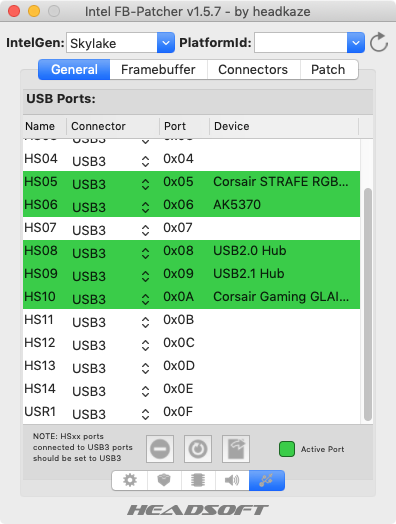

SavageAUS Posted October 27, 2018 Share Posted October 27, 2018 23 hours ago, headkaze said: Intel FB-Patcher 1.5.7 Released - Now detects EHC and hub ports (thanks to RehabMan & SavageAUS). Multi-select USB Ports. Now detects if USBInjectAll is installed Hey buddy, using 1.5.7 on my skylake rig and i'm unable to see SS ports, i believe i am injecting all ports. ioreg.txt CLOVER.zip Link to comment https://www.insanelymac.com/forum/topic/335018-hackintool-v3xx/page/6/#findComment-2643336 Share on other sites More sharing options...
