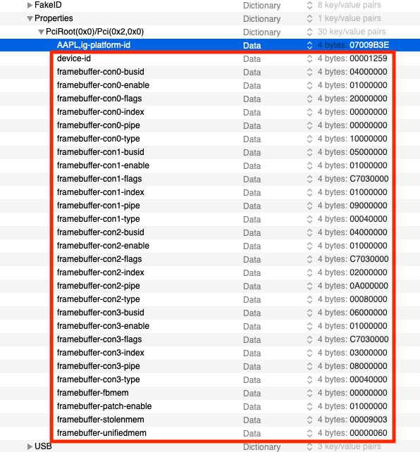

blusprite Posted October 7, 2018 Share Posted October 7, 2018 Hello! Let me first express my appreciation of what you guys are doing! I hope I can get some help with getting my UHD 630 acceleration working. So far I have attempted to use the FBPatcher 1.4.6 + WEG and Lilu and managed to get the OS to boot. I tried all possible PlatformId's but failed to get acceleration. I found that my system boots successfully only if Device ID 0x59120000 is used. With all other ID's I tried (including the ones in FBPatcher's Patch>Advanced tab), the boot would not complete and I got "Kextd stall[0], (60): 'IGPU'" message. My BIOS allows for setting preallocated DVMT up to 1024 MB, so I have it at 256. I also tried patching the connectors. I have a VGA plug on my monitor cable, so I only use that port. The three available in FBPatcher platform ID's that correspond to UHD 630 desktop (0x3E9B0007, 0x3E920003, 0x3E910003) have combinations of connectors that don't include Index 0, and my monitor only shows in red if the Index is 0. Tried to set the first connector to Index 0 and set type to VGA, but again no acceleration. I'm not sure if I'm supposed to change the Framebuffer flags, so I left them as they were by default. So I'll be very grateful if someone can point me where I'm messing things up and how to fix them. I attach my config.plst (latest version of Clover). Can't make screenshots, perhaps to do with the missing QE/CI, but in my kext/other folder I have WhateverGreen.kext, VirtualSMC.kext, Lilu.kext, all compiled yesterday using the script that was kindly shared here. config.plist Link to comment Share on other sites More sharing options...
Andrey1970 Posted October 8, 2018 Share Posted October 8, 2018 It is necessary for you only AAPL,ig-platform-id Delete all this. 1 Link to comment Share on other sites More sharing options...
blusprite Posted October 8, 2018 Share Posted October 8, 2018 (edited) Thank you very much for your reply! After some kext and cache cleanup, it booted with only the AAPL,ig-platform-id, however the display goes black and powers off immediately. I connected remotely via team viewer and the graphics were now properly recognized and QE/CI and Metal working, but in About This Mac>Displays it shows a pic of an iMac and says: "Internal display". So how do I make it send signal through my VGA port to my monitor, as it seems now it turns off the port and assumes it has a built-in display like a genuine iMac? I tried using the two other platform id's that are suggested for UHD630 but they cause kernel panic, tried using different iMac models (18.1, 18.3, 17.1) in the SMBIOS system def's, but nothing worked. Edit: I read that VGA is not supported by macOS anymore. Could this be the problem? My monitor only has VGA port. Perhaps I should try a monitor with DVI-D at least. Edited October 8, 2018 by blusprite Link to comment Share on other sites More sharing options...
Andrey1970 Posted October 8, 2018 Share Posted October 8, 2018 4 hours ago, blusprite said: I read that VGA is not supported by macOS anymore. Could this be the problem? My monitor only has VGA port. Perhaps I should try a monitor with DVI-D at least. Yes, you need to replace the monitor. 1 Link to comment Share on other sites More sharing options...

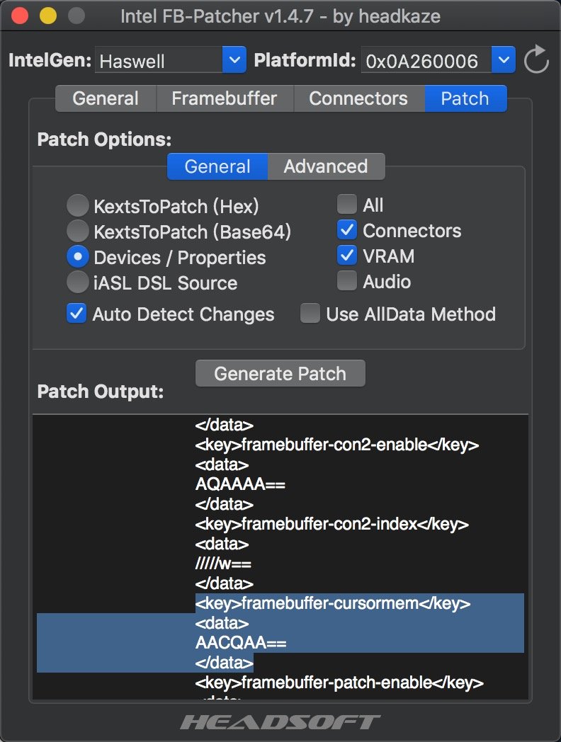

Mison Posted October 9, 2018 Share Posted October 9, 2018 I found a bug in FB-Patcher v1.4.7. 'framebuffer-cursormem' will not appear when I generate them with 'iASL DSL Source'. Link to comment Share on other sites More sharing options...
headkaze Posted October 9, 2018 Author Share Posted October 9, 2018 20 minutes ago, Mison said: I found a bug in FB-Patcher v1.4.7. 'framebuffer-cursormem' will not appear when I generate them with 'iASL DSL Source'. Thanks for reporting. Fixed in v1.4.8. 1 Link to comment Share on other sites More sharing options...

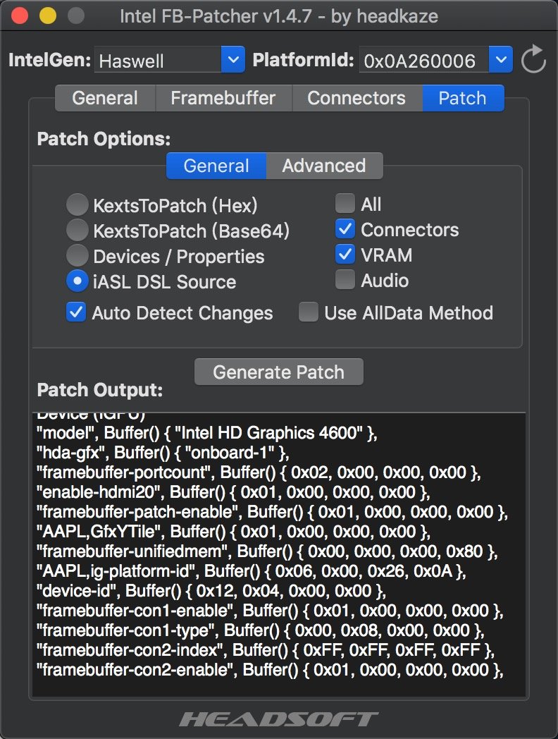

Alpha22 Posted October 15, 2018 Share Posted October 15, 2018 (edited) Hi headkaze as per photo CursorMemorySize 0 bytes it's right Edited October 15, 2018 by Alpha22 Link to comment Share on other sites More sharing options...

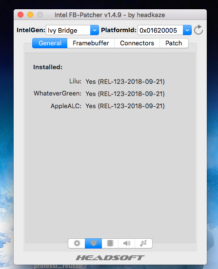

Matgen84 Posted October 16, 2018 Share Posted October 16, 2018 4 hours ago, headkaze said: How is it not detecting it correctly? REL means release. I talk about numbers after REL: version info. I use : Lilu v1.2.7 (Release 2018-09-11) AppleALC v1.3.2 (Relese 2018-09-11) Whatevergreen v1.2.3 (Release 2018-09-21) Intel FB Patcher v1.4.9 displays REL 123-2018-09-21 for all kexts Link to comment Share on other sites More sharing options...
HmO Posted October 16, 2018 Share Posted October 16, 2018 (edited) 33 minutes ago, Matgen84 said: I talk about numbers after REL: version info. I use : Lilu v1.2.7 (Release 2018-09-11) AppleALC v1.3.2 (Relese 2018-09-11) Whatevergreen v1.2.3 (Release 2018-09-21) Intel FB Patcher v1.4.9 displays REL 123-2018-09-21 for all kexts The same thing WhateverGreen.kext (v.1.2.4) Lilu.kext (v.1.2.7) AppleALC.kext (v.1.3.3) Edited October 16, 2018 by Ukr55 Link to comment Share on other sites More sharing options...
headkaze Posted October 16, 2018 Author Share Posted October 16, 2018 58 minutes ago, Matgen84 said: Intel FB Patcher v1.4.9 displays REL 123-2018-09-21 for all kexts Yes, it was a bug. Fixed in 1.5.0. Thank you. 1 Link to comment Share on other sites More sharing options...

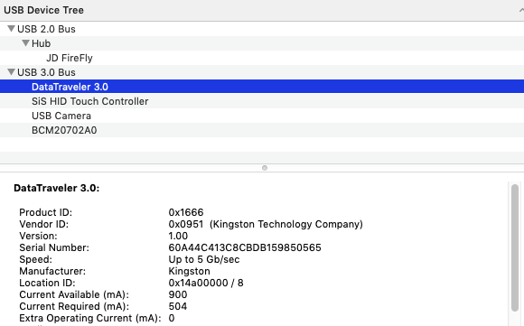

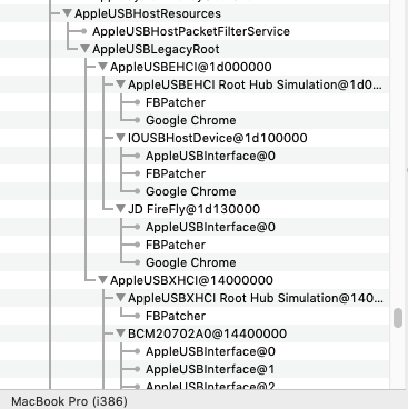

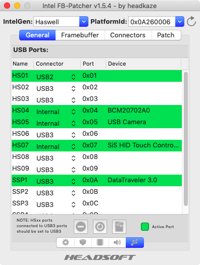

SavageAUS Posted October 23, 2018 Share Posted October 23, 2018 (edited) Hi, i am having an issue with the app detecting the two USB 2.0 ports on the left hand side on my laptop, the ports work as you will see in the screenshot but does not show up in fb-patcher. Legacy USB is disabled in my bios and XHCI pre boot is set to smart auto i think. The 3 highlighted ports are internal, i just need to map the 3 ( 2 x USB 2.0 and 1 x USB 3.0. HS01 & SSP1 is the USB 3.0 port. Any suggestion on what i need to change or add would be appreciated. I am using the port limit patch (might not be needed for this laptop) and have usbinjectall. SSDT-UIAC.aml Edited October 23, 2018 by SavageAUS Link to comment Share on other sites More sharing options...
headkaze Posted October 23, 2018 Author Share Posted October 23, 2018 30 minutes ago, SavageAUS said: Hi, i am having an issue with the app detecting the two USB 2.0 ports on the left hand side on my laptop, the ports work as you will see in the screenshot but does not show up in fb-patcher. Legacy USB is disabled in my bios and XHCI pre boot is set to smart auto i think. The 3 highlighted ports are internal, i just need to map the 3 ( 2 x USB 2.0 and 1 x USB 3.0. HS01 & SSP1 is the USB 3.0 port. Any suggestion on what i need to change or add would be appreciated. I am using the port limit patch (might not be needed for this laptop) and have usbinjectall. You do need to remove your SSDT-UIAC.aml file before configuring ports but it looks like you have an additional USB controller and it could quite possibly need an additional kext. Can you please run "ioreg -l >ioreg.txt" from Terminal and attach it here. Link to comment Share on other sites More sharing options...
headkaze Posted October 24, 2018 Author Share Posted October 24, 2018 (edited) @SavageAUS can you download FB-Patcher v1.5.5. It can now export USBEHCPorts.kext and USBXHCPorts.kext. I'm guessing that's what you need? Edited October 24, 2018 by headkaze Link to comment Share on other sites More sharing options...
SavageAUS Posted October 24, 2018 Share Posted October 24, 2018 2 hours ago, headkaze said: @SavageAUS can you download FB-Patcher v1.5.5. It can now export USBEHCPorts.kext and USBXHCPorts.kext. I'm guessing that's what you need? Downloaded, removed SSDT, Applied USB port patch...now waiting for macOS update to finish downloading then i will test. Link to comment Share on other sites More sharing options...
