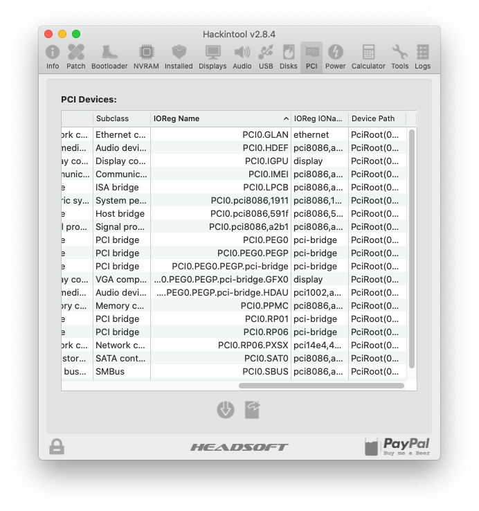

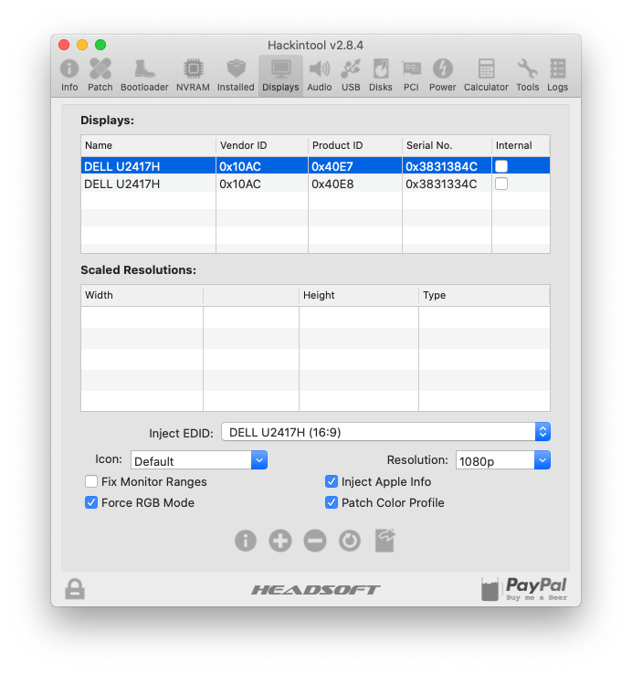

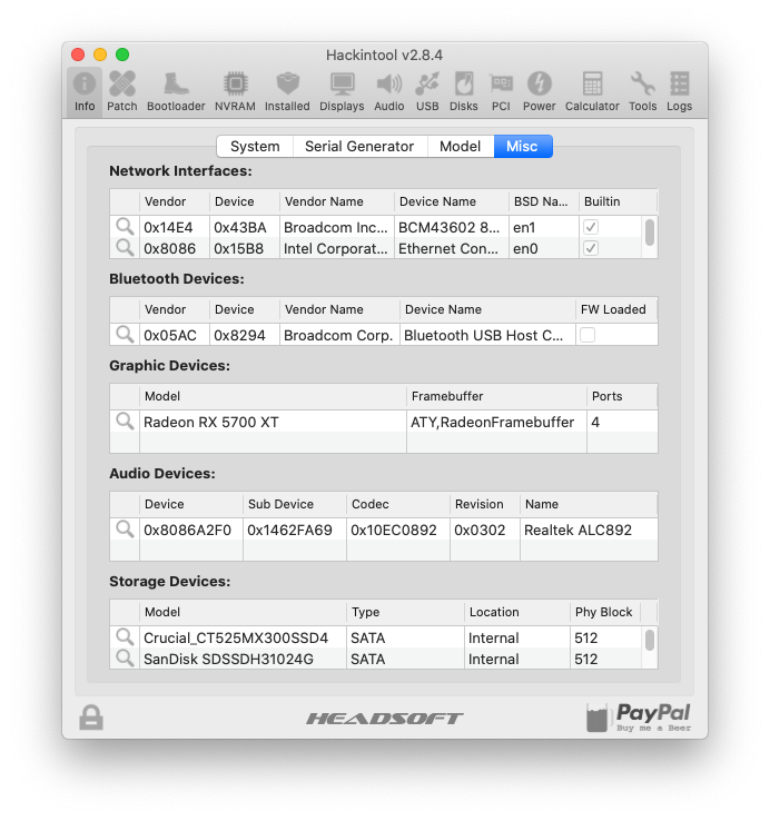

Alex HQuest Posted October 31, 2019 Share Posted October 31, 2019 Display information: Much better The Bluetooth firmware is still not reflected. The PCI IOReg Name column thing is still not wide enough for these two display lines. Pictures for them all. 1 Link to comment Share on other sites More sharing options...
headkaze Posted November 1, 2019 Author Share Posted November 1, 2019 On 10/31/2019 at 8:51 AM, Alex HQuest said: Display information: Much better The Bluetooth firmware is still not reflected. The PCI IOReg Name column thing is still not wide enough for these two display lines. Pictures for them all. A new version has been released. The BT firmware upload issue is with BrcmPathRAM3 and hopefully @Mieze will add the registry entry to check for this. I did add some more width to the IOReg Name column too. 2 Link to comment Share on other sites More sharing options...

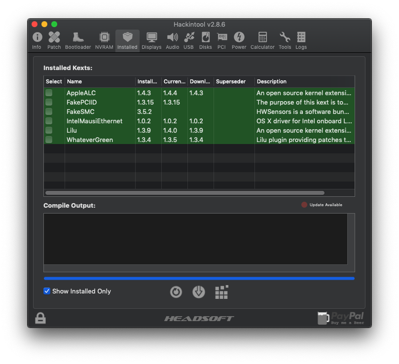

MacKonsti Posted November 27, 2019 Share Posted November 27, 2019 Hi @headkaze hope you are well ! Thanks again for releasing v2.8.6 Please, are we supposed to get a red colour with newer kexts available? I have checked the option to show only installed; but seems I get the green line despite having new kexts to download. Please see image. Is this to be expected? Many thanks! Link to comment Share on other sites More sharing options...
headkaze Posted November 27, 2019 Author Share Posted November 27, 2019 1 hour ago, MacKonsti said: I have checked the option to show only installed; but seems I get the green line despite having new kexts to download. You have the latest release versions which still highlight green. Compiling the latest Github version is up to you. 2 Link to comment Share on other sites More sharing options...
MacKonsti Posted November 27, 2019 Share Posted November 27, 2019 I see, so the Github version obviously precedes the pre-compiled binaries available later. Thank you for the clarification! Link to comment Share on other sites More sharing options...

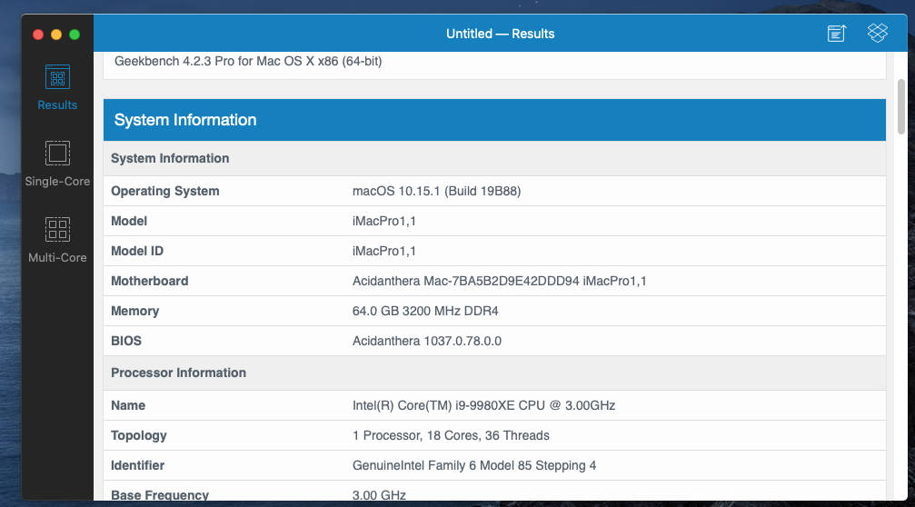

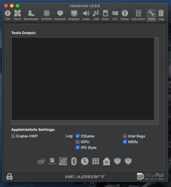

nmano Posted December 1, 2019 Share Posted December 1, 2019 Intel(R) Core(TM) i9-9980XE CPU @ 3.00GHz @headkaze If you can please update get AppleIntel info because i9 9980XE CPU I can’t get info Its panic. Thanks Team. Link to comment Share on other sites More sharing options...

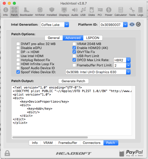

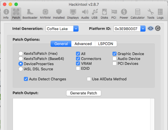

HmO Posted December 15, 2019 Share Posted December 15, 2019 Hi @headkaze why does not generate code for patch this is bug? Link to comment Share on other sites More sharing options...
headkaze Posted December 15, 2019 Author Share Posted December 15, 2019 2 hours ago, HmO said: Hi @headkaze why does not generate code for patch this is bug? What are your General options? Link to comment Share on other sites More sharing options...
HmO Posted December 15, 2019 Share Posted December 15, 2019 3 hours ago, headkaze said: What are your General options? Link to comment Share on other sites More sharing options...

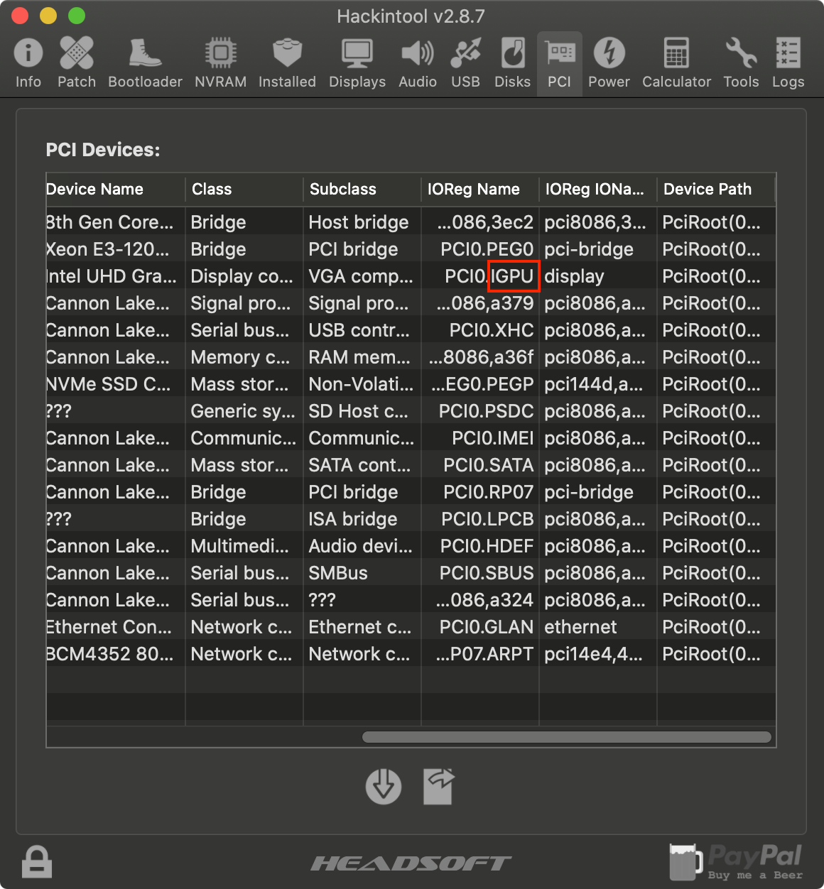

headkaze Posted December 15, 2019 Author Share Posted December 15, 2019 9 hours ago, HmO said: 15 hours ago, HmO said: Hi @headkaze why does not generate code for patch this is bug? Most likely you don't have an IGPU entry in your PCI list. What is the IOReg Name of your internal display? Link to comment Share on other sites More sharing options...
HmO Posted December 18, 2019 Share Posted December 18, 2019 On 12/16/2019 at 1:41 AM, headkaze said: Most likely you don't have an IGPU entry in your PCI list. What is the IOReg Name of your internal display? Hi @headkaze everything works well, someone in the bios turned off IGPU Link to comment Share on other sites More sharing options...
