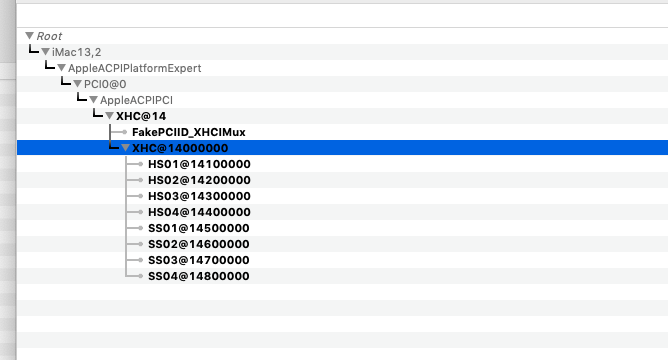

Im on Catalina beta with my laptop in signature and I have already a working ssd-uaic file created with the rehabman method but I wanted to try your method too so I deleted it and I followed the steps described in the Hackintool info.
At the end of the process I noticed that my left usb 3.0 didn't work at full usb 3 speed but it was only recognized as 2.0. So I installed my old ssd-uiac and I noticed that a usb 3.0 pen in the left USB port of my laptop doesn't show at all in the USB ports list in Hackintool.
I noticed another strange behavior when I was checking my USB ports with usbinjectall and the port limit patch(without my ssd-uiac): when I plug a usb 2/3.0 in the others 2 port it highlights both the hs and ss ports at the same time(is it normal?), this doesn't happen when I plug an usb 2/3 in the left port, in this case the USB port name remains the same (HS01) while in the ioreg its hs01 for the usb 2.0 and ss01 for the usb3.0.

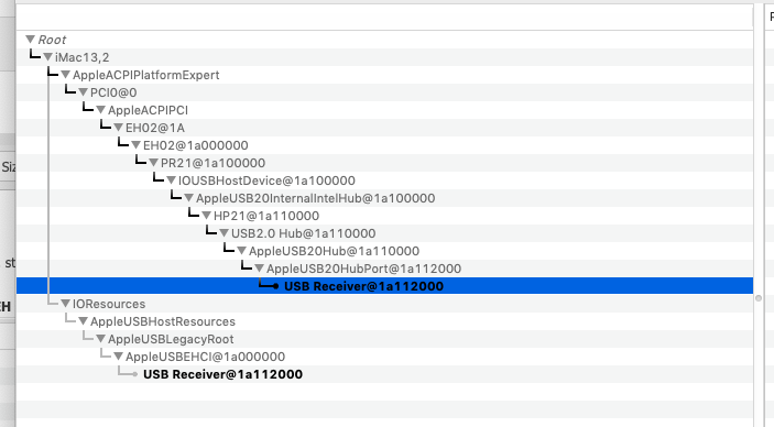

Hello! I need help... I need patch my USB ports...!
My MOBO: Z77N Wifi. Manal say this:
 10. Reboot with -uia_exclude_ss uia_include=HS01,HS02 boot flags (Yes I've already applied the previous 9. steps)
Change the HS01,HS02 ports to the ones you have your mouse and keyboard attached.
Okay but i don't have HS ports!! Ioreg show HS ports but no devices connected in XHCI@14000000. I have HP + PR ports! So i also need "uia_include=HS01,HS02" with replace "uia_include=HP or PR01,HP or PR02"???
Thanks!978096879_IOREGSCREEN.png.d438fb7add2659451ed87ec76a789a22.png522863565_IOREGSCREEN2.png.f1d2cf99421a537910f89d51d7711cbc.png

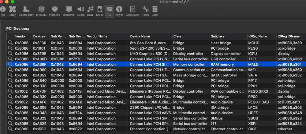

Hi @headkaze
Your amazing tool don't detect correctly my 9th gen (i7 9700K) Coffe Lake - R and z390 chipset, I think. Screenshot in attachment.
Thanks for your work
Hackintool I believe populates the PCI Devices based off what devices are in your ACPI tables, it looks like from the screen shot you using a patched DSDT and have added some of Maldron's devices.
Right. But PCIIDs repo isn't up to date: there isn't 9th Gen core listed for example.

2 hours ago, jamesxxx1997 said:
I'm pretty sorry to bother you , @headkaze , for I found out a weird thing when using hackintool to generate SSDT-UIAC & SSDT-USBX.
When I does the exact same patch with Rehabman's SSDT.UIAC and Hackintool's SSDT.UIAC  , the rehabs' result is this ; while the hackintools' result is this.  This is my ioreg dump and EFI , hoping you can take a look when you have time , thanks!
The only difference I can see is that "XHC" is defined as "8086_9dxx".
I've attached one with "XHC" changed to "8086_9d2f". Can you see if it works the same way as Rehabman's?
