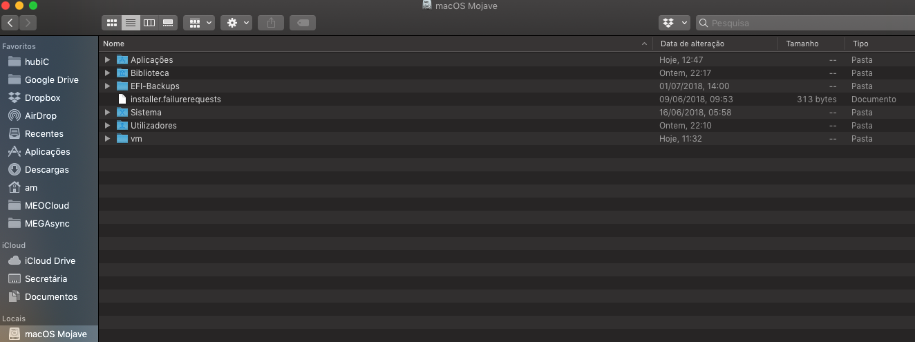

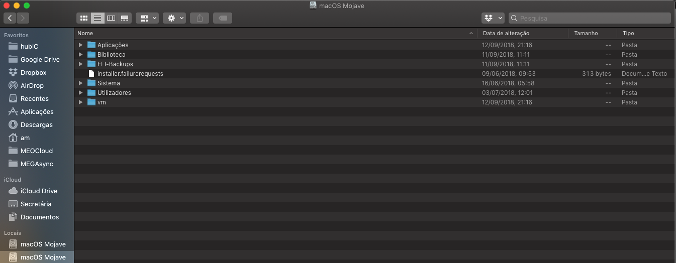

MorenoAv Posted September 18, 2018 Share Posted September 18, 2018 (edited) Hi Guys, Today after switching from macOS High Sierra to macOS Mojave, after writing the new name in my ssd I saw the following files in the list, and I don't know what they are, but before emptying my trash is better to ask... The same file was in my other ssd with Mojave. installer.failurerequests installer.failurerequests 2 Edited September 18, 2018 by MorenoAv Link to comment Share on other sites More sharing options...

chris1111 Posted September 18, 2018 Share Posted September 18, 2018 (edited) 2 hours ago, MorenoAv said: Hi Guys, Today after switching from macOS High Sierra to macOS Mojave, after writing the new name in my ssd I saw the following files in the list, and I don't know what they are, but before emptying my trash is better to ask... The same file was in my other ssd with Mojave. installer.failurerequests installer.failurerequests 2 this file is suppose to hidden Command sudo chflags hidden /Volumes/"name of SSD"/installer.failurerequests Edited September 18, 2018 by chris1111 Link to comment Share on other sites More sharing options...
MorenoAv Posted September 18, 2018 Share Posted September 18, 2018 (edited) Well @chris1111, something was telling me to ask before deleting them... Thanks man Edited September 18, 2018 by MorenoAv Link to comment Share on other sites More sharing options...
MorenoAv Posted September 18, 2018 Share Posted September 18, 2018 After trying the command you provided, it didn't work, but I realized that all the contents are visible, as you could see in the photos attached... Link to comment Share on other sites More sharing options...
chris1111 Posted September 19, 2018 Share Posted September 19, 2018 11 hours ago, MorenoAv said: After trying the command you provided, it didn't work, but I realized that all the contents are visible, as you could see in the photos attached... If the volumes name is macOS Mojave Copy and paste this command in terminal sudo chflags hidden /Volumes/"macOS Mojave"/installer.failurerequests Link to comment Share on other sites More sharing options...
MorenoAv Posted September 19, 2018 Share Posted September 19, 2018 Thanks @chris1111 ... 1 Link to comment Share on other sites More sharing options...

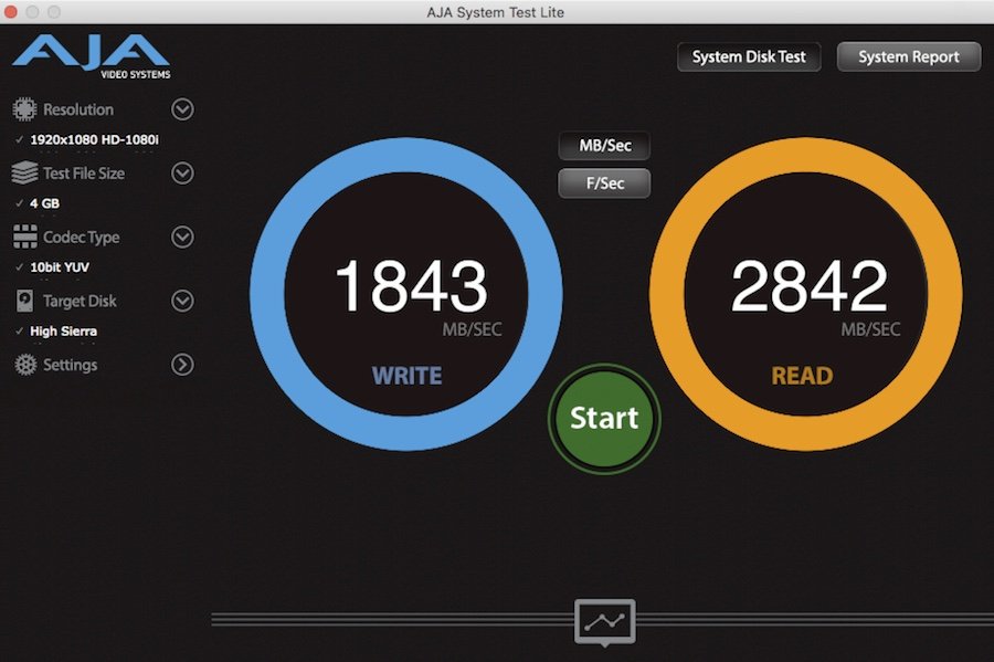

jerryy2 Posted September 20, 2018 Share Posted September 20, 2018 18 hours ago, telepati said: Yes, I have the latest BIOS v3802. Here is the weird thing coming; My board specification says it supports both SATA & PCIE mode. 1 x M.2 x4 Socket 3, with M Key, type 2242/2260/2280/22110 storage devices support (both SATA & PCIE mode) Or am I interpreting this sentence incorrectly? @surfinchina @jerryy2 @DocXavier are you all getting the same score for each test? Here are my 5 test results in a row; 1) 1560MB W 2100MB R 2) 700MB W 2150MB R 3) 350MB W 2185MB R 4) 1537MB W 2150MB R 5) 1532MB W 2085MB R This EVO is my boot drive and its APFS. is it possible the test without format on windows? I tried with Samsung Magician and CrystalDiskMark, but it does not allow. Also, I don't get it why I am not choosing M.2 on BIOS? When I try to choose it always turning SataExpress automatically after restart. Your interpretation is fine, but you have ran into the small print disclaimer, so to speak. My motherboard's manual says the same thing, just about word for word. Later though, in the small print section, the manual informs me that if I put a SATA type NVME drive in that M.2 slot, I will lose the regular SATA 0 port because of the bus sharing. Putting a pci-e type drive in there has no such restrictions. I think HBP's approach will be the easiest to try, not to overlook it being the least expensive. That should get you to having consistent SATA speeds for the drive. After that, the adapter should get you a little more speed, along the lines of what Pavo posted, but that is a conversation more for you and your cash flow. The results I posted are fairly steady. If I run the test suite for a bunch of trials, I get some results that are faster and some that are slower, but mostly similar to the one I posted. (I do not run the suite when backups or indexing is occurring.) I only can give you a glib answer about why your BIOS does not retain the setting. It maybe that the BIOS sees your wifi card and decides to make sure it takes priority and acts accordingly. The BIOS on my motherboard will not retain the onboard clock setting I enter no matter which time zone I set it to, it always reverts to Greenwich Mean Time (GMT) on the next startup. 1 Link to comment Share on other sites More sharing options...
