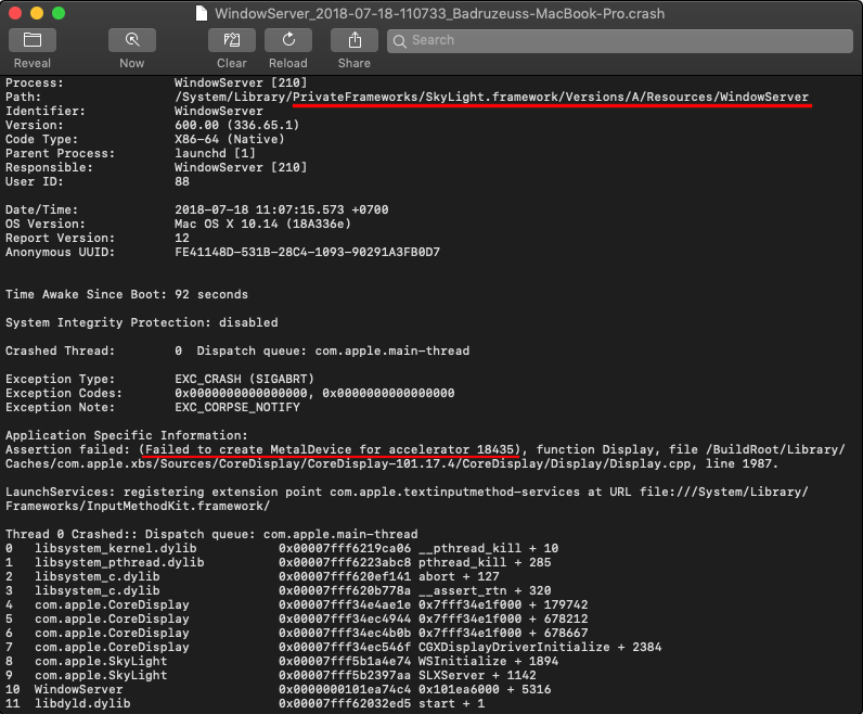

Badruzeus Posted July 18, 2018 Share Posted July 18, 2018 (edited) So, I just re-installed Beta 4 using Full Installer to find out what caused WindowServer crash with my Nvidia Fermi GF119. (Fyi, I am able to reach 10.14 Desktop using CoreDisplay binary from Beta 1 located on /System/Library/Frameworks/CoreDisplay.framework/Versions/A) Using CoreDisplay from Beta 2 - 4; what I get is; "Failed to create Metal Device for accelerator xxxxx". It seems Apple assumed Fermi as Kepler, while Kepler is Metal capable graphics (both Nvidia GF && GK drivers are still included on 10.14's SLE as well) which are using same tech. but diff capability, unfortunately. Interesting, why your Intel HD 1st Gen, HD3000, and some OLD AMD graphics that aren't Metal capable got no WindowServer crash issue with Mojave though using kexts from prev. macOS version? Edited July 18, 2018 by Badruzeus 1 1 Link to comment Share on other sites More sharing options...

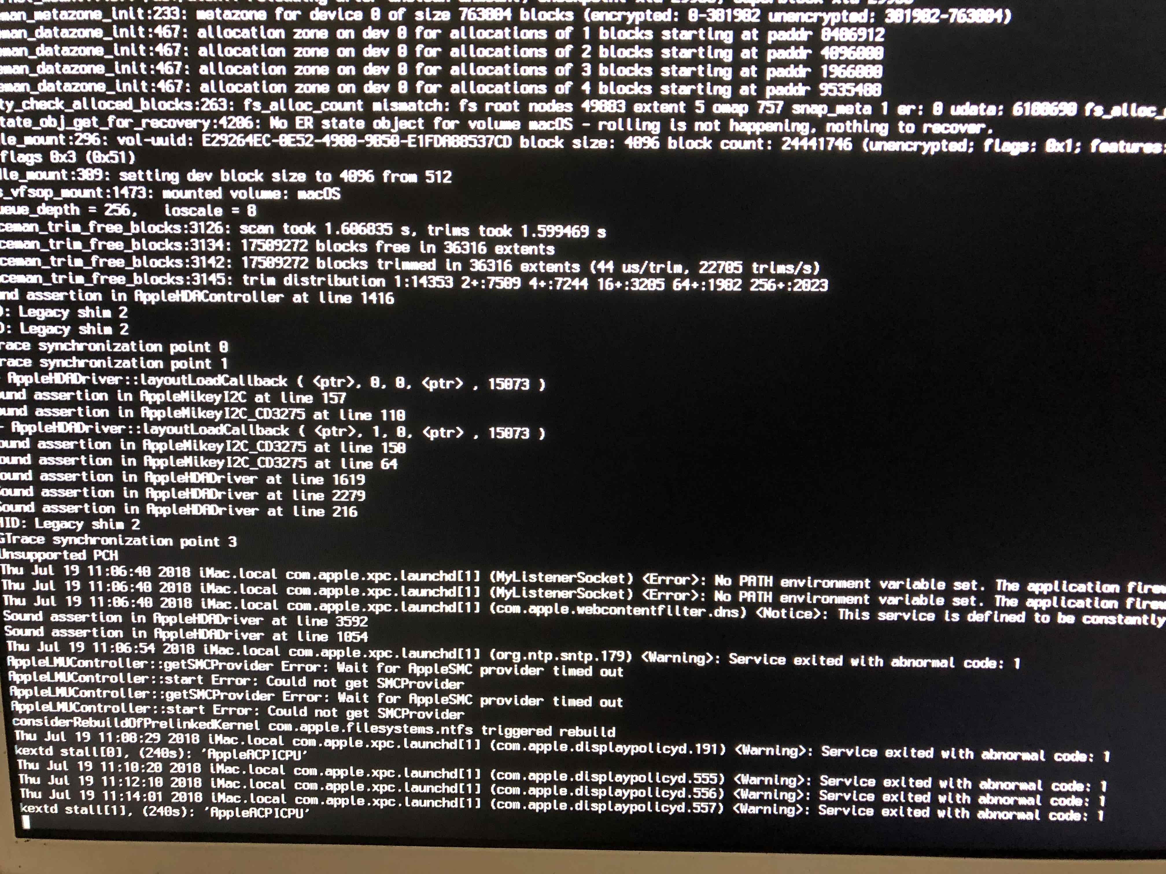

diepnt Posted July 19, 2018 Share Posted July 19, 2018 updated from beta 1 to 2 normally but from beta 2 to 3 got stuck as pictures. anyone has idea about that? Link to comment Share on other sites More sharing options...
diepnt Posted July 19, 2018 Share Posted July 19, 2018 2 hours ago, Moviemakergr said: Try to delete ACPIsensors plugin from fakesmc.kext How to do that? I only installed fakeSMC.kext into S/L/E. I also show content of fakeSMC.kext but not found ACPIsensors Thank you. Link to comment Share on other sites More sharing options...
Matgen84 Posted July 19, 2018 Share Posted July 19, 2018 1 hour ago, diepnt said: How to do that? I only installed fakeSMC.kext into S/L/E. I also show content of fakeSMC.kext but not found ACPIsensors Thank you. Do you try to put fakesmc in EFI/Clover/Kexts/Other rather than S/L/E? Do you try to press F11 in Clover GUI? Link to comment Share on other sites More sharing options...
