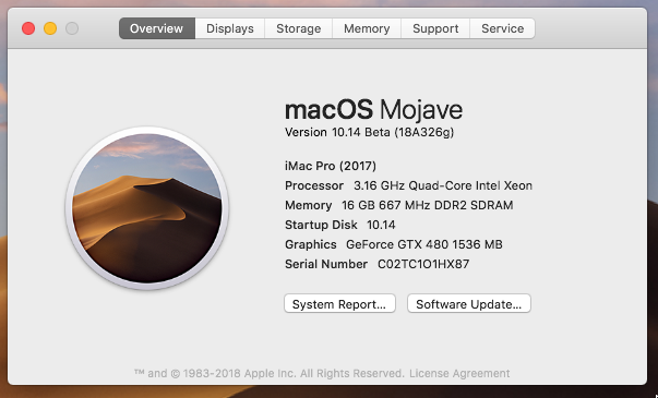

nmano Posted July 8, 2018 Share Posted July 8, 2018 (edited) I test now Intel(R) Xeon(R) CPU X5460 ITs worked to replace com.apple.telemetry.plugin still no success GTX 480 x86info v1.31pre Found 4 identical CPUs Extended Family: 0 Extended Model: 1 Family: 6 Model: 23 Stepping: 6 Type: 0 (Original OEM) CPU Model (x86info's best guess): Core 2 Duo P8600 Processor name string (BIOS programmed): Intel(R) Xeon(R) CPU X5460 @ 3.16GHz eax in: 0x00000000, eax = 0000000a ebx = 756e6547 ecx = 6c65746e edx = 49656e69 eax in: 0x00000001, eax = 00010676 ebx = 01040800 ecx = 000ce3bd edx = bfebfbff eax in: 0x00000002, eax = 05b0b101 ebx = 005657f0 ecx = 00000000 edx = 2cb4304e eax in: 0x00000003, eax = 00000000 ebx = 00000000 ecx = 00000000 edx = 00000000 eax in: 0x00000004, eax = 0c000121 ebx = 01c0003f ecx = 0000003f edx = 00000001 eax in: 0x00000005, eax = 00000040 ebx = 00000040 ecx = 00000003 edx = 00002220 eax in: 0x00000006, eax = 00000001 ebx = 00000002 ecx = 00000001 edx = 00000000 eax in: 0x00000007, eax = 00000000 ebx = 00000000 ecx = 00000000 edx = 00000000 eax in: 0x00000008, eax = 00000400 ebx = 00000000 ecx = 00000000 edx = 00000000 eax in: 0x00000009, eax = 00000000 ebx = 00000000 ecx = 00000000 edx = 00000000 eax in: 0x0000000a, eax = 07280202 ebx = 00000000 ecx = 00000000 edx = 00000503 eax in: 0x80000000, eax = 80000008 ebx = 00000000 ecx = 00000000 edx = 00000000 eax in: 0x80000001, eax = 00000000 ebx = 00000000 ecx = 00000001 edx = 20100000 eax in: 0x80000002, eax = 65746e49 ebx = 2952286c ecx = 6f655820 edx = 2952286e eax in: 0x80000003, eax = 55504320 ebx = 20202020 ecx = 20202020 edx = 58202020 eax in: 0x80000004, eax = 30363435 ebx = 20402020 ecx = 36312e33 edx = 007a4847 eax in: 0x80000005, eax = 00000000 ebx = 00000000 ecx = 00000000 edx = 00000000 eax in: 0x80000006, eax = 00000000 ebx = 00000000 ecx = 18008040 edx = 00000000 eax in: 0x80000007, eax = 00000000 ebx = 00000000 ecx = 00000000 edx = 00000000 eax in: 0x80000008, eax = 00003026 ebx = 00000000 ecx = 00000000 edx = 00000000 Cache info L1 Instruction cache: 32KB, 8-way associative. 64 byte line size. L1 Data cache: 32KB, 8-way associative. 64 byte line size. L2 cache: 6MB, 24-way set associative, 64-byte line size. TLB info Instruction TLB: 4x 4MB page entries, or 8x 2MB pages entries, 4-way associative Instruction TLB: 4K pages, 4-way associative, 128 entries. Data TLB: 4MB pages, 4-way associative, 32 entries Data TLB0: 4KB pages, 4-way associative, 16 entries Data TLB0: 4MB pages, 4-way associative, 16 entries Data TLB1: 4KB pages, 4-way associative, 256 entries 64 byte prefetching. Feature flags: fpu vme de pse tsc msr pae mce cx8 apic sep mtrr pge mca cmov pat pse36 clflsh ds acpi mmx fxsr sse sse2 ss ht tm pbe sse3 dtes64 monitor ds-cpl vmx est tm2 ssse3 cx16 xTPR pdcm dca sse4_1 Extended feature flags: xd em64t lahf_lm dts Long NOPs supported: yes Address sizes : 38 bits physical, 48 bits virtual 3.20GHz processor (estimate). Total processor threads: 4 This system has 1 quad-core processor running at an estimated 3.20GHz Edited July 8, 2018 by nmano 2 Link to comment Share on other sites More sharing options...

nmano Posted July 9, 2018 Share Posted July 9, 2018 For GTX 480 If I want to replace NV kexts 10.13.4 to 10.14 How many files I need to replace.please give me list Link to comment Share on other sites More sharing options...
Badruzeus Posted July 9, 2018 Share Posted July 9, 2018 (edited) 1 hour ago, nmano said: For GTX 480 If I want to replace NV kexts 10.13.4 to 10.14 How many files I need to replace.please give me list GeForce* NVDA*.kext Though I've reinstalled Mojave more than 5 times, only for testing Nvidia Drivers from prev. mac versions; w/o success. It' s ez changing RequiredOS from NVDAStartup Info.plist, kext for Fermi (NVDAGF100*) is loaded just fine, but nor with GeForce.kext, so we'll lost nvAccelerator. Edited July 9, 2018 by Badruzeus 1 Link to comment Share on other sites More sharing options...

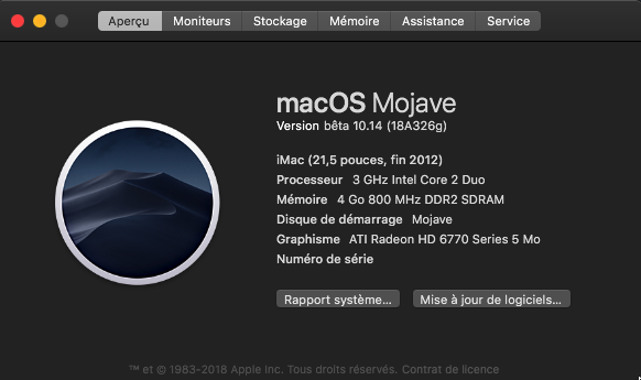

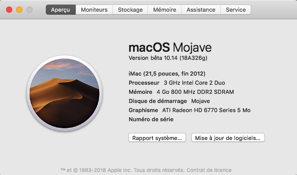

fantomas Posted July 9, 2018 Author Share Posted July 9, 2018 macOS Mojave beta 3 on Intel Core2Duo E8400 (SSE4,1) Used @crazybirdy MBR script to create Mojave USB installer + Clover r4515 - I have only 1 HDD with 1 HFS+J partition for HS. I just created a second HFS+J partition for Mojave and that did the job. As in a post-installation, manually patching of com.apple.telemetry.plugin (Clover patch on the fly didn't work. ) and voilà. 3 2 Link to comment Share on other sites More sharing options...

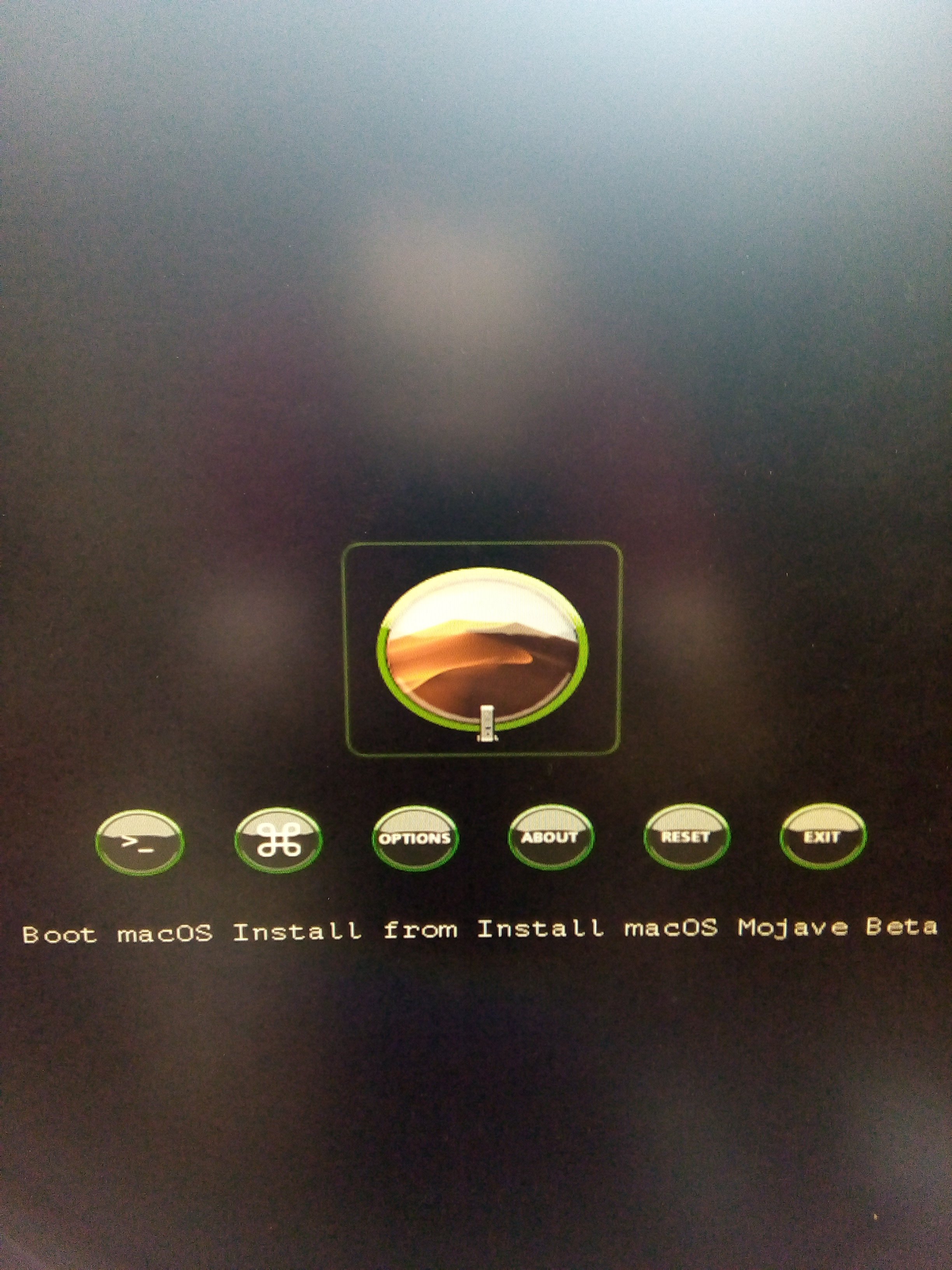

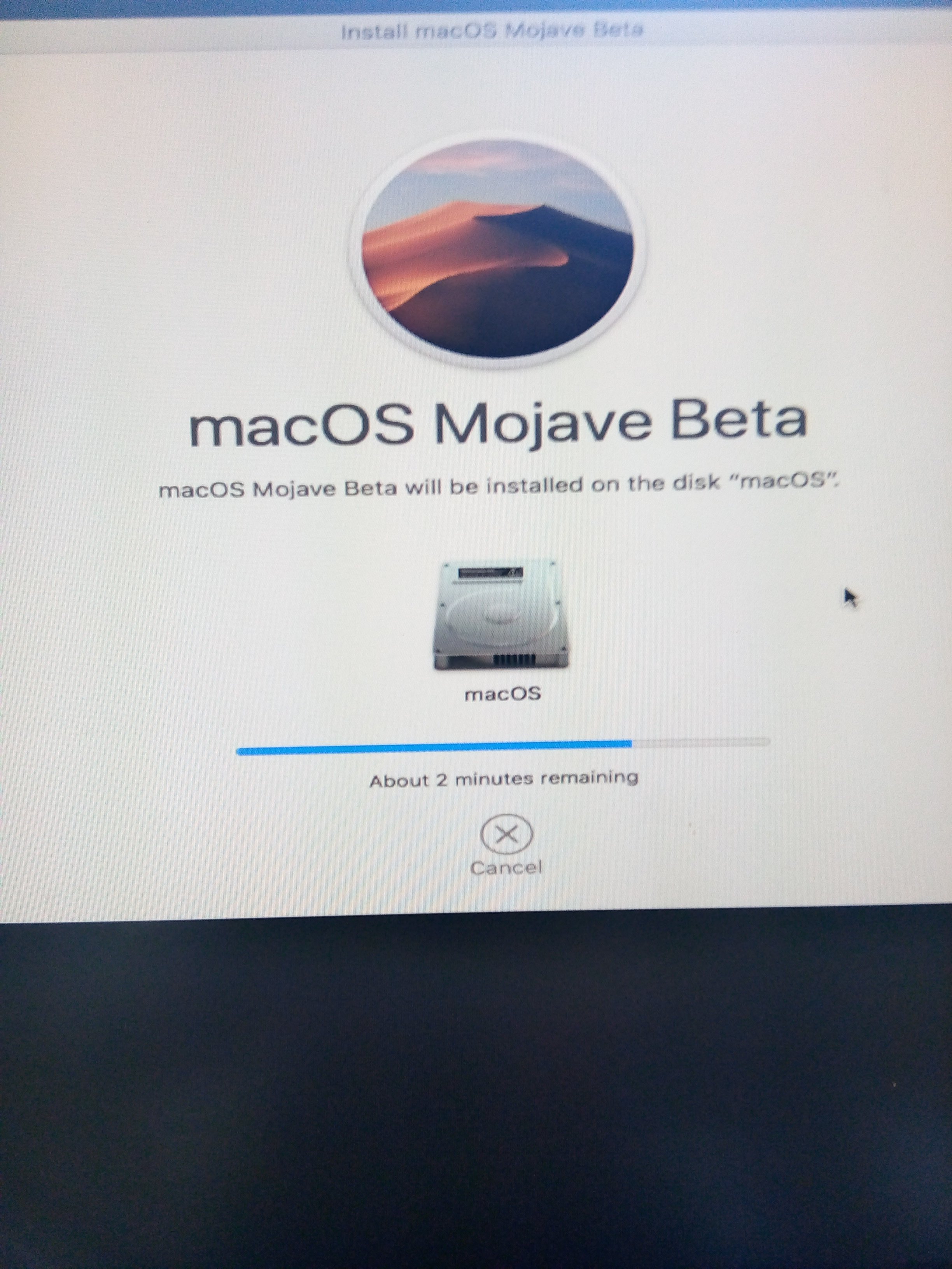

ANONIMNIQ Posted July 9, 2018 Share Posted July 9, 2018 @crazybirdy I use your CLOVER folder and removed some drivers to load the installer successfully but PC restarts at this point of the installation and CLOVER don't detect the HDD to continue installation process. What I'm doing wrong? I create the installer from the Terminal. Is it possible that the installer is damaged? Link to comment Share on other sites More sharing options...
