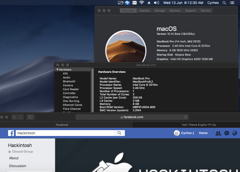

Mc Jacej Posted June 13, 2018 Share Posted June 13, 2018 mojave on my acer aspire v3 471g 2 Link to comment Share on other sites More sharing options...

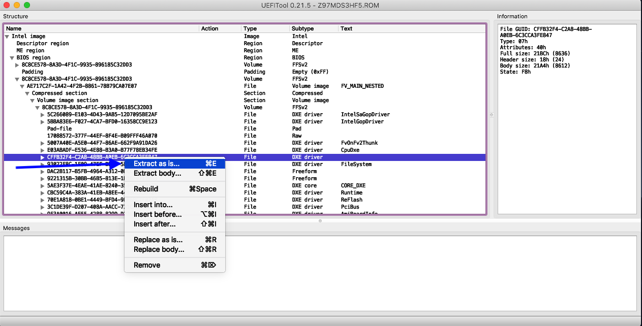

ammoune78 Posted June 13, 2018 Share Posted June 13, 2018 (edited) 5 hours ago, cecekpawon said: This "ffs"? $ xxd apfs.ffs 00000000: 6270 6c69 7374 3030 d301 0203 0405 065c bplist00.......\ 00000010: 4e53 5552 4c4e 616d 654b 6579 5f10 104e NSURLNameKey_..N 00000020: 5355 524c 4669 6c65 5369 7a65 4b65 795f SURLFileSizeKey_ 00000030: 1018 4e53 5552 4c46 696c 6552 6573 6f75 ..NSURLFileResou 00000040: 7263 6554 7970 654b 6579 5841 5046 532e rceTypeKeyXAPFS. 00000050: 6666 7311 0f41 5f10 1c4e 5355 524c 4669 ffs..A_..NSURLFi 00000060: 6c65 5265 736f 7572 6365 5479 7065 5265 leResourceTypeRe 00000070: 6775 6c61 7208 0f1c 2f4a 5356 0000 0000 gular.../JSV.... 00000080: 0000 0101 0000 0000 0000 0007 0000 0000 ................ 00000090: 0000 0000 0000 0000 0000 0075 ...........u 4 hours ago, HBP said: here is where the originalAPFS.EFI jumpstarted I posted came from, I simply extracted the one from my ROM instead of taking the time to locate the original post. HBP The reason for that question HBP, is because if you open that APFS you uploaded yesterday with an Hex editor, it will show the exact code quoted by @cecekpawon, while if you open the APFS from the link you provided from @griven post it will show another, this happened while you extracted the APFS file, because you should right click on the module, and then select: extract as is, using UEFITool like the screenshot above: Thanks for that link anyway Edited June 13, 2018 by ammoune78 1 Link to comment Share on other sites More sharing options...

HBP Posted June 13, 2018 Share Posted June 13, 2018 1 hour ago, ammoune78 said: The reason for that question HBP, is because if you open that APFS you uploaded yesterday with an Hex editor, it will show the exact code quoted by @cecekpawon, while if you open the APFS from the link you provided from @griven post it will show another, this happened while you extracted the APFS file, because you should right click on the module, and then select: extract as is, using UEFITool like the screenshot above: Thanks for that link anyway this is how I extracted it, as I have discovered, even with SIP off, Mojave Protects files it thinks are sacred. the file uploaded was from Mojave right after I got it back up and running, the original is larger (3905 bytes) but Mojave refuses to read it for some reason. Link to comment Share on other sites More sharing options...
