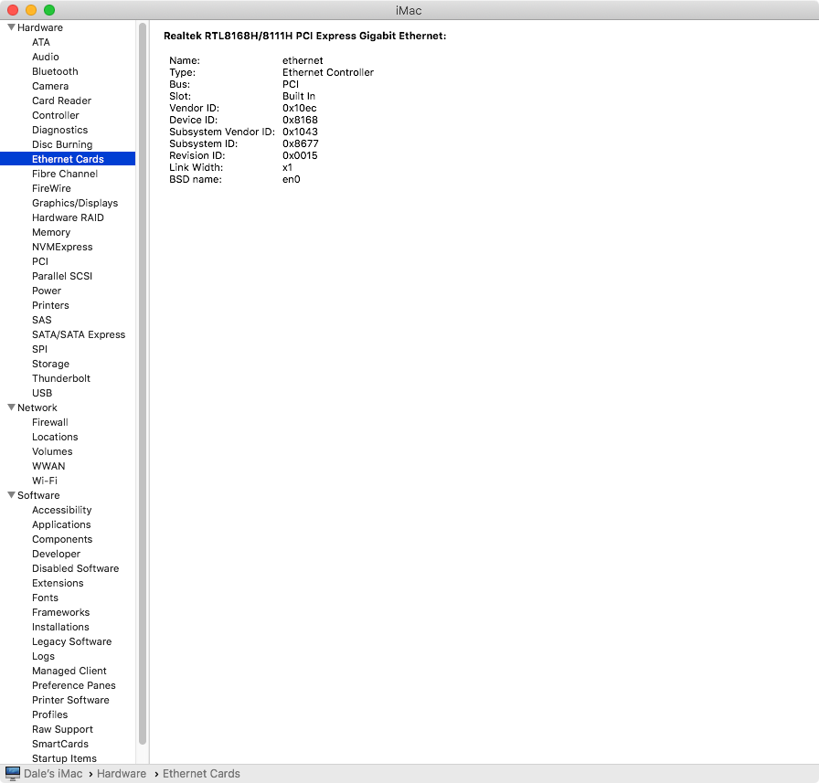

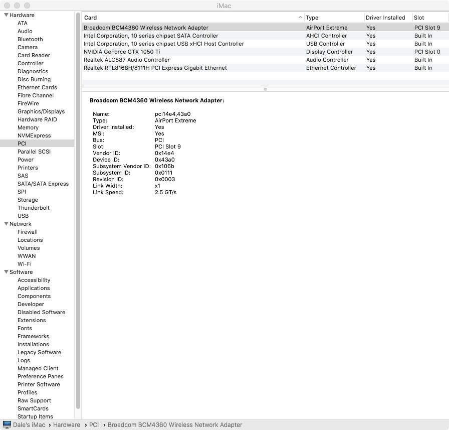

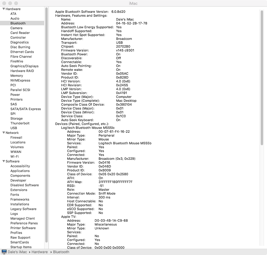

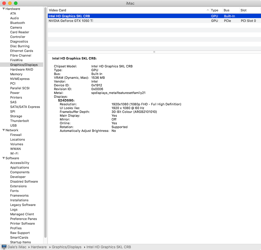

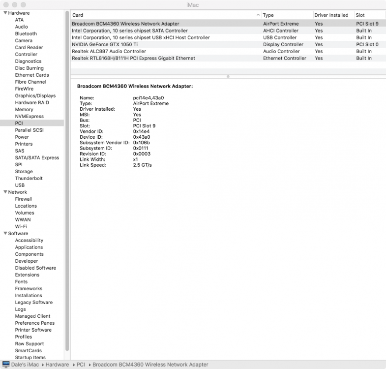

daleski75 Posted June 7, 2018 Share Posted June 7, 2018 iMessages does not appear to sync with my iPhone or ipad My Apple Watch no longer unlocks the hackintosh Asides from this everything looks good. Also it now shows both my Intel HD530 and my Nvidia 1050 Ti so need to buy another monitor to test this lol Link to comment Share on other sites More sharing options...

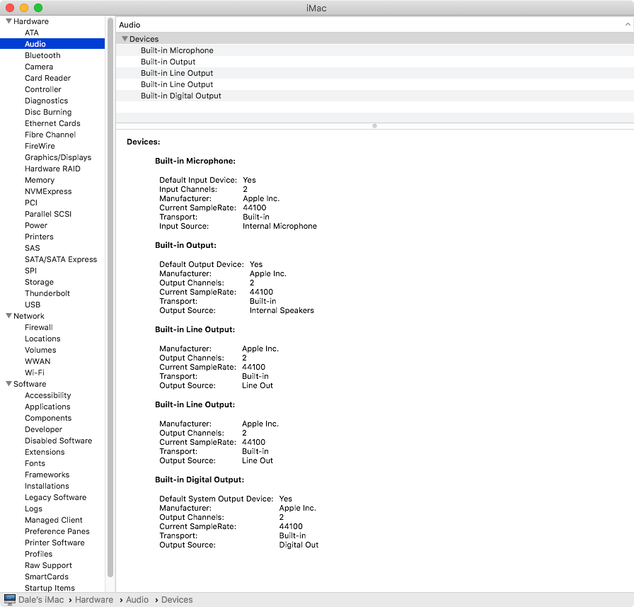

In-N-Out Posted June 7, 2018 Share Posted June 7, 2018 (edited) Yippee!! I finally got audio! Trying to retrace all of my steps that finally made it work. Please don't pay attention to the bottom photo, I posted it to the wrong post and can't figure out how to delete it here. Edited June 7, 2018 by In-N-Out Updated Link to comment Share on other sites More sharing options...

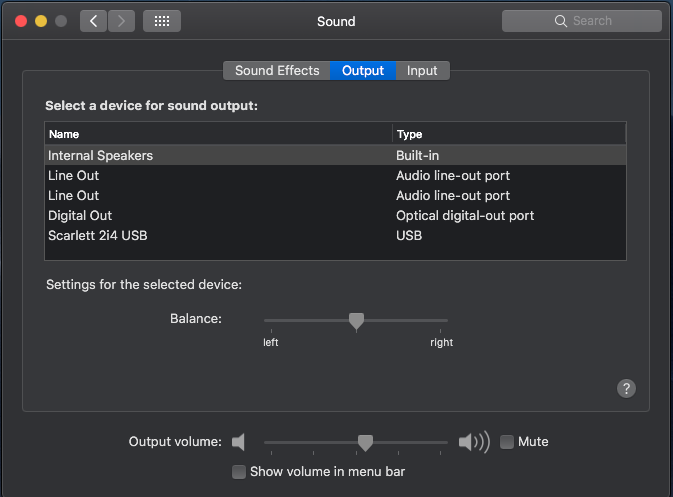

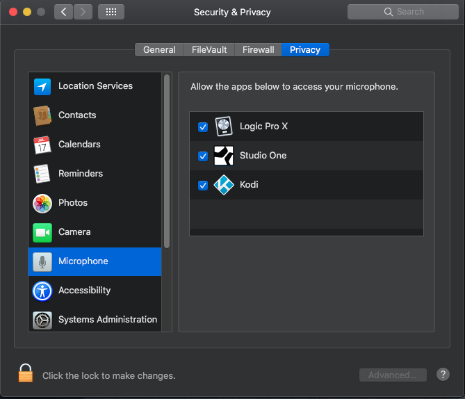

In-N-Out Posted June 7, 2018 Share Posted June 7, 2018 (edited) That victory above was short lived. Loaded 2 of my DAW's and neither get's an input signal through my Focusrite Scarlett 2i4 interface. I can route computer audio through it like always (youtube etc..) but when I hook up my guitar into the Focusrite, choose the Scarlett interface in each DAW no signals gets to the DAW's. I even tried Logic Pro X (newest version) and nothing. Drivers for the Scarlett interface were never needed for OSX, macOS since it is class compliant. If anyone has an idea on how to fix this please let me know. Oh well, that's why they call it beta. Update: Found the issue I hadn't granted access to the Microphone for the two DAWS. That is something new during the install and I just didn't choose it but found it elsewhere and enabled it. All is well now with my 2i4 Scarlett interface under Mojave! Edited June 7, 2018 by In-N-Out Link to comment Share on other sites More sharing options...

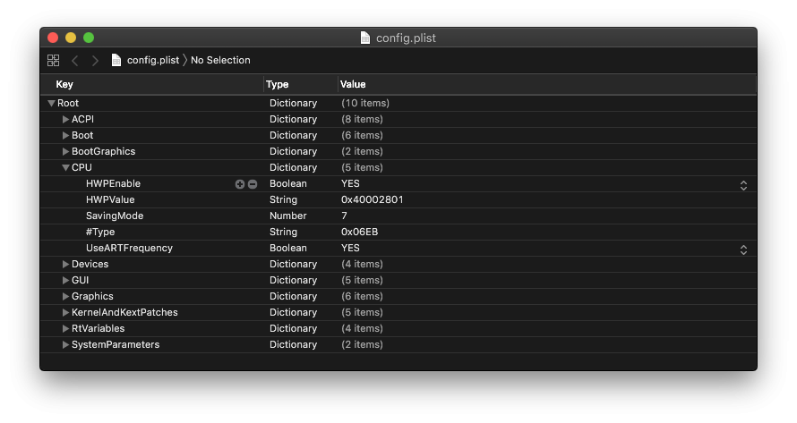

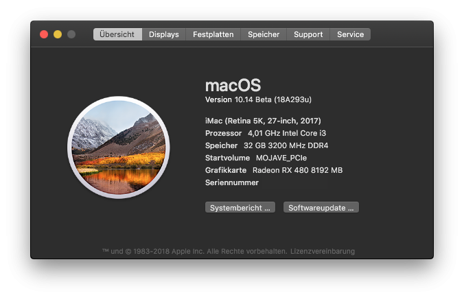

Mork vom Ork Posted June 7, 2018 Share Posted June 7, 2018 (edited) 8 hours ago, winlog said: How did you manage to work identification of CPU? Coffee Lake is Unknown CPU for me still.... I did it this way: You just need to disable the "Type" entry in category "CPU" by setting it to "#Type" - of cause only, if you have such an entry. Set this, system will keep the right CPU info automatically. Edited June 7, 2018 by Mork vom Ork 3 Link to comment Share on other sites More sharing options...

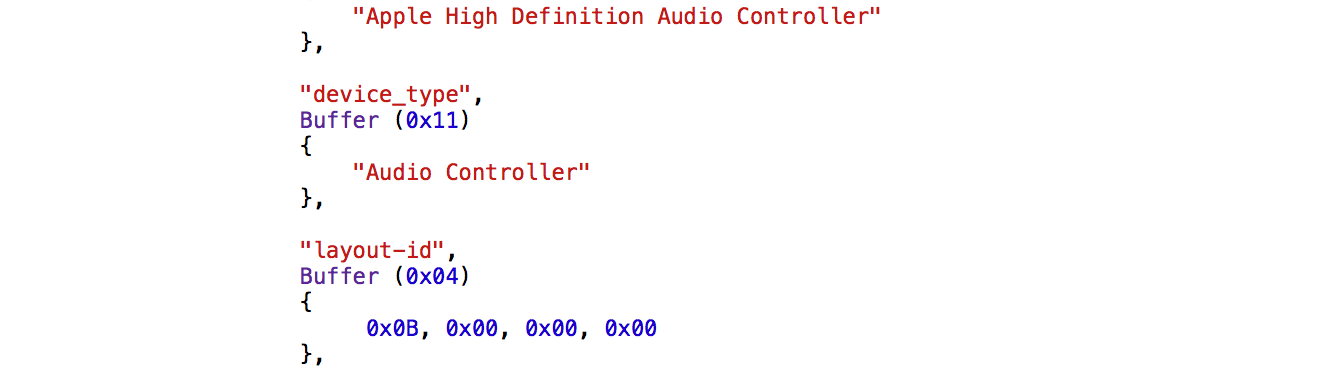

RandomTech Posted June 7, 2018 Share Posted June 7, 2018 4 hours ago, Pavo said: Because vit9696 changed the way it handles provided layout-ids, your provided layout-id is read only by AppleALC then changed to whatever AppleHDA uses by magic. My audio layout-id is managed in DSDT to 11 (I think), I removed the SSDT completely and set in config.plist to 2 and it worked.. Any suggestion on how I change DSDT to layout-id 2 please? I have no idea what those 0x0B, 0x00, 0x00, 0x00 numbers are Link to comment Share on other sites More sharing options...
