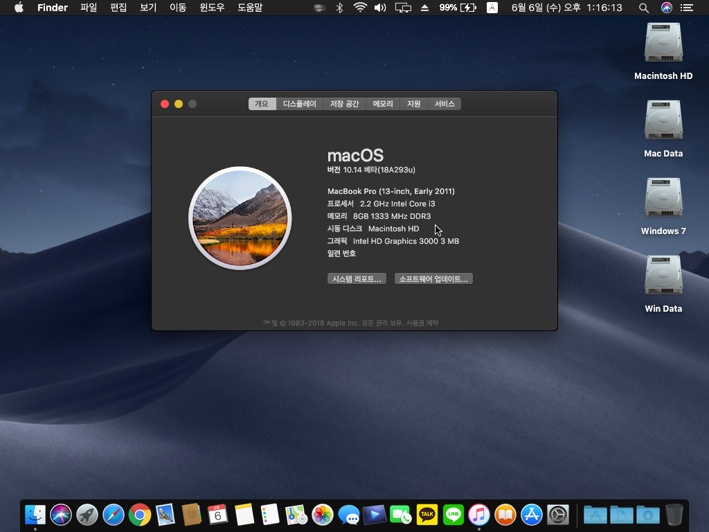

all right. HD 3000, now, get black screen after pass verbose screen.
i tested all graphic files of High Sierra in 10.14.
My Sandy Bridge laptop issue in 10.14
1. CPUPM
2. HD 3000 Accelerator
except list above, all is good.
if someone find some solution, it's best. or give up 10.14 in sandy brigde laptop.
i think users of 1st generation laptop have been experienced since long time ago.
hope they find some solution. i will return High Sierra on 4230s.
thanks.

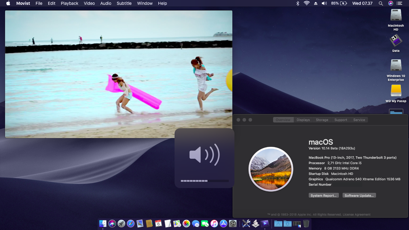

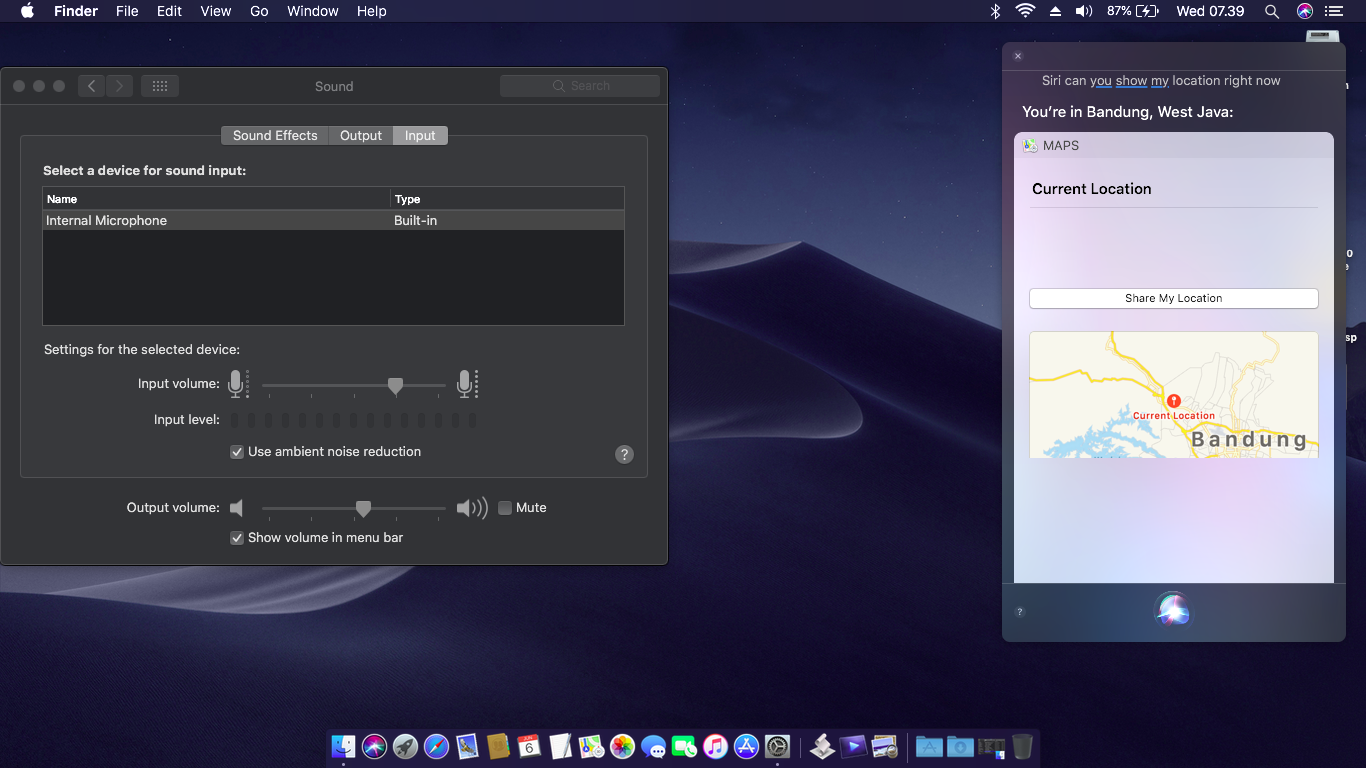

Working great with Layout id for ALC236 = 15,,
But with AppleALC.kext, layoutid=15 is no internal mic. At High sierra i used LayouID = 13 and Internal Mic is good.
So i download AppleALC Master from Github and modif it, delete all data for LayouID 15 and change data of layoutID 13 to LayoutID 15 then recompile AppleALC.kext
Now Audio and Mic is working great again

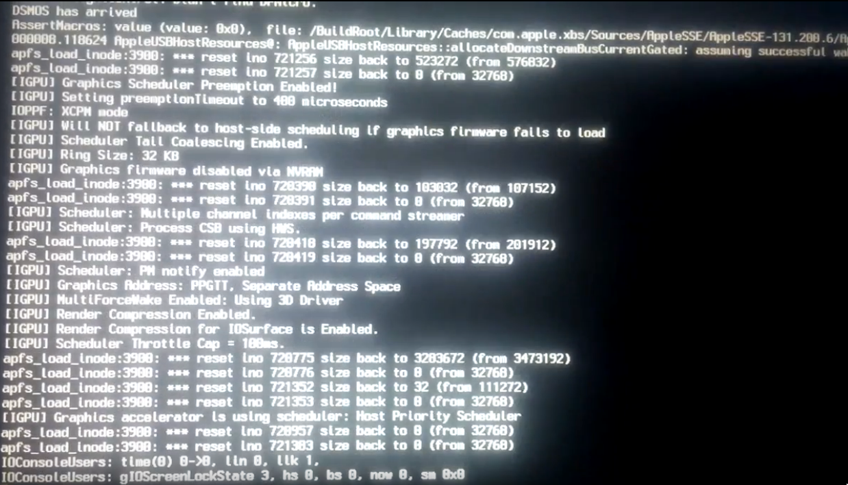

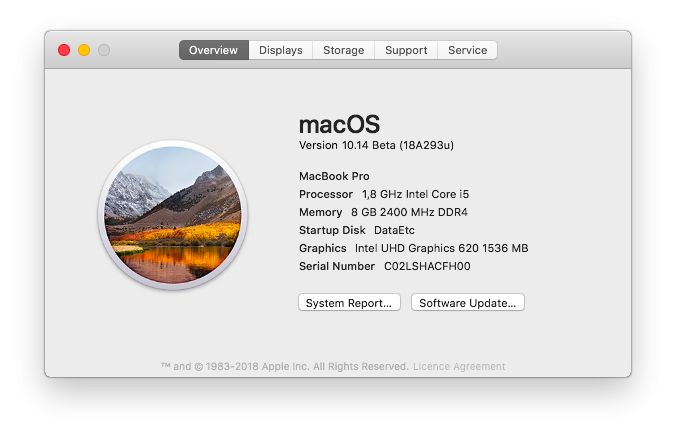

Well, first results on HP Probook G5 i5 8250U - with clover64.efi here, installation at least started, rebooted and going on:) Will report later about the results.
UPDATE 1: still waiting something on a black screen after 2nd reboot
UPDATE 2: finally installed, but can boot only in safe mode. More to come when I'll have some time to check the things
UPDATE 3: up and running now, -lilubetaall helps to boot normally
Edited by sosh3

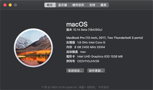

3 hours ago, JHeartyP said:
Tried different FakeID's for gpu. Still end up on a black screen. In kexts/other I have applealc, appleps2smarttouchpad, fakesmc, lilu, usbinjectall, voodootscsync. Boots normally with an invalid gpu ig-platform-id.
config.plist
So I tried 4 different kbl ig-platform-ids and 7 different kbl fakegpuid's and still didn't get past that problem. I think it successfully booted but failed to load the frame buffer. Anyway, it's still a beta. I managed to get acceleration working with my kbl HD 620 using fakepciid and fakepciid intel hd graphics kexts with skl fakeid/intelgfx 0x19168086 and ig-platform-id of 0x19160000. Would somebody with a KBL notebook and an hd 620 be nice enough to tell me what ig-platform-id and fakeid/intelgfx they used? :) Anyway I'm happy so far. :) Everything seems to be working just fine, including audio (haven't tried hdmi yet).
Edited by JHeartyP
