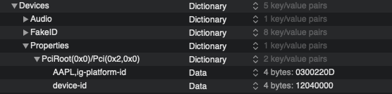

Hello.
I have i3-4170 + hd4400 + 10.14.5 and problems with preview.
I try:
1. change smbios to macmini, imac, macpro and etc = no result.
2. add novpa add my other clover folder (this folder contains: fake, alc, lilu, novpa, realtek8111 and whatevergreen) = no result.
Of course preview work on 10.13, but i love dark mode ;(
My GPU works by edit devices section(see attach).
Thanks for any help.
Sorry for my english, it's not my first language.
Edited by wired-man
Hello, there are many things wrong with your config. Starting with the fact that it looks downloaded from a certain forum of which we don't speak here.
Are you using a dedicated GPU? Can you also provide information about your motherboard? Your config is..not really clean, for as far as I can see. For example, why FakeCPUID? And why that ID? Generate C-States, P-states set to False, no PluginType...
Also, I think I've seen some other people with i3 processors and issues getting either acceleration to properly work, or QuickLook/Preview...
Also, when you upload your config.plist, please, put it in a zip, so you don't make a huge post with a copy-paste of the entire xml.
Can you generate a new config (you can do it from Clover Configurator) and try that one instead? It might or might not make a difference to the actual issue, but it might generate a cleaner config than Tony's.
I also made a few changes to your config. Could you, please, try the attached one?
Always have a backup of your config/EFI folder on a USB so you can boot in case of emergency.
config.plist.zip
Edited by arsradu
