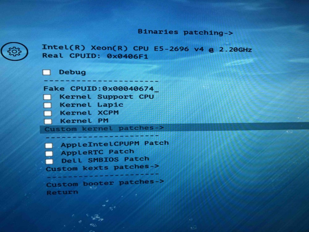

Guest Posted March 17, 2018 Share Posted March 17, 2018 You can try with your first config.plist and if it hangs you can add msr program pikeralpha kernel patch without fakecpuid Link to comment Share on other sites More sharing options...
obus Posted March 17, 2018 Author Share Posted March 17, 2018 (edited) 1 hour ago, fabiosun said: You can try with your first config.plist and if it hangs you can add msr program pikeralpha kernel patch without fakecpuid I tried with my old config.plist and with the patch you've recommended above and no fakecpuid. That didn't work. Your complete config.plist is working but I don't know what should be there and what should be taken away. Could you maybe take some stuff away? Is your AptioMemoryFix.efi special in any way? Another question. Is the MSR 0xE2 register patch on KGP:s Skylake guide universal? Do you think I can use it for unlocking the register on my mobo or should I stick to the TSCAdjustReset.kext? gIOScreenLockState 3 is my problem now. I tried NvidiaGraphicsFixup.kext and nv_disable=1 without success. Any advice? Edited March 17, 2018 by obus Link to comment Share on other sites More sharing options...

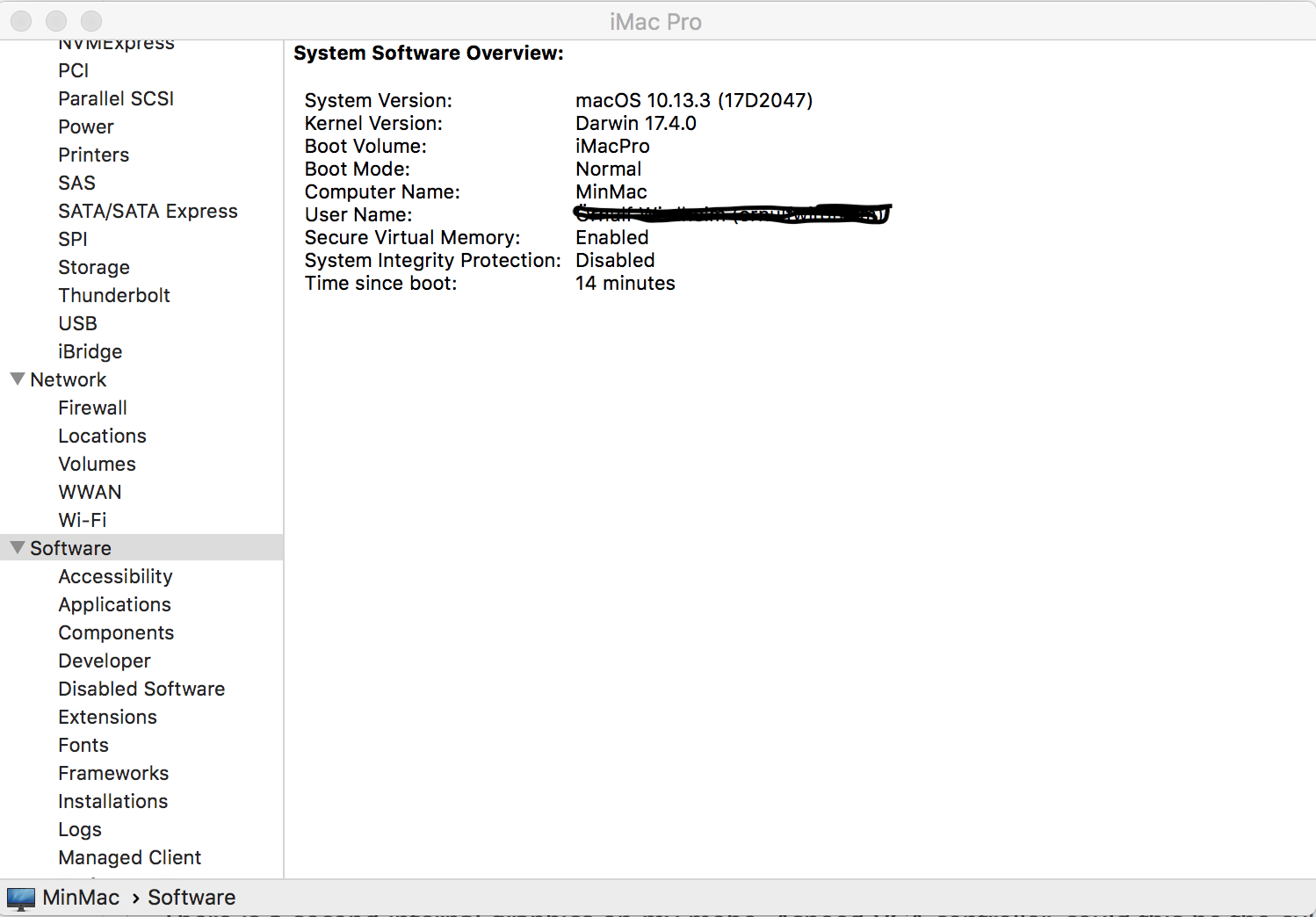

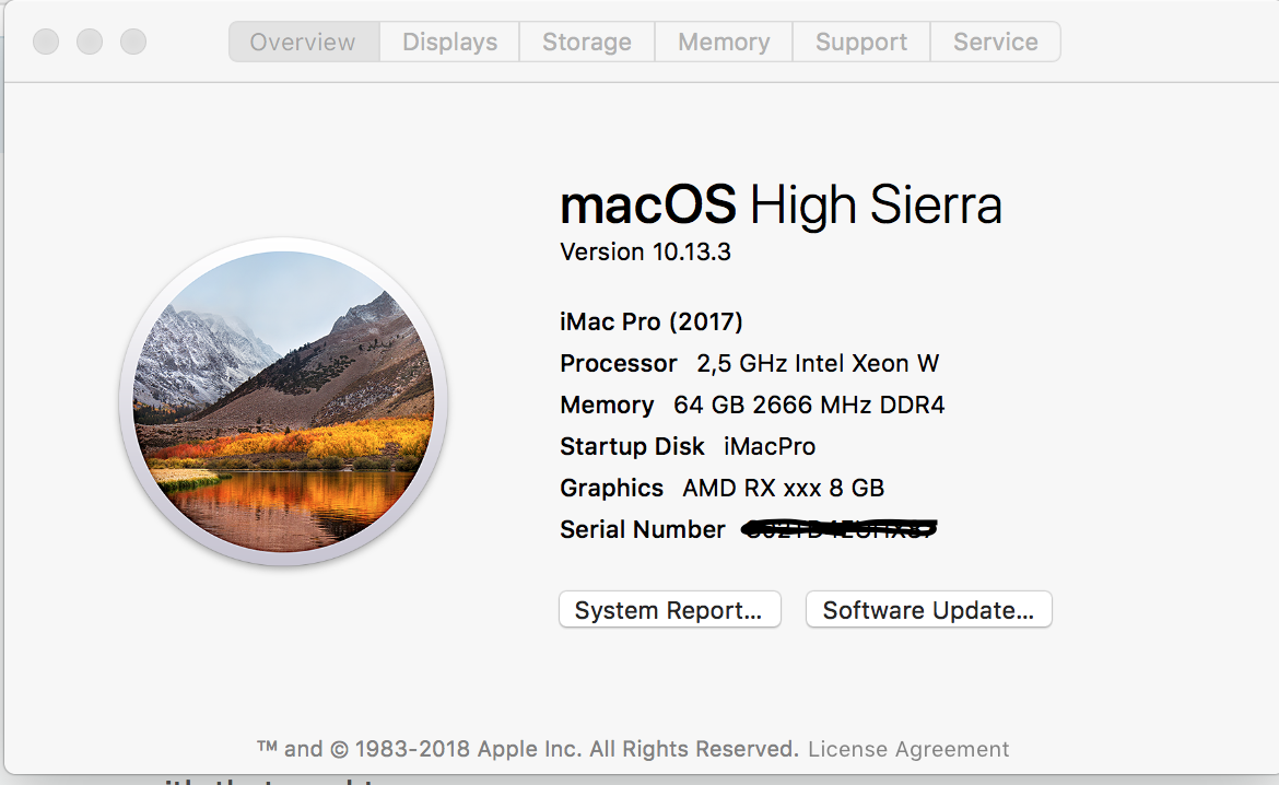

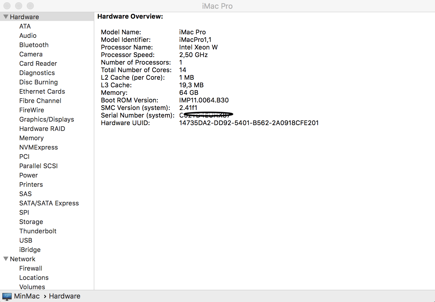

obus Posted March 19, 2018 Author Share Posted March 19, 2018 (edited) On 3/18/2018 at 11:02 AM, joedm ru said: @obus, any update? I'd want to ask you a couple of questions after you got your system (or at least installer) running. It's related to NVRAM, see my post. Up and running after some days struggle. Everything seems to be working except my dual Intel I210-AT Nic:s. If somebody have a solution for this I'd be very, very happy. Tried a lot of different kext with no avail. Thank you @fabiosun for the absolute mandatory "PM" and "xcpm_program_msrs (c) Pike R. Alpha" kernel patch. This two patch paired with Broadwell FakeCpuid 0x040674 was the soloution for booting into the installer. Thank you @jaraheel for the edited TSCAdjustReset.kext. After that everything went smooth (OOB) with booth my GTX 680 and my RX Vega 56. Next step will be to try patching my locked bios. @joedm ru you asked for some information earlier and I hope I can help you now. Edited March 19, 2018 by obus Link to comment Share on other sites More sharing options...
