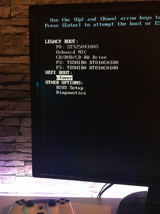

****Edit:

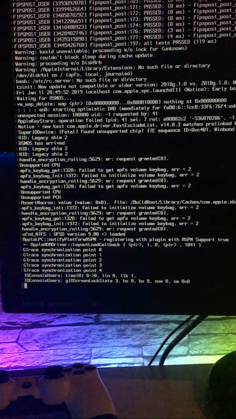

Ive managed to boot Cover in uefi but macos still won't boot (blackscreen at 70%)
This is the Last Line before it becomes black...

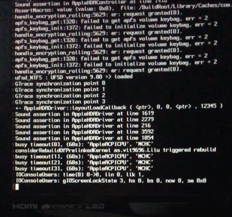

Does really no one know what I can do now? I don't want to use the gt 710 anymore....
On 1/22/2019 at 1:07 PM, chris1111 said:
this is an issue with AppleALC and Lilu
used the latest
Do you know wether this would be possible to fix? If you say its an issue with the latest versions only, should i try older versions?
***edit
Im not sure if i got you the right way, nevertheless I Downgraded the lilu Version from 1.3.1 to 1.2.9 and disabled the appleALC (which isnt necessary to boot i guess) without success. Again blackscreen after the attached Image...

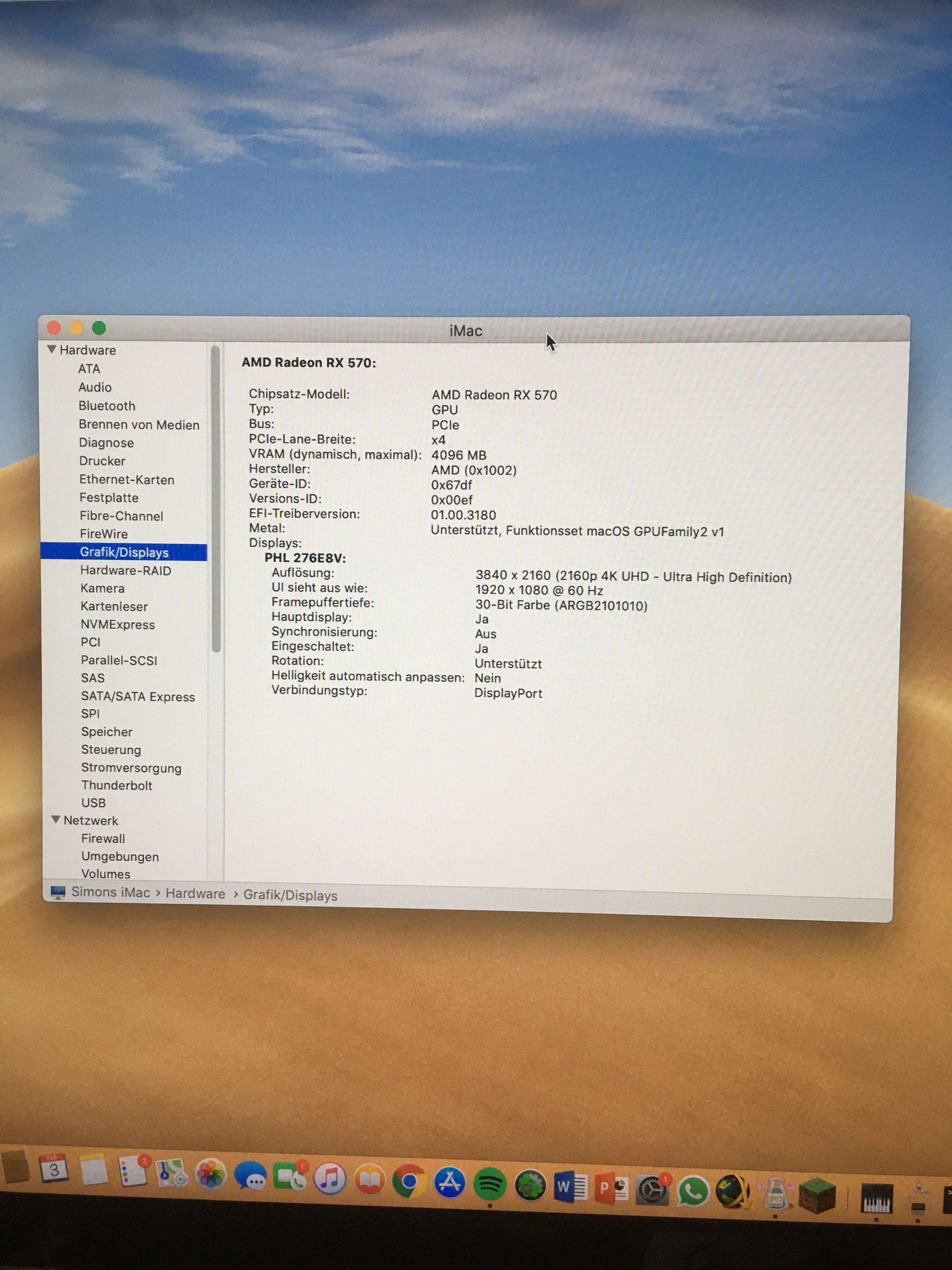

Ive got my Rx 570 working in macos finally! The solution was using a DP cable instead of the HDMI. My second Monitor only uses HDMI so I cant use it now.  Does anyone have a tip or a solution for this problem?
Edited by blxkspell

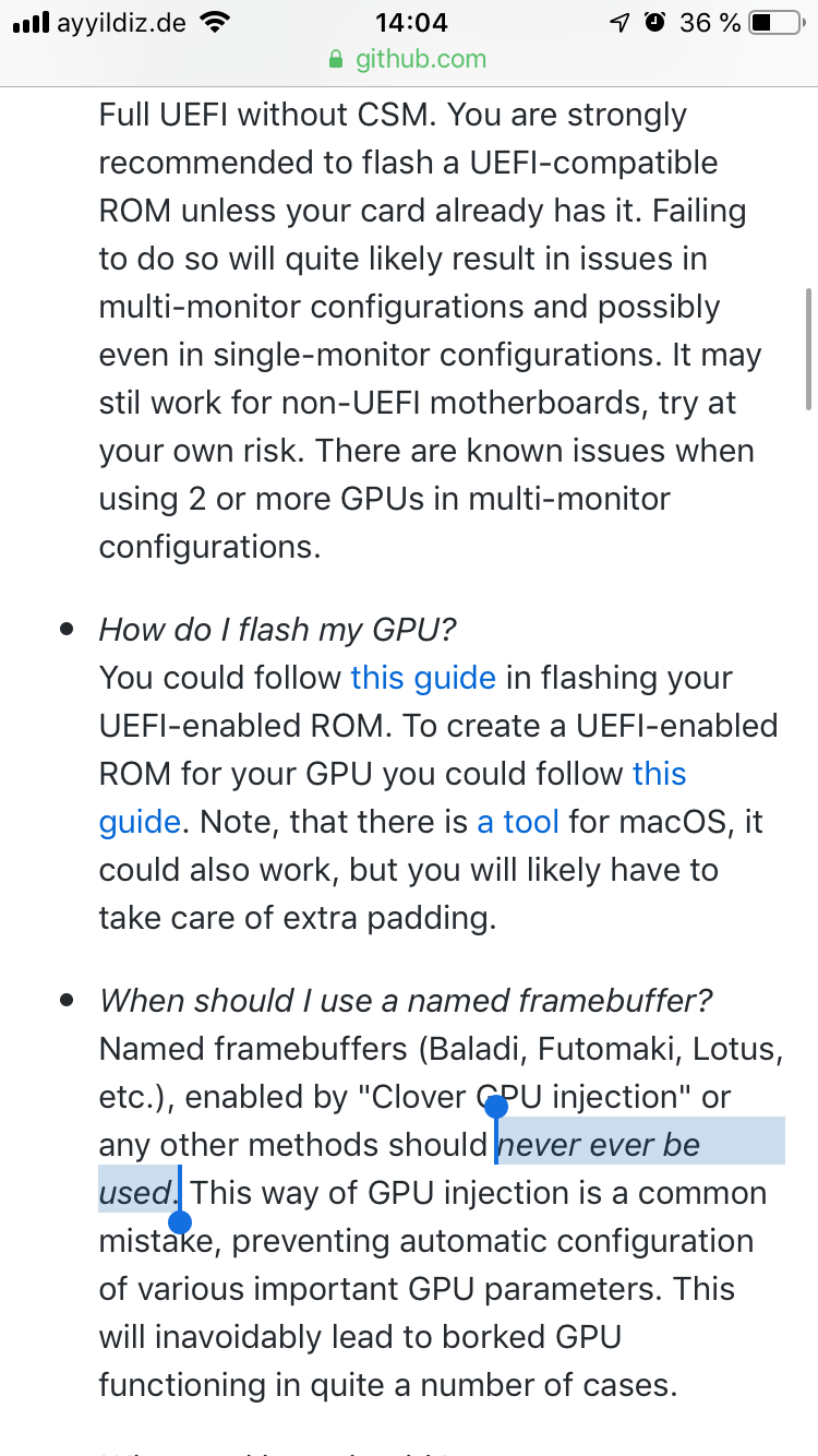

Actually Ive already tried to inject ATI and add orinoco as FB which would fit to my Rx 570 but it didn't work either. I have the feeling that for my system it doesn't make a difference at all wether I use the Whatevergreen kext/ Framebuffer/ Radeondeinit or not.
Also I've read that with WeG injected you shouldn't use injectATI
