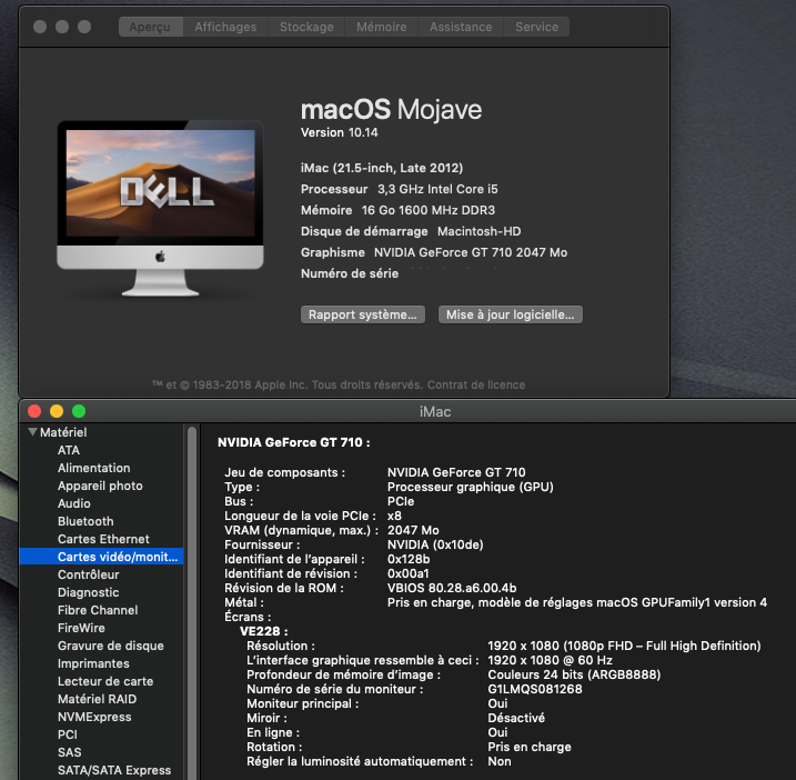

fedaamahmoud Posted October 30, 2018 Share Posted October 30, 2018 3 minutes ago, chris1111 said: Stock DSDT no graphics patch config.plist ➜ Inject Nvidia = False this card works OOB from macOS Sierra to macOS Mojave See here https://www.insanelymac.com/forum/topic/332512-guide-macos-high-sierra-1013-dell-optiplex-780-760-755-790-990/?do=findComment&comment=2625927 Thank u so much I'll buy it asap Link to comment Share on other sites More sharing options...
chris1111 Posted October 30, 2018 Share Posted October 30, 2018 2 minutes ago, fedaamahmoud said: Thank u so much I'll buy it asap See I have this card Link to comment Share on other sites More sharing options...
fedaa_mahmoud Posted October 30, 2018 Share Posted October 30, 2018 21 hours ago, chris1111 said: See I have this card Great mojave really awesome . Link to comment Share on other sites More sharing options...

MacPeet Posted November 2, 2018 Author Share Posted November 2, 2018 here too, 10.14.2 DP1 works @rachad gt710 is better, OOB works with Sierra, HS and Mojave HD5450 works only up to Sierra (and HS with rollback), Mojave without graphics acceleration Link to comment Share on other sites More sharing options...

MacPeet Posted November 4, 2018 Author Share Posted November 4, 2018 (edited) Yes, but without inject nvidia. Everything is empty in the CloverConfigurator / graphics. GT710 works OOB. I have the MSI GT710 2GB passive version without fan. (Remove graphics entry from the HD5450 in the DSDT) Edited November 4, 2018 by MacPeet Link to comment Share on other sites More sharing options...

morpheousman Posted November 20, 2018 Share Posted November 20, 2018 On 11/18/2018 at 8:03 AM, blxkspell said: i use the 120mm fan from my old dell 780 with the cooler master hyper 212x heatsink bc dell uses a different pin layout than the stock coolermaster fan. Maybe thats the reason for my issue. btw is it already possible to install mojave on the dell 790? I have Mojave on my 790. I had to change video cards from the HD5450 to a Gigabyte Geoforce 710. G710 works OOB On 11/13/2018 at 4:16 AM, gendigbadig said: i have optiplex 990 SFF with i5 -2400 and Nvidia Zotac GT710 2 gb How can i install newly high sierra or mojave on this pc? I've tried with tutorial on first page but no luck. Always had black screen after loading FakeSMC.kext I'm using clover 2.4k r4701 Rehabman version Is there any DSDT that should be used to make installation run? Thanks. Where is install hanging up, can you get through to installation screen? Link to comment Share on other sites More sharing options...
