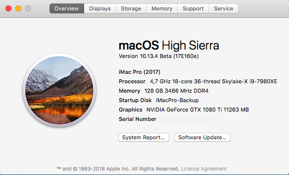

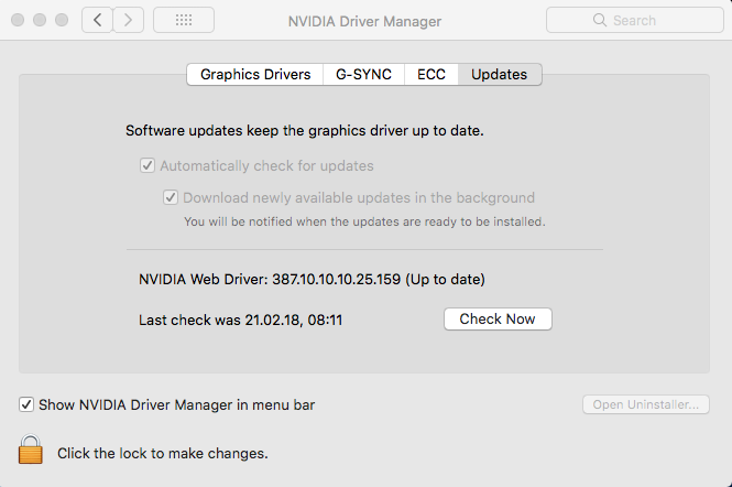

Successful Update to macOS High Sierra 10.13.3 SA (17D2102)
Important Notification: Note the new macOS Build number 17D2102! No official Nvidia Web Driver has been released yet for 17D2102! Thus, all Nvidia users have to work with the xx.106 or xx.157 Web-Deriver Patch-Workaround fully described in Section E.2) - Graphics Configuration, until an official Nvidia Web Driver has been released for 17D2102!
The guide in the originating post of this thread will be updated, as soon the latter Web Driver is available.
Enjoy and have fun,

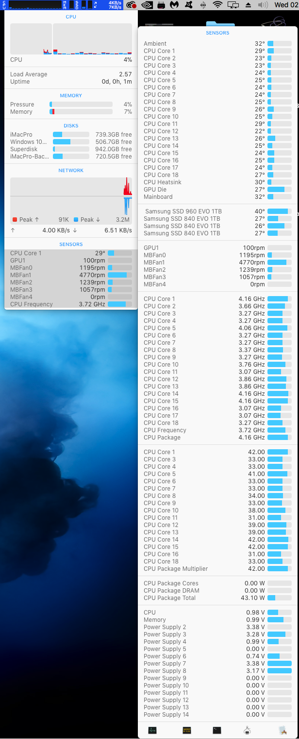

Big Progress in Skylake-X/X299 HWMonitoring
After a extensive tweet session between @BJango, @gxsolace and myself, it seems that we approached a major step forward towards a correct Skalyke-X/X299 HWMonitoring based on the HWSensor and FakeSMC kext distribution provided by @interferenc and iStatMenus provided by @BJango. Many thanks to both @interferenc and @Bjango for their awesome and extensive contributions and just brilliant work!
The recent iStatMenus beta distribution can be achieved here: https://s3.amazonaws.com/bjango/files/istatmenus6/957.zip ….
The HWSensor and FakeSMC kext distribution of @interferenc can be achieved here: https://github.com/interferenc/HWSensors.
To compile the HWSensor kexts, perform the individual steps detailed below:
1.)
git clone https://github.com/interferenc/HWSensors
2.)
cp HWSensors ~/Desktop/
3.)
cd ~/Desktop/HWSensors
4.)
xcodebuild -project Versioning\ And\ Distribution.xcodeproj/
5.)
xcodebuild -project HWMonitor.xcodeproj/
6.)
xcodebuild -project HWSensors.xcodeproj -alltargets
Subsequently, one finds the all compiled binaries in ~/Desktop/HWSensors/Binaries/.
Note that all compiled kext binaries are once more attached below. Just download and unzip HWSensor-kext-distribution-interferenc.zip and copy all kexts to /EFI/Clover/kexts/Other/.
Remaining problems:
a.) CPU Package Cores and CPU package DRAM power consumption apparently not supported by sensor kexts...
b.) GPU Fan speed at 100 rpm for water blocked Nvidia GPU :-)
Enjoy and have fun,

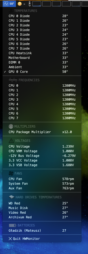

Very good news. But still no support for RX radeon series in gpusensor.kext. And I notice that cpu voltage showing incorrect value.
For now I thing will stay with @Slice version. There are all moderatory information
@Matthew82, for me the important thing is to finally retreive the correct Skylake-X CPU information, which totally fails with HWMonior.app. I am optimistic that one can use any sensor kext distribution with iStatmenus. No explicit need to take the sensor kexts of @interferenc. What improved is the Sensor interface of iStatmenus!
Cheers,
KGP

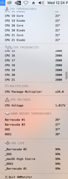

From long time a not using HWMonitor.app. But @Slice make compatible version for HWMonitorSMC.app and iStat.
Well then his Sensor kexts should also work with the new iStatmenus beta.. As far as I see from your picture above, you are still limited to 8-10 core sensor information. For me the kexts of Slice do not work at all...
Up to you, it is not a must to use the new iStatmenus beta... you are free to do whatever you want..
Cheers and good luck,
KGP  :wink_anim:

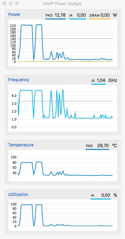

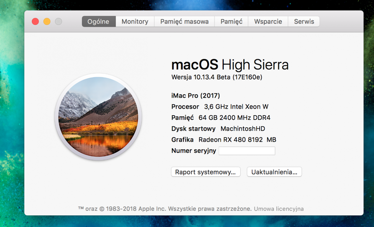

No issue and my build is stable , the most improvement is that xcpm_core_scope_msrs © Pike R. Alpha", kernelToPatch,  TSCadjustreset kext  are no more needed. :)
I found in DMI tables from iMacPro cpu type "0f01" and showing now W xeon attachicon.gifZrzut ekranu 2018-02-22 o 00.18.25.png
I notice to that ACPI_SMC_PlatformPlugin.kext shoud not be load. So I made kext disabler to prevent loading. But I don't know is that important thing.
https://drive.google.com/file/d/1UPKGmd2pg3eX18Ervd6Bk5SKg_Y3oPom/view?usp=sharing

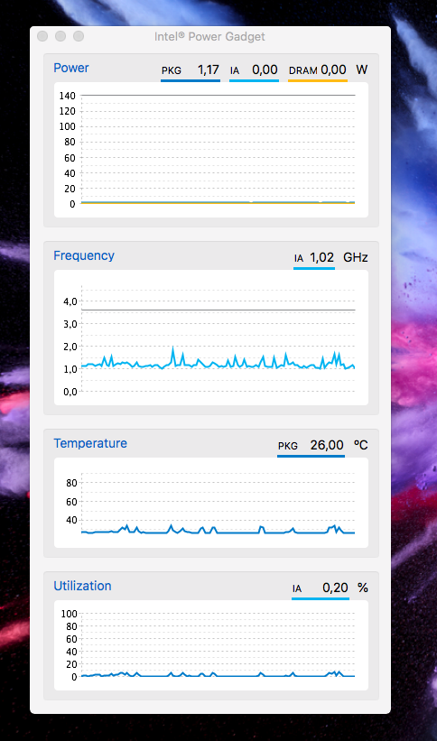

disable ACPI_SMC_PlatformPlugin.kext does change something here.
When i use the disabler, my system idle down to 1.00 GHz, when ACPI_SMC_PlatformPlugin.kext is loaded, idle @ 1.20 GHz.
In orginal SystemRaport from iMacPro ACPI_SMC_PlatformPlugin.kext in not loading, but in my hack is loading. So I disabled it. But I really don't know what impact it can have on correct system working.
if plugin type 1 is set, osx will load X86PlatformPlugin.kext.
If plugin type 1 is not set, osx will load ACPI_SMC_PlatformPlugin.kext
I saw same unstable system behavior when using disabler.kext. So I thing there is no point to experimenting. If you want lower temp and frequency in idle mode you can use modified PlatformPlugin. https://drive.google.com/file/d/1IANg7Qtz7IRoAe4xxvsLSh7P4M94qb5S/view?usp=sharing
